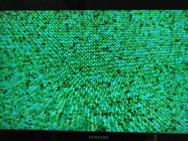

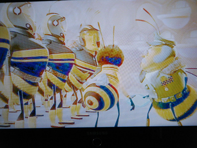

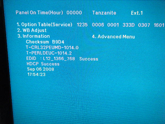

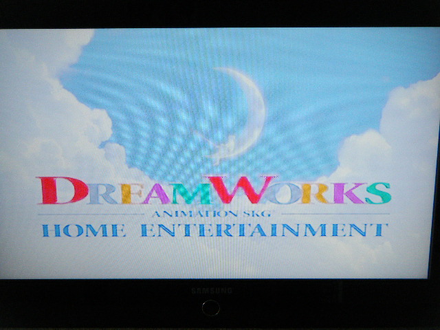

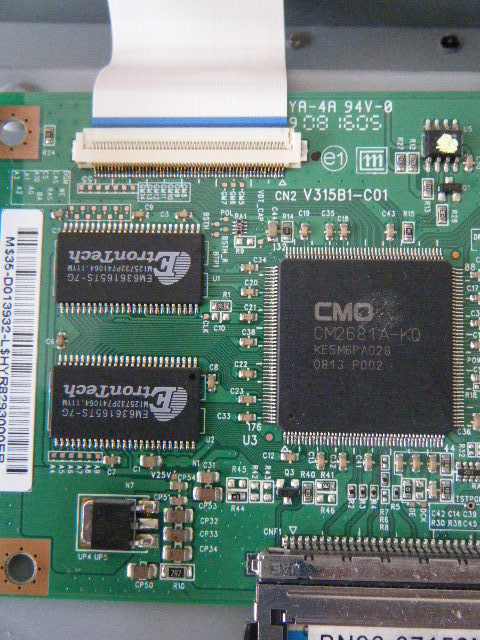

      Hi, Thank you, the issue is the picture quality/Colour. A friend had same fault and found by going into service mode he changed a setting called "DRR LINE" and the pictures has been fine for the last year. I went into service mode and could not see it so did a factory reset, still the same so added some pics guys. Any thoughts?
      The service mode screen the colours are fine and all looks good. The next image is a green snow screen that is the screen between chapters when a DVD is played. The next is the dream works screen and the colours seem ok, but the next one is from the actually film and they look terrible and a tad blurred.
        Re: Service Mode on Samsung LE32A436T1D

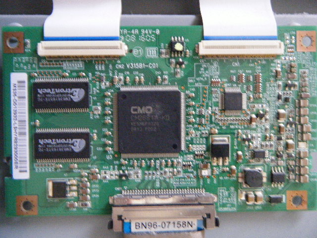

        Gamma fault I'll bet; post a picture of the T-con board. Has nothing to do with service menu.
          Pic as requested, I have checked all the connections to and from Tcon
            I need to be able to see the little test points on the board, but it looks like you have AS15 gamma IC which commonly fails (righthand 48 pin QFP.)

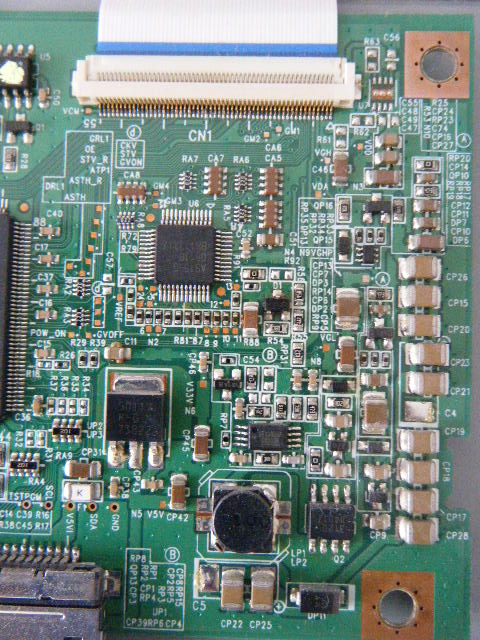

              Taken two pics of the Tcon, hope you can see what you need.
                OK, see the points marked GM1...GM14 (not all may be available) check the voltage on each, red probe on point, black probe on chassis, TV powered on.
                    GM1..13.16V
                    GM2..13.14V
                    GM3..13.04V
                    GM4..12.24V
                    GM5..9.16V
                    GM6..7.87V
                    GM7..11.13V
                    GM8..6.66V
                    GM9..6.20V
                    GM10..5.04V
                    GM11..4.52V
                    GM12..3.81V
                    GM13..3.03V
                    GM14..0.053mV
                      Another bad AS15 gamma chip. Replace it.
                          Hi Tom and Budm,
                          Thank you so much I have ordered the IC, cant wait for it to arrive as I love doing micro soldering jobs. Can I ask a question what told you it was faulty? was it one of the voltage readings? If so which one and what should it be? Just trying to develop my knowledge on TV's.
                          Andy
                            GM7 is bad, but in general, for future reference a quick test is the voltages must count down in one direction i.e. 1,2,3,4V is OK, 4,3,2,1V is OK, 4,2,3,1V is NOT OK.
