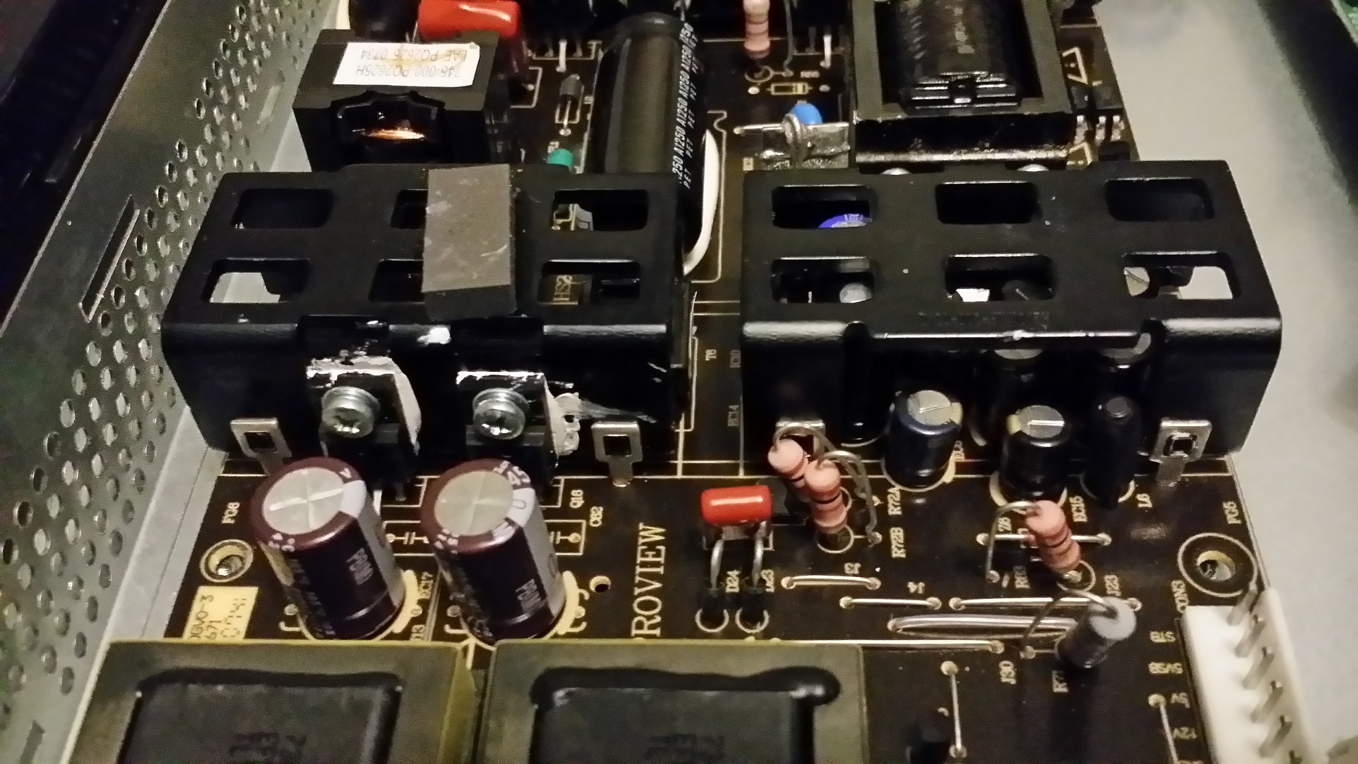

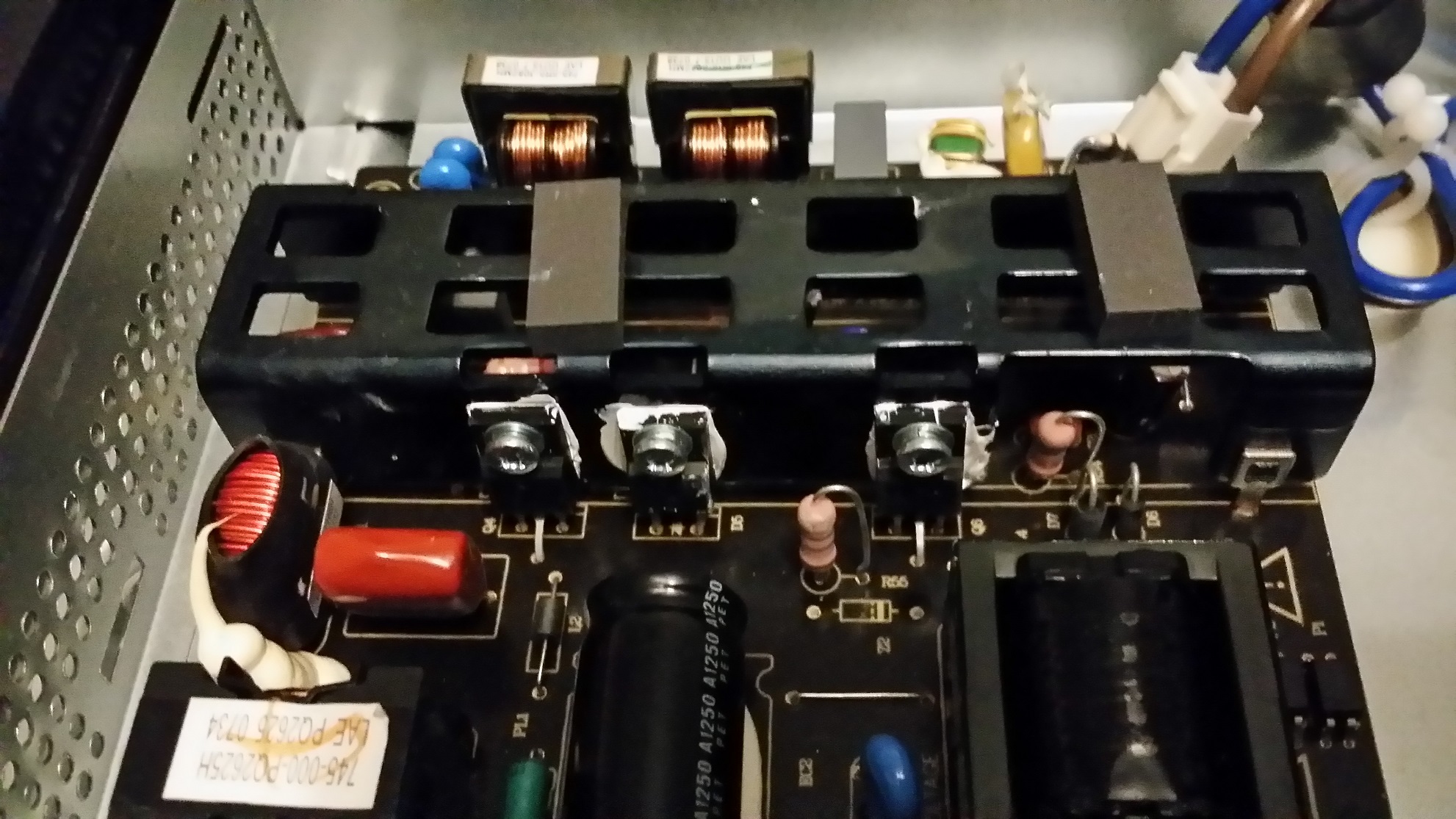

    I just purchased this TV. when power is applied I get a pulsing flash from the red power led. but the TV won't turn on. the person I purchased it from just replaced all of the caps. not sure where to go from here. what to test?

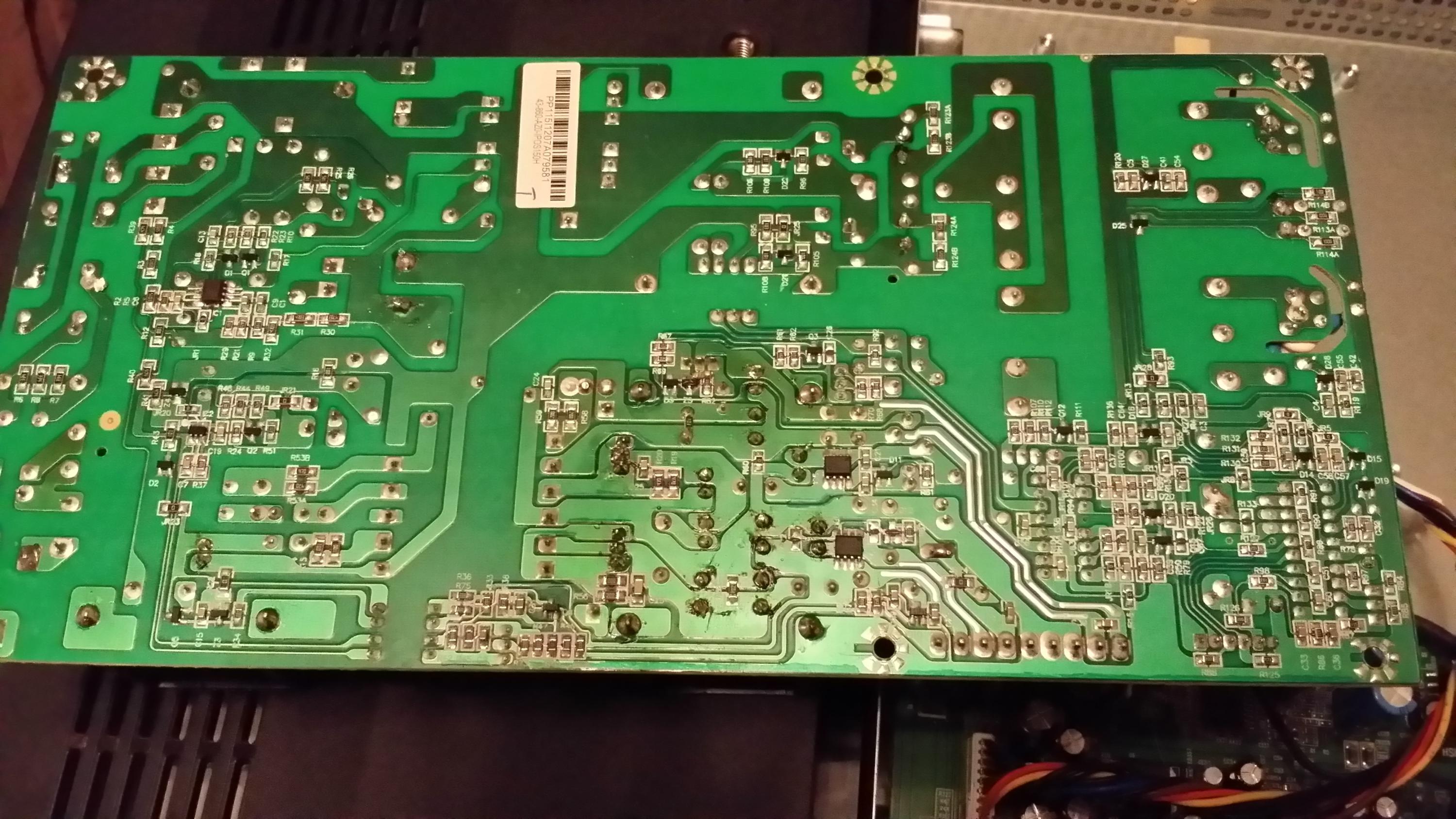

      • ntehicks
        • Mar 2011
        • 272
        Re: Memorex MLT3221 Red power LED pulsing

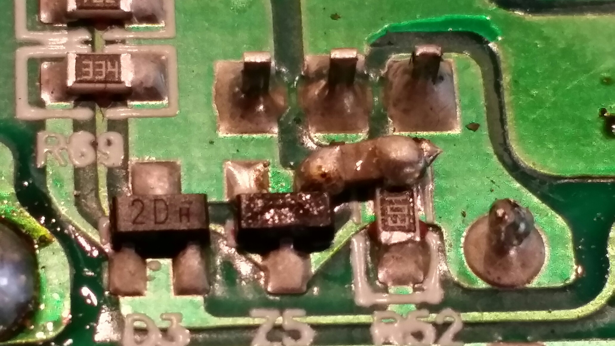

        I just noticed this on the bottom of the power board. not sure of this is normal or if someone made a modification.

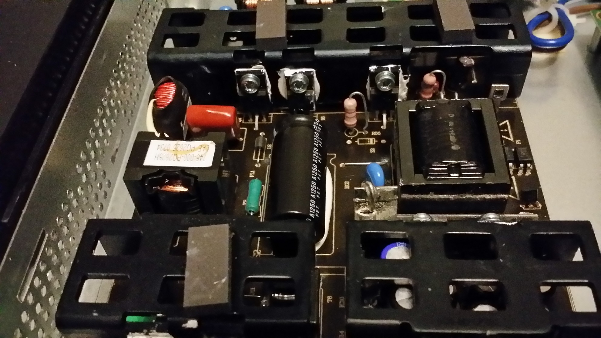

        • ntehicks
          • Mar 2011
          • 272

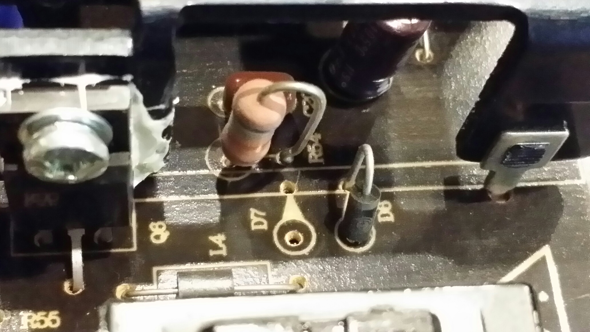

          I was tested on the primary side and came across D7 the part number is HER207 it is testing low ohms both directions.

            so I have ordered a replacment diode. is there anything else I should test before installing new diode and connecting power to the tv?

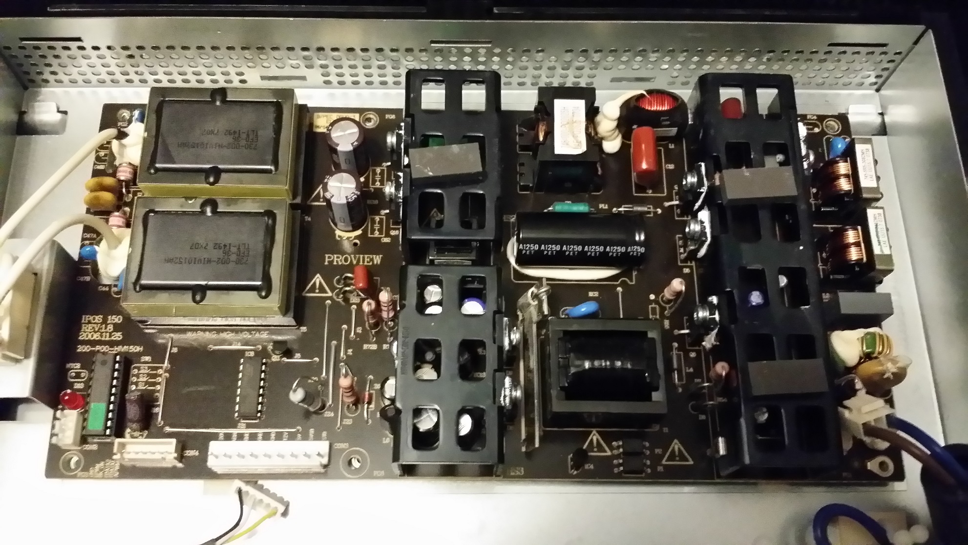

              replaced D7 and still get the same results. the front led blinks red and tv won't turn on. I at the same time ordered a full working power supply and tested the tv with that and TV works. I would like to figure out what is bad on this board. no 5 volt standby.

                is it possible to take this power supply and run it with out the other boards. I would like to trouble shoot the 5volts missing.
                  If the +5VSTBY is not working, you can run the power supply board by itself since +5VSTBY is an always on power supply so you can troubleshoot that +5VSTBY without having the board connected to anything else. Or you are talking about +5V (swithced).
