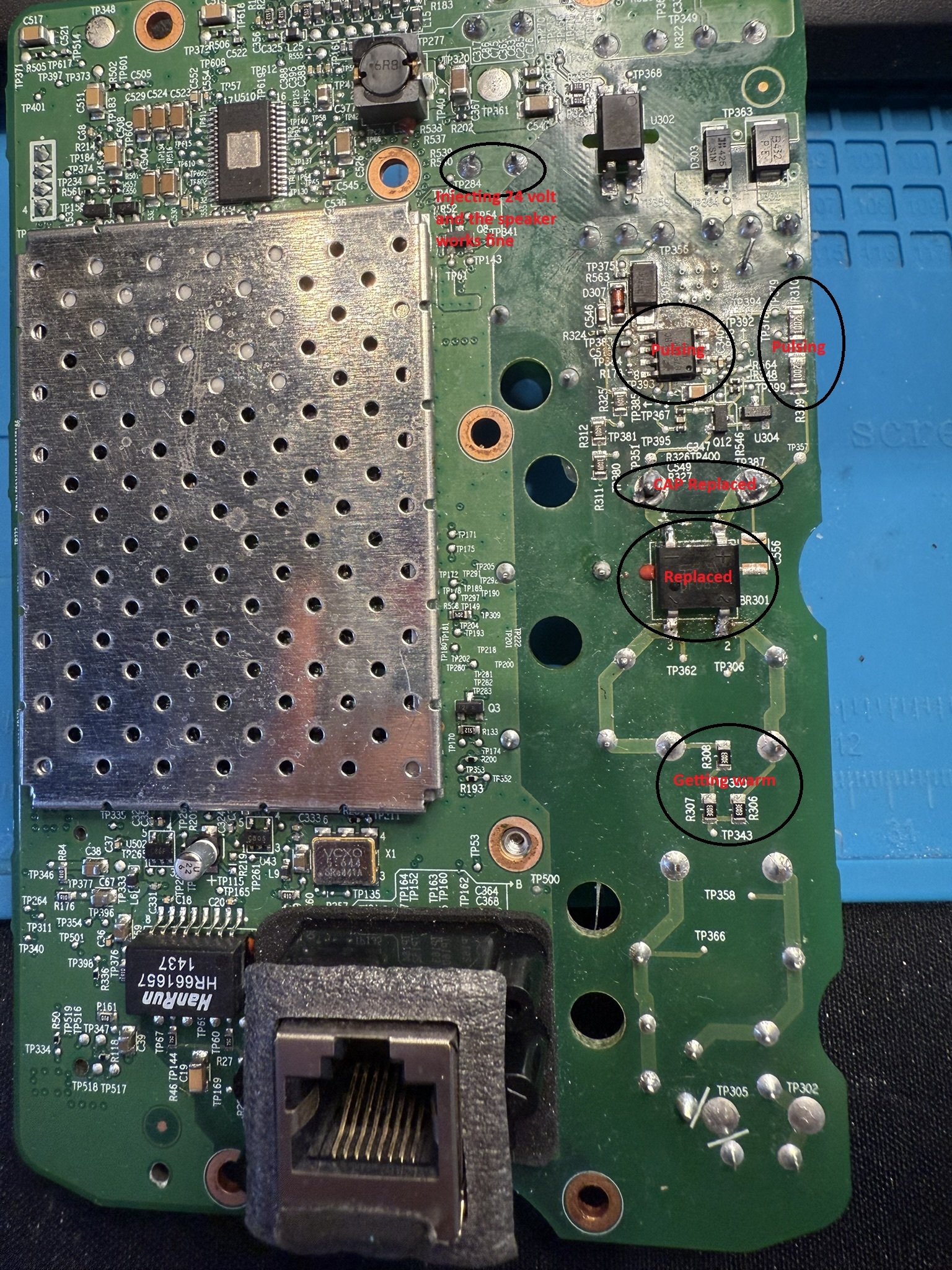

    I'm rather new to repairing electronics, i do know the basics of most components but never actually repaired a PCB, but i want to change that.
    So, i bought a faulty Sonos Play 1 speaker with the intention of finding the fault, and replace the damaged part.
    Well, i did find the fault, i replaced parts that i thought caused the problem, but no-go.
    The problem is a pulsing power supply, when i connect the mains to the board and hook up my thermal cam i see R306,307 and 308 getting warm, but i assume that's normal.
    But, whats is not normal is the pulsing of resistor R309 and R310, and R310 is connected directly to the PWM controller (FAN6751MR) and that pulses half a second later (or earlier)
    I have replaced the FAN6751MR, replaced the df08s bridge rectifier and replaced a 400v 100uF CAP, but it keeps pulsing.
    When i inject 24 volts on a CAP (35v 2200uF) right after the power supply the Sonos boots up and works without any problem.
    Can someone give me a hint where i should poke my multimeter?

    It’s cycling… I’ll give you a hint. Study the FAN6751 pdf. It will telly what needs to happen. sometimes it pays off to read the datasheet. The bridge rectifier was a wrong call, The main filter capacitor, could have been, but I would have doubt it. The two pulsing resistors go to the negative of the main filter cap.
    The question right now is: What could be the cause(s) that makes the PWM behave like that?
    I hope I gave you a gentle nudge in the right direction.

      Believe it or not, but i was just looking at the https://www.mouser.com/datasheet/2/1...51MR-94595.pdf datasheet and measuring the components behind the VIN, i'm assuming that the VIN "protects" the system and is turning on/off

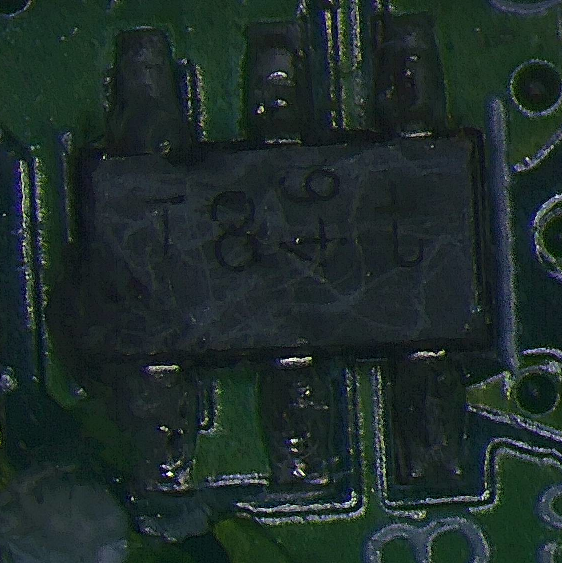

        On the other side of the PCB there is also one component cycling, and that component is after the fan6751, but i can't seem to find the component on the internet.
        Anyone with a idea what this is?
