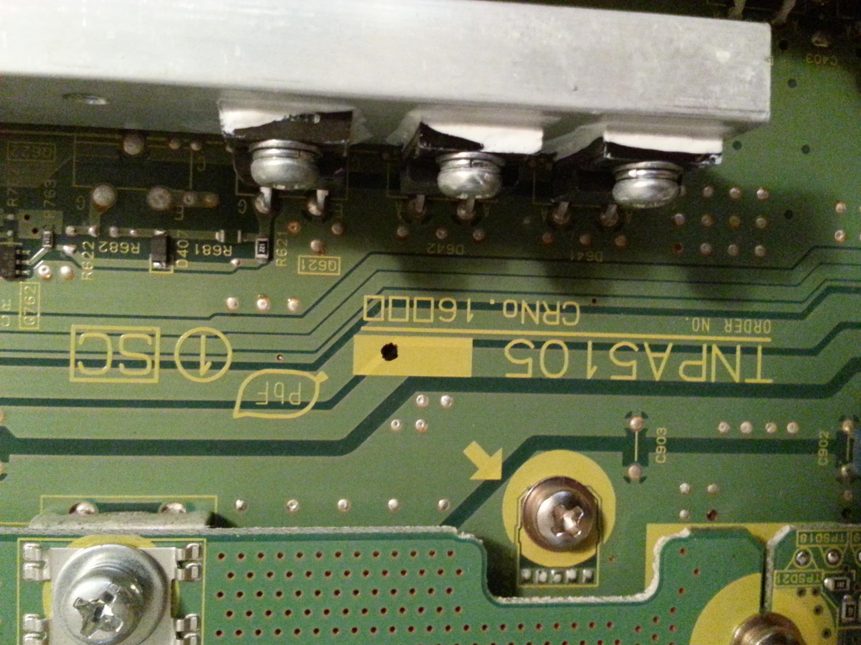

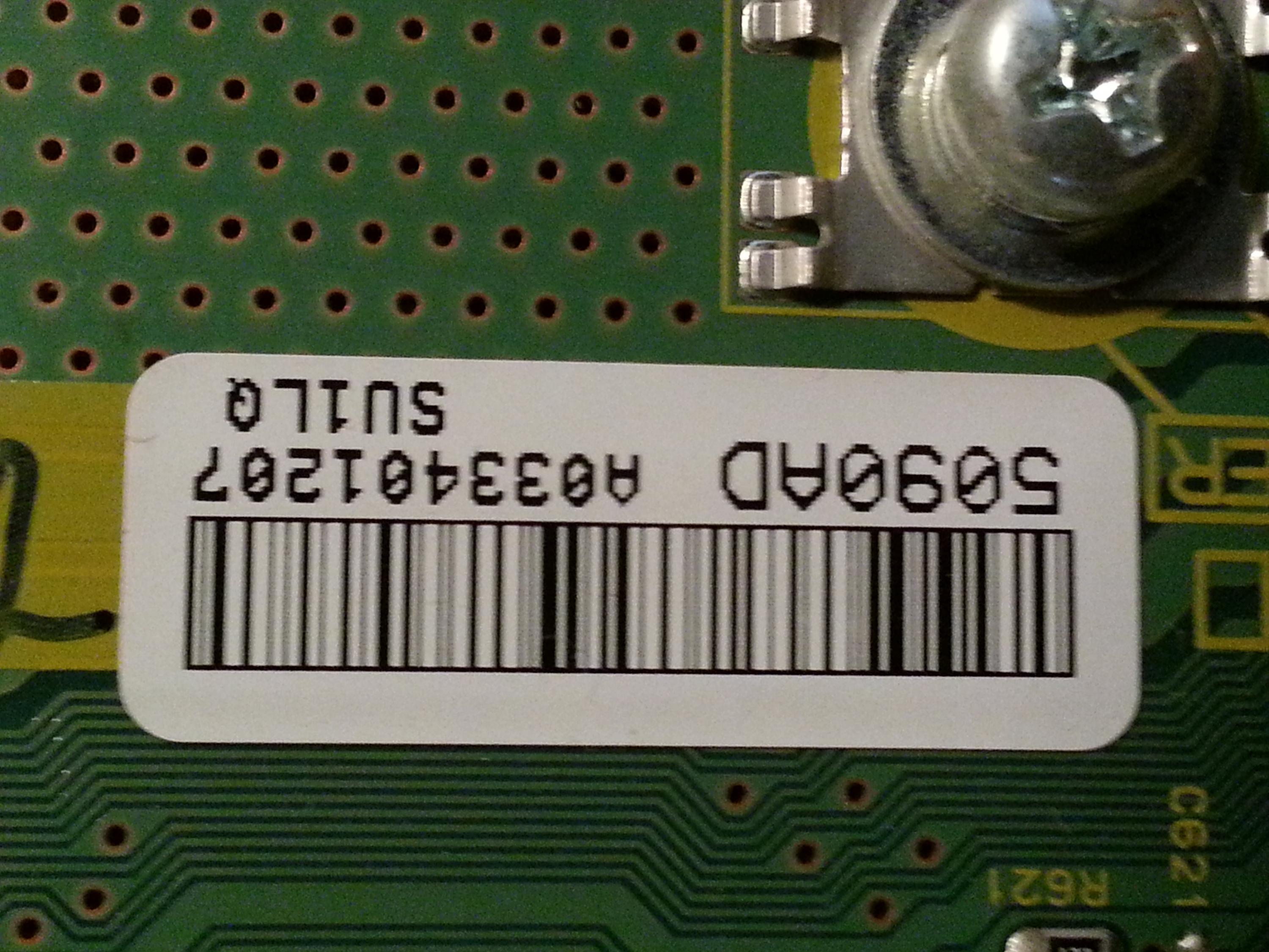

            There are a couple of part numbers on the board. Can you tell me which to use? Also, where can I find the prefix? I think it is a TNPA5105 but no prefix.

              Re: Panasonic TC-P50S2 Snowy Picture
              The first shot is the SC board.
              The second is of the SU board bolted/connected to the SC board.
              Could be a very hard board to source.
              TXNSC1LQUU, TNPA5105AB
              Panasonic
              TC-P50S2 TC-P50U2, TX-P50S20B, TX-P50U20B
              Edit: TXNSC11FEK50 is another part number.
