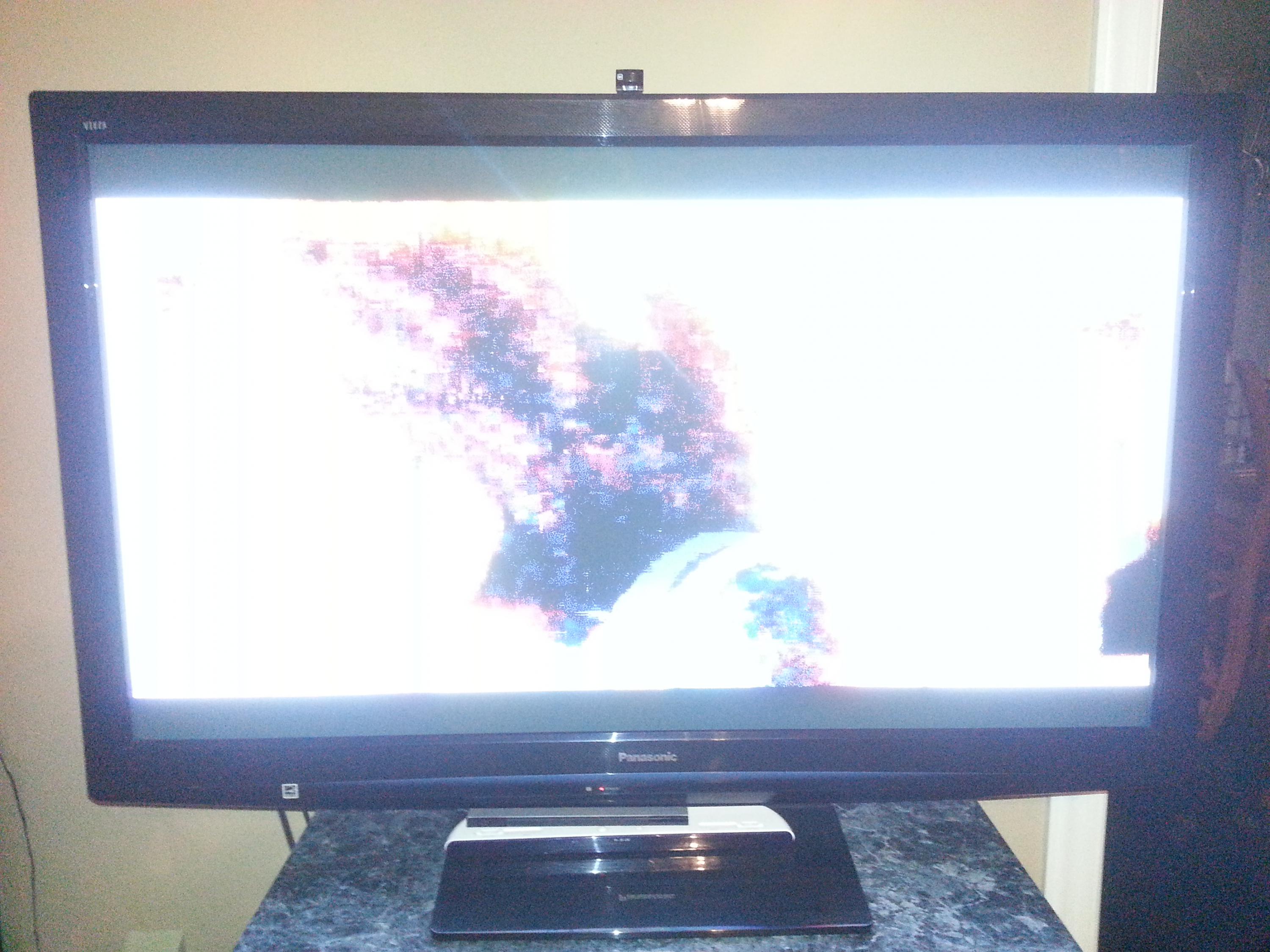

    Hi all, and thanks in advance for the help.
    I have a Panasonic TC-P50S2 50" Plasma. When I first turn on the TV the picture is very snowy and Sparkly, it seems to have slight lilac color image retention and looks as if contrast is set to extreme levels. After about 5 minutes it clears completely and has a beautiful picture with no issues.
    I can not post pictures at this time as the screen is clear now. this only seems to happen when the tv has been off a few hours.
    Does anyone have any clue as to what might be going on?

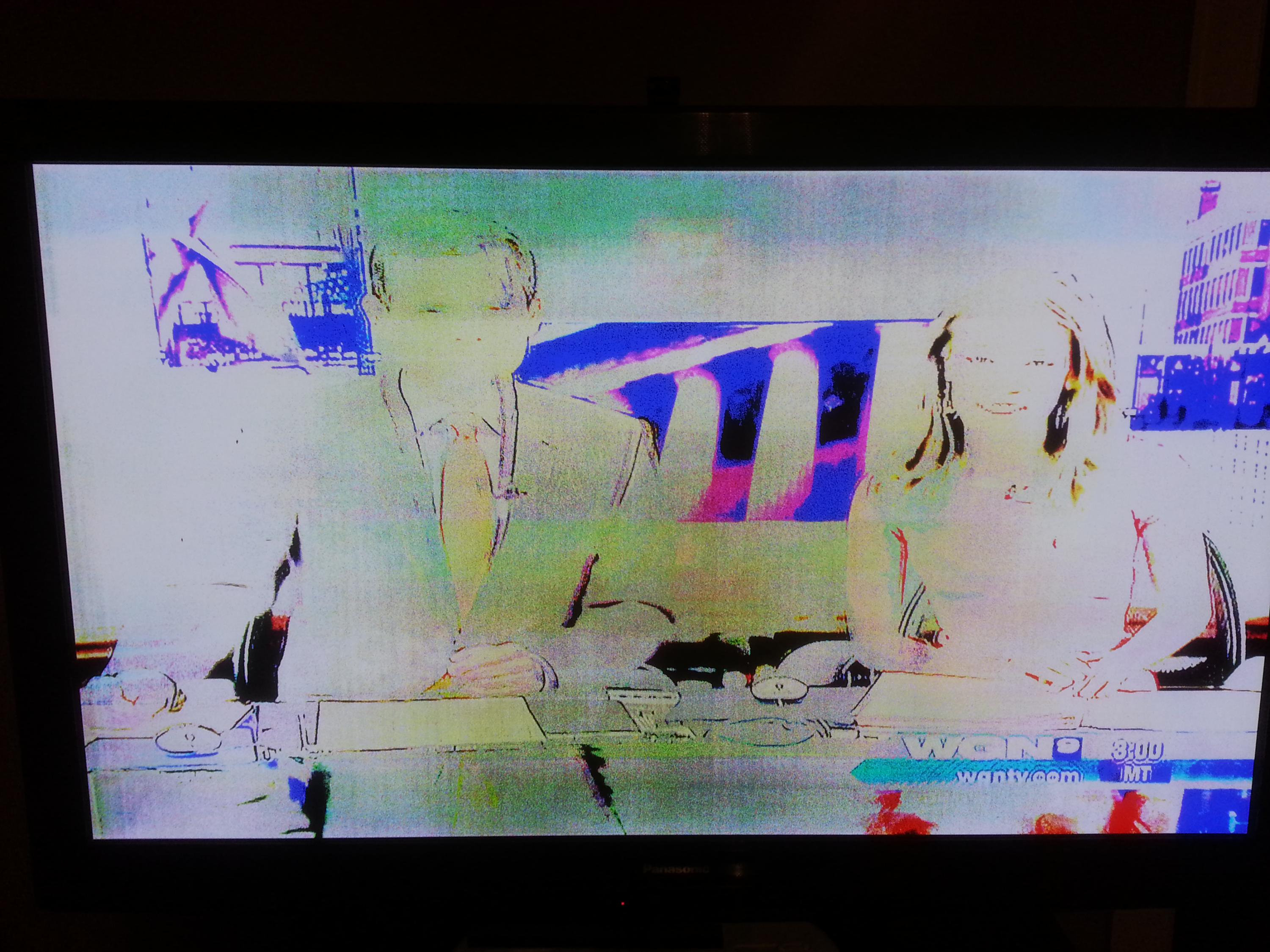

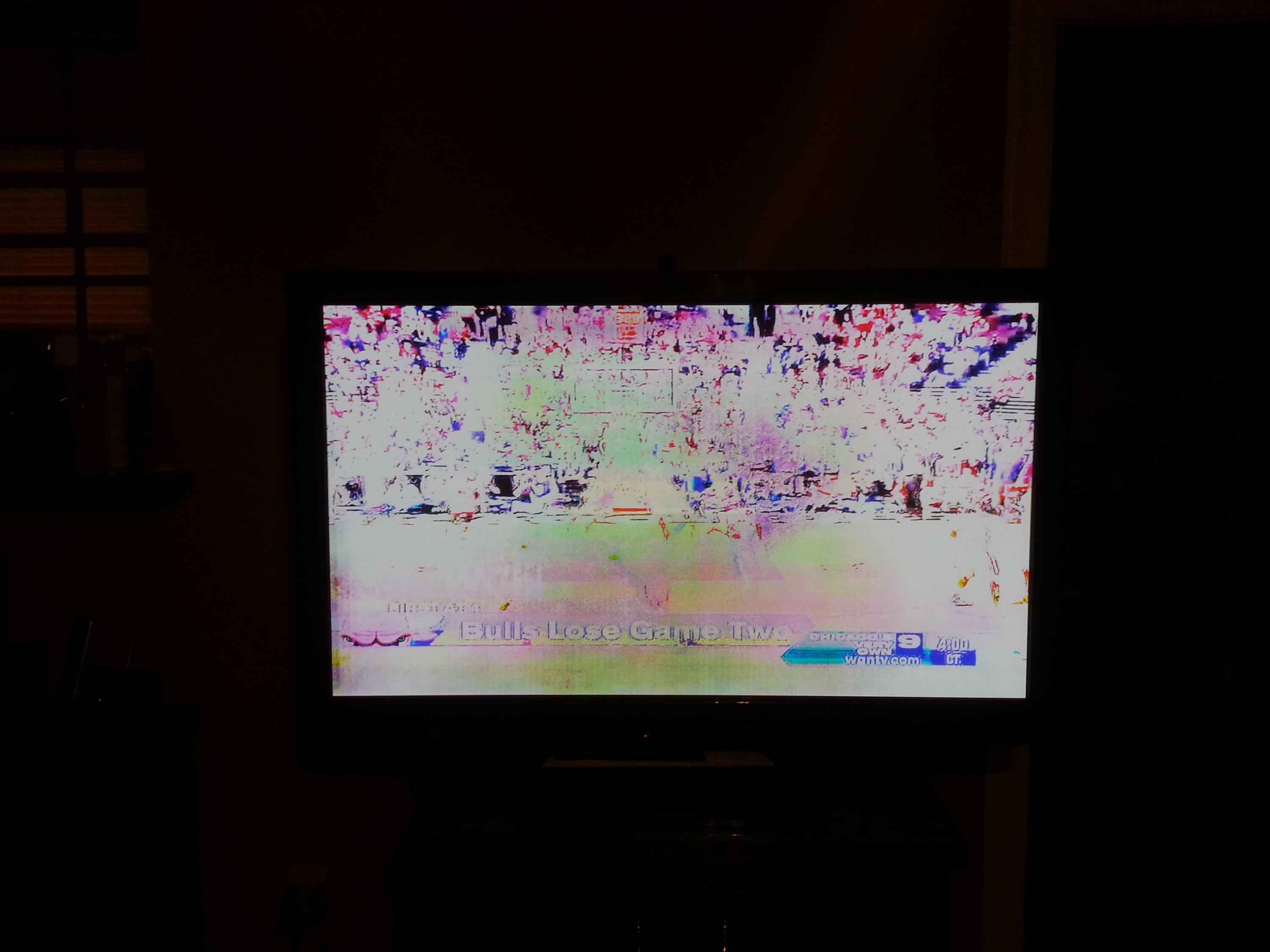

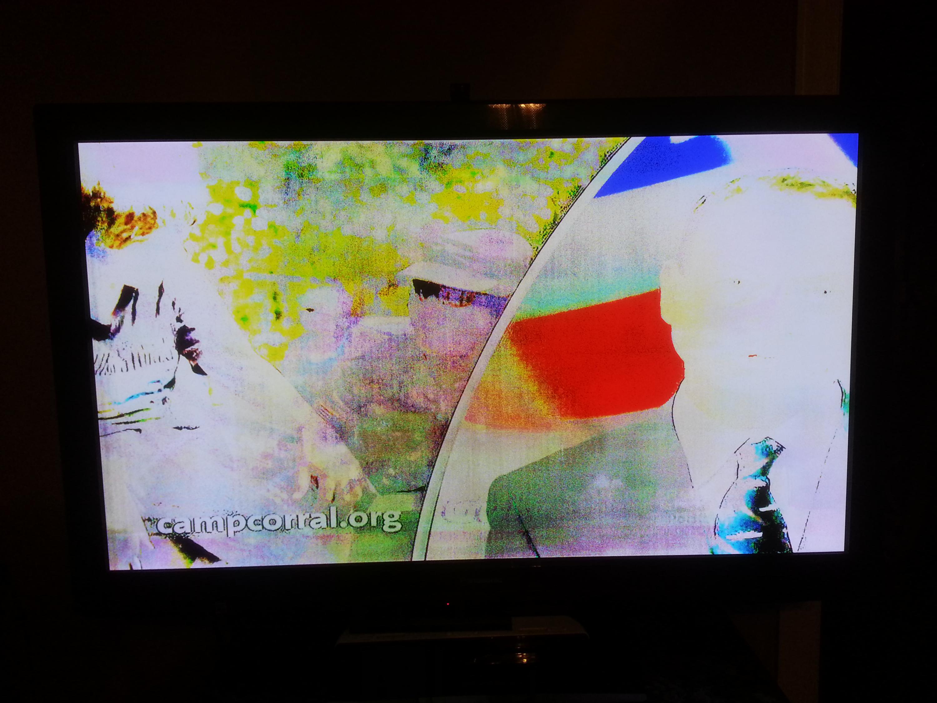

          Re: Panasonic TC-P50S2 Snowy Picture
          This is of the fault. I will send pics of the board's this afternoon. It only does this for about five minutes then clears until the next time it is turned on after being off for a few hours.
          • tw2005
            • Oct 2011
            • 6458
            That's one of the most original Panasonic failures I've seen here. looking at the first shot, I'm thinking A board then at the last I'm thinking SC/SD/SU and then after it warms up you say perfect which would make me suspicious of the A again.
            Maybe next time try warming the A board up and see if it goes away quicker.
            This will interesting to follow.
              Yeah that's not an SS board fault in my opinion; if anything SC or missing drive waveform due to A board fault.

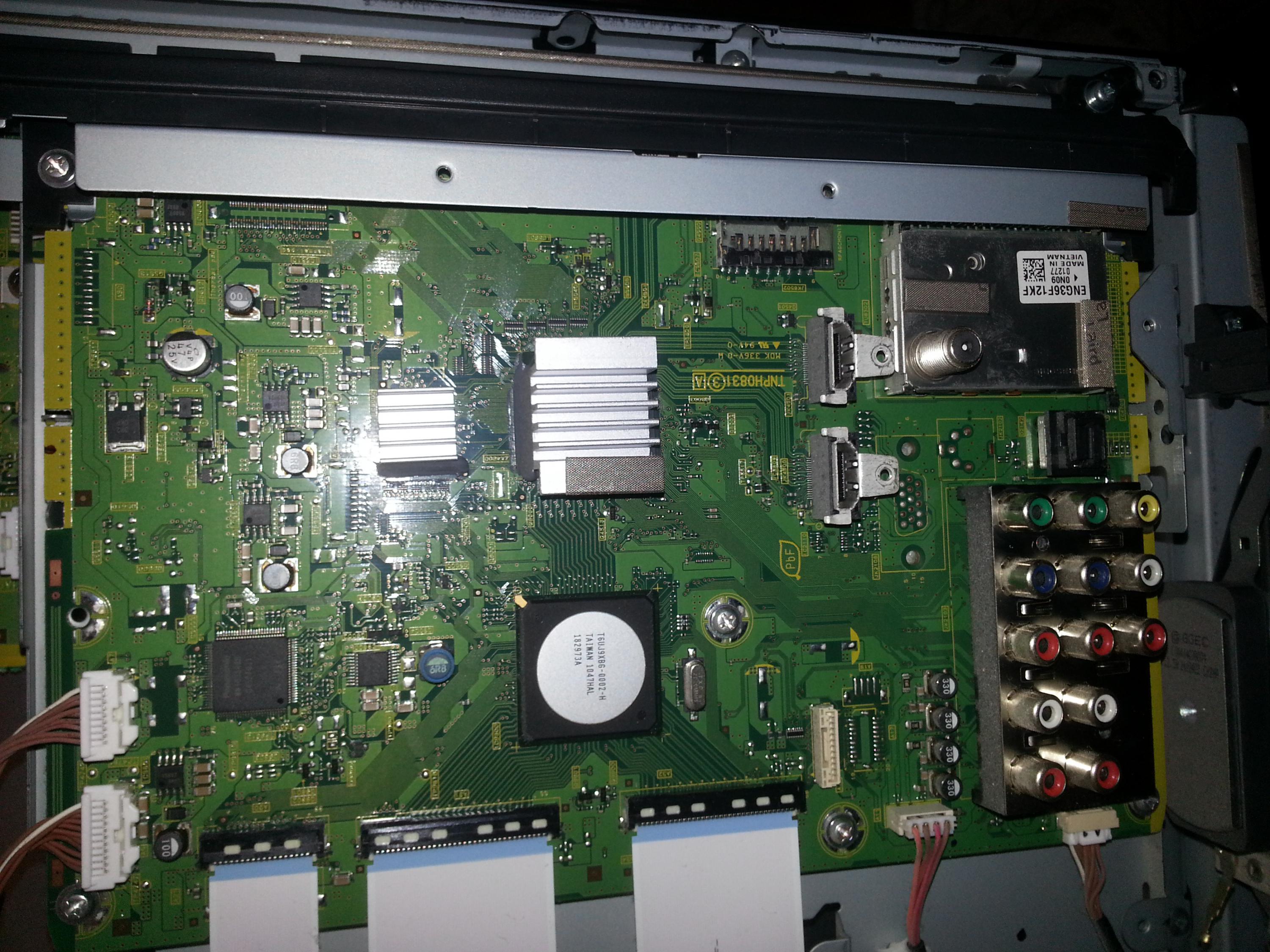

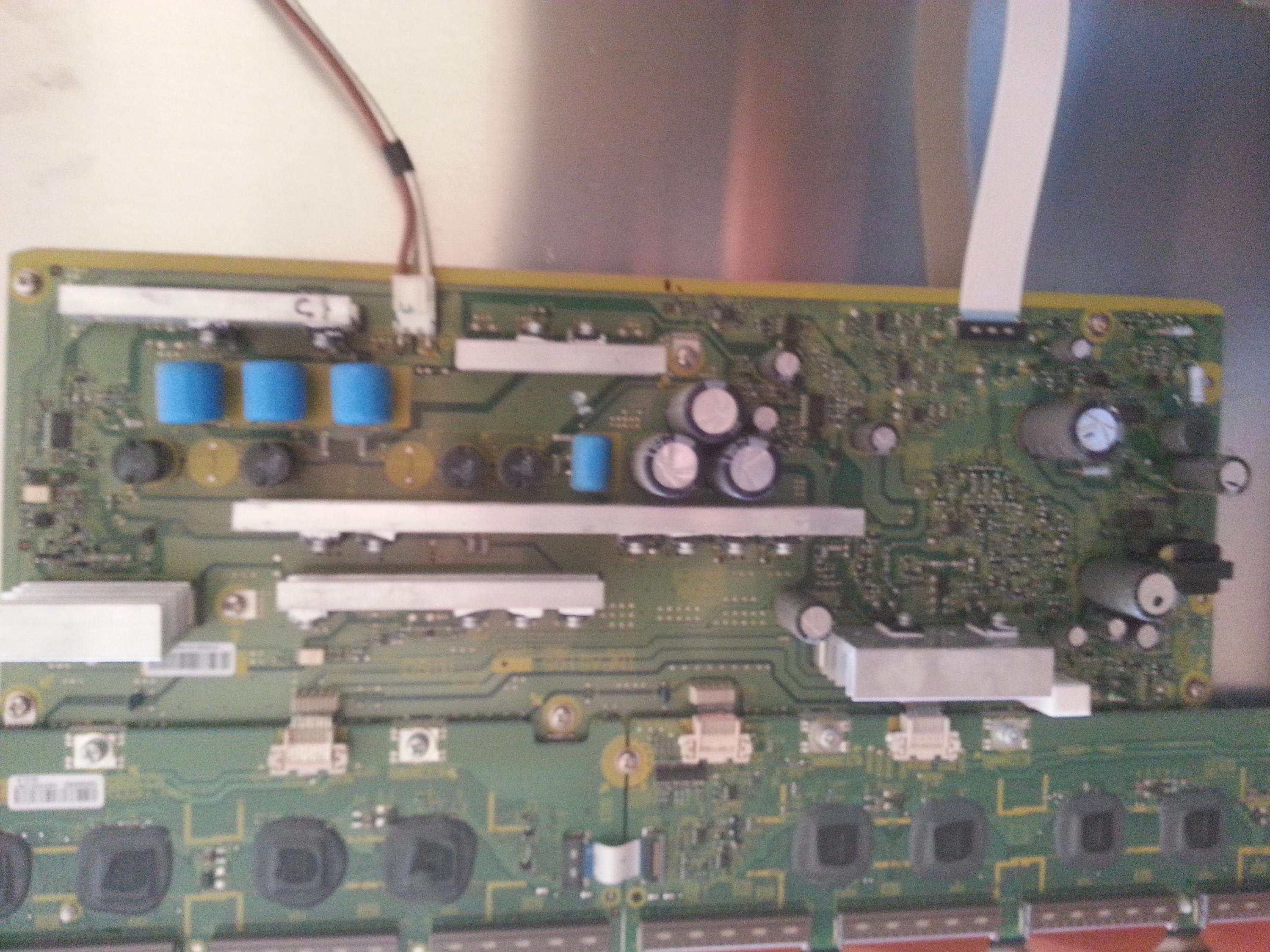

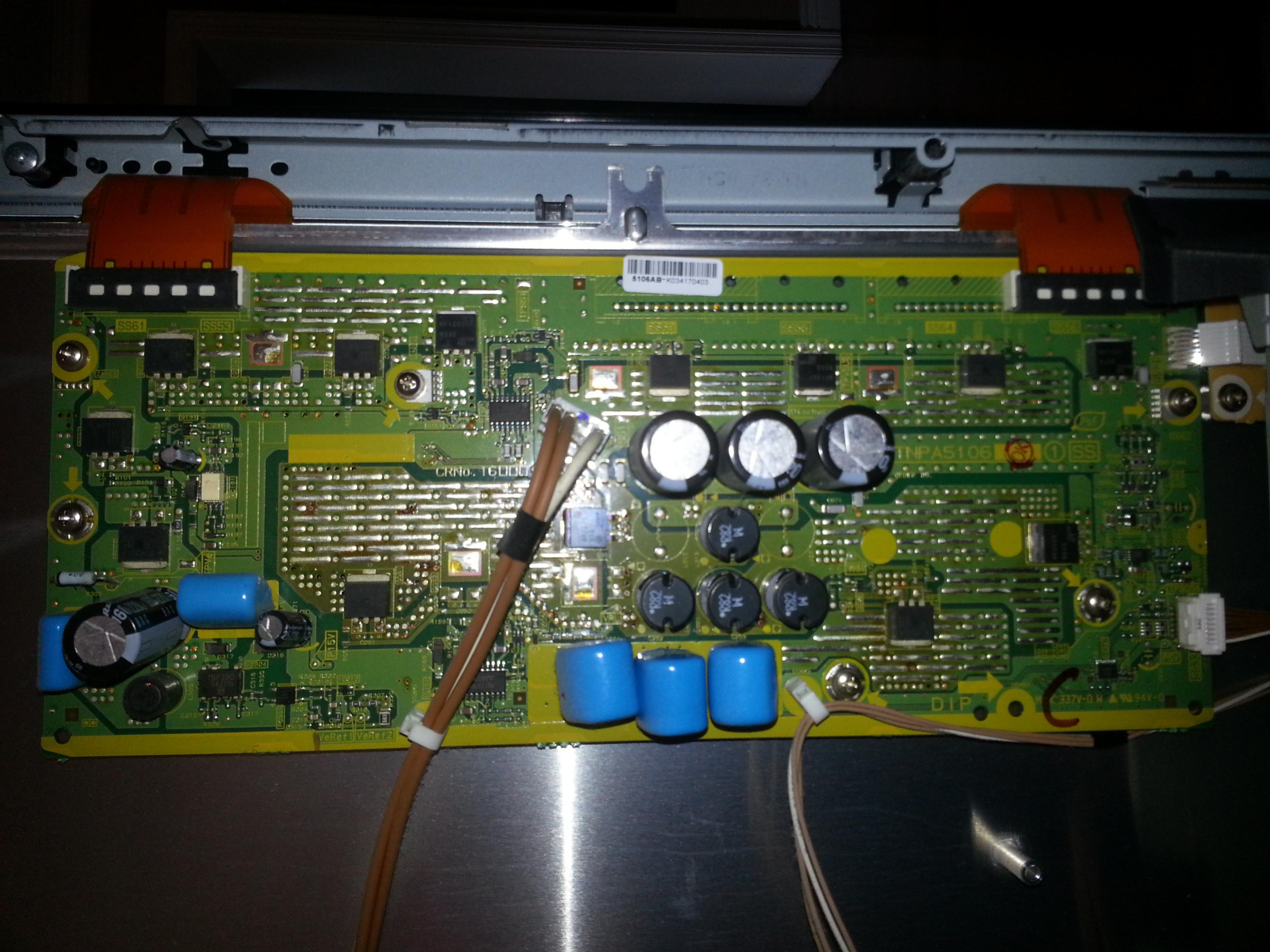

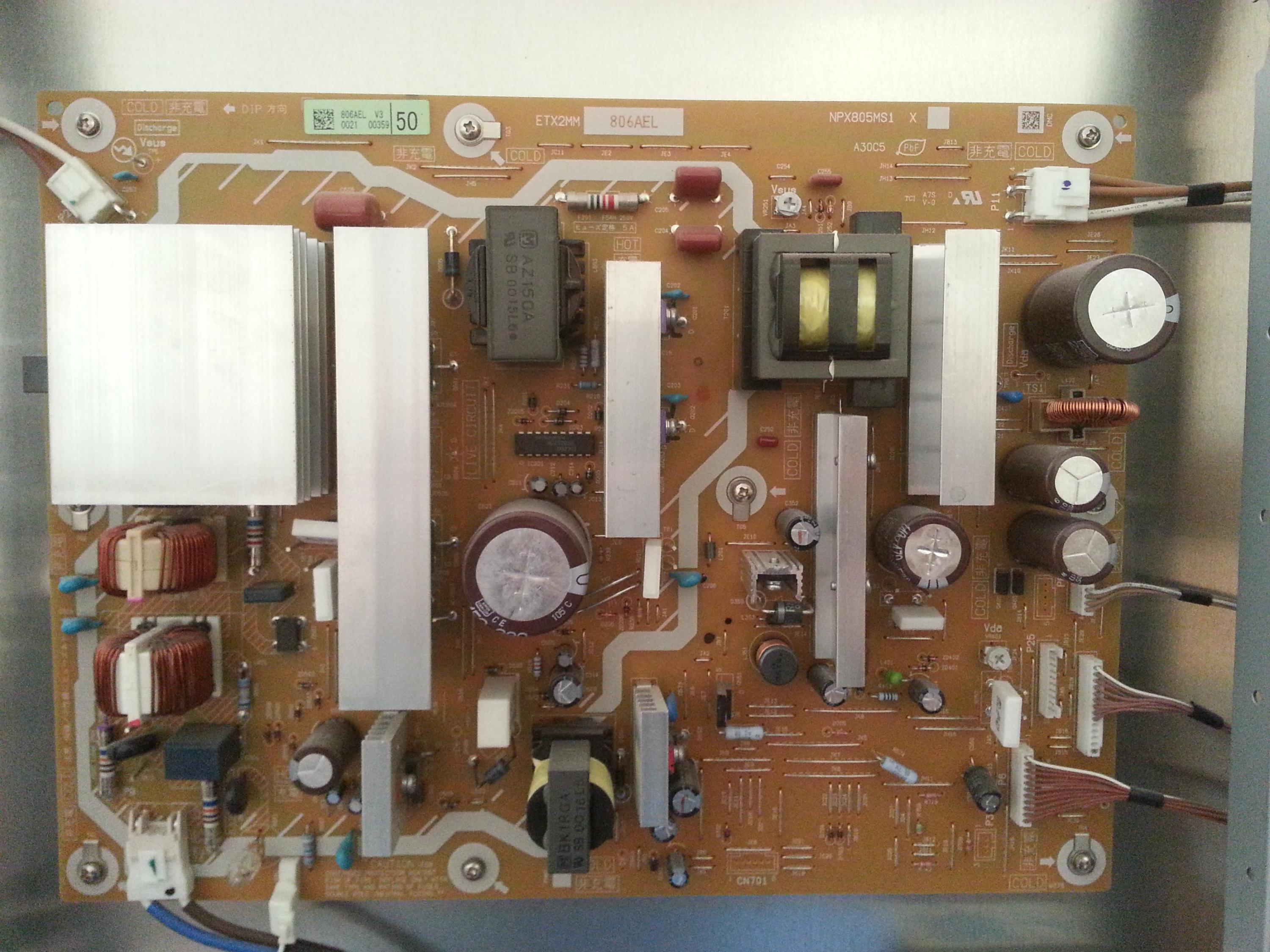

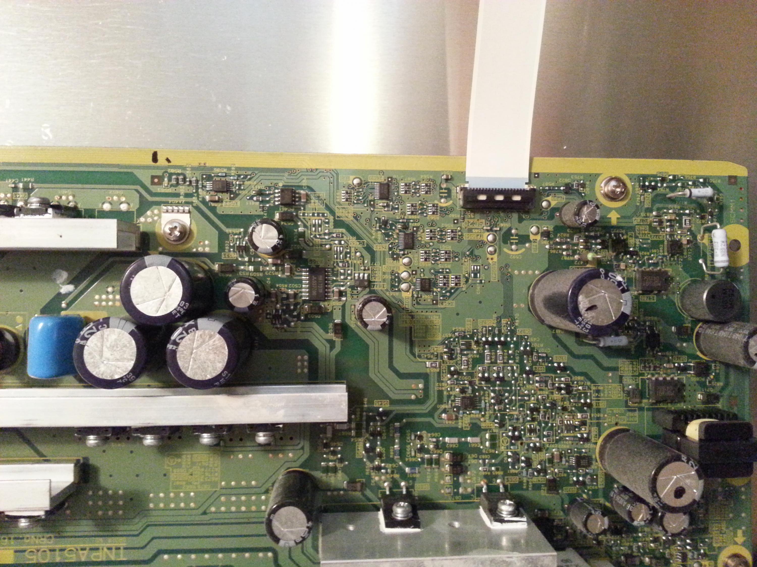

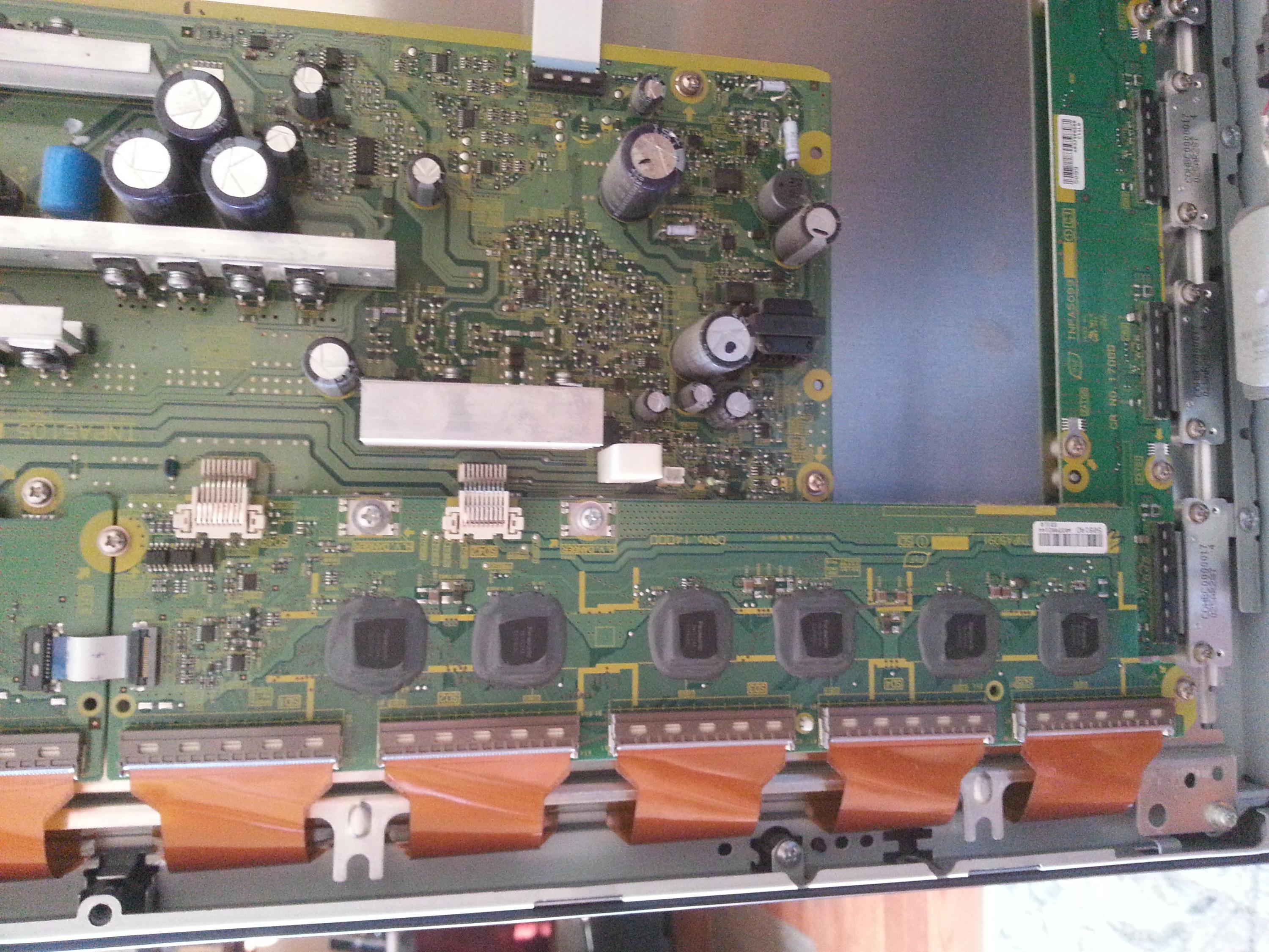

                Here are pictures of the board's inside the housing. I do not know what each one is called
                • rlhowelljr
                  • Apr 2014
                  • 30
                    From the left
                    P board, SS board, A board, SC board (with SU+SD boards below), SU board (with SC board above)

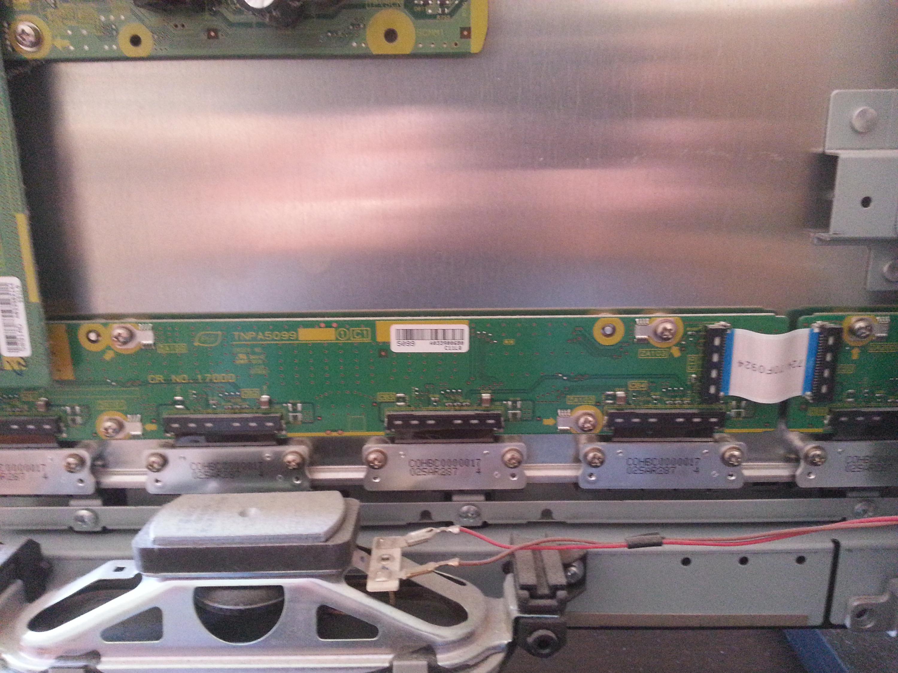

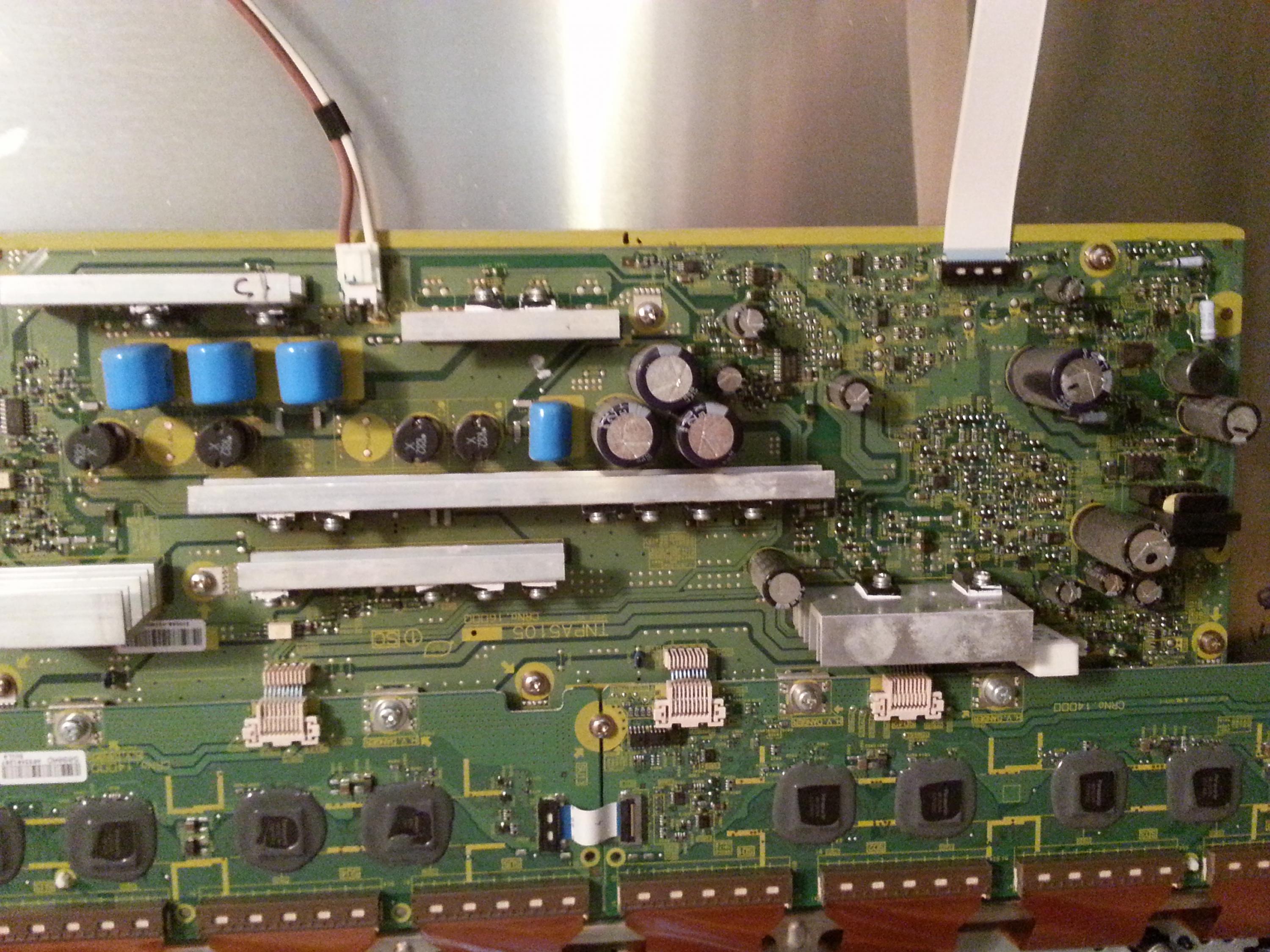

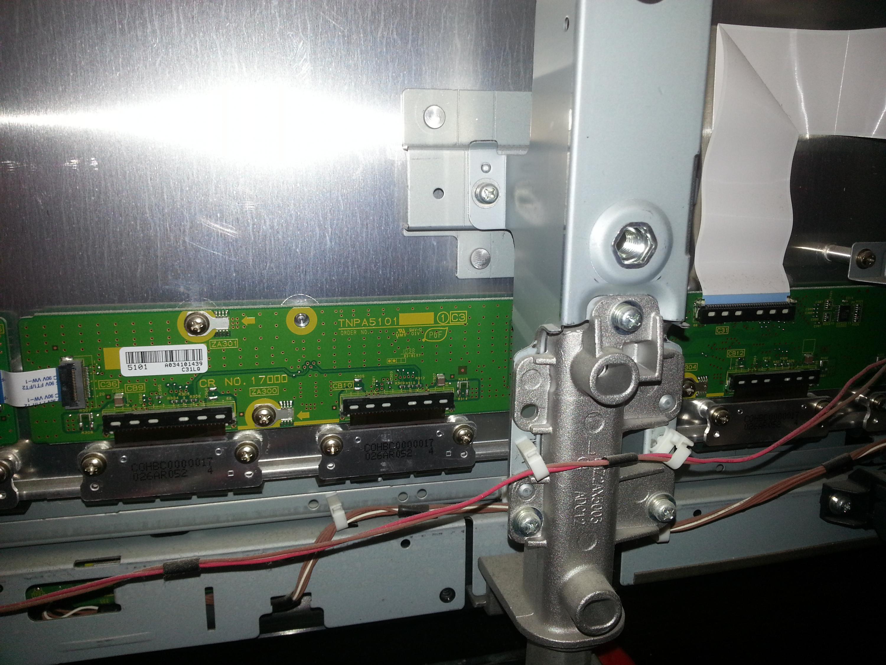

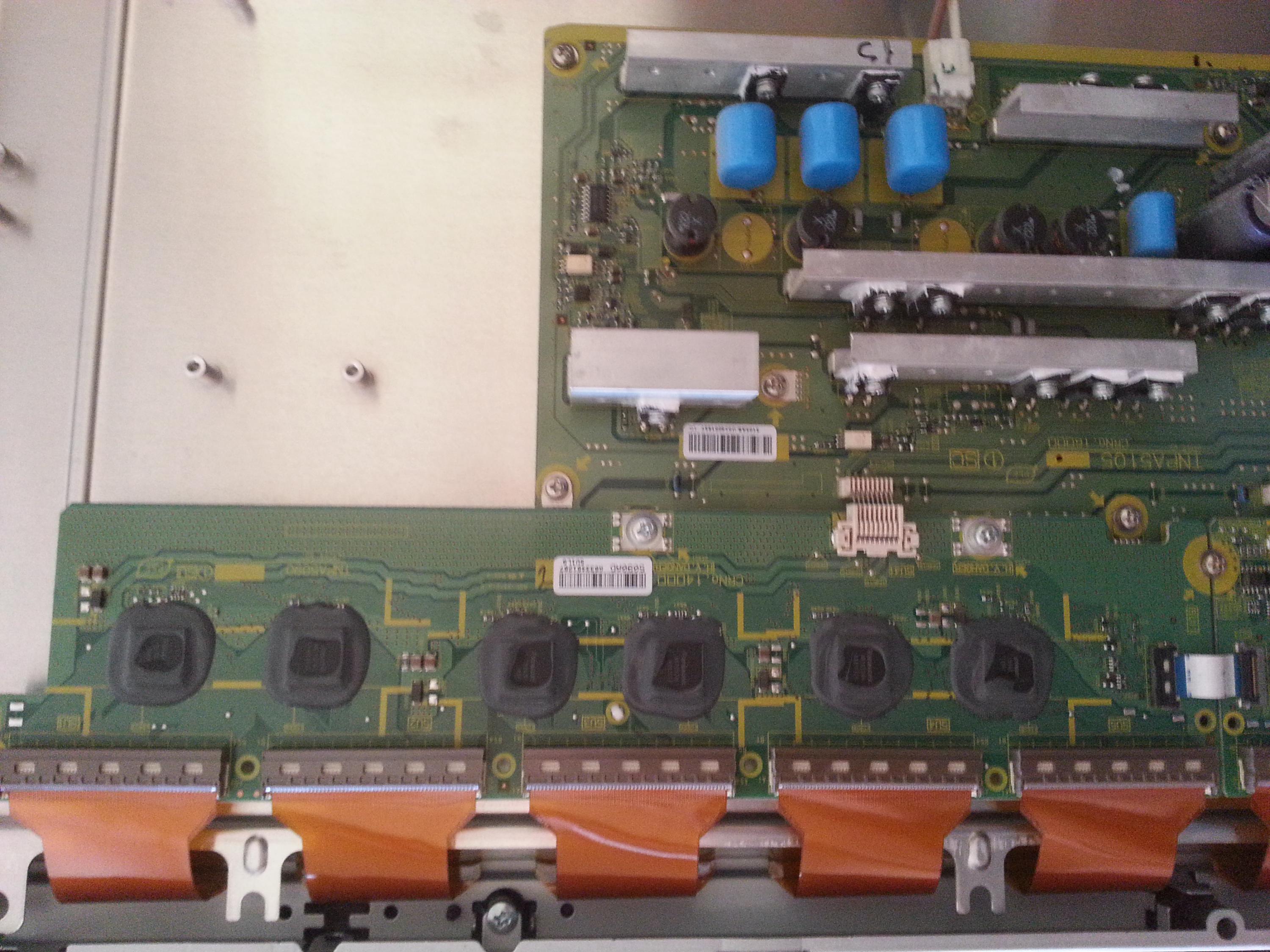

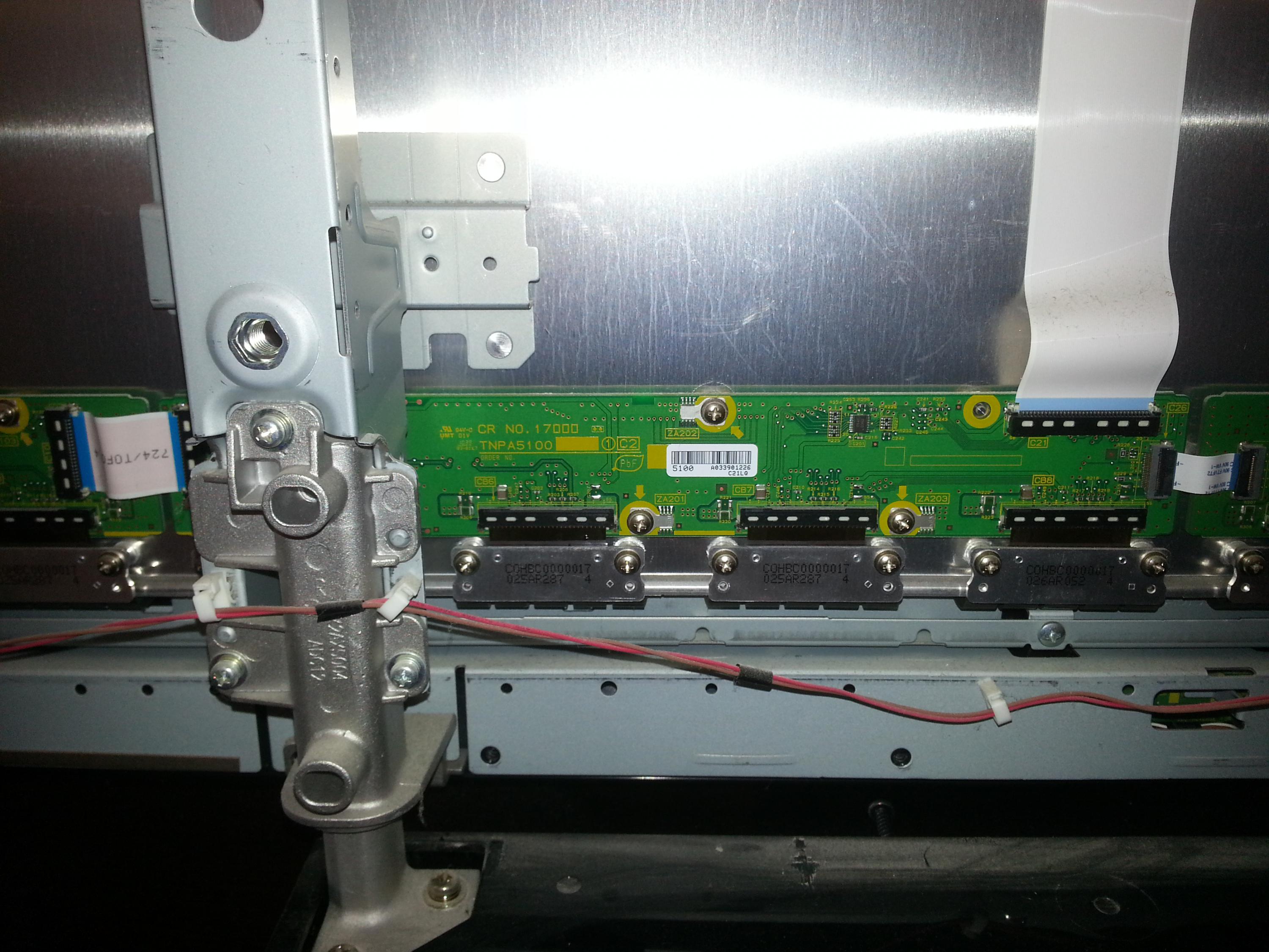

                      Picture 2
                        SD board, and C1, C2, C3 boards.
                            I don't see anything obviously wrong. Is there a starting point that I should begin with?

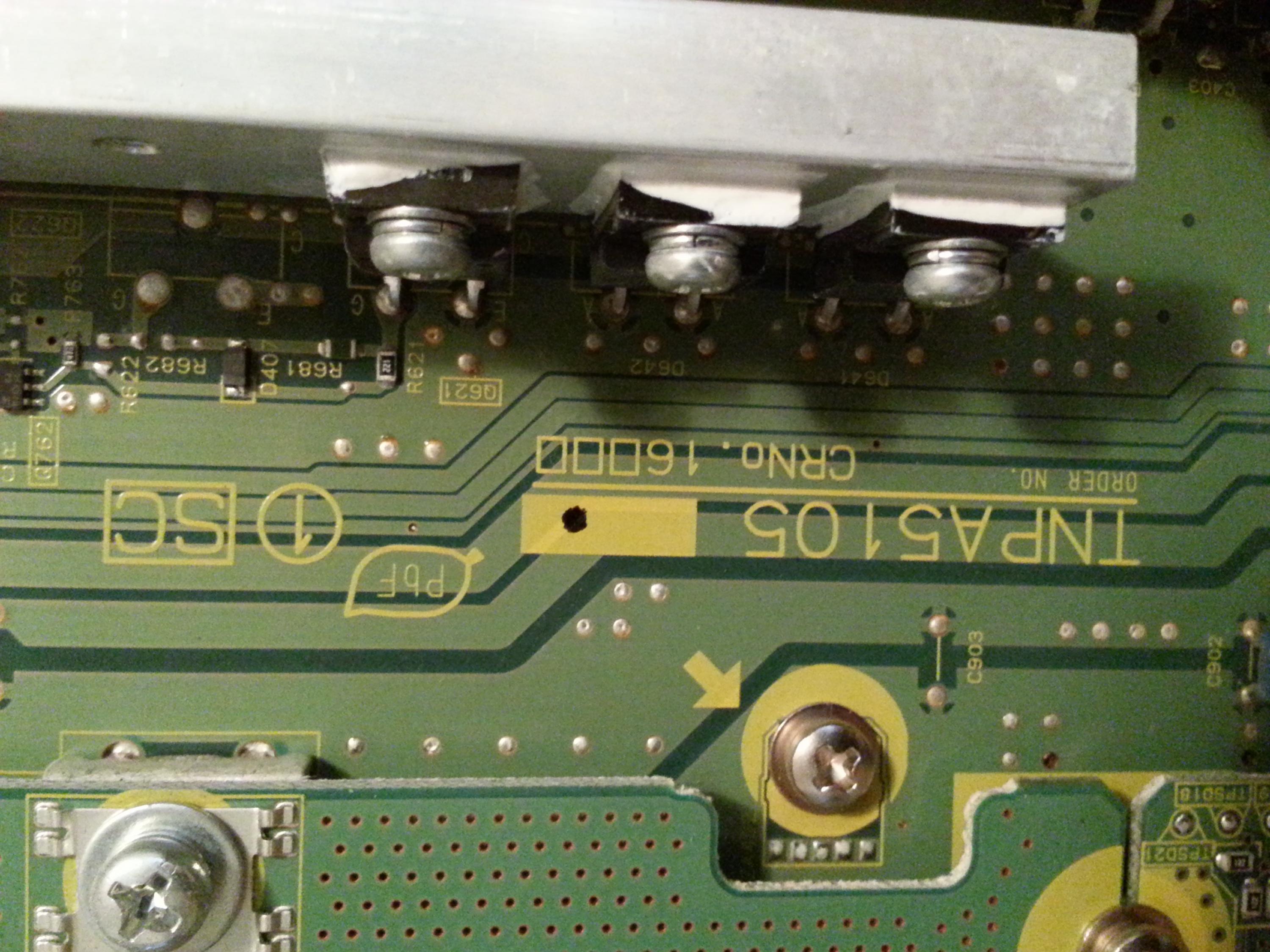

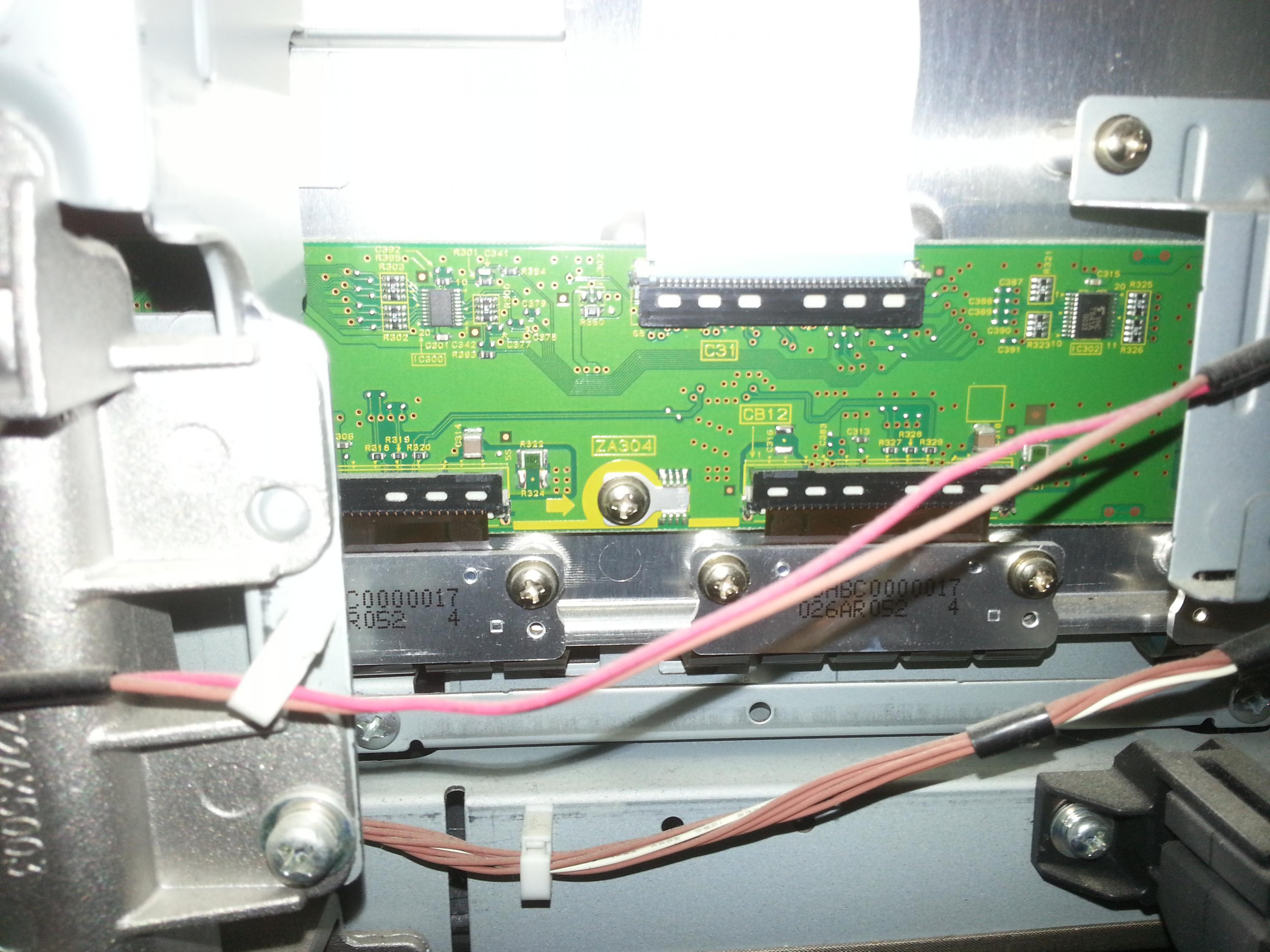

                                  I can get the problem to occur and clear by heating or cooling this section of the SC board.
                                    Not certain on which that part is but it looks like the VSET or INIT-F generation which could cause this fault.
                                    • rlhowelljr
                                      • Apr 2014
                                      • 30
                                      It is on this board. I think it is the SC. I have no idea what a VSET or INIT-F is.
                                        Yes I'm aware of that, the problem is it's probably going to be down to a very small component in that circuit so locating it will be hard. You would probably require an oscilloscope.
                                        Maybe the best bet for you is to locate a replacement board since you've narrowed the fault down to one board.
