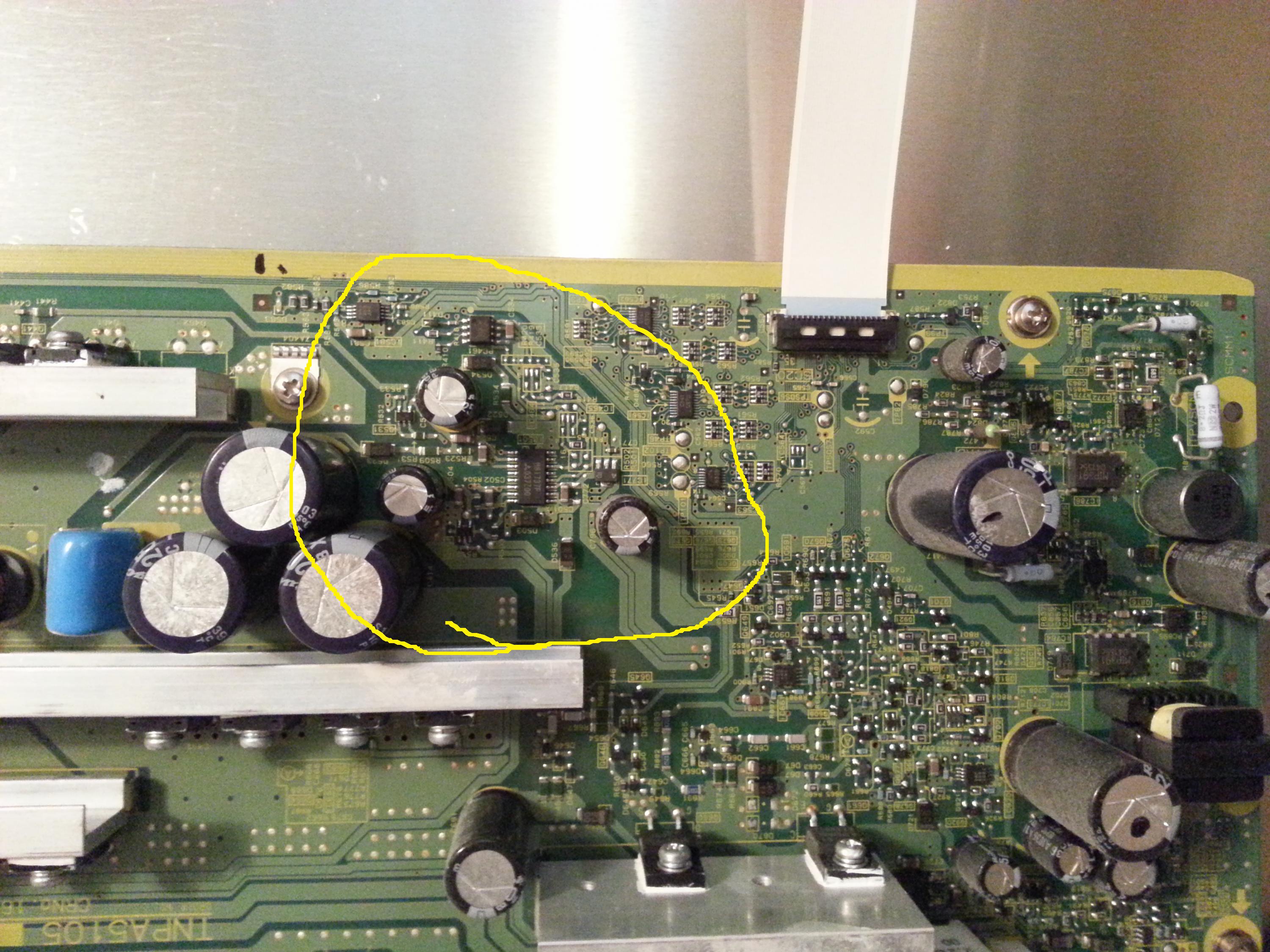

    There is probably a small lytic around the set-up ramp generator responsible for setting the ramp timing, or a ceramic cap. For a failure that would be my bet but locating it could be hard without a scope.

      Slang for "electrolytic capacitor" - the tall things all over the board. They are frequent failures in consumer electronics, although it's rare to find a bad one in a Panasonic as they typically well overspec them.

          That cannot be ruled out, possibly the set-up MOSFET could fail causing other problems, though it is likely to be repairable if you eventually source a new SC board.

            there are 3 small capacitors in the area I heated and cooled to initiate the fault. would they be the suspect?

              Can you highlight them and possibly include the "REFDES" of the capacitor. This is the text like e.g. C958 printed next to the capacitor on the board. The schematic can be checked to see if they might cause this problem.

                this is the area that seemed to cause the fault.

                  I will have to take the back off again to get better pictures of the "REFDES" (wife was getting grouchy about the repair shop in her living room)

                      There should be no adjustments required if it is an exact replacement board.

                                Something you can try for free if you haven't already is to snug down all screws that mount the sc and ss boards. Some of the newer Panasonic plasmas have sc and ss board failures that start with loose mounting screws.

                                      I got the board yesterday afternoon. It was very easy to install, and the picture is perfect.
