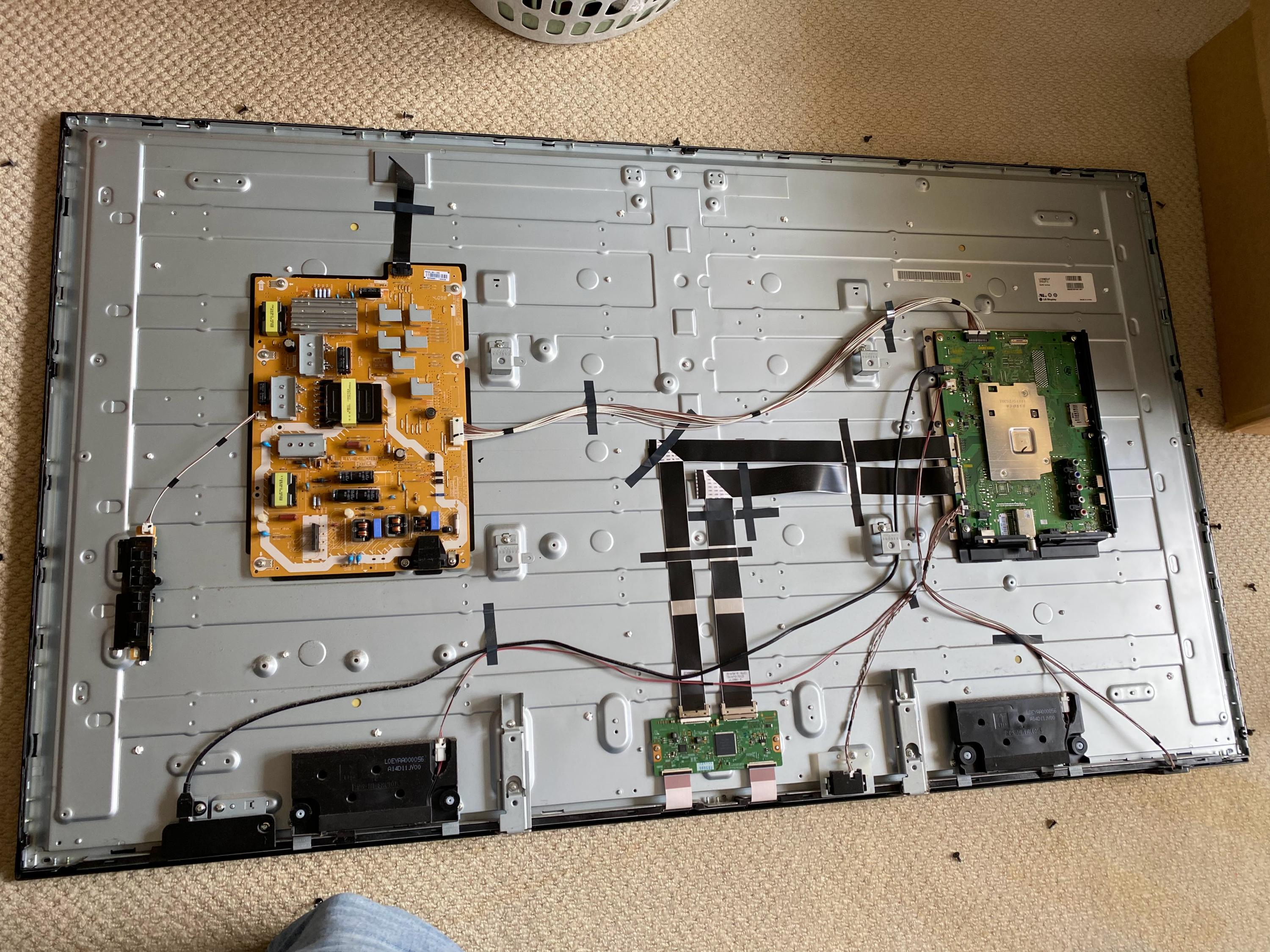

    I've tried a couple of things before tearing it apart:
    * Resetting using various combinations of powerbutton and volume buttons pressing down while booting.
    * Activating Self Check according to service manual using IR Blaster (we have no remote unfortunately)

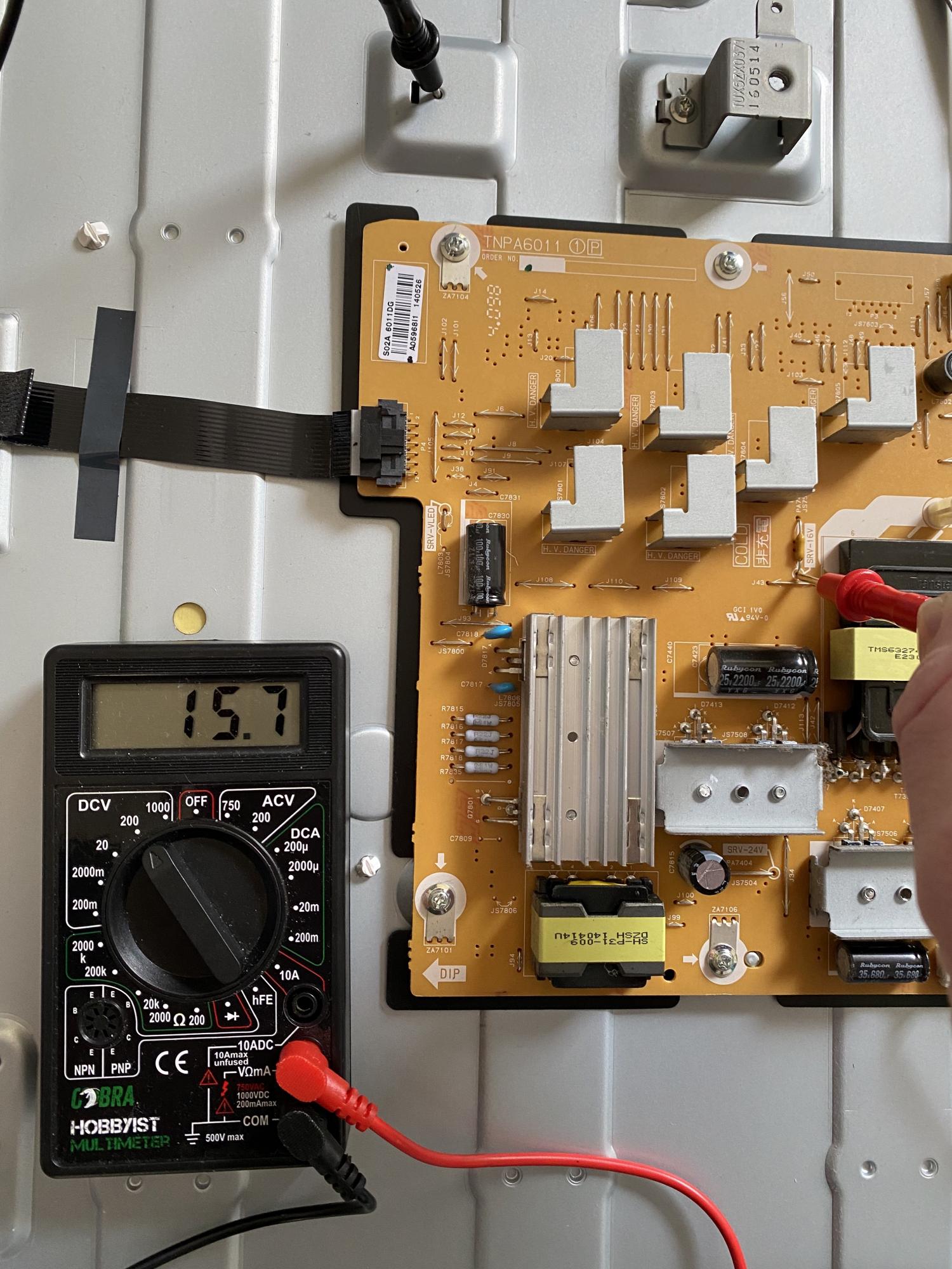

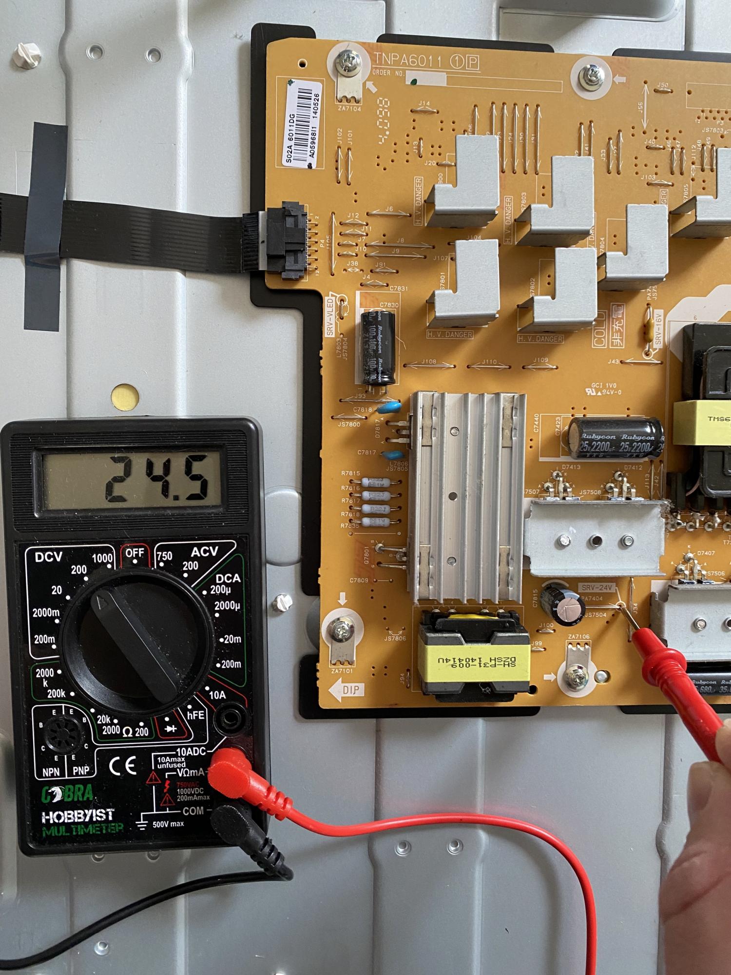

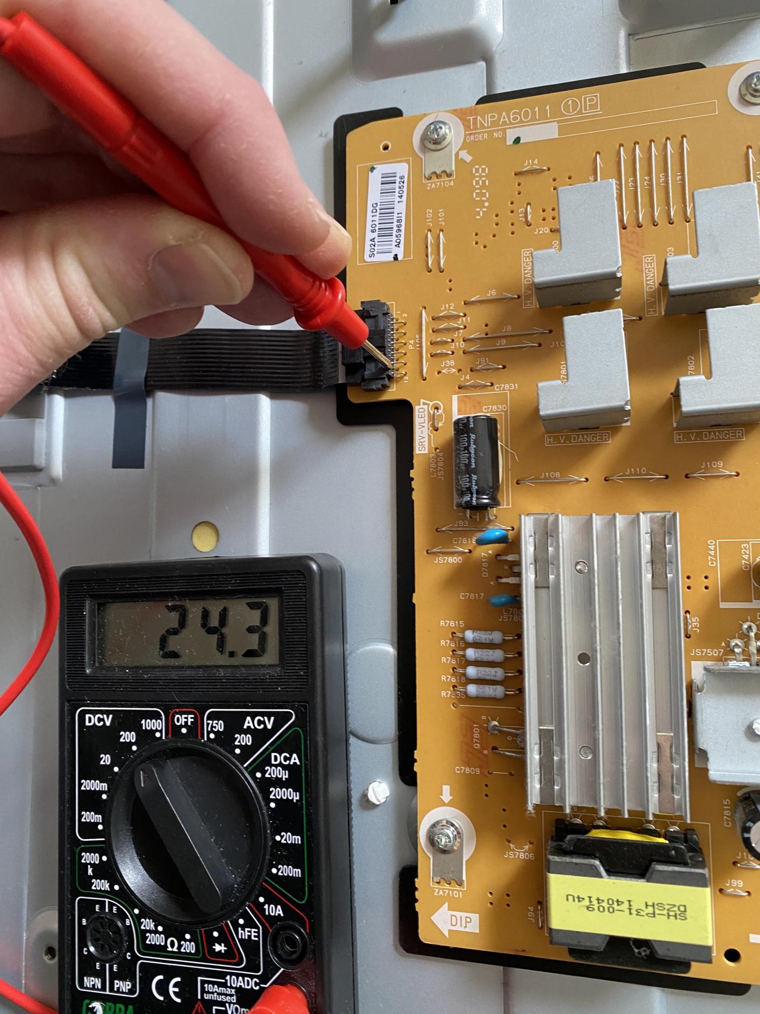

    At that point I decided to open up the back cover. Measuring the basic Testpoints I was able to find:

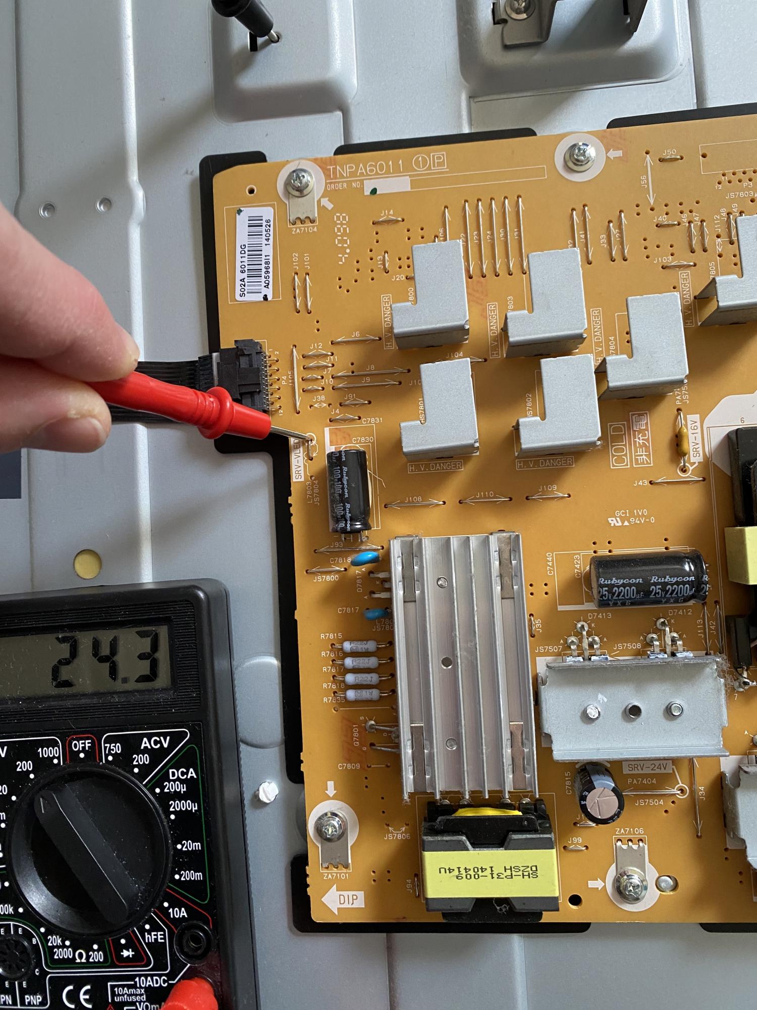

    * All test points on the P Board seemed okay, the LED Backlight is getting 24V for each strip (6 in total)
    * On the A Board all test points are fine except the 12V, which shows 0V
    * I also went ahead (because I had some spare time) to tear apart more and test the LED Backlight strips using my 21V power supply, and I was able to light them up all individually (12x for 7 LED's)
    That means, there must be something wrong with either the P or A board or TCON board. But at this point I'm not sure what should be my next step before I try to order and replace any of the boards.

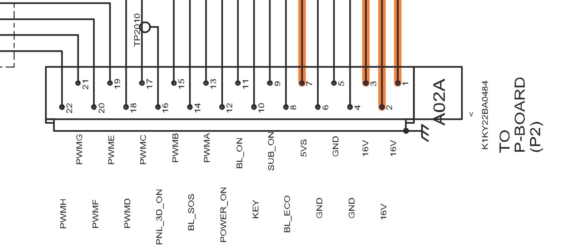

      Can you post a clear focused picture of the legend/map with expected voltages by the connector on powerboard or list it if you can't get a clear picture, check optical output/toslink port on mainboard, is it lit red?

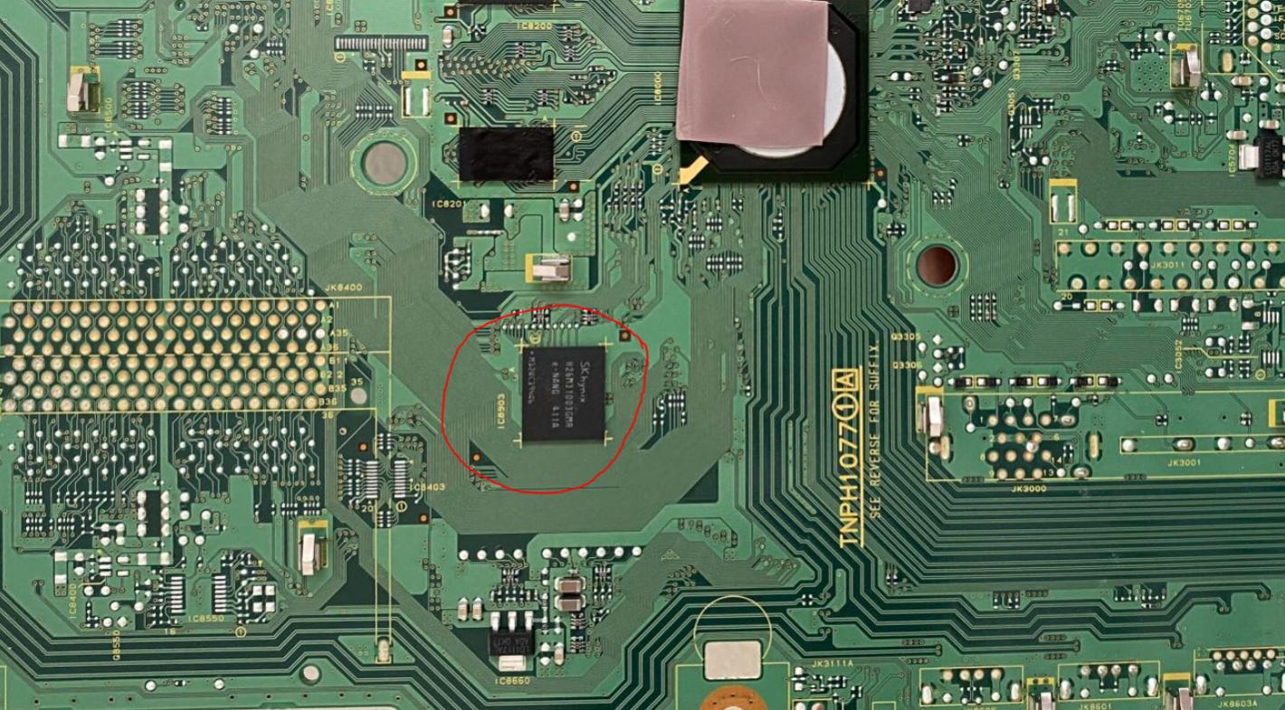

          "Shows flashing red LED with code 13" - this is a problem with the eMMC where the firmware is located.
            not sure where to find this legend map? the toslink optical output is not lit red, so are the USB Ports also not providing any power (when connecting my google chromecast)
              ok, sounds like this is not repairable unless i replace the whole board?

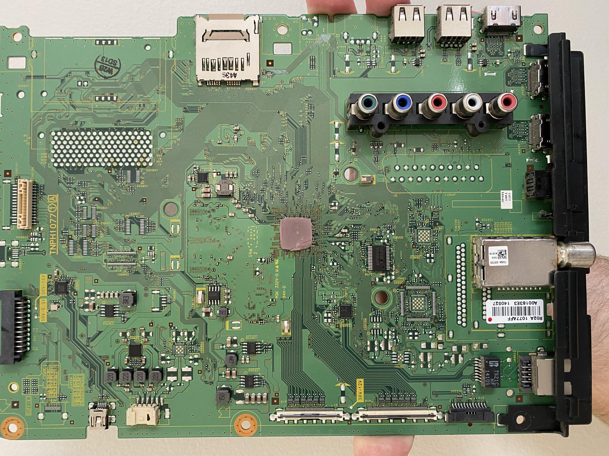

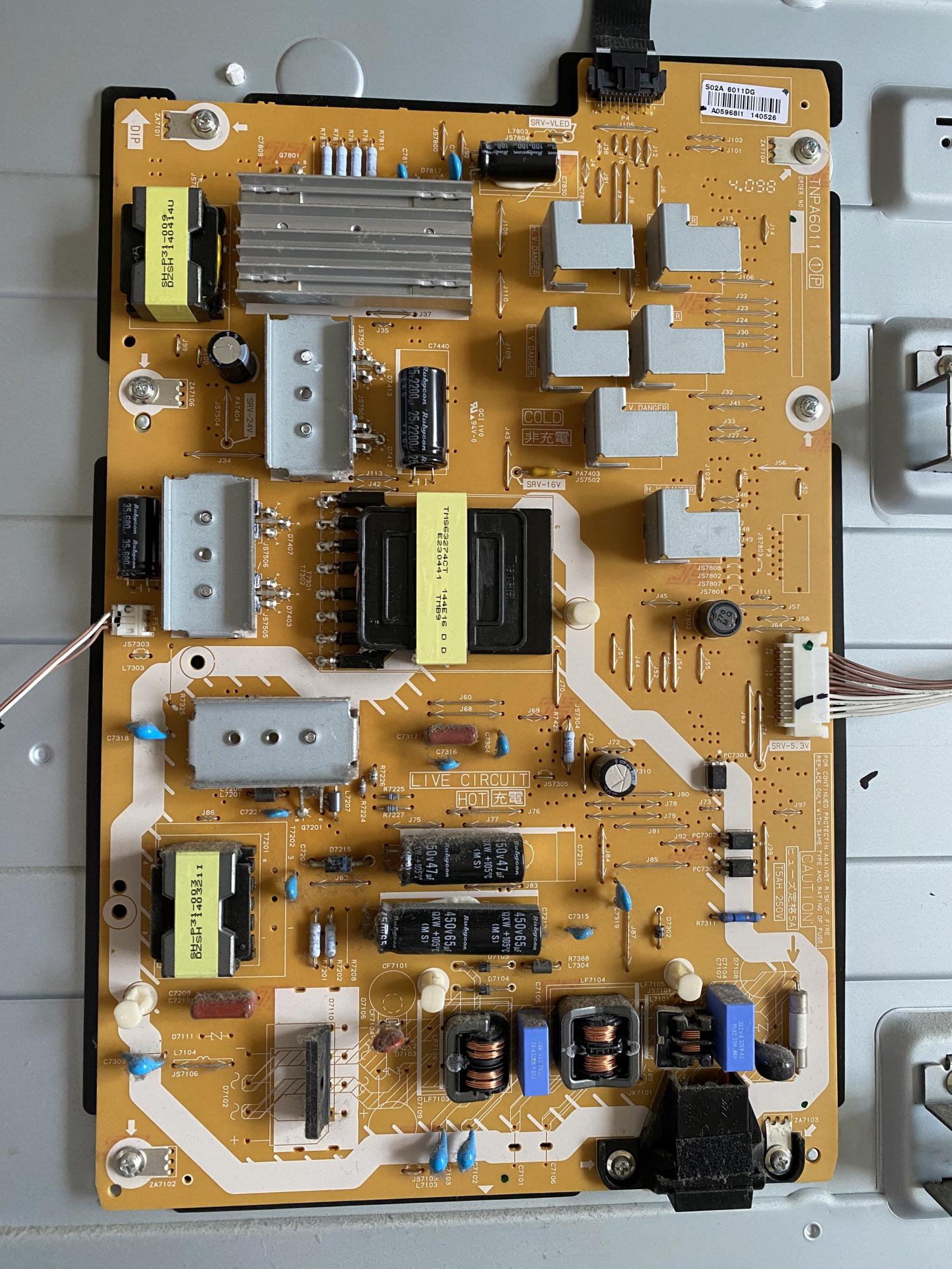

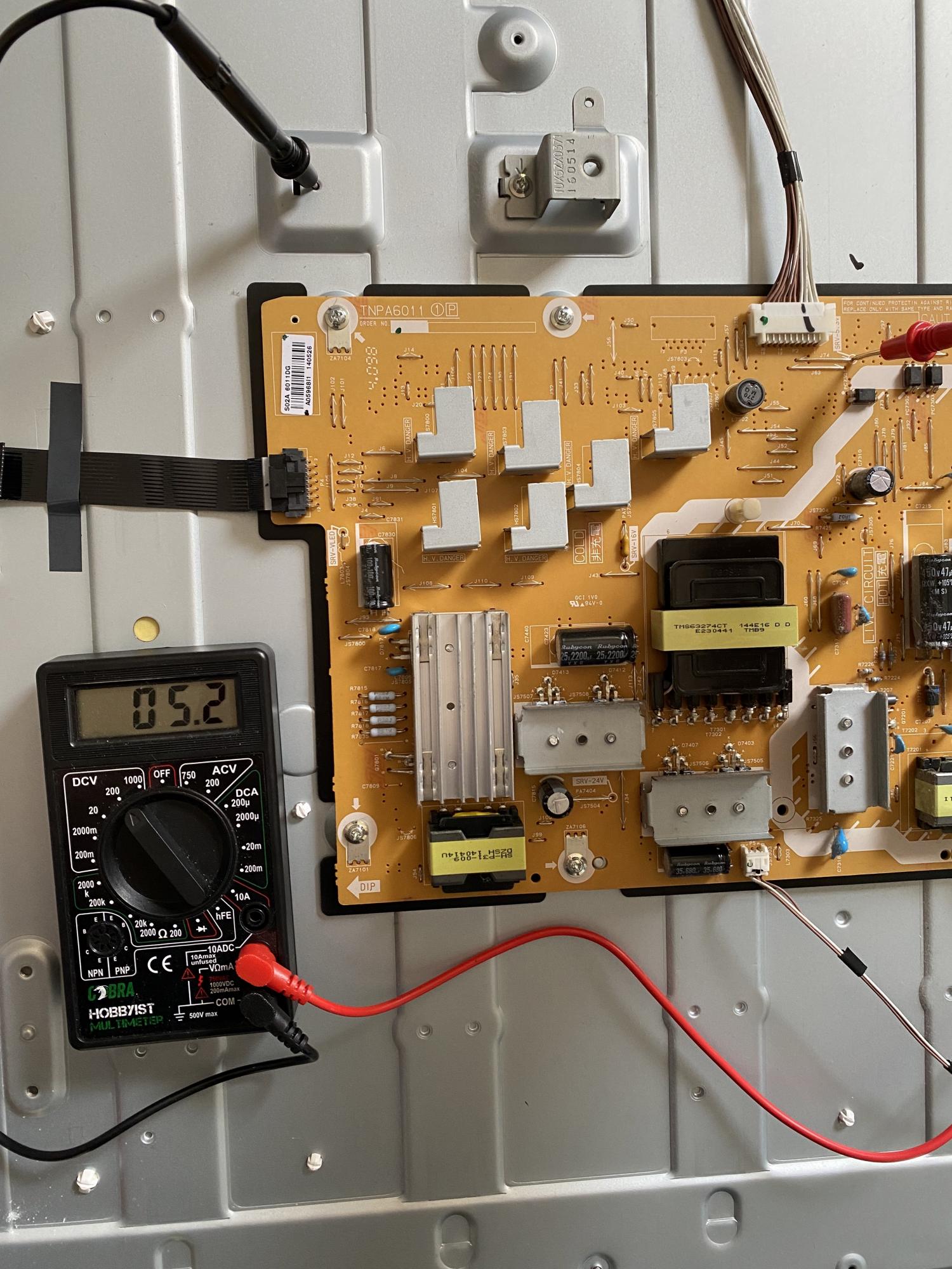

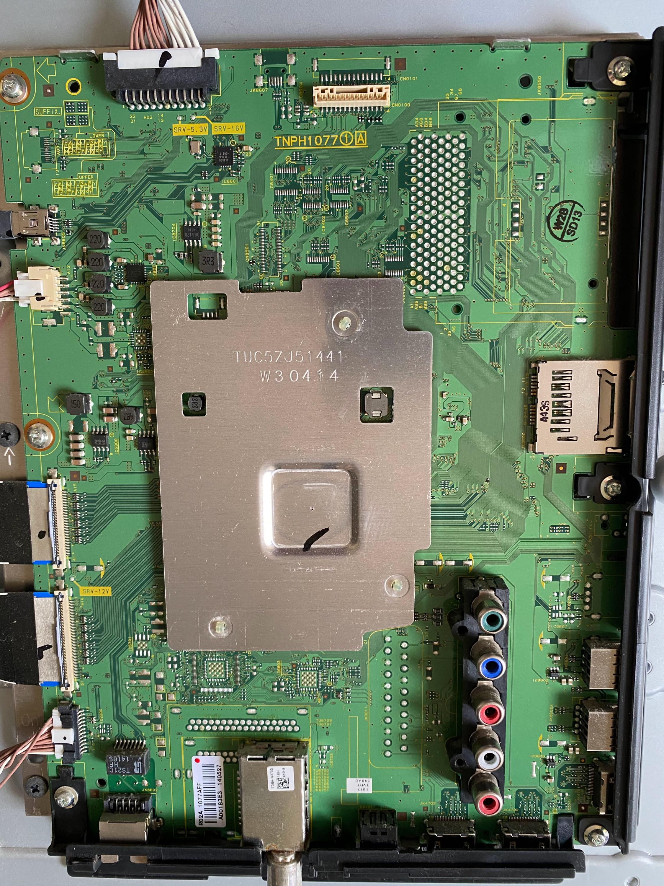

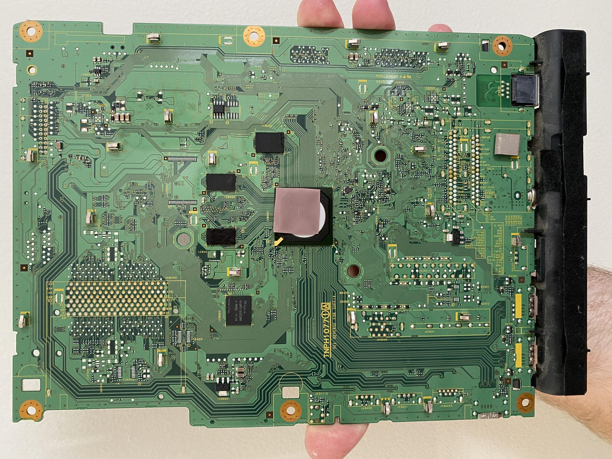

                    Re: Panasonic TH-55AS670A no picture no sound
                    There is also no voltage on the SRV-12V testpoint. The other two testpoints show 5.3V and 16V each.
                    I took out the board for you to see maybe any obvious faults.

                      Maybe Lotus can tell you how to test to make sure it's eMMC problem if possible, I can not recall the procedure.
                        Replacement with a new one with clean service firmware.
                            Sorry I think I know what you meant by now.
                            I've measured the following voltages on the connector of the mainboard (A Board):
                            Pin 1: 15.7V (16V)
                            Pin 2: 15.7V (16V)
                            Pin 3: 15.7V (16V)
                            Pin 4: 0 (GND)
                            Pin 5: 0 (GND)
                            Pin 6: 0 (GND)
                            Pin 7: 5.2V (5VS)
                            Pin 8: 0 (BL_ECO)
                            Pin 9: 3.3V (SUB_ON)
                            Pin 10: 3.3V (KEY)
                            Pin 11: 0 (BL_ON)
                            Pin 12: 3.3V (POWER_ON)
                            Pin 13: 0 (PWMA)
                            Pin 14: 3.3V (BL_SOS)
                            Pin 15: 0 (PWMB)
                            Pin 16 0 (PNL_3D_ON)
                            Pin 17: 0 (PWMC)
                            Pin 18: 0 (PWMD)
                            Pin 19: 0 (PWME
                            Pin 20: 0 (PWMF)
                            Pin 21: 0 (PWMG)
                            Pin 22: 0 (PWMH)
                            So that means I'm getting BL_SOS although I've check my LED strips individually and can confirm they are working. Must be something in between or a bad connection somewhere?
