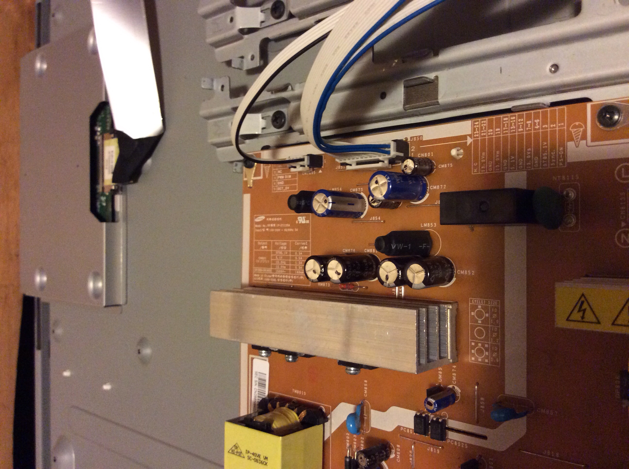

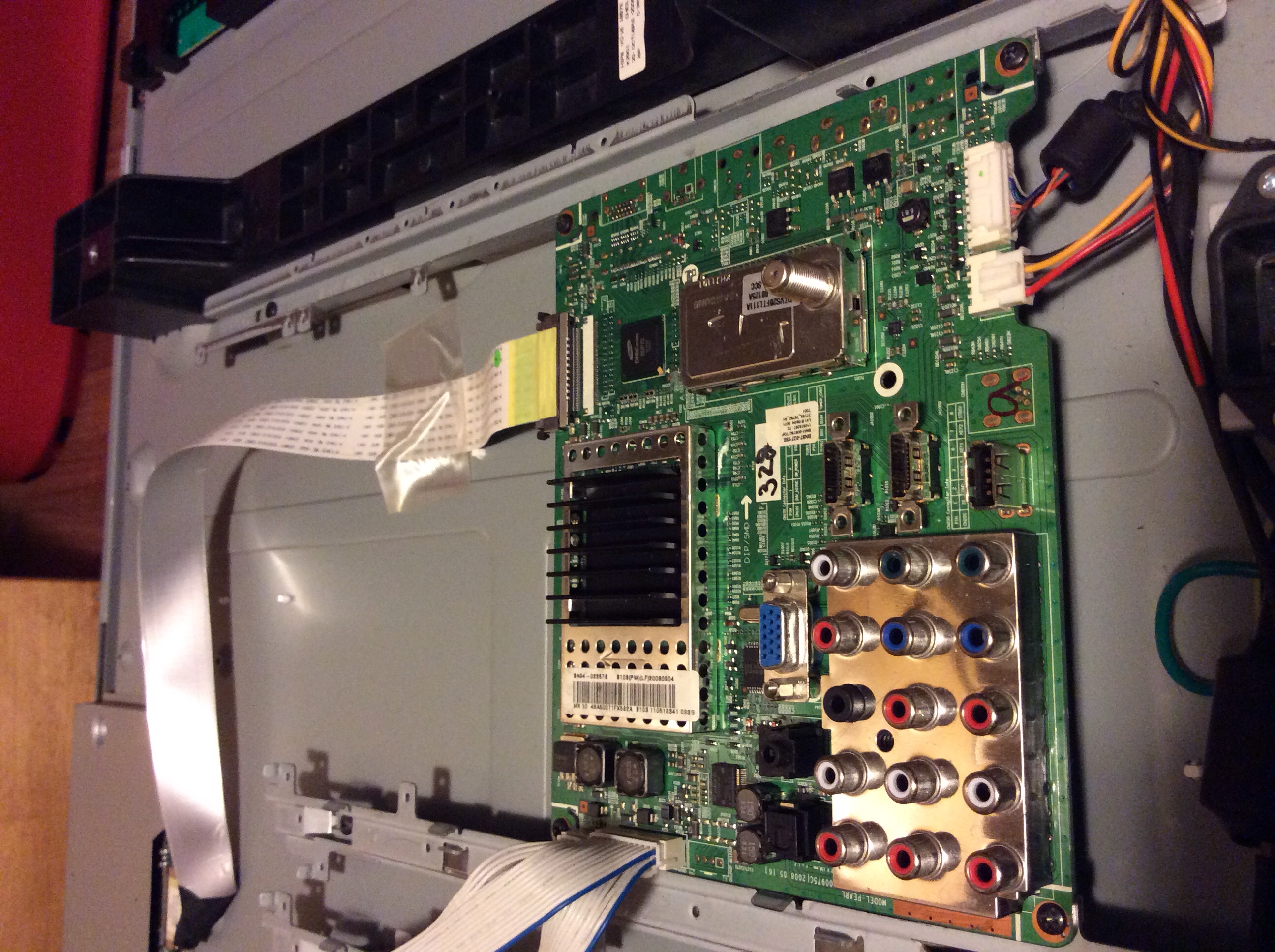

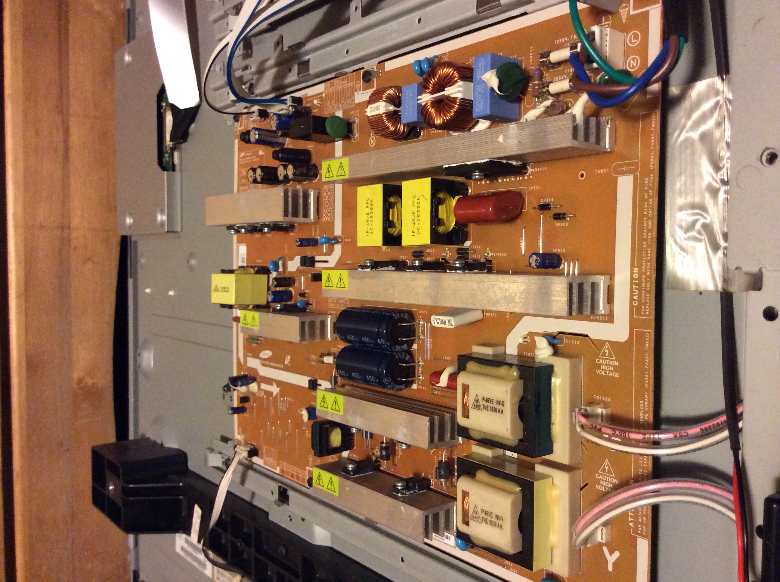

    Hi guys, my TV has been doing the turn on off thing when I go to boot it up. Can here it clicking and I get display eventually but it's messed up for about many tries and eventually I get a working picture. Some times it comes up fine and soon as I try using the remote it reboots others I get scramble or discoloured picture... Thought it was the main board but replaced it and it still is doing the same thing. Looked at the caps none are leaking or bulged. I was thinking maybe I should test the power section before buying new caps and not fixing the problem?
    Power board is the ip-271135a aka the bn44-00202a how would I go about that exactly?

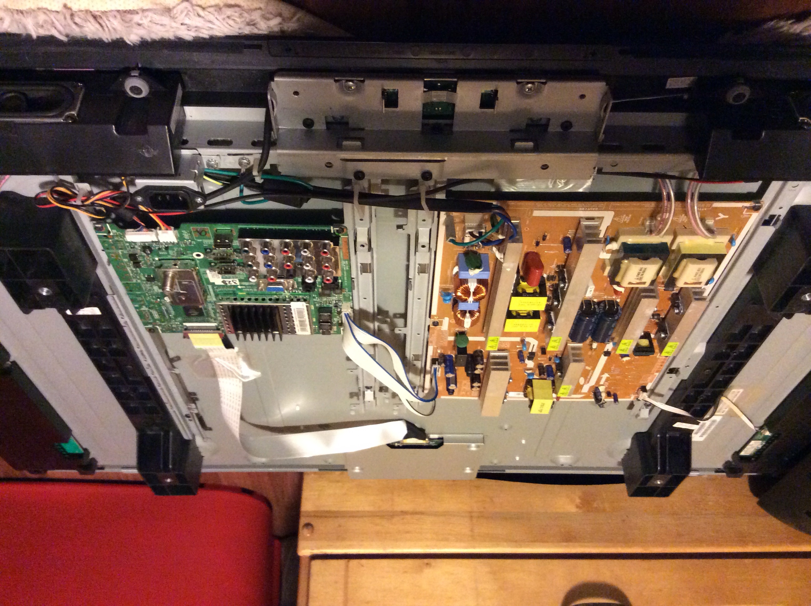

    Re: LN46a500T1FXZAA with seeming broken power board
    Post good clear pictures of the boards and the whole back of the TV so we can see how the boards are connected will be a good start.
      Back of TV
        Power board
            Main board
                              Hi Vowswithin:
                              Unless the power supply has visibly bulging capacitors in the secondary circuit, this does not sound like a power supply issue.
                              From your initial description, this sounds like a mainboard issue common to A-series Samsung LCD and plasma TVs.
                              You state that you had resets, and glitchy video, perhaps also accompanied with audio screeching?
                              You also state that you replaced the existing mainboard with a different mainboard. I suspect that both mainboards may have the same issue.
                              I think you need to replace C102 and C131 on mainboard, adjacent to white 24pin connector.
                              Both caps are polarized surface mount caps. C131 is on the top and C102 is on the bottom. Marking C131 easy to spot. Marking C102 may be difficult to find, but capacitor should be next to IC101.
                              Measure the voltage across the capacitors before removing the capacitors. They have a polarity marking, but it is opposite to what you think. The band indicates positive which is not consistent with other can type electrolytic capacitors. Installing electrolytic capacitors backwards by accident may cause them to blow up.
                              I think I used 47uF/50V caps.
                              See this thread for more information:
                              https://www.badcaps.net/forum/showth...ight=C102+C131
                              Also, you may not need to remove the bad capacitors C102 and C131. In my TV, it was sufficient to solder the new capacitors across the existing ones, and even makes it easier not to damage solder traces if you are not a good at soldering. NOTE THE CORRECT POLARITY!!
                                Maybe check DB803 and all the rest of the diodes.
