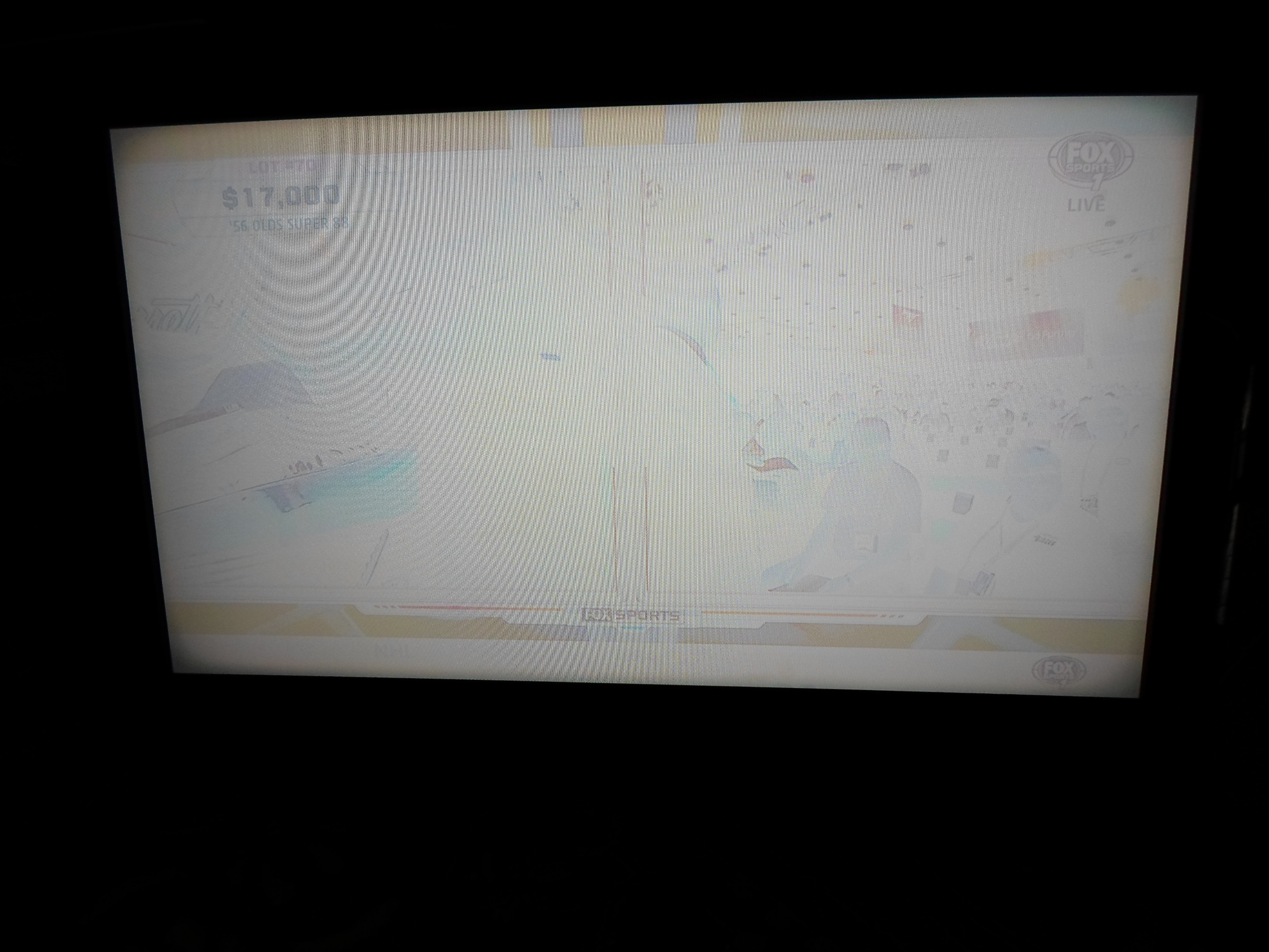

    There is picture and sound, however screen is bright white (The swirls are from the camera). Reset picture to default and factory reset does nothing. No T-Con board on this one. Bad panel?

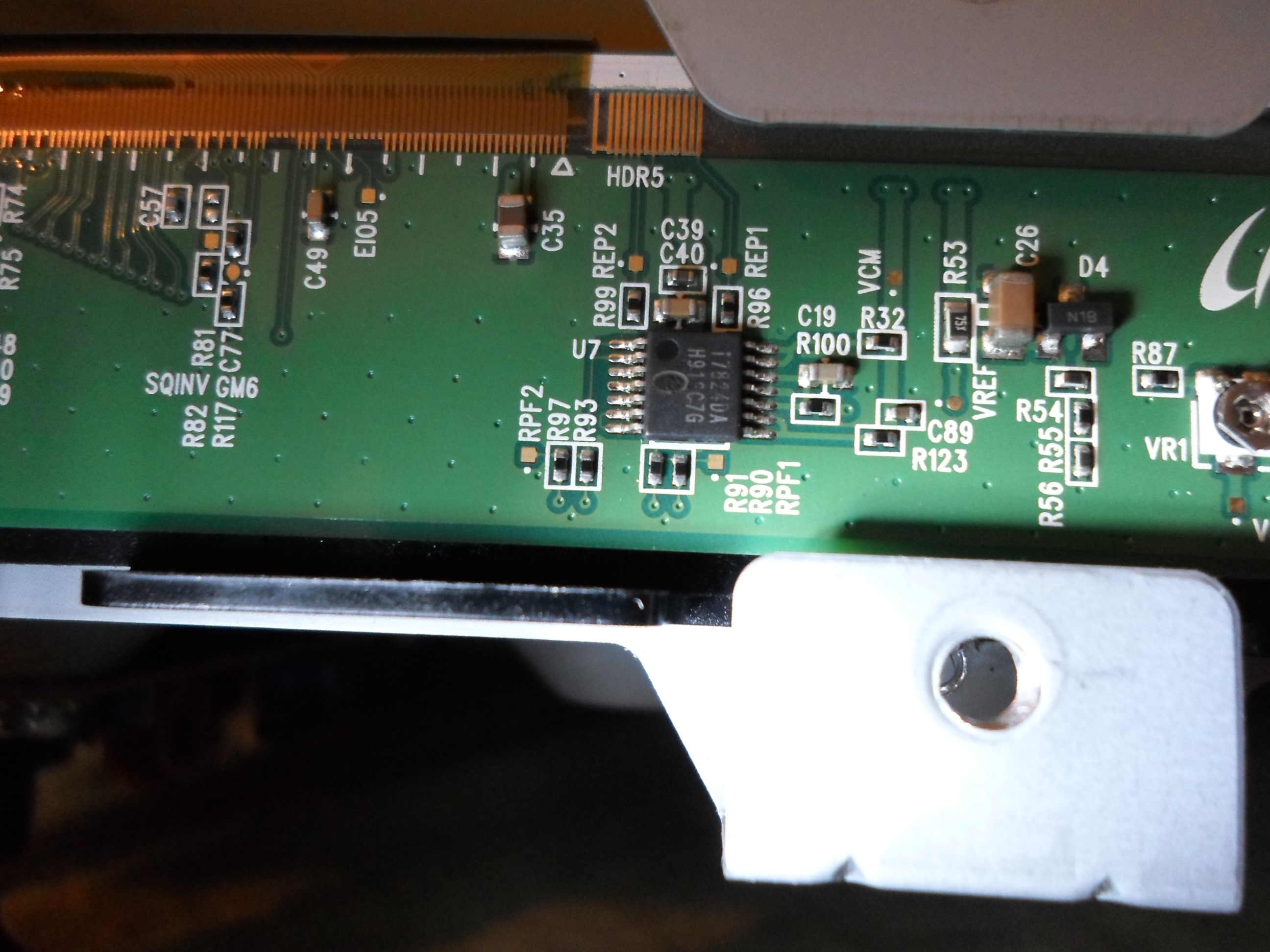

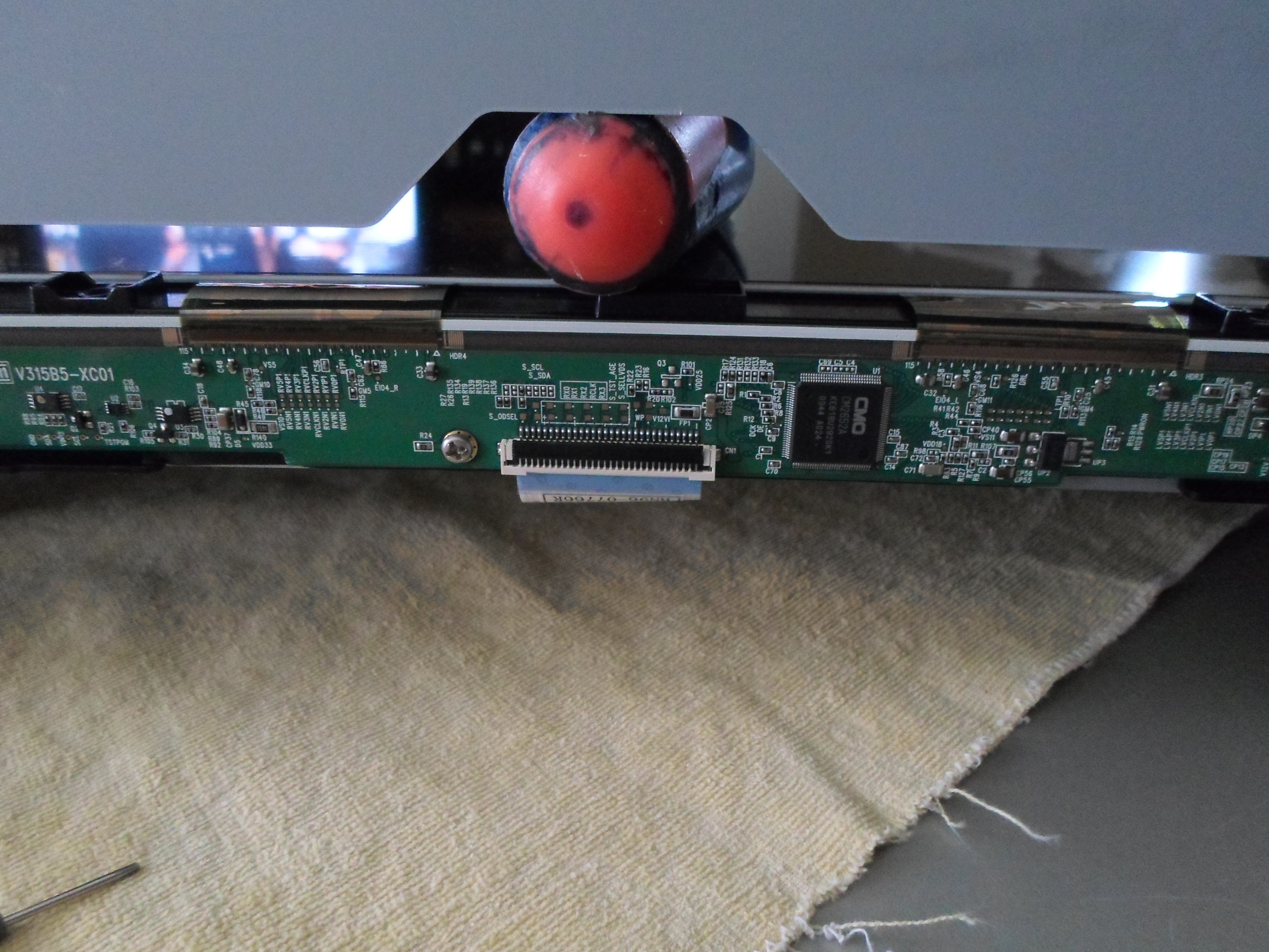

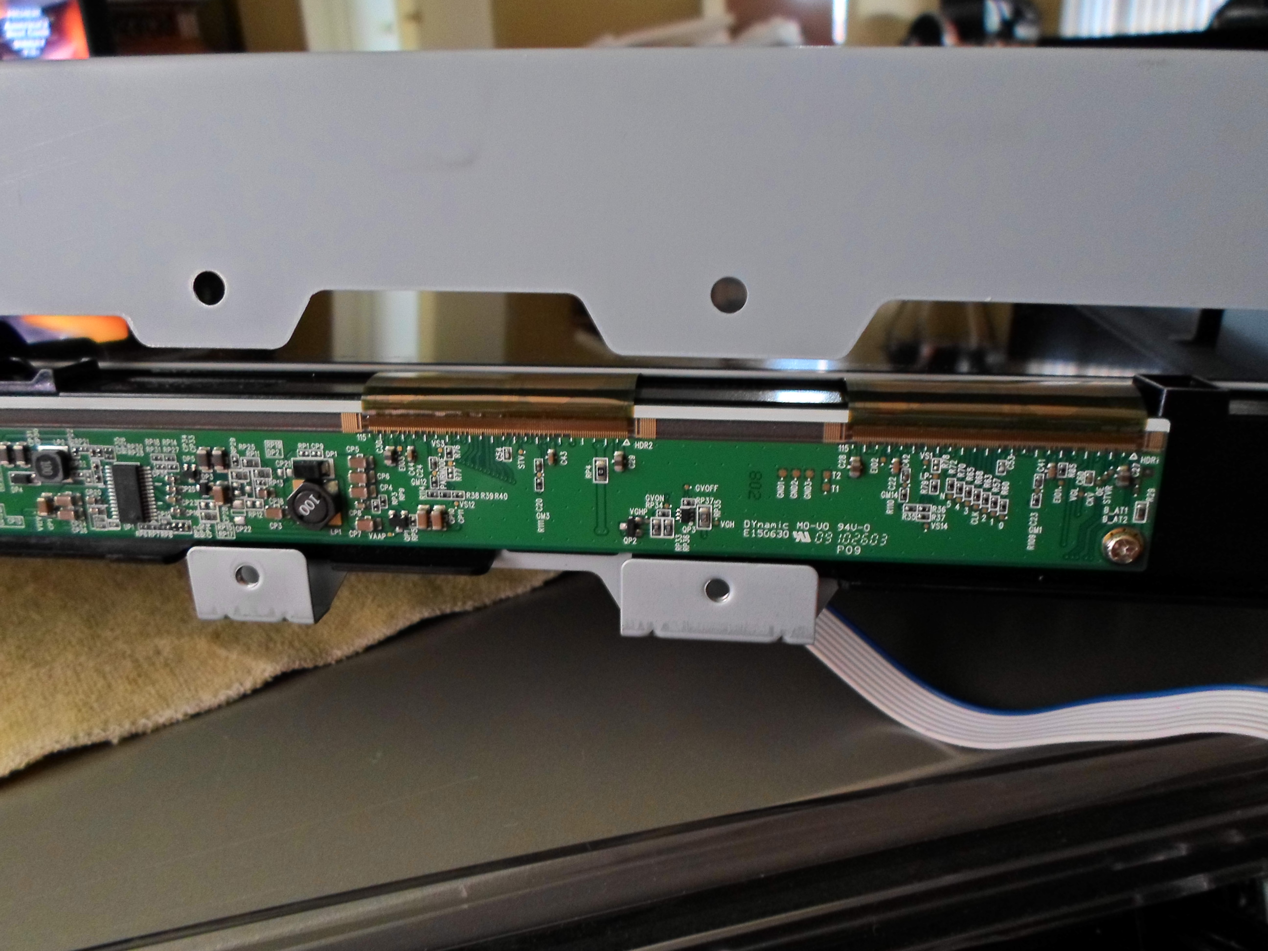

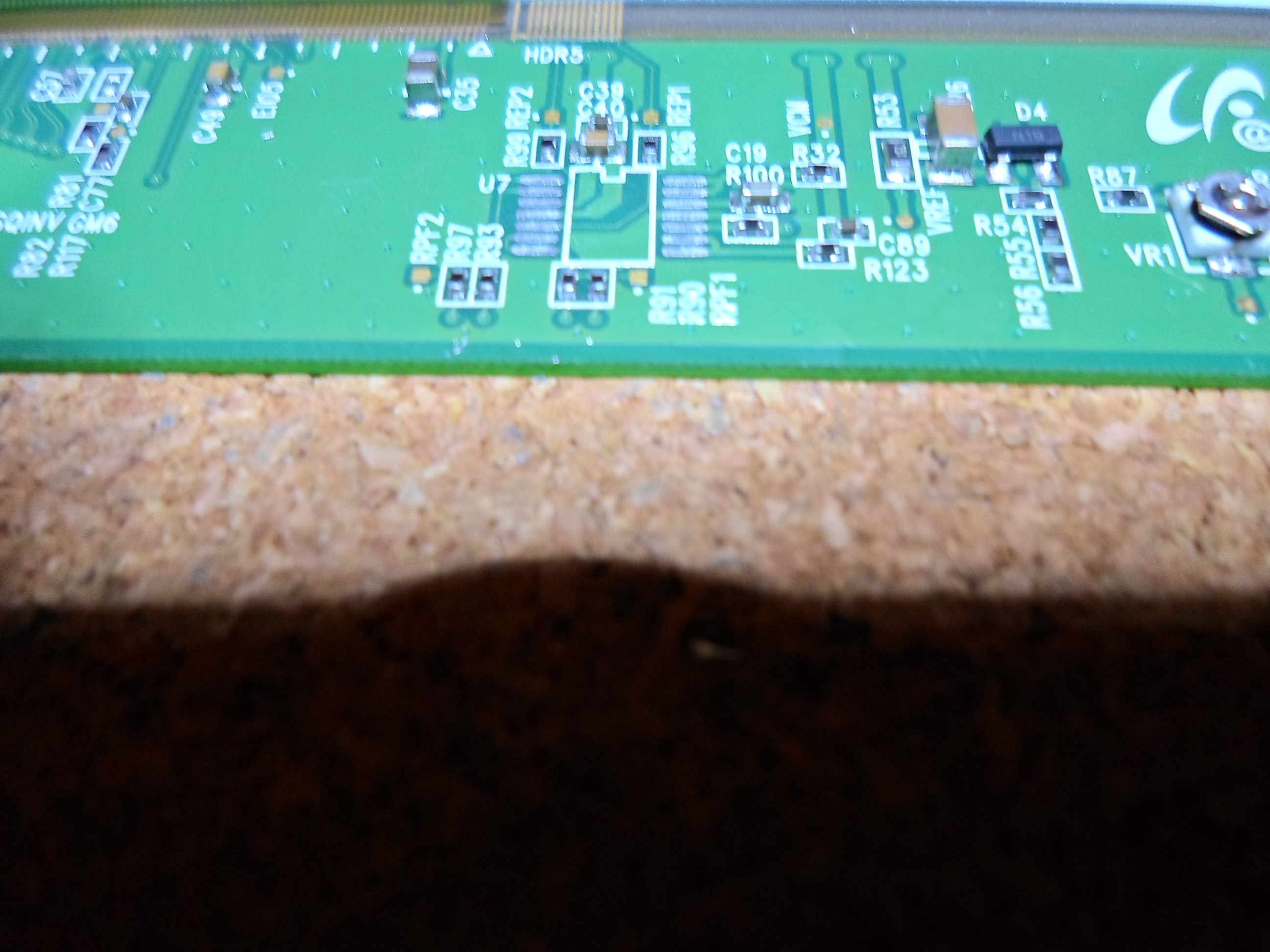

      I have it open now. There is a variable resistor on the board which does nothing when turned. I remember I had another TV and I broke off the VR by accident and it caused a white screen. I can tell by the screws someone has been inside here before unfortunately. Ill send a pic in a sec...
        Re: Samsung LN32B360C5DUZA LN32B360C5D White Screen

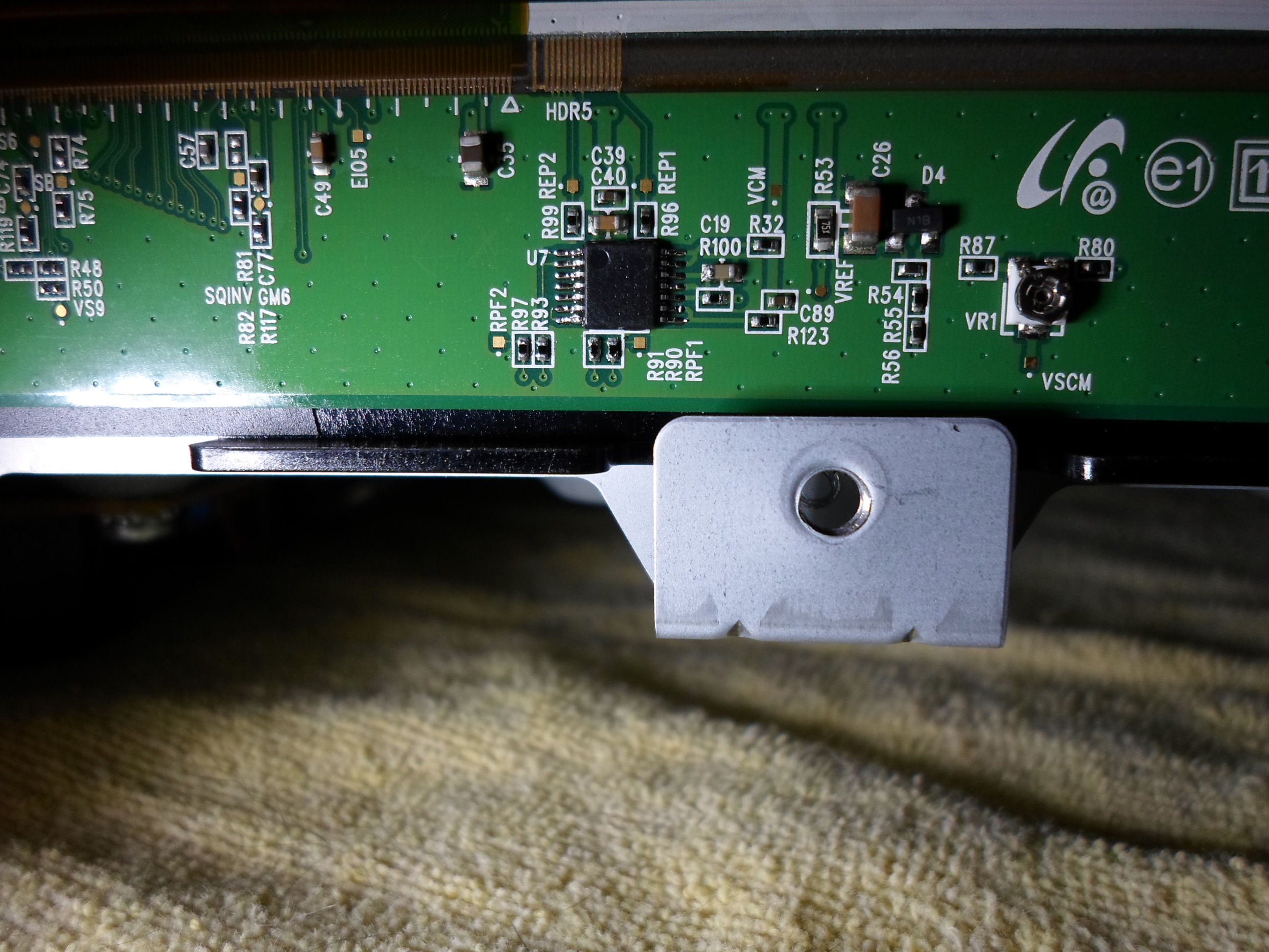

        Here's pics
          Ahh it appears U7 is burned.
            Yes I can see a little mark, part # and we can do a few tests maybe, looks like it would be replaceable but hard work. I have done a component replacement on a panel board before though, it's just awkward because of panel size.

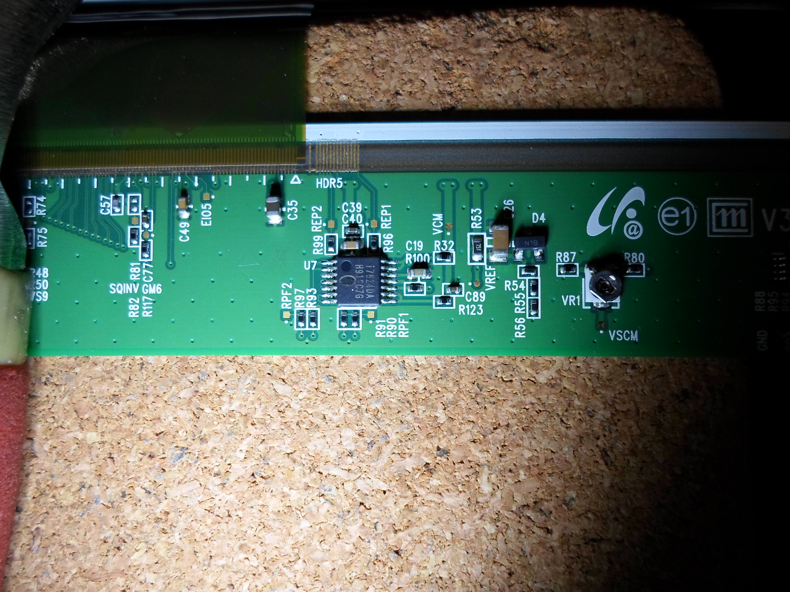

              Here's a close up of it, I can't find anything on it so far.. Definitely shorted though.
                Looks like Intersil, but can't find any part by them with that number. They do make quite a few parts like this for LCD applications. Probably a VCOM amplifier, but not sure what one...
                Only place you might be get it is a similar cracked panel.
                  Hmm, I cannot locate the I7824DA datasheet, but you can get it.
                  http://www.aliexpress.com/w/wholesale-i7824da.html
                    Bummer, thanks. Well at least mystery is solved. U7 is usually the AS15 chip on the T-Con also.

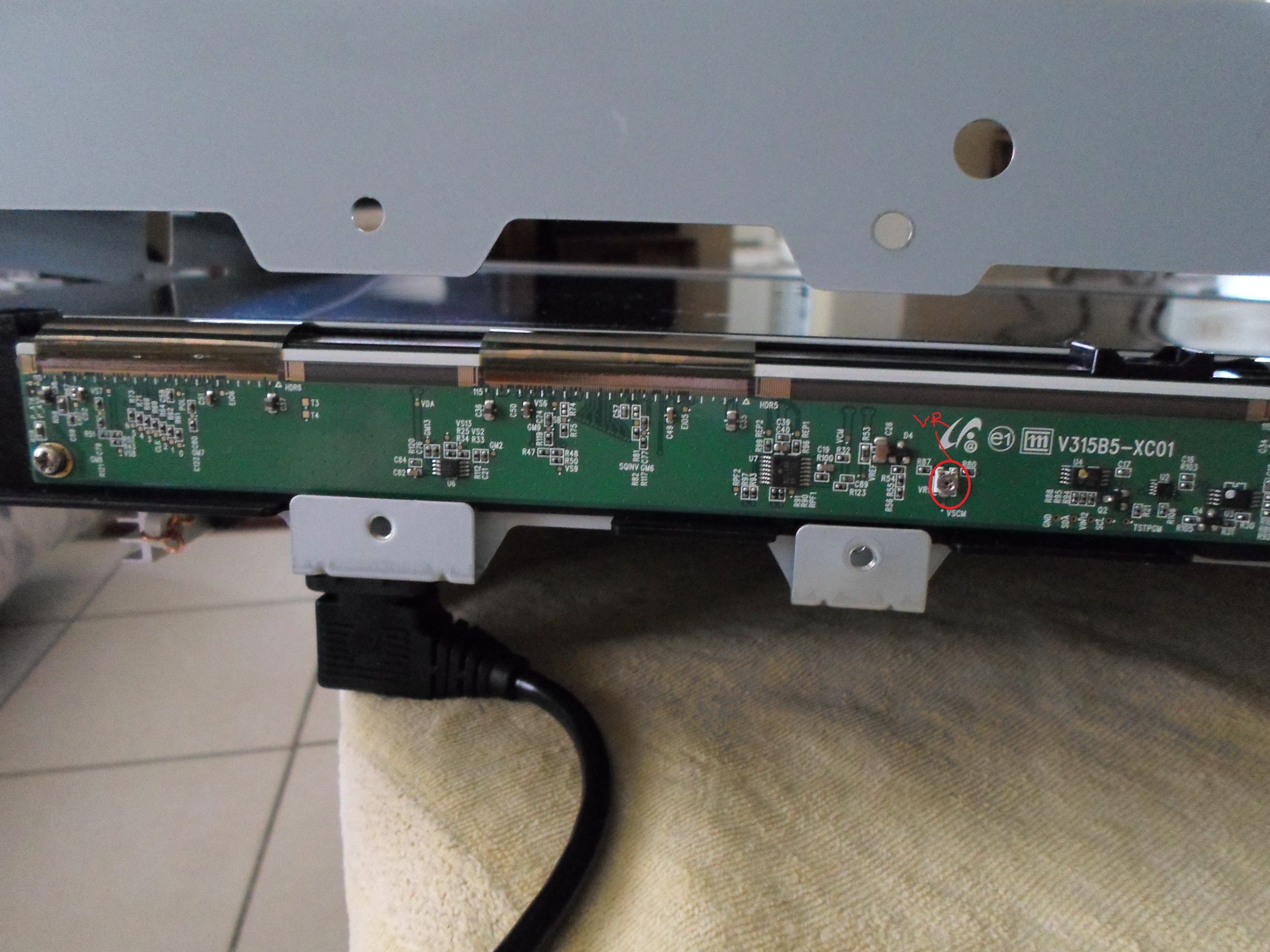

                              I ordered this part. Assuming all goes well and I get it replaced, I did move that variable resistor adjustment, is that an adjustment that can be just done by eye, or is there a process for it?
                                You should bring up a pattern like this (LCD Tests -> Inversion):
                                http://www.techmind.org/lcd/
                                Find the pattern which makes the panel flicker. Usually it is dot inversion or dot-pair inversion.
                                Then slowly adjust that until the flickering hits a minima. If you go too far it will start flickering again. It will not be possible to get zero flickering though and it might look a little uneven, just go for the best you can. Real world images won't ever be as bad as that...
                                Most likely if you haven't changed it, it will be fine in the factory setting.

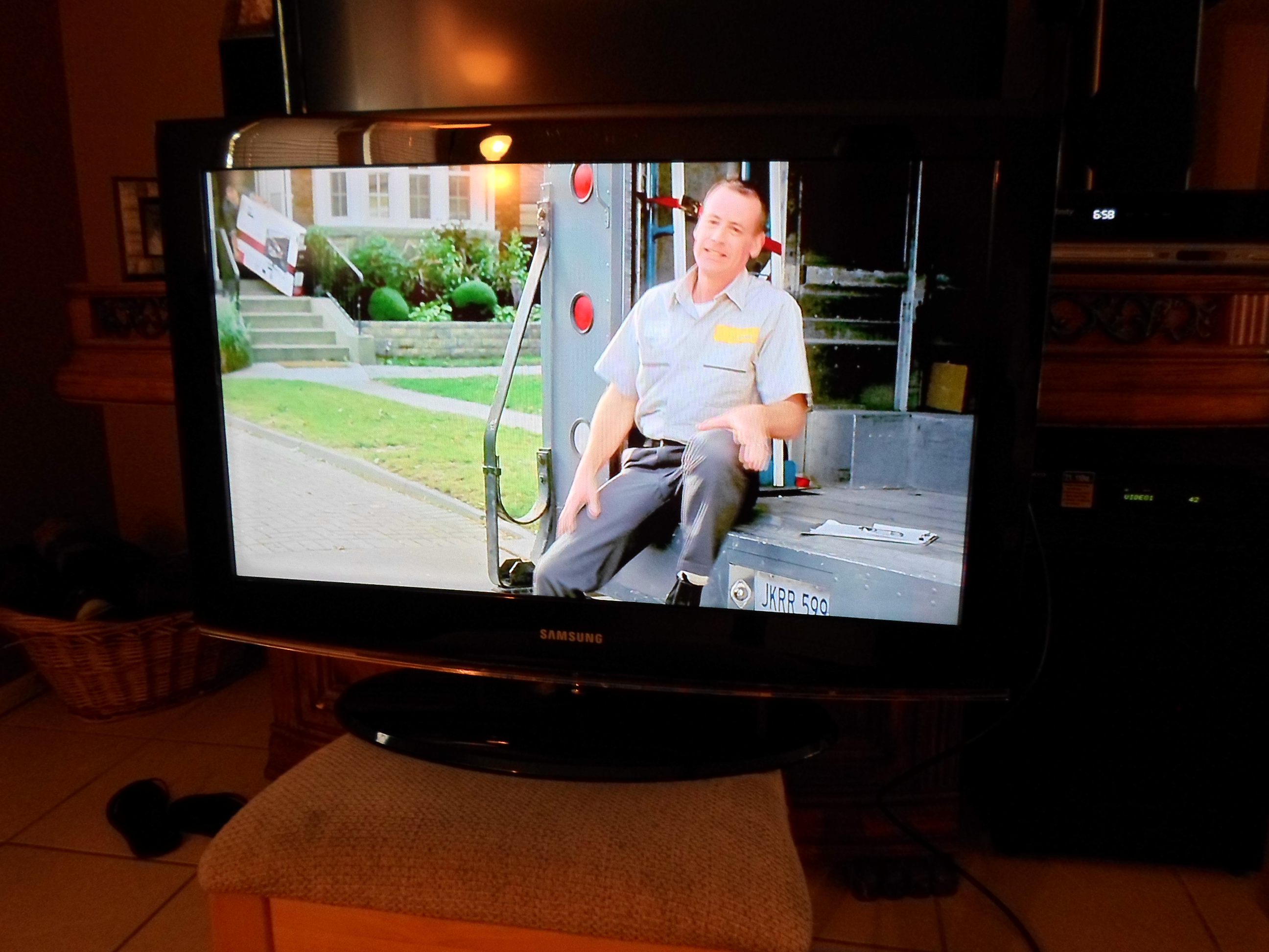

                                  Part came from China. How great is this! Thanks guys!
                                    Nice fix!
                                      Great works and thanks for posting the result.
