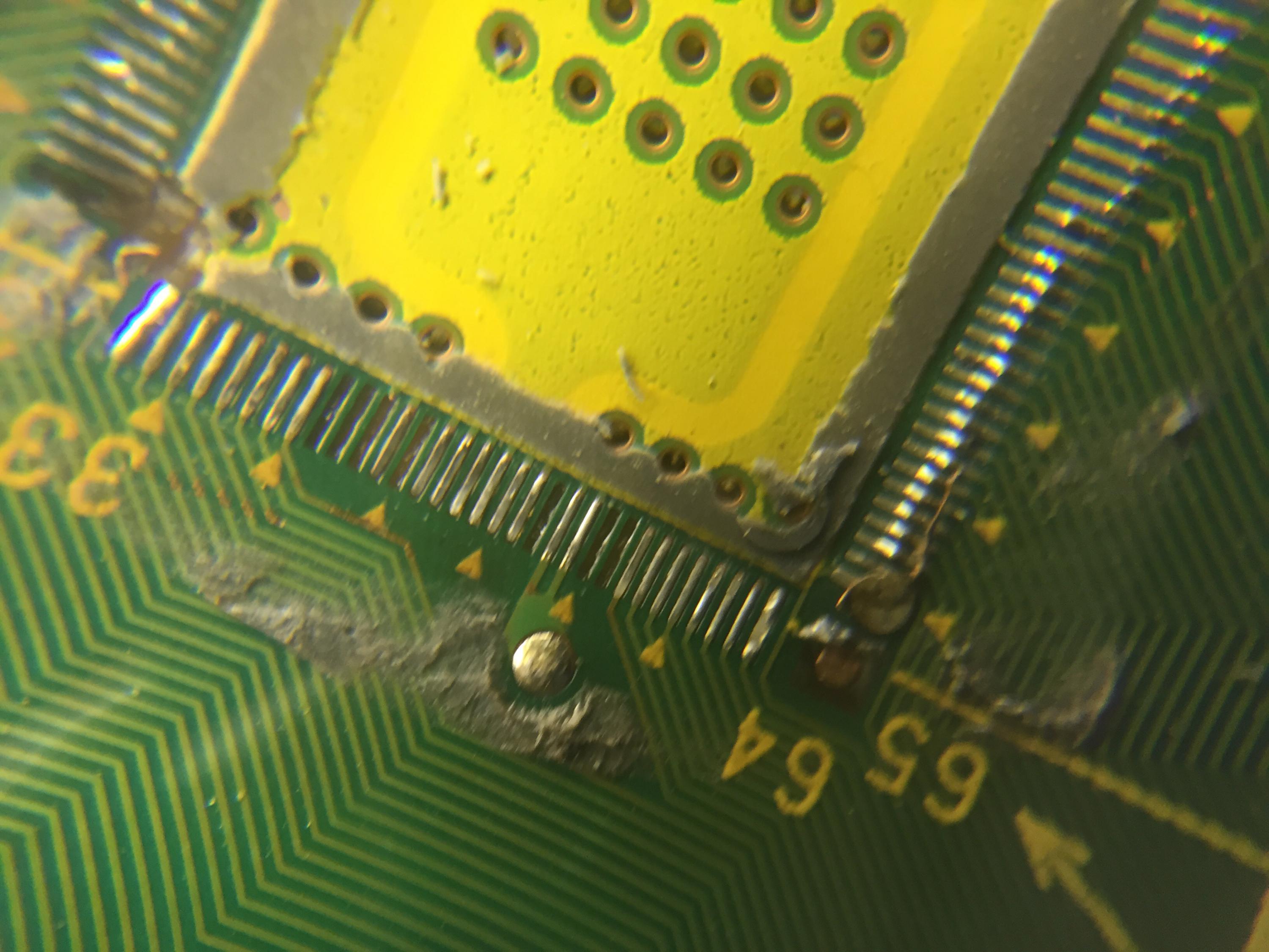

                      How hard is it to replace ic buffer chip and is there any tricks to make removal more easy.Problem I am running into is the glue it has hard to remove from pins and has some under chip.
                        Yep, that's what I found and at least someone has tried and tore the tracks. Not sure how many have tried the Panasonic buffers, usually they are obtainable easy enough.
                        maybe try acetone ?

                          Here is my attempt used a small screw driver. Will use a dental pick on the rest of the chips since the board is ruined.some pads came off but they appear not to be connected.
