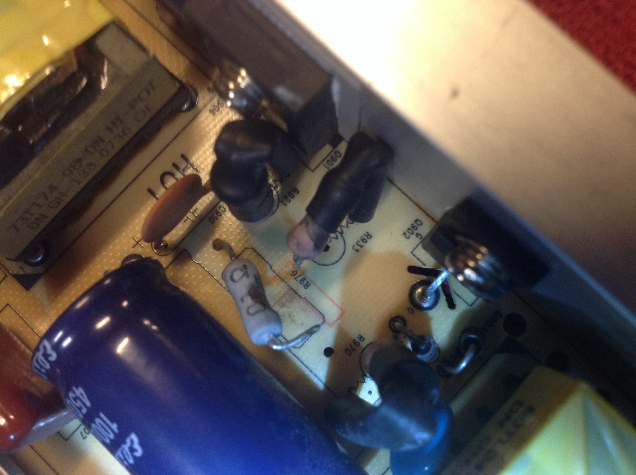

                          R933s are fried on both boards, was hard to see due to heat shrink. Here's a picture of burnt r976 and r933.

                            Desoldered r970 (on both power boards) and both are reading open. I'm glad I waited to order parts, seems like both boards have same exact problem. I was hoping to at least steal parts from one the make the other functional. But not looking that way now.

                              Q902 MOSFET should be removed and tested off the board so we will know for sure if it is shorted out or not. And if the S to D is shown as shorted, then you should order the IC at the same time because if the IC is also damaged (no way to tell for sure if the IC is 1005 good or bad) it will cause the damage to the the new MOSFET.

                                  Yes, I suspect it will have very low resistance between S and D which will explain why the fusible resistor blew up.

                                    Ok, I'll removed q902, it reads 0.5 between S and D, 21.2 between D and G, and 21.2 between S and G.
                                    I'll order ic902, q902, r933, r970, r976, and d920 (which I guess is bad) for both boards, with some spares, hehe. Thanks again budm your have a great night. I'll let ya know when I get the parts in, take it easy.
