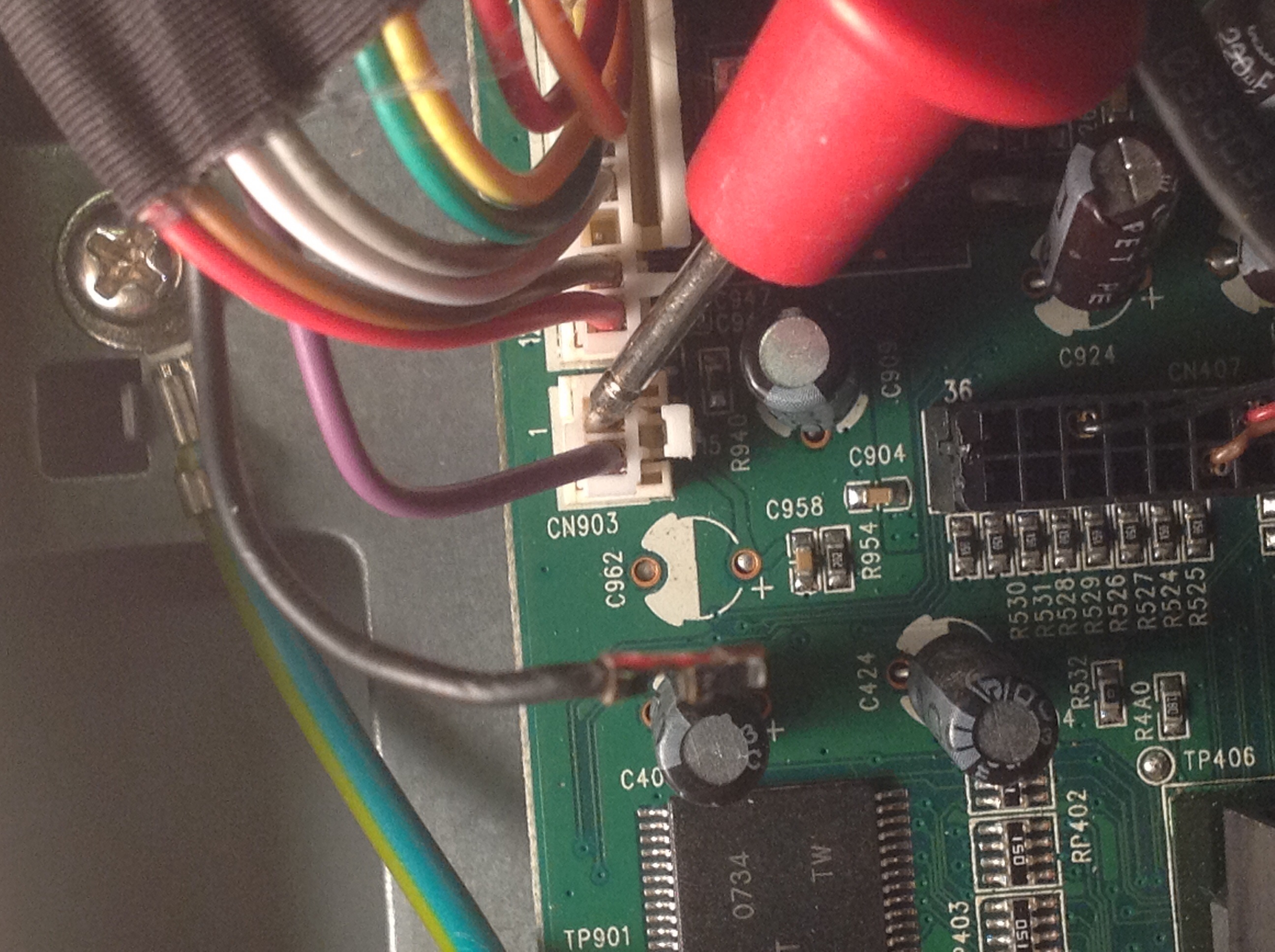

    Currently I have no 24 vdc to the inverter board from the power supply. All fuses checked good. With the tv power off (at cn902 power from Psu to mainboard),(pins 1 & 2 not used on this model) it has 13.52 at pins 3 & 4, 5.29 vdc at pins 5 & 6, good grounds at pins 7 - 8, 0 vdc on pin 10, 0.03 vdc on pin 11, and 0 vdc at pin 12. (Note all volts are the same for corresponding pins for cn901 at mainboard power off and on) At cn903 (Psu to inverter) it has 2.92 vdc at pin 12 on/off, 3.31 vdc at pin 11 dim, good ground at pins 10 - 6, no 24 vdc at pins 5 - 1.
      With power on (steady green led light) cn902 has 13.11 vdc at pins 3 & 4, 5.30 vdc at pins 5 & 6, 2.92 vdc at pin 10 on/off, 1.87 vdc at pin 11, and 3.31 vdc at pin 12 dim. At cn903 (Psu to inverter) it has 2.92 vdc at pin 12 on/off, 3.31 vdc at pin 11 dim, good ground at pins 10 - 6, no 24 vdc at pins 5 - 1.

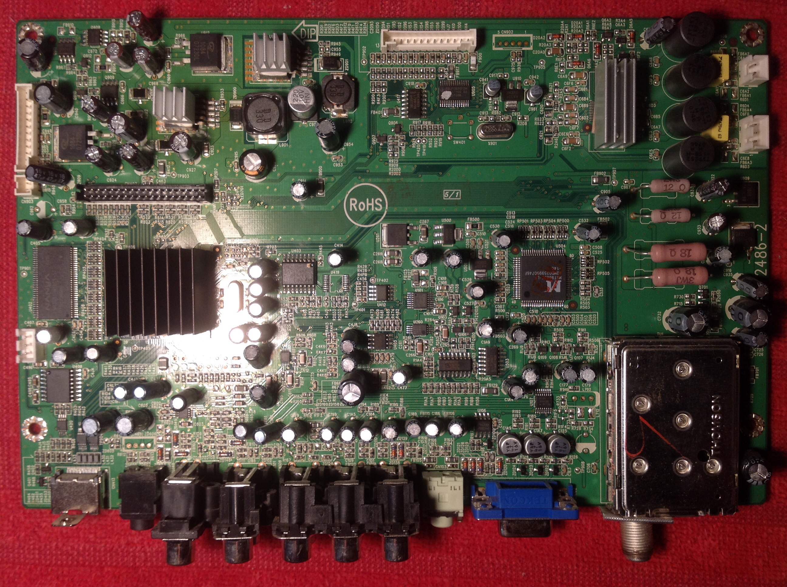

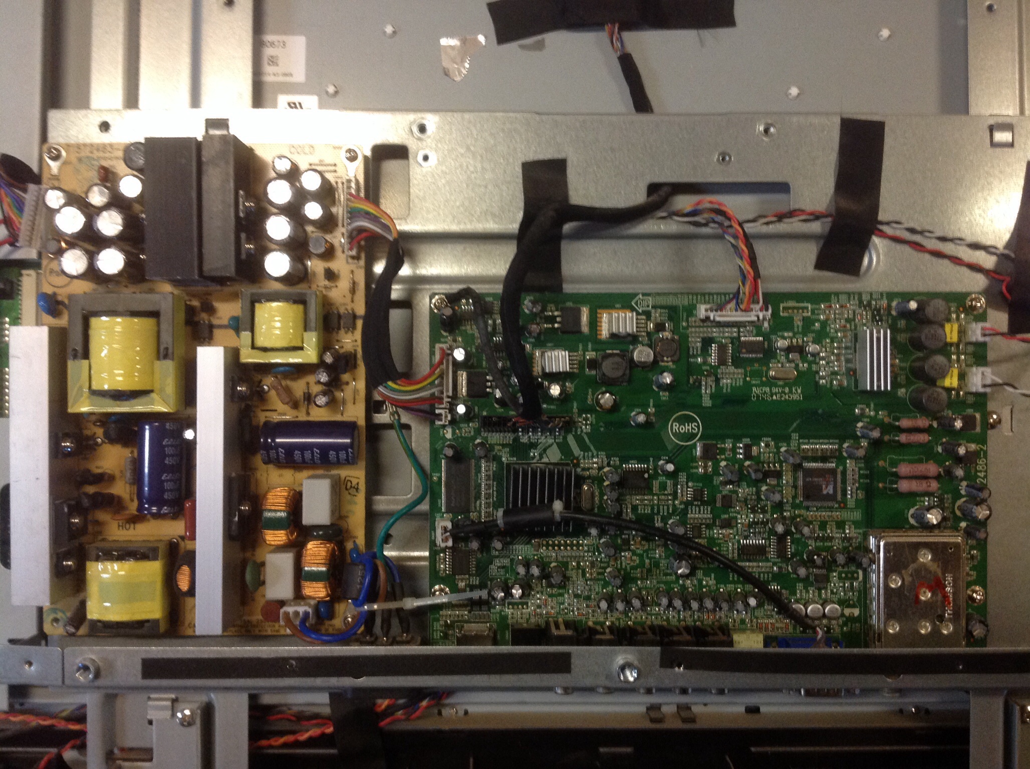

        Here's some pictures off the power and main boards

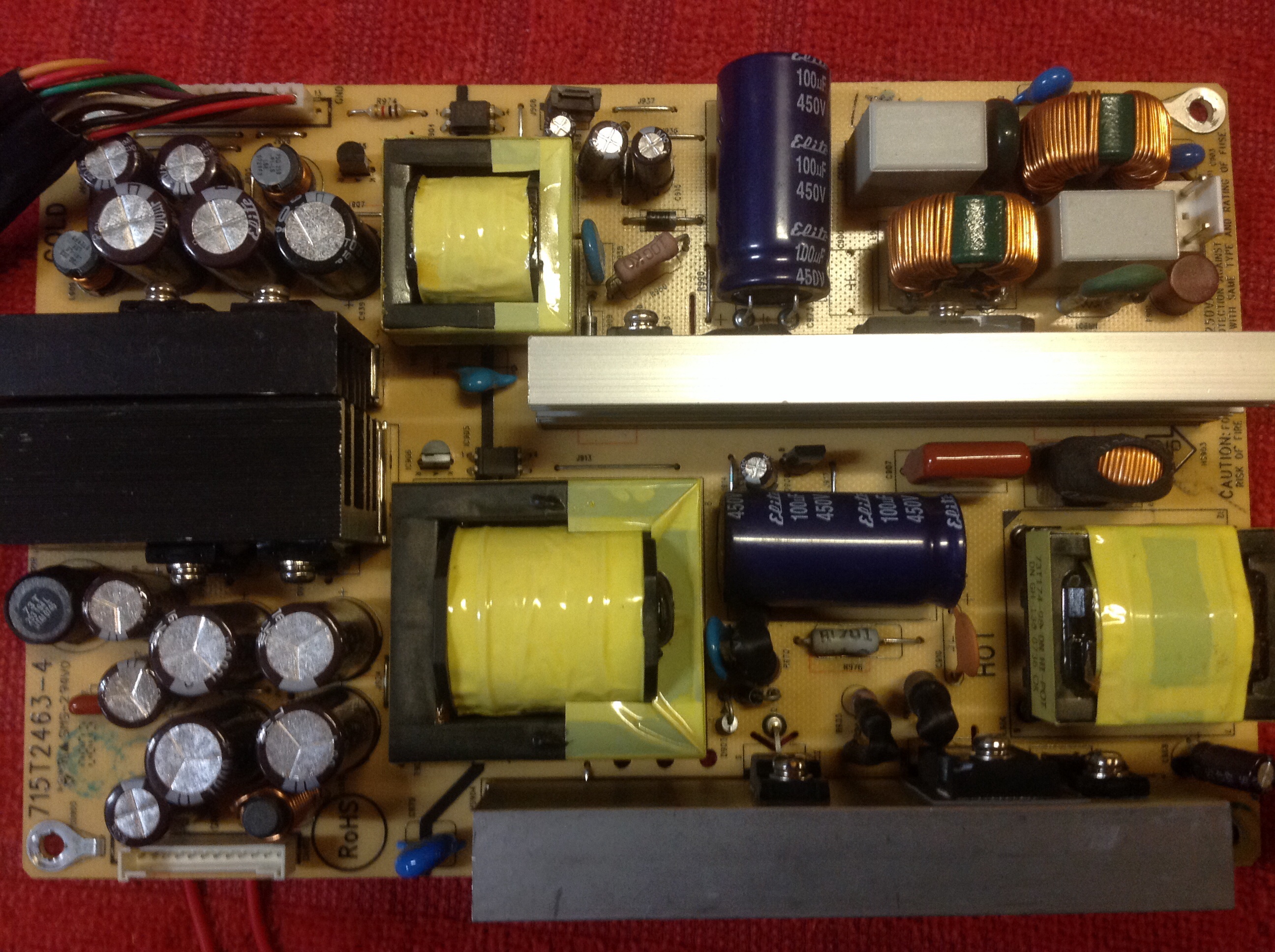

          Here's the power board top

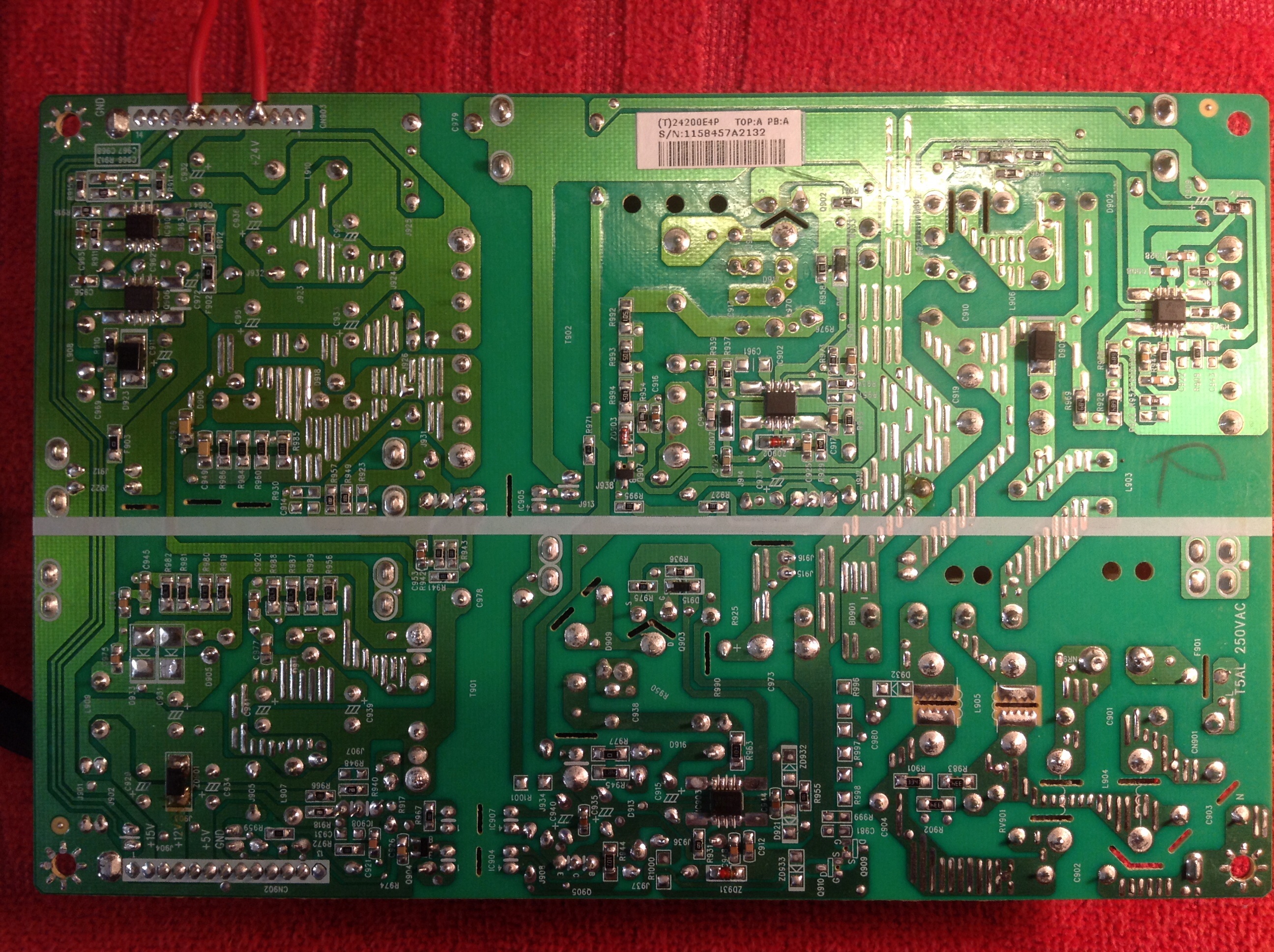

            Here's the power board bottom

              Here's the main board top

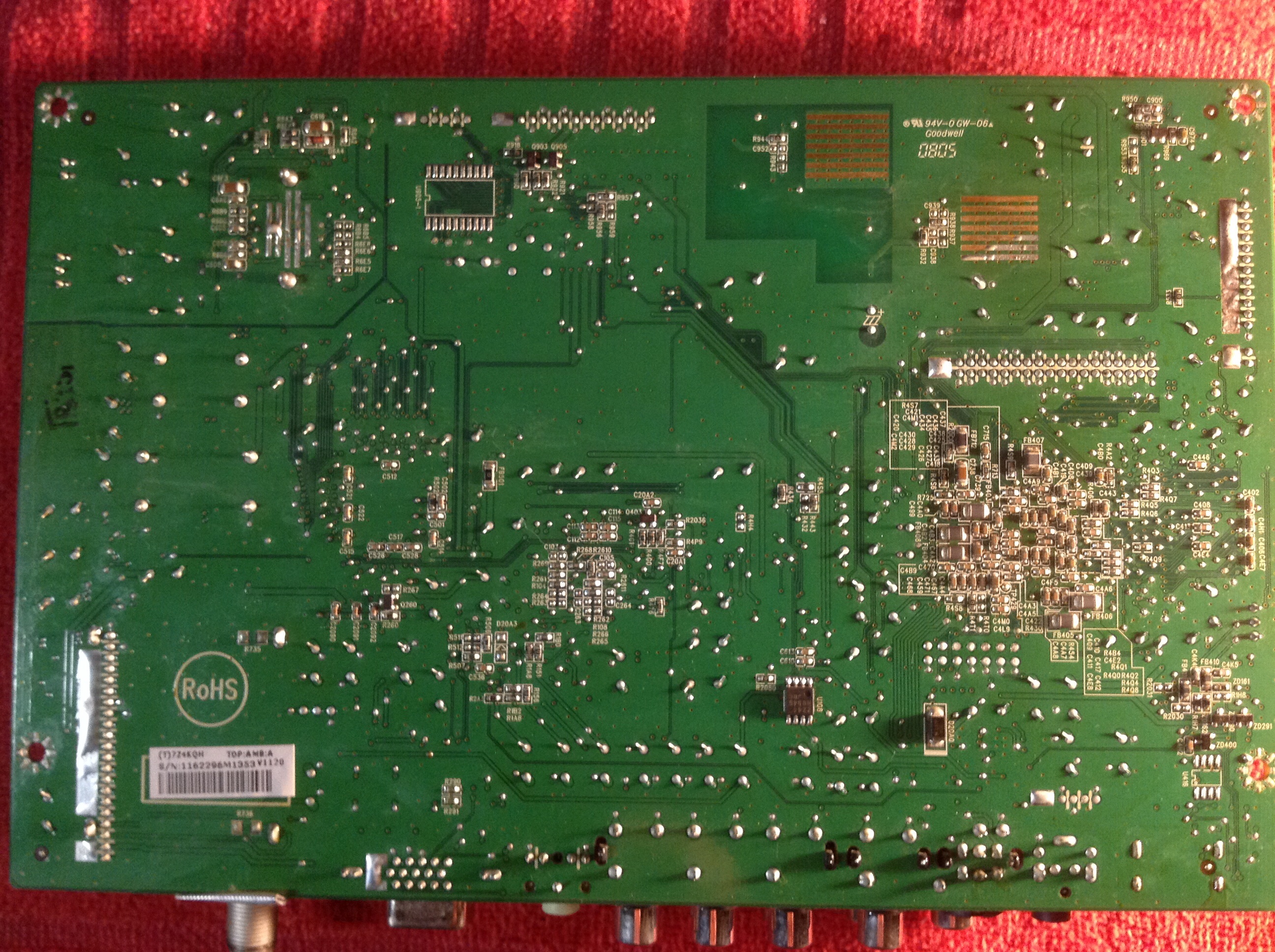

                Here's the main board bottom
                By the way, sorry for putting picture on five different post, but seems like they are too large for one post. Anyway I've ordered an ESR tester and will check caps more when it arrives. Any suggestions in the mean time?

                    Re: AOC Envision 32 inch L32W761 no picture or sound
                    OK, we need to know if the PS_ON signal is working not by checking the DC voltage right at the two legs of the 450VDC main filter cap when TV is off and when it is turn on.
                    It should have about 170VDC when TV is OFF and about 370~400VDC when TV is ON.

                        Sorry for the slow response (Friday night, hehe), anyway at c973 with power off I'm getting 167vdc off both legs, and 402vdc with power on.
                          OK, the PS_ON is fine, when PS_ON is applied, the PFC Voltage booster will kick up the voltage for the 24V power supply to run on. So we need to look at the 24V power supply section next. There may be a fusible fuse that the 402VDC is fed into to feed to 24V power supply section.
                          Since we do not have the schematic diagram for this power supply, it will be a matter of tracing out the traces on the bottom side of the board to see how it works.
                            The SMPS IC902 and the MOSFET Q902 are for the 24V circuit. Try to get the P/N as printed on top of the IC so we can get the spec sheet for it.
                            Check the fusible resistor R976.

                                    So check that fusible resistor R976 to see if it is open.
                                        TV unplug, then just check the resistance of that resistor R976, it should show about the same resistance reading as when you touch the two probes of the meter together.
