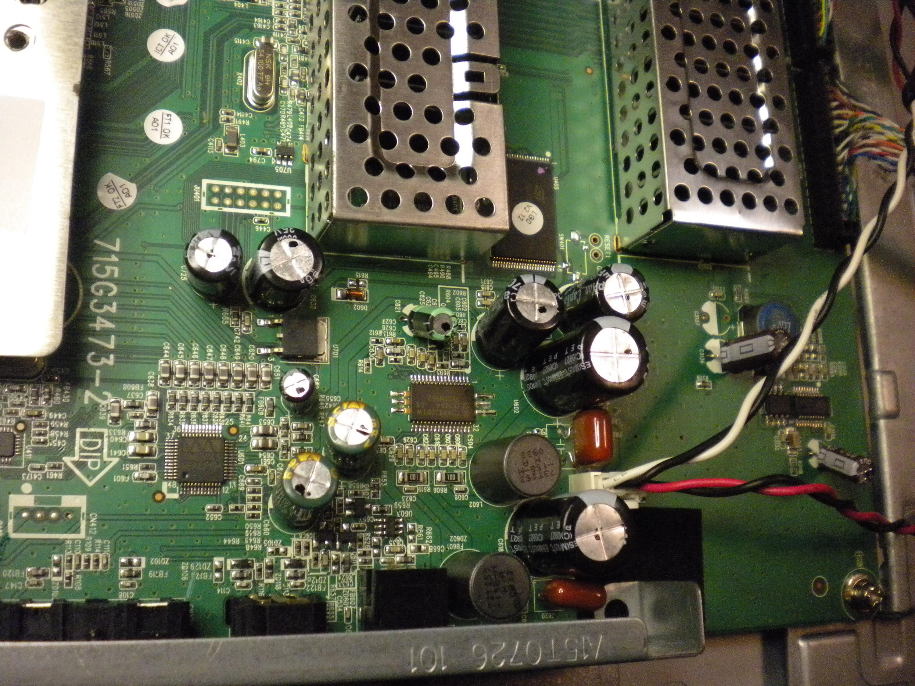

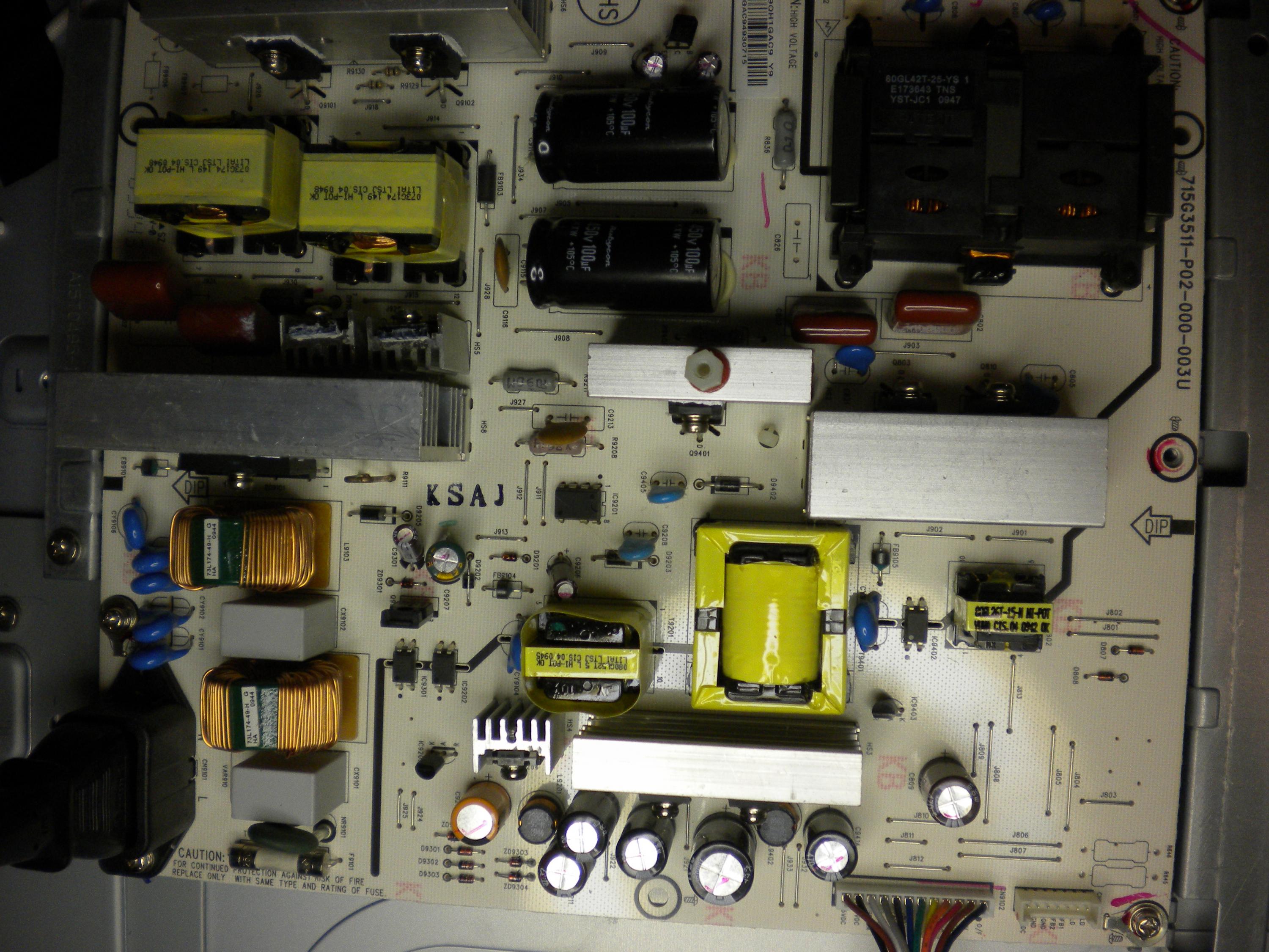

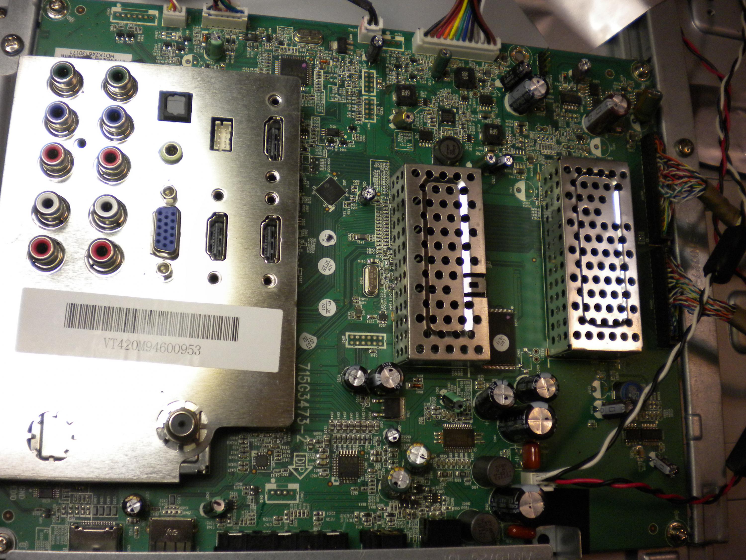

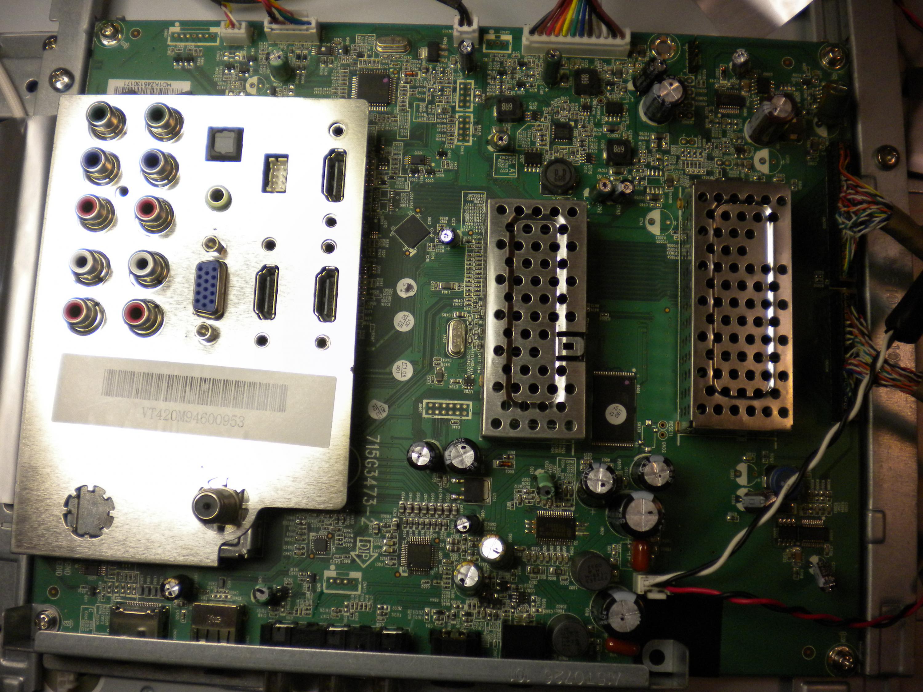

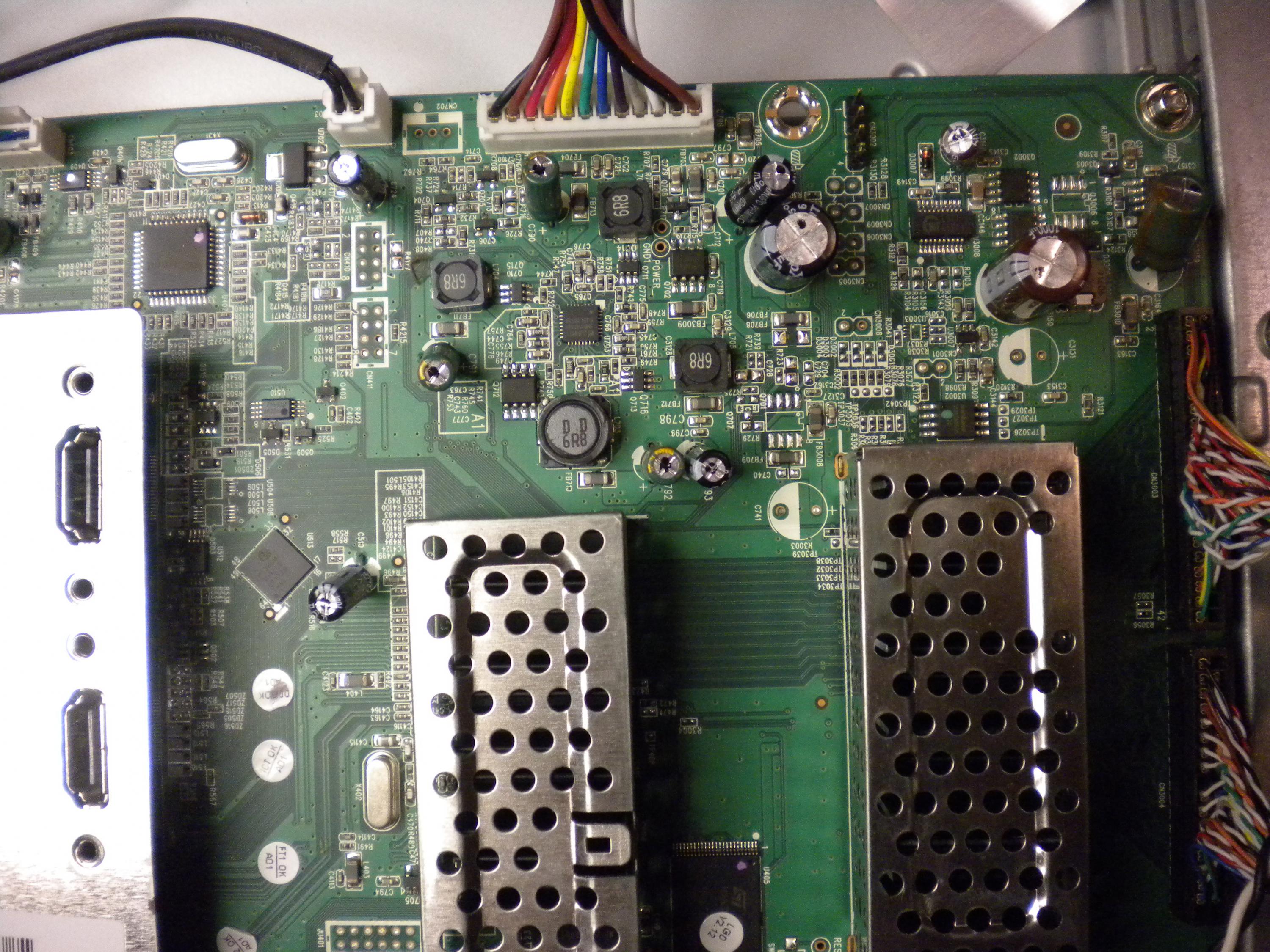

      Re: VT420M zombification
      Let's see if these will do. And one of the power board as well. I'm still waiting to hear there's an easy fix for all my troubles on that side.
        Hmm, there are more than one version of your model, one has power supply-inverter combo, one does not. You have the combo one.
        The 12V is not tightly regulated power supply, it is used mainly for sound.

        It does sound like you do have main board problem since it is not sending out the BL_ON either, and it also not sending the signal to turn on the switched MOSFET (on the main board) to supply the B+ to the T-CON.

              After installing a used mainboard, the backlight and picture returned. Probably the sound, too.
              As for the original mainboard: I noted before that the top cage was staying cold on the original board. On the new one, whatever is in there warmed it up appropriately, so its on the same circuit as my mystery problem. I may go spelunking in there and see what's shaking once I'm done catching up on my show.
