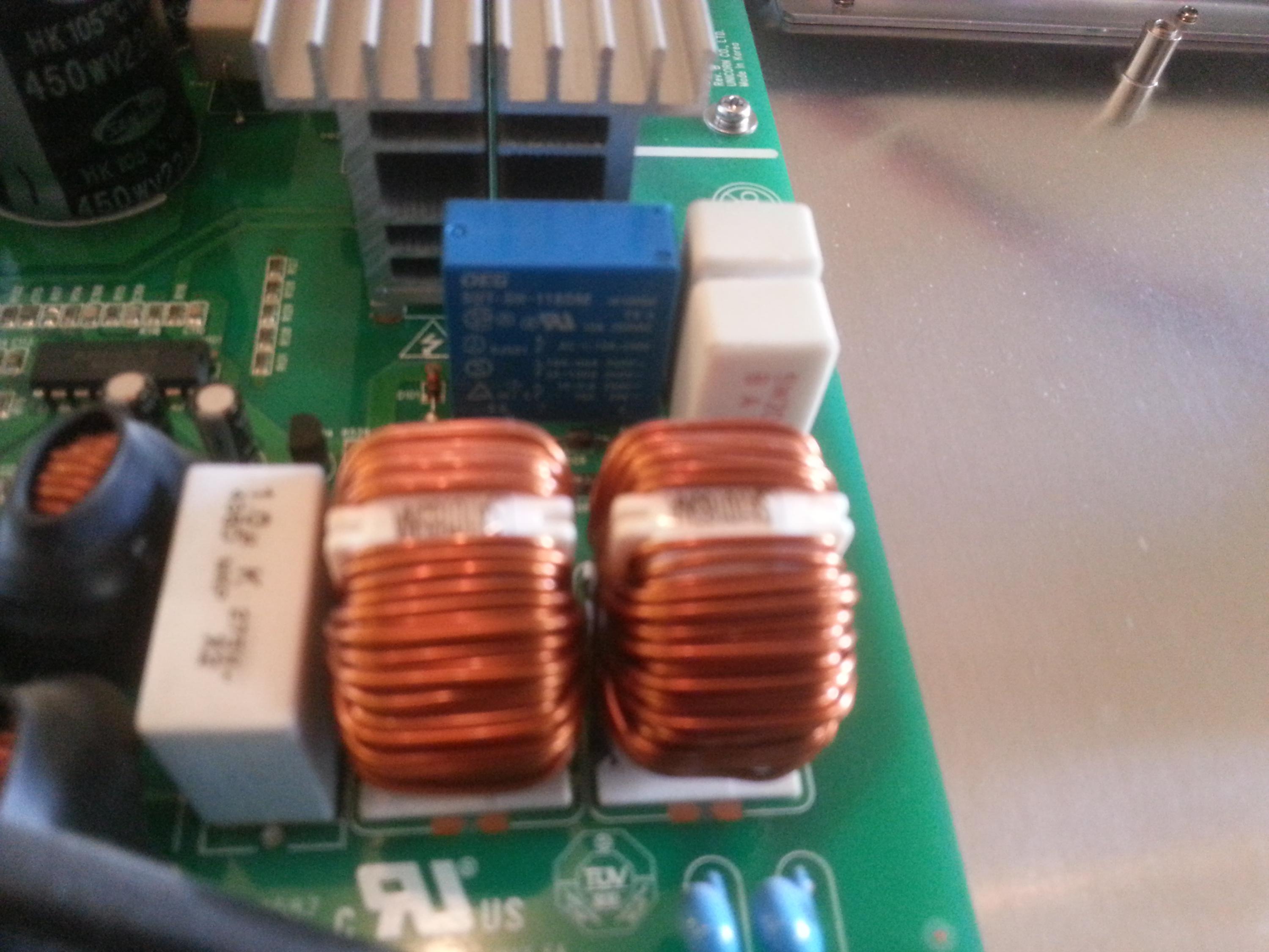

        • joehezzer
          • Jul 2012
          • 251
          • England
          #64
          Re: usp440m-42lp psu
          ok so i have changed filter no joy, i must have tested something wrong somewhere or has blown old filter and something else. i have not had chance to test it properly yet. i did test the rocker switch and it tested ok but on closer inspection it looks a bit melted.
          when i plug the power cord in i can hear what sounds like a relay click from the area pictured and shorting sound if i can use that term

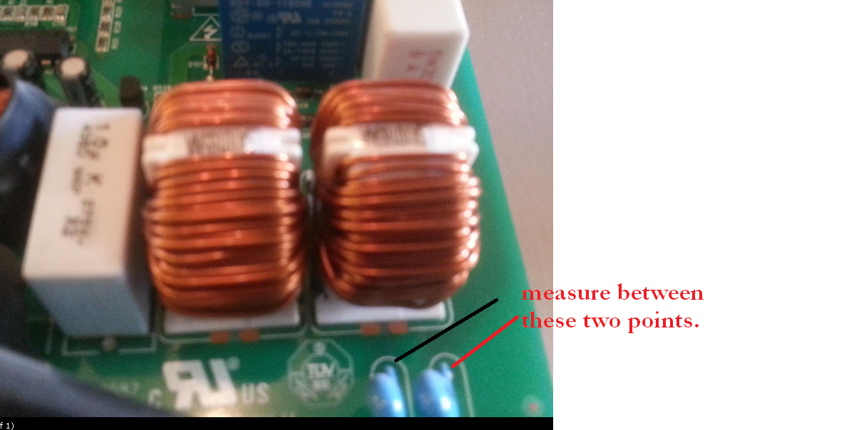

          • joehezzer
            • Jul 2012
            • 251
            • England
            #65
            Right ok test out put again and got 263v Ac atleast I have a reading this time lol
            • joehezzer
              • Jul 2012
              • 251
              • England
              #66
              Originally posted by paulstef
              Perfect. What's the voltage at the points indicated in the picture?
              37v AC
              • joehezzer
                • Jul 2012
                • 251
                • England
                #67
                37v AC from these

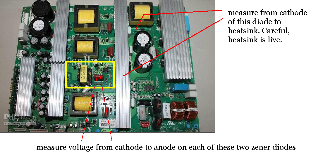

                • paulstef
                  • Dec 2013
                  • 724
                  #68
                  37VAC is not enough, must be the same voltage as input AC voltage.
                  • joehezzer
                    • Jul 2012
                    • 251
                    • England
                    #69
                    • joehezzer
                      • Jul 2012
                      • 251
                      • England
                      #70
                      ok just double checked it got the same voltage as the input, 263v ac

                            • paulstef
                              • Dec 2013
                              • 724
                              #74
                              check the measurements in the picture
                              the yellow part creates the 5V standby voltages

                                  • paulstef
                                    • Dec 2013
                                    • 724
                                    #77
                                    Originally posted by joehezzer
                                    Nothing from any of them. So probably need to pull off diodes and check em !!
                                    No.
                                    Obviously the NCP1200 (8-PIN IC) is not oscillating.
                                    From cathode of D103 to heatsink, do you read high voltage DC?
                                    If not what do you read from the leftmost pin to the rightmost pin of the bridge rectifier BD101?
