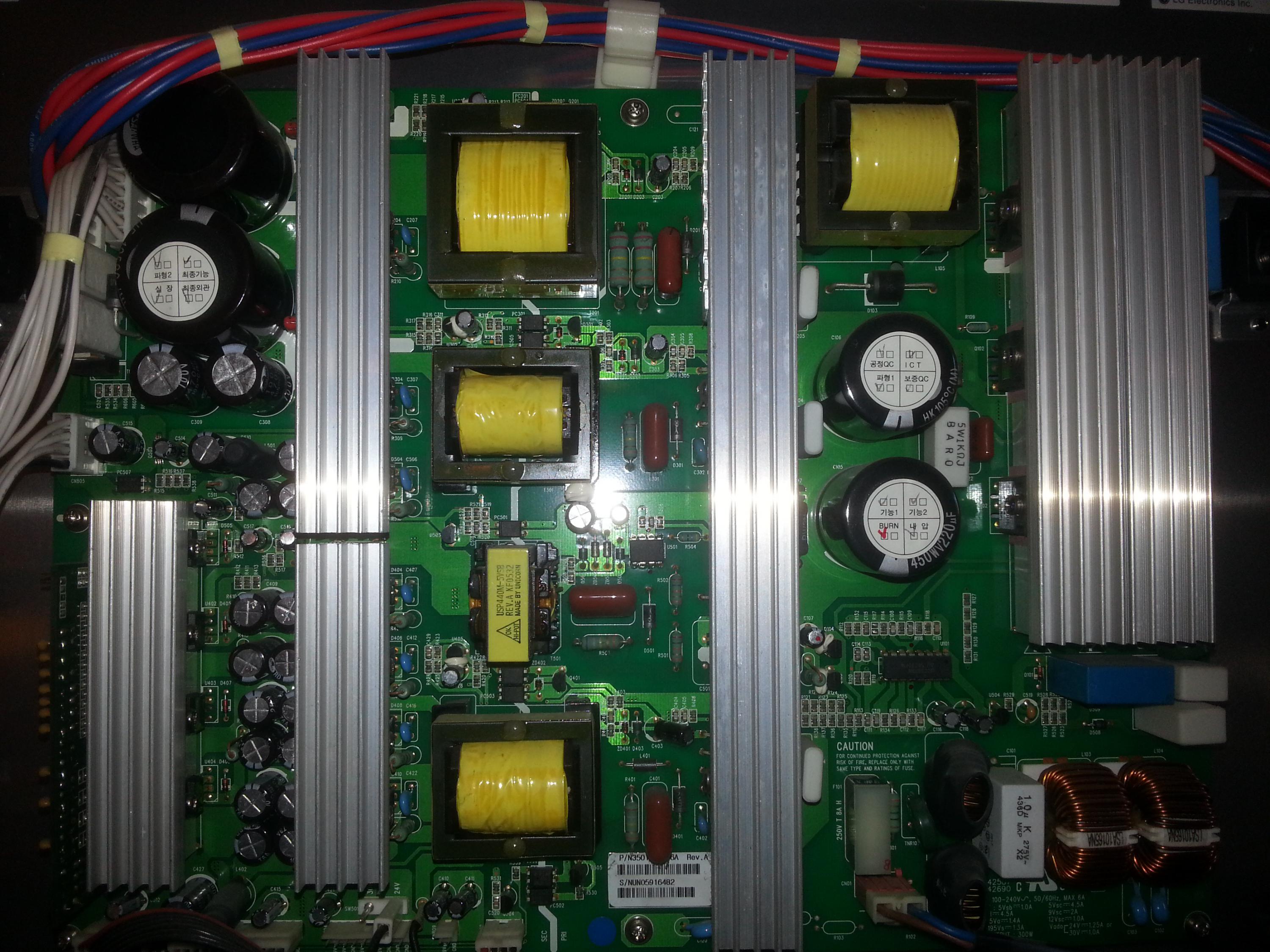

    Hi all does anybody have any experience with the said psu, picked up a 42inch plasma the other day, the psu has no power and am struggling to find a replacement cheers

      Re: usp440m-42lp psu
      What tests have you done on it?
      Stby 5v present?
      Have you tried turning the PSU on by sending the PS-On, Vs-On, etc to it?
      What set? PSU may well be fine--could be a Set fault and nothing to do with the PSU at all!

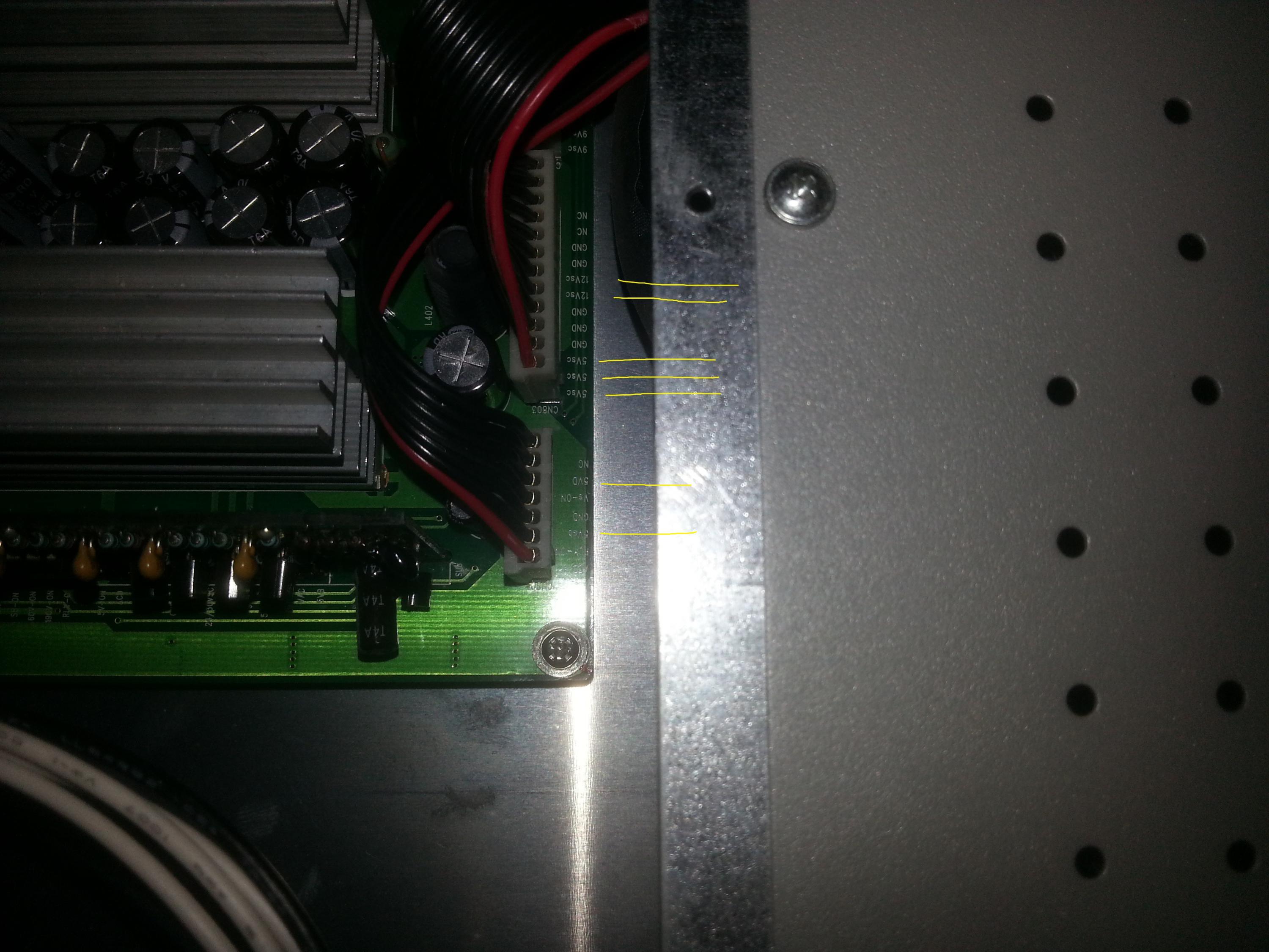

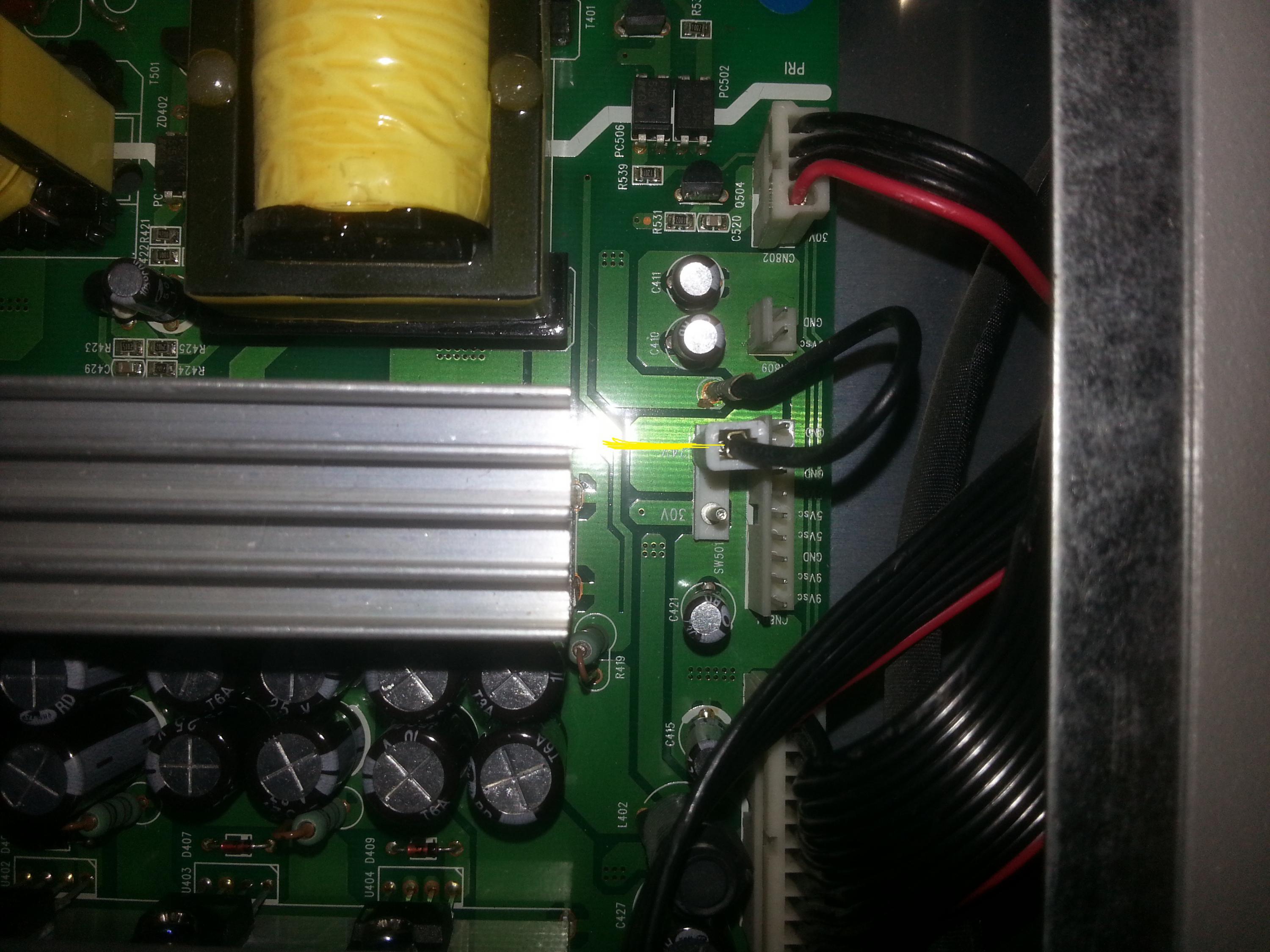

        i have checked the voltage on the points marked in yellow, nothing at all no standby light nothing. i have done a minimal amount of checks as i was just going to replace psu. there is a big blue block (relay i think ) found a post somewhere saying it might be that, its a bush 42" PLASMA, i do not have model number as of yet

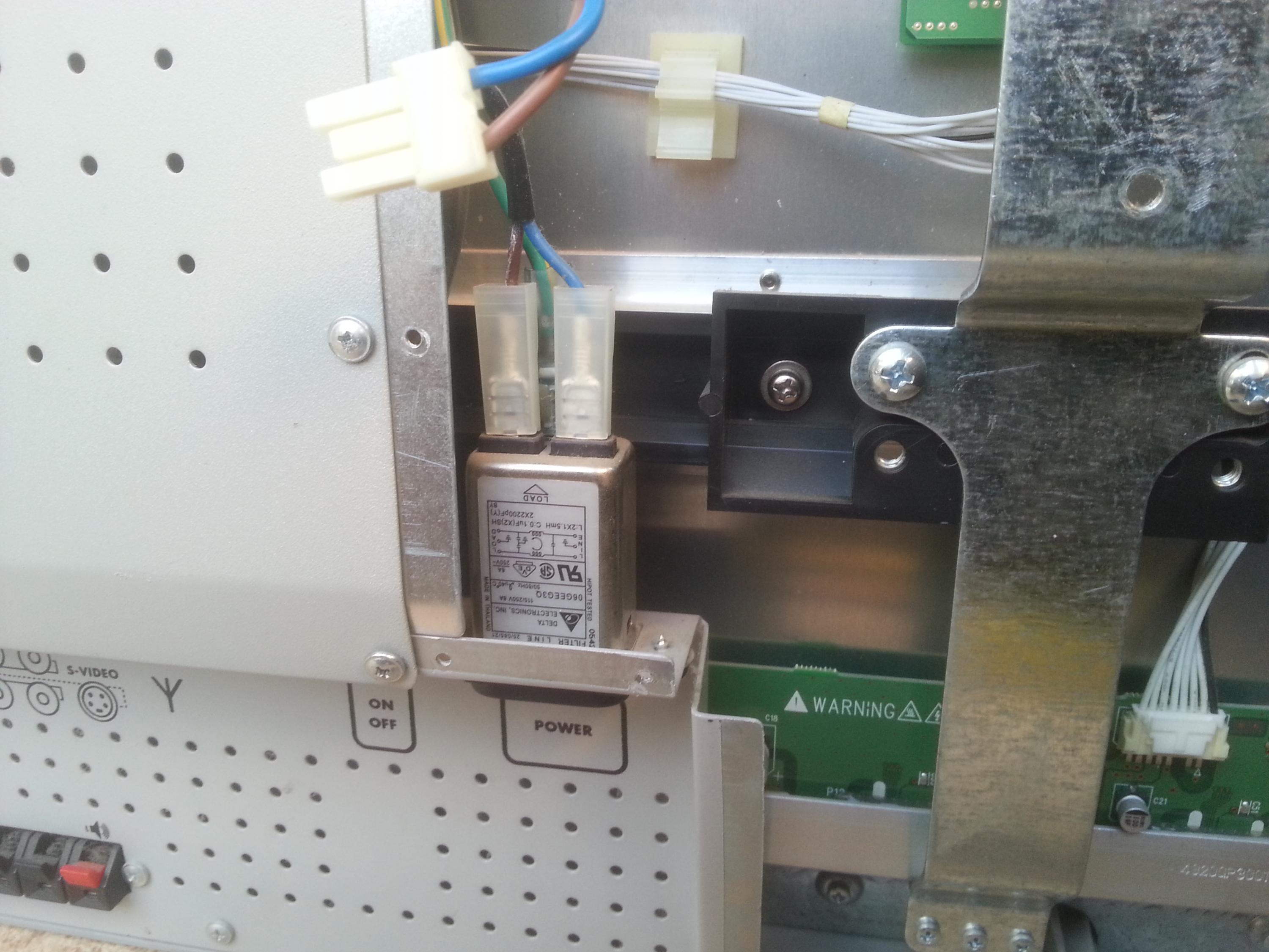

              Pics of chassis....?
              --I'll bet that PSU is OK from experience....
              TELEFIX
              • joehezzer
                • Jul 2012
                • 251
                • England

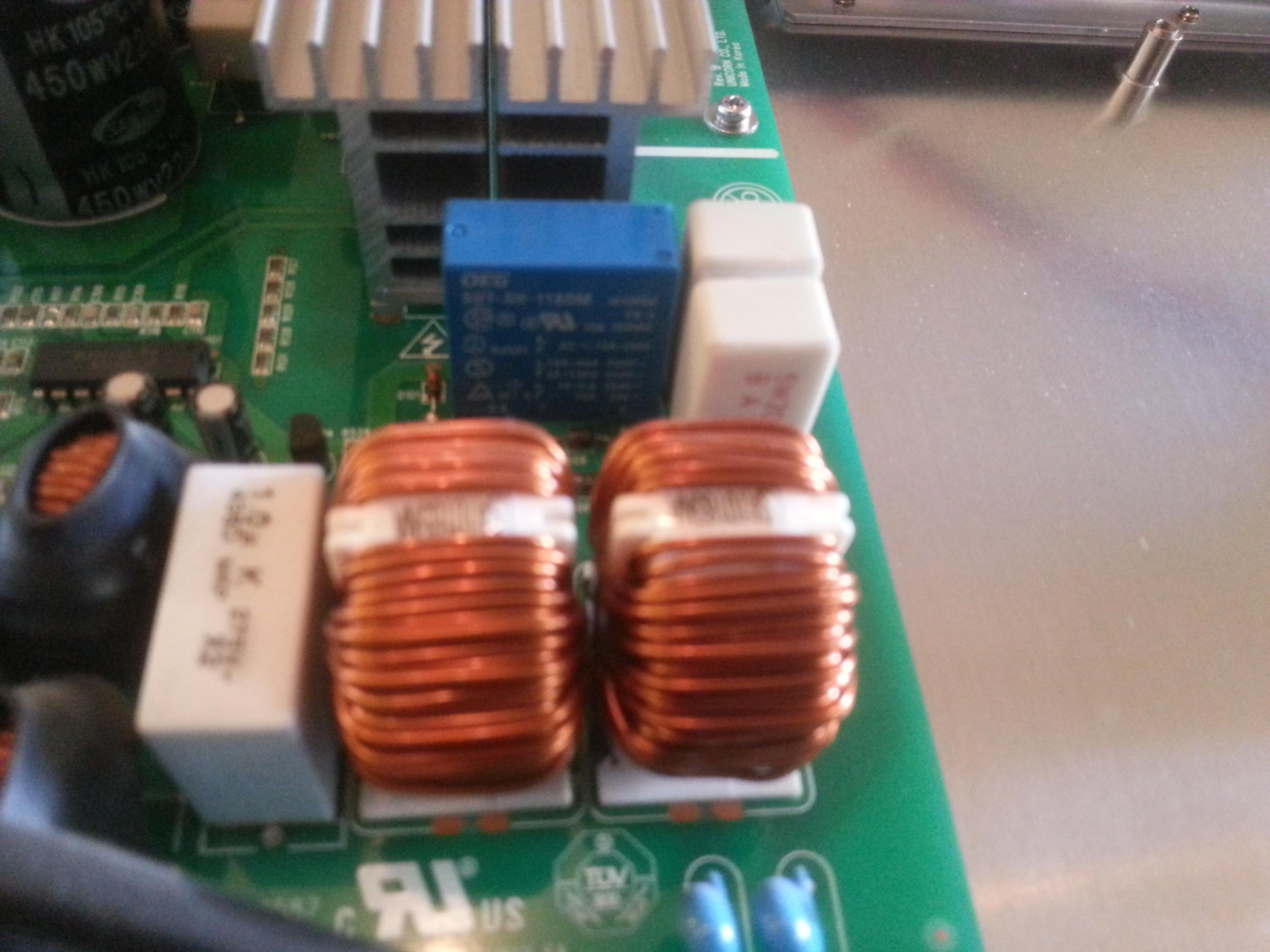

                bridge rectifiers tested good, i will get more pics later

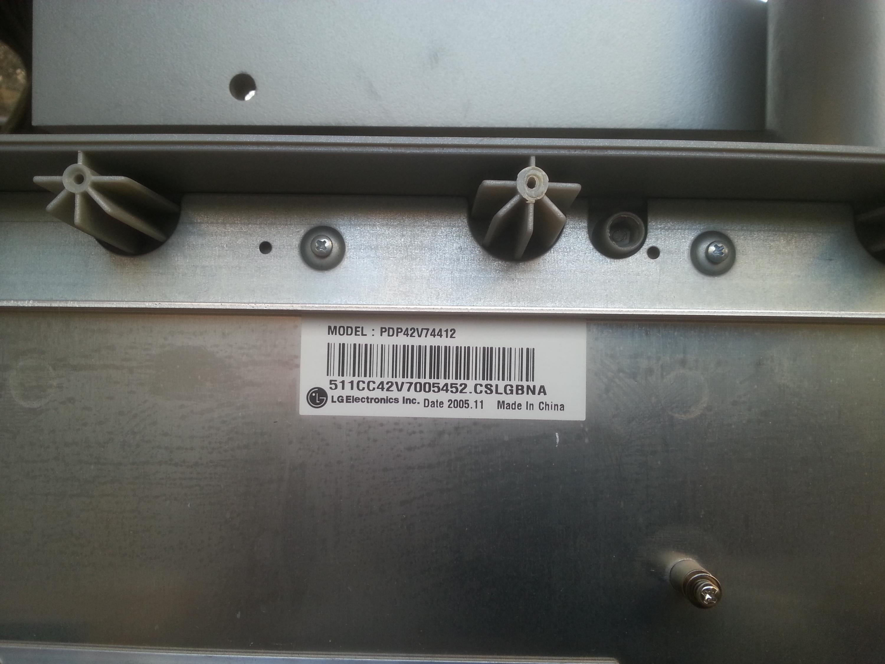

                    model number pdp42tv006
                    • Alastair E
                      Chief Womble
                      • Mar 2013
                      • 1963
                      • U.K.
                      Ha! A V7!
                      First plasma I ever potched with was a V7. Still got an alleged brand-new IPM for one kicking round somewhere....
                      10-1 that PSU is OK. You'll need to check for 5V stdby supply first before going any further.
                            just looking for the 5v stby point, i can see 5v ctl
                            • joehezzer
                              • Jul 2012
                              • 251
                              • England

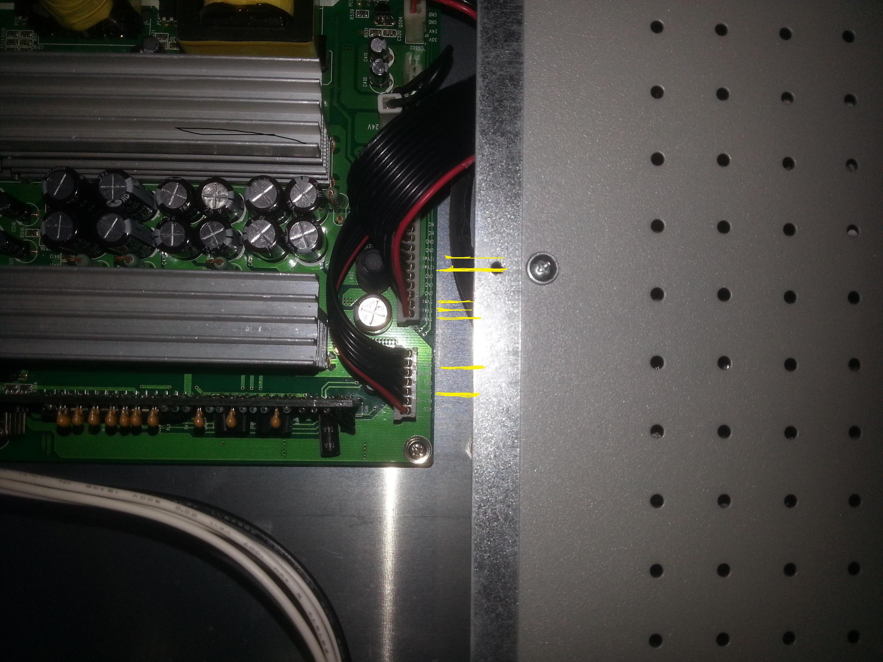

                              Firstly, with set unplugged, use your meter to check the fuses on Y-SUS and Z-SUS. Any blown and there's a short somewhere....
                              they are all ok checked them earlier (fuses), i disconnected the boards y-sus z-sus one at a time to see if it turned on still nothing
                              • Alastair E
                                Chief Womble
                                • Mar 2013
                                • 1963
                                • U.K.
                                OK--Thats one of the 5V lines--there's usually a few. Some will be powered, some not when in standby.
                                Check 'em all, post results and the names/references of 'em pref with a pic of the plug you measured them at...

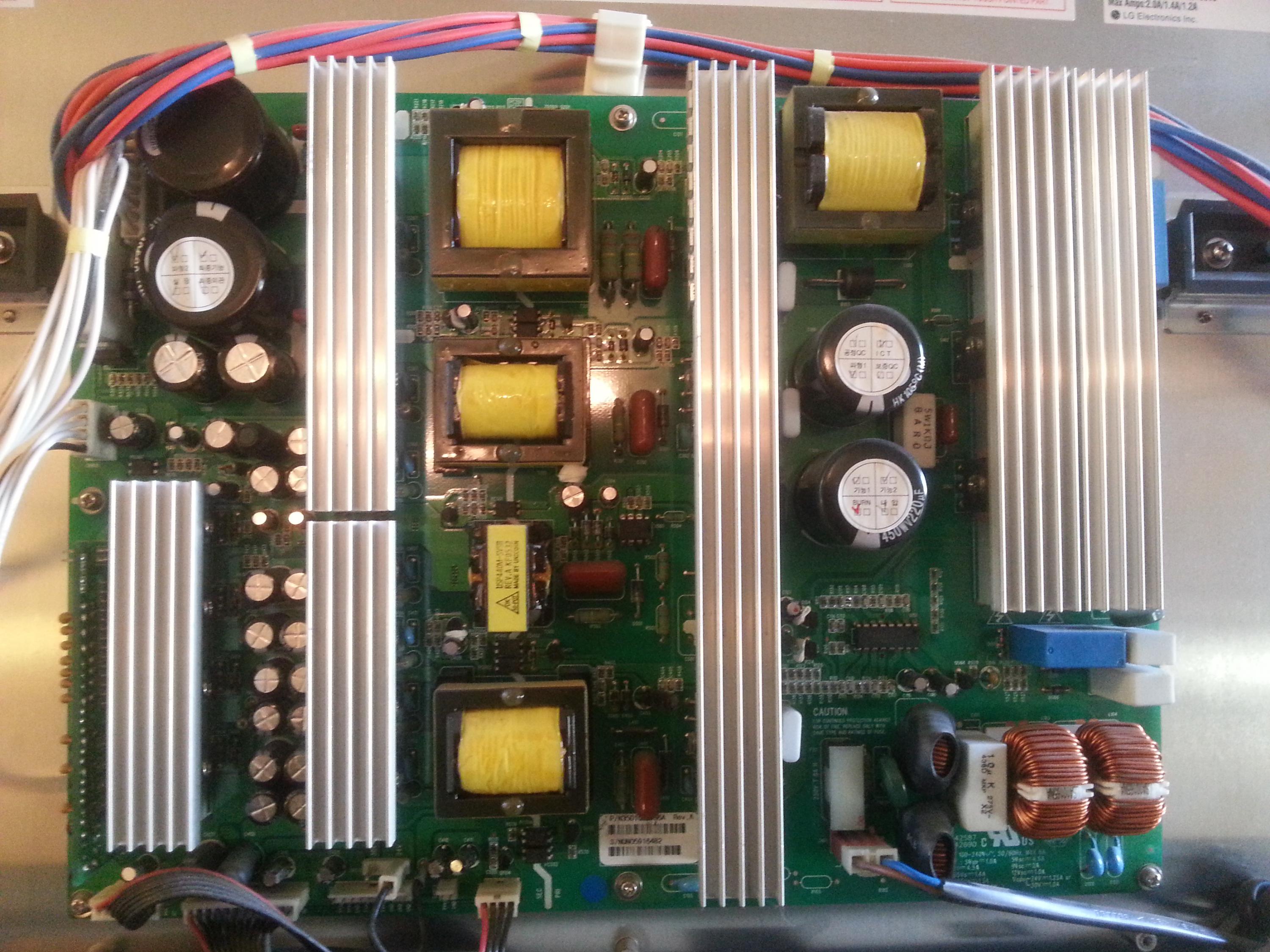

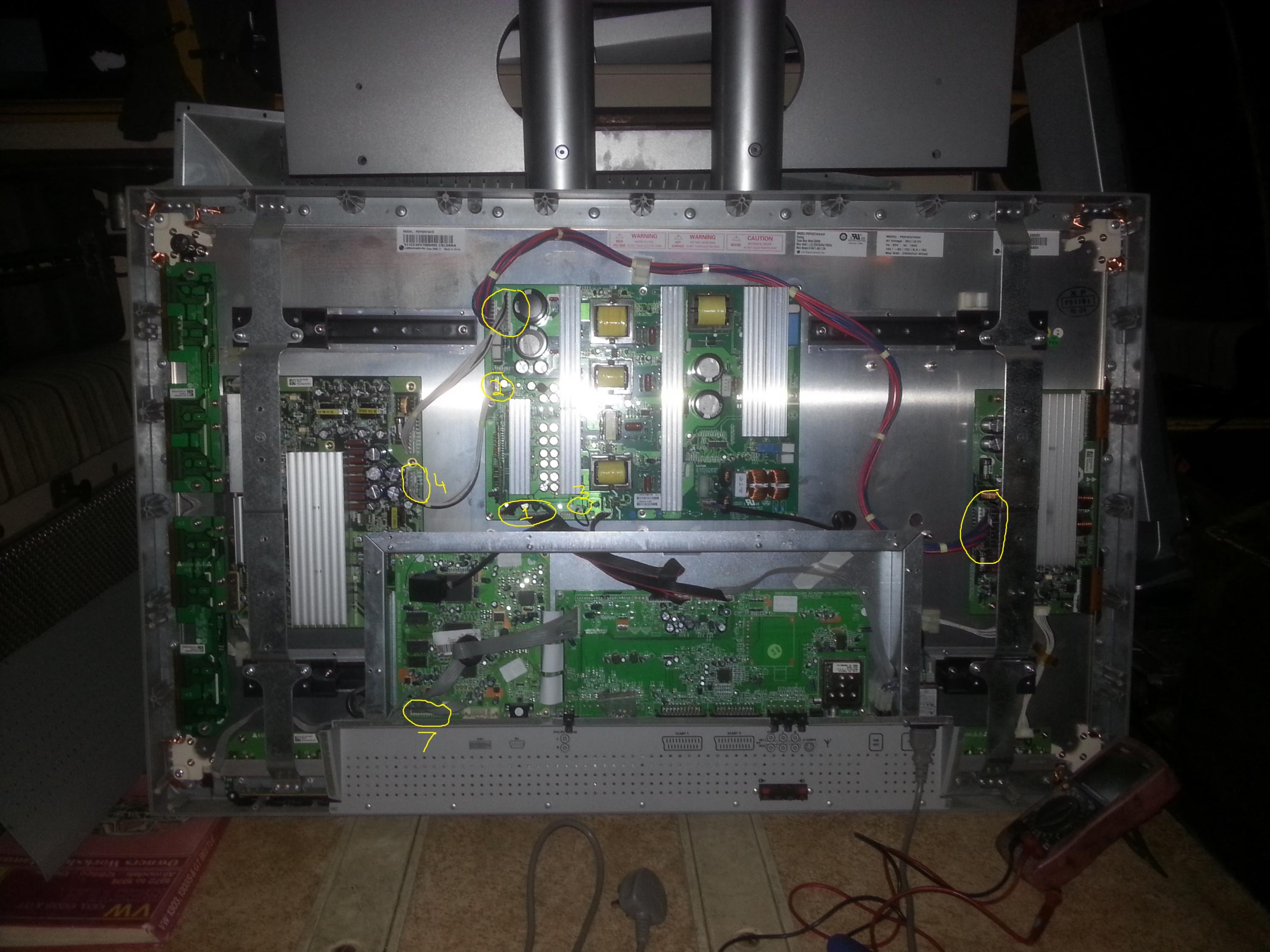

                                    ok so i have measured all the 5v standby and a couple of others and i am still getting no readings at all, they are all marked in yellow
                                    • joehezzer
                                      • Jul 2012
                                      • 251
                                      • England
                                      a bigger picture, the numbers on the pics refer to the first pic then the second and so on, but i think i kinda screwed it up lol
