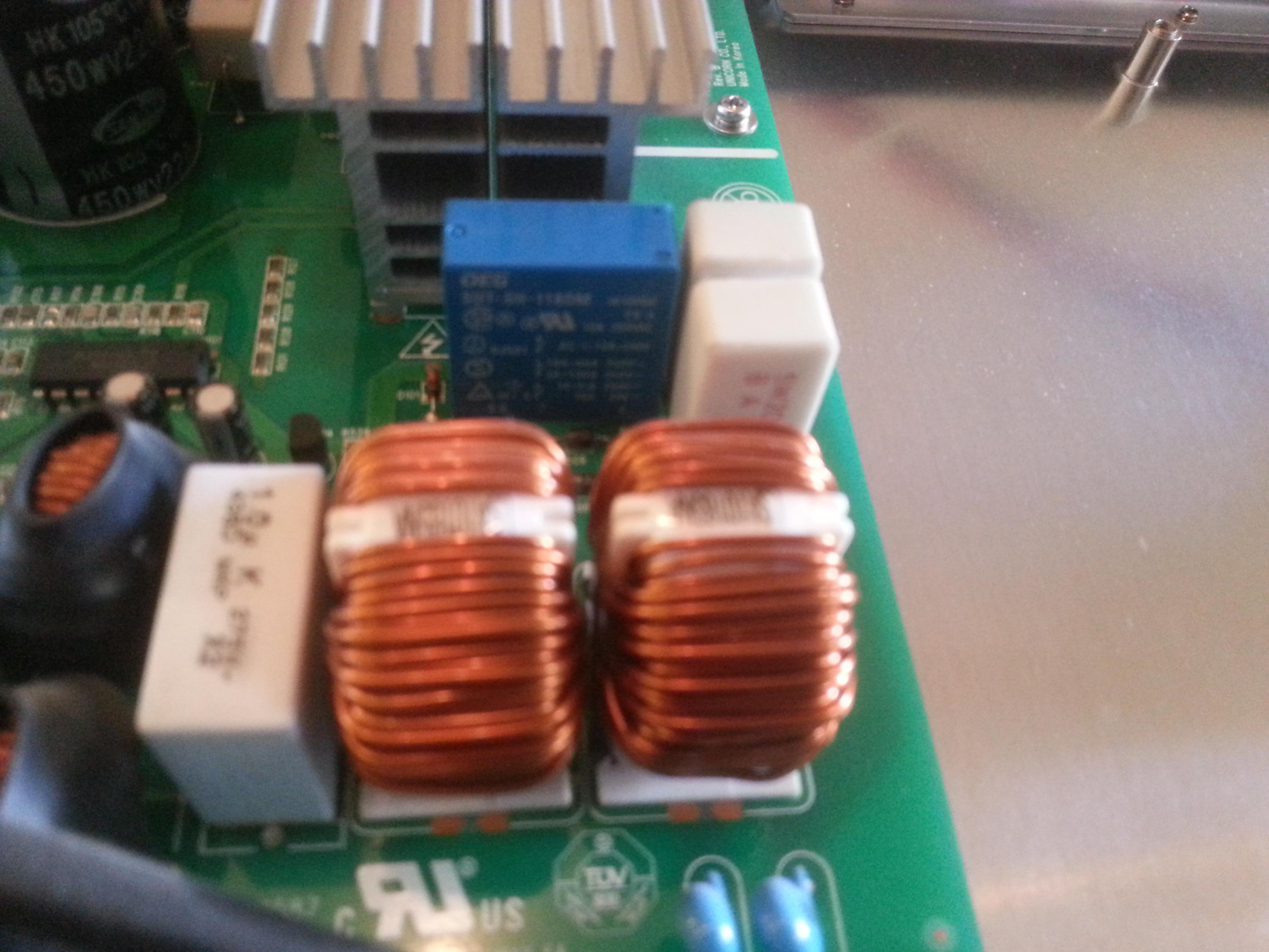

          Joe,
          could you do me a favor and measure the voltage over ZD501 and ZD502?
          I'm having the same problem but at least VA and all low voltages are working now after I swapped some caps.
          See my thread here:https://www.badcaps.net/forum/showthread.php?t=36026

            hi paul yes will give it a go bud, but the problem i have i have no voltage anywhere, i do not even have a standby light nothing, i am wondering if something on the hot side of the board is dead, hence no power any where else, i will check for u though just incase

              In post #14 you said you have 5VCtrl. You should also have 5Vsb.
              What comes out of the PFC?
              If you have 5Vsb you could try to disconnect everything and drive RLY-ON directly from Vsb via a resistor maybe.

                  Ok,
                  1. measure from cathode of D103 to the long heatsink (that's primary ground) . When plugged in you should have immediately 170VDC (for 120VAC input). What's the voltage?
                  2.
                  If you can't measure 5Vsb on CN801 but you can measure Vctrl on CN805 I could check how they are linked.
                  Before turning on the unit through 5Vsb - RLY-ON - VS-ON the only power supply that works is the one with the NCP1203. If you have voltage on the ZD501 and ZD502 this chip works. What's the voltage over these two zener diodes?
                  An oscilloscope would help.
                  EDIT: I think the voltage in UK is 230VAC? In this case you should have about 325VDC from cathode of D103 to heatsink

                        D103 reads 01.2 vdc 01.3 vac i am gonna pull diodes and test them and see if they are shot

                            Oops, that's not good. I didn't analyze that part of the circuit because mine is working. I'll have a look at it.
                            Where exactly you say you had 5V?

                              Do you have a voltage at the output of the bridge rectifier BD101? It's the two outer pins.

                                Very minimal voltage botton pin 01.6 upper pin 01.4 v

                                  its dead all over i found somewhere that the big blue relay could be at fault

                                    If you don't have DC voltage between pin "+" and "-" of the bridge rectifier then it is either faulty or there is no AC coming in.
                                    Measure AC between the two inner pins of the bridge rectifier. If there is none then follow the two traces back.
                                    What's the voltage on TNR 102? The green round component right beside R105 R106?

                                      The blue relay only bridges the two white resistors when you turn on the TV. It limits the inrush current when the two big caps are discharged and you plug the TV in.
                                      Normally AC goes through the two resistors. There should DC on the big caps even when the relay is OFF.

                                        Check the resistors R105 R106. Mine are 20R each. Yours could be different since we have 120VAC here.

                                          voltage on TNR 102 00.3v
