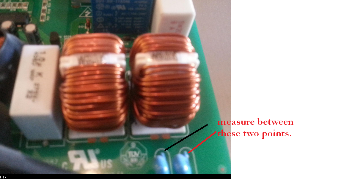

    Perfect. What's the voltage at the points indicated in the picture?
    • joehezzer
      • Jul 2012
      • 251
      • England
      #42
      Re: usp440m-42lp psu
      Bouncing around 00.3 to 00.7 that looks a bit suss
        Are you sure the fuse is ok?
        You measure AC, right?
            Check input voltage directly at the connector. Sure it's there?
                Well, then the problem is somewhere else. I don't have the TV in front of me, just the board. Check the connector/cable etc.
                • paulstef
                  • Dec 2013
                  • 724
                  #48
                  That's very strange. Is your multimeter working? What if you measure the AC directly at the wall outlet?

                      #50
                      There is also an EMI filter directly connected to the AC inlet of the TV. Maybe it's faulty. You could measure the output voltage at its terminals.

                              #54
                              i have not tested it yet but it does smell a little

                                        #59
                                        How did this work out for you? Was it the Filter?
                                        ok so i just tested the filter there is no voltage at all at the filter, so have a new filter on order.
