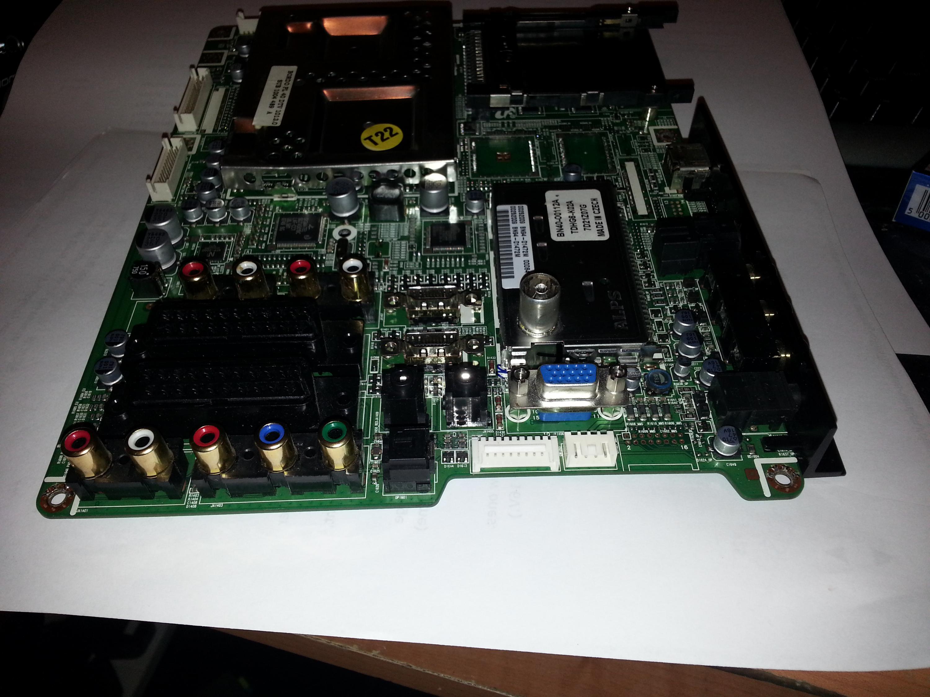

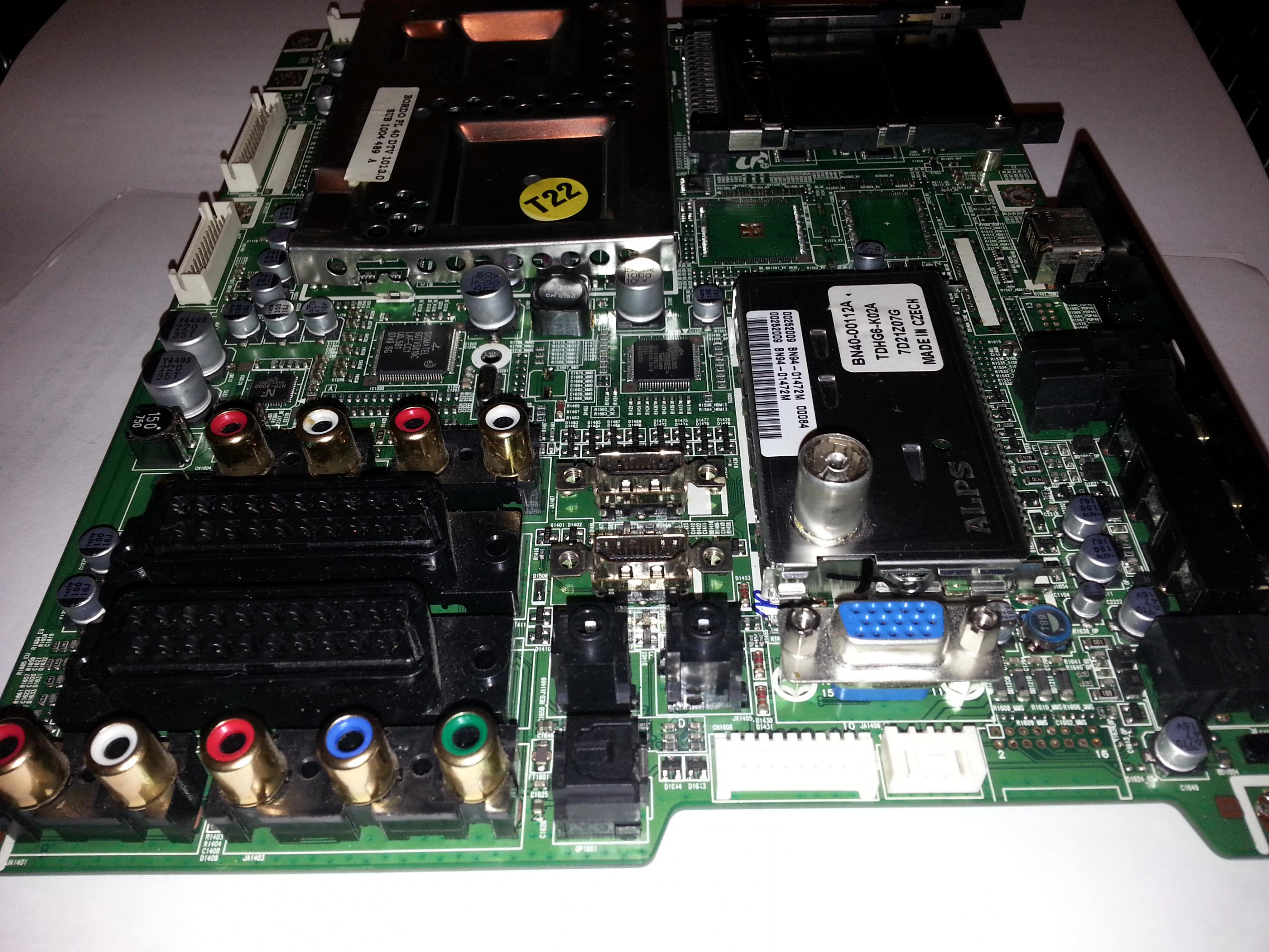

    Re: Samsung LE40R87BD
    Hi All
    Just thought to add a couple of pictures of main board.
    Ron[/ATTACH]

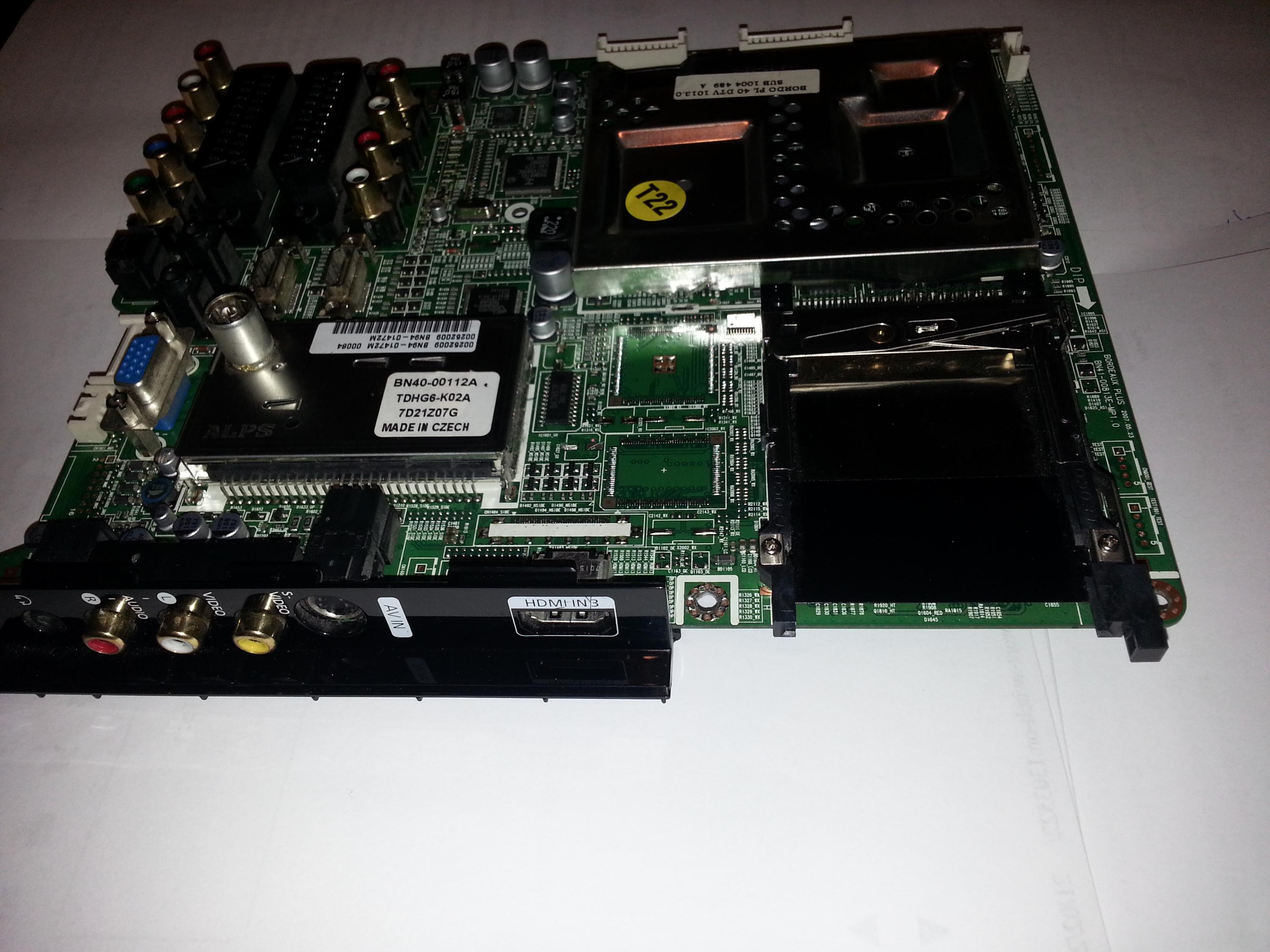

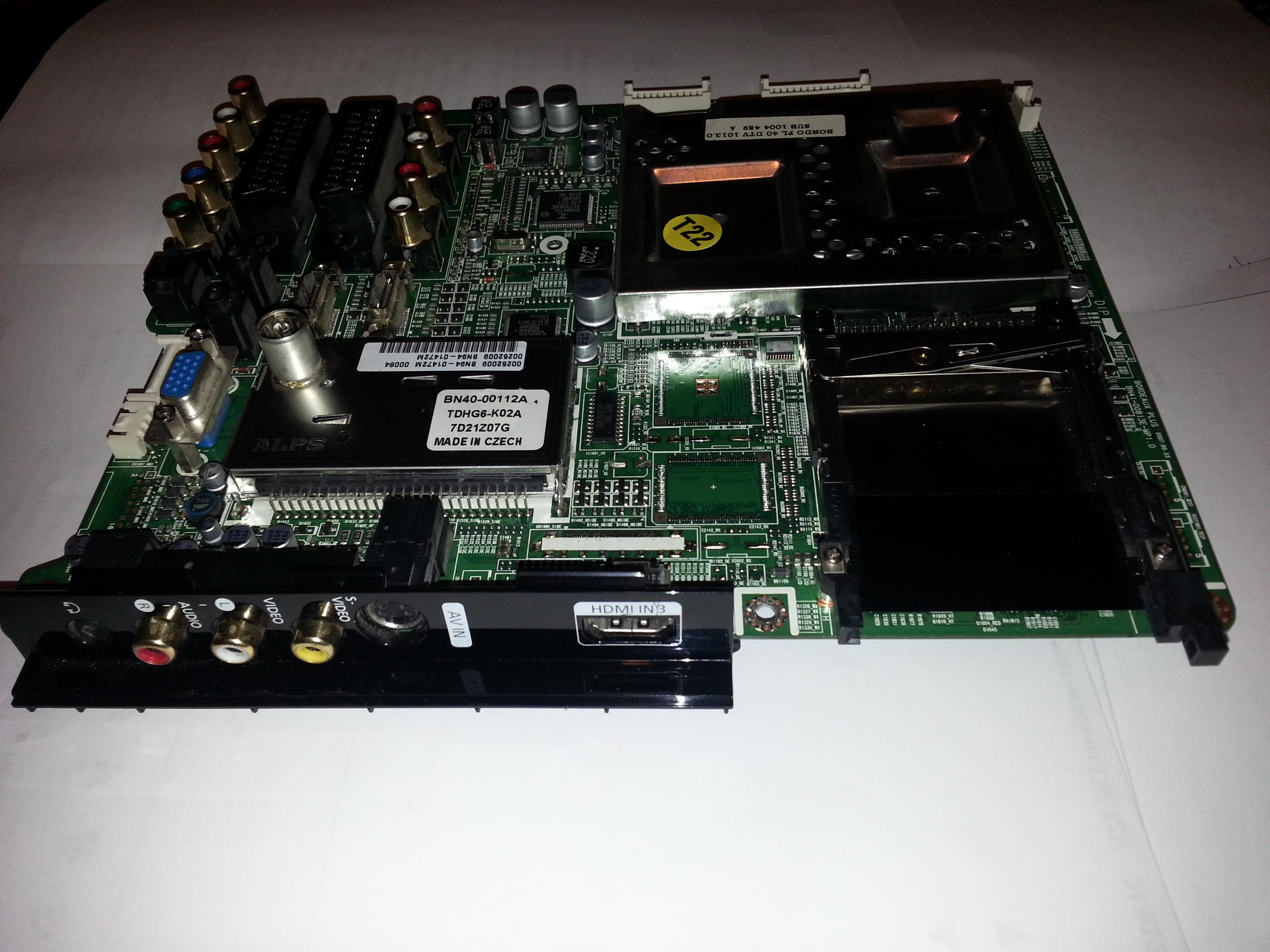

                        Hi Alastair
                        Yes it is a Bordeaux it says Bordeaux plus 2007.05.23 the number below that is BN41-00813E-MP1.0
                        Sticker on tuner has BN40-00112A TDHG6-KO2A, 7D21Z07G, MADE IN CZECH second sticker has numbers BN94-01472M 00084, BN94-01472M.
                        I will also include pictures so you can see what the lay out looks like.
                        If you do have any thing like it I would be very grateful and please let me know how much and I will pay. ( I have a PayPal account and could transfer money if you also have PayPal )
                        I would be very grateful if you could help.
                        Regards Ron.
                        [/ATTACH]
                          BN40-00112A is the tuner module P/N. http://sparedparts.com/parts/details...12a_tuner_unit
                          As I indicated, the blank board BN41-00813E can be stuffed to make many different version of the main boardS for many models of the TV.
                              Right, I had three Bordeaux boards.
                              Chance would have it, I had a 37" Sams. with a Bordeaux in too. It had dodgy caps on 24V line, quickly fixed, so I tested the first two I had.
                              One oldish/cruddy/dirty looking one wouldn't boot--so it got booted!
                              The second boots fine, but cannot test for picture, as the LVDS plug is different on the set--Its the full HD 1080p set, (Very unusual, only the second 1080p Ive seen in 6 months, the other was a 37" LG--now in me bedroom!) and has different panel.
                              I note though, this working/booting board has the same socket type as your board. I'll dig it out from car later and give you its numbers, although looking earlier, I couldn't determine the panel size it was intended/set for.
                              The third, I found later in the day and is so far untested, but is marked, 32".
                              TELEFIX
                              • Alastair E
                                Chief Womble
                                • Mar 2013
                                • 1963
                                • U.K.
                                Right, Here are some numbers for you--
                                top of board, above that interface-socket, printed in white ident- Bordeaux plus 2007.05.23
                                below that-- BN41-00813E-MP1.0
                                Paper label below interface-socket, --Bordeaux IDTV37, 110619 C818 05
                                Paper label on tuner-- HU 10 BN94-1121S 010026874510 0094
                                Small letters, same label-- Bordeaux IDtv 37" AUO 393A 2007.1/1004/1013 BREDA
                                --There's a metallic plastic label on the tuner, but I believe this relates to the tuner, The DNOS403Mxxx number....
                                So--looks like this board is intended/set for a 37" AUO LCD panel....
                                What make/type panel is your 40"? It'll probably work, but you'll need to set screen-size in the engineer/options menus....
                                TELEFIX
