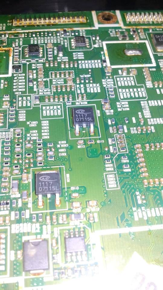

      Re: Samsung LE40R87BD
      Just wanted to know what ic is this. of fixed value 1117
        So what are the Voltage readings right now on each pin?
        • licbal
          • Jun 2014
          • 4
          • Potugal
          On the board is a plate to make protection and that also should make dissipation, underneath this plate is 4 ic and there is the error is that the heatsink is detached from the IC. Necklace also sinks on the ic EM6A9320BI-4MG and does not happen anymore the power turns off.
