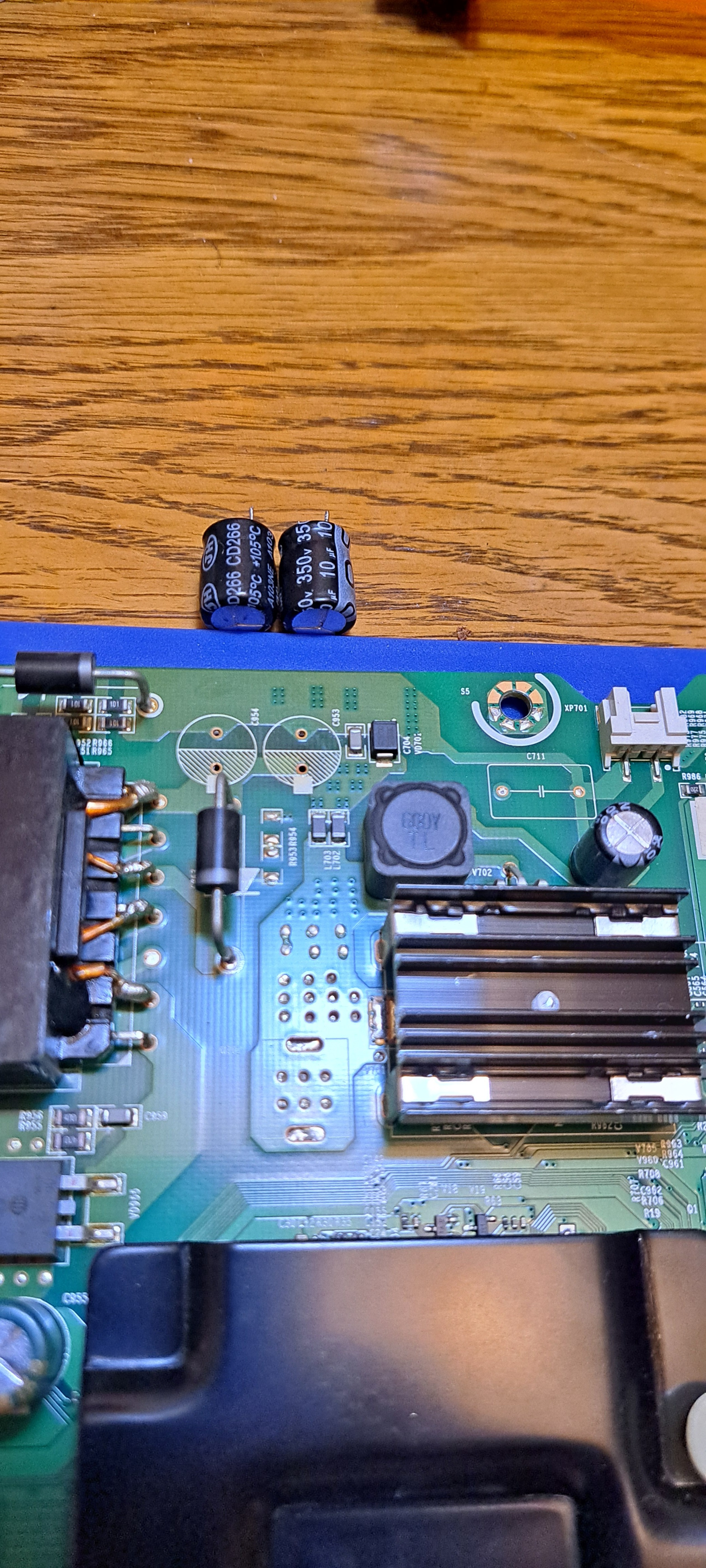

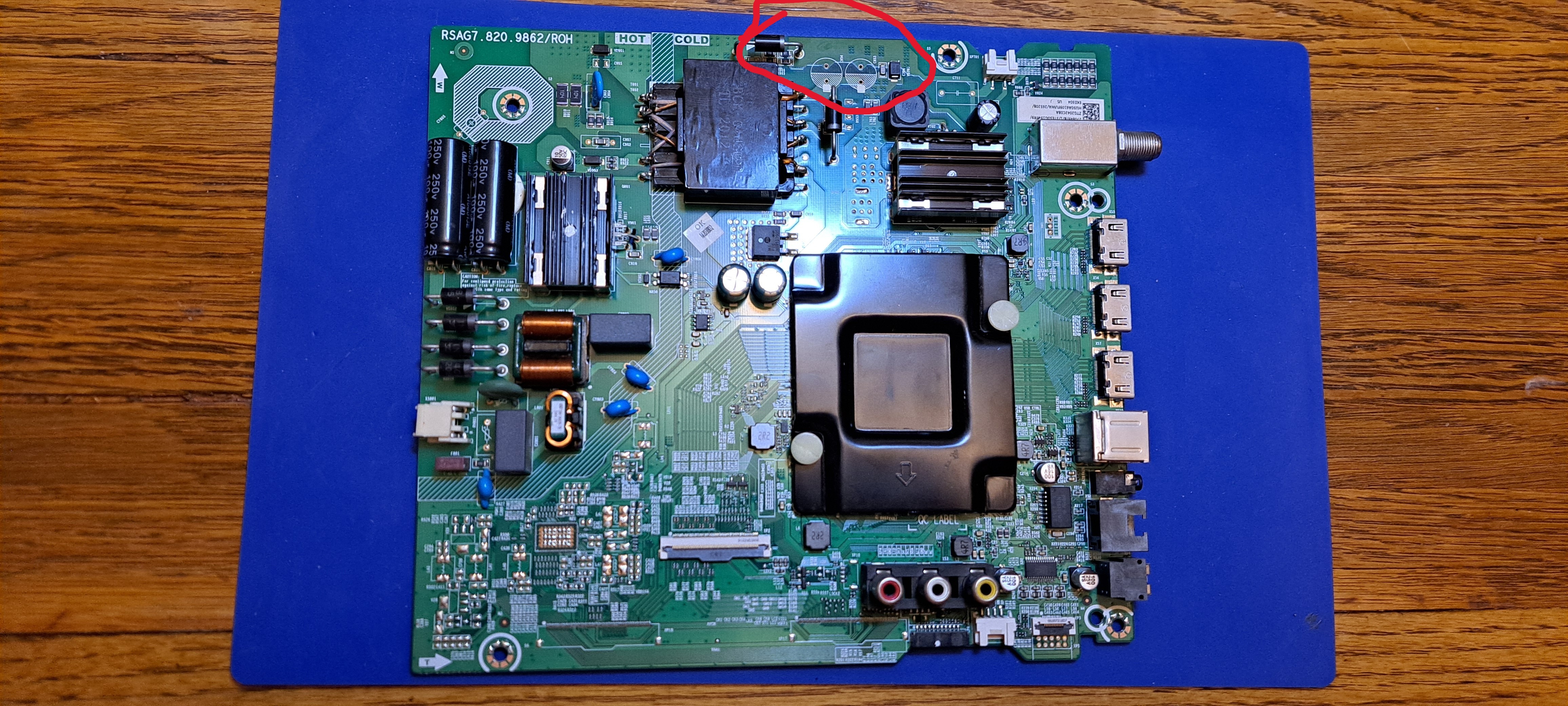

                    I have a Hisense H6570G. It had similar symptoms. It would turn on and get to the Android load screen, and sometimes it would get all the way to the start page, but then it would shut off. If I left it off longer before trying again it would stay on a bit longer before shutting down. The behavior led me to suspect an over heating issue, likely a bad capacitor. I opened it up to diagnose the problem and on visual inspection I noticed two capacitors with bulged tops. The location is circled in red below. The other image includes the caps I removed. They are Jianghai JH CD266 series with values 10 μF, 350 V. Itested them with my LCR meter and got in the neighborhood of 6 pF on one. The other was in the nF range. I didn't have replacements in stock so I ordered them. After I get them replaced I will post the results in case any body else has the same problem.

                        It's now a couple of weeks since I replaced those two caps on my HiSense H6570G and it has been working well. Except many of the shows on it are really dumb. I don't know how to fix a TV so that it doesn't play stupid shows. 😉
