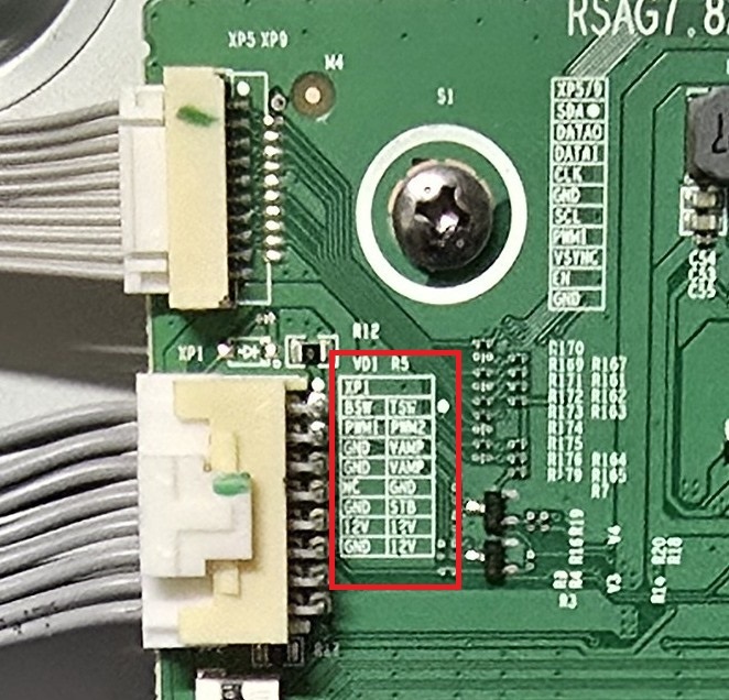

                its one SoC boards. not so complex to follow it
                could you list the V you have on this socket at time only plugged in wall
                also you can unplug the socket on MB which it go to LED driver boards... they will lit very dim at time the tV ON
