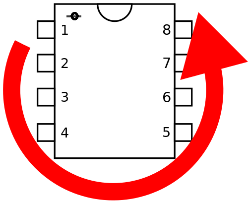

      OK please check voltages on: pin 2, pin 5, and pin 7
      Pins are counted as such, starting from dot:

        hi tom that parts is burnt would that be all that the problerm is ? if so do you have link for that as cant find a match
        pin 2 = 12.83 pin 5 =000 pin 7= 5. my dot is where pin 1 is

          It's actually AIC2857F. Is it physically burnt? Your results indicate it is not functioning, in the very least.
          One on eBay, they're about £5 each
          http://www.ebay.co.uk/itm/1PCS-Brand...item3cc84b952e
          but plan on about 2 weeks to get it from China.
          See diagram here:
          http://www.analog.com.tw/p2_6_detail...idTableName=05
          Pin 2: input voltage, this is OK (12V from PSU)
          Pin 5: output feedback, should be 1.25V - not OK indicating the output voltage is not present
          Pin 7: on/off command, it is >2V indicating the main board processor says "I want power" but converter does not function. (Like a light switch which is on but with a blown light bulb.)

              From the pictures, it looks OK to me.
                Re: lcd19-229 stand by light on and off
                Other places to buy
                http://www.ebay.co.uk/itm/ic-sop-8-A...-/400538572096
                http://www.aliexpress.com/item/AIC28...449252694.html
                BTW, dot always marks pin 1.
