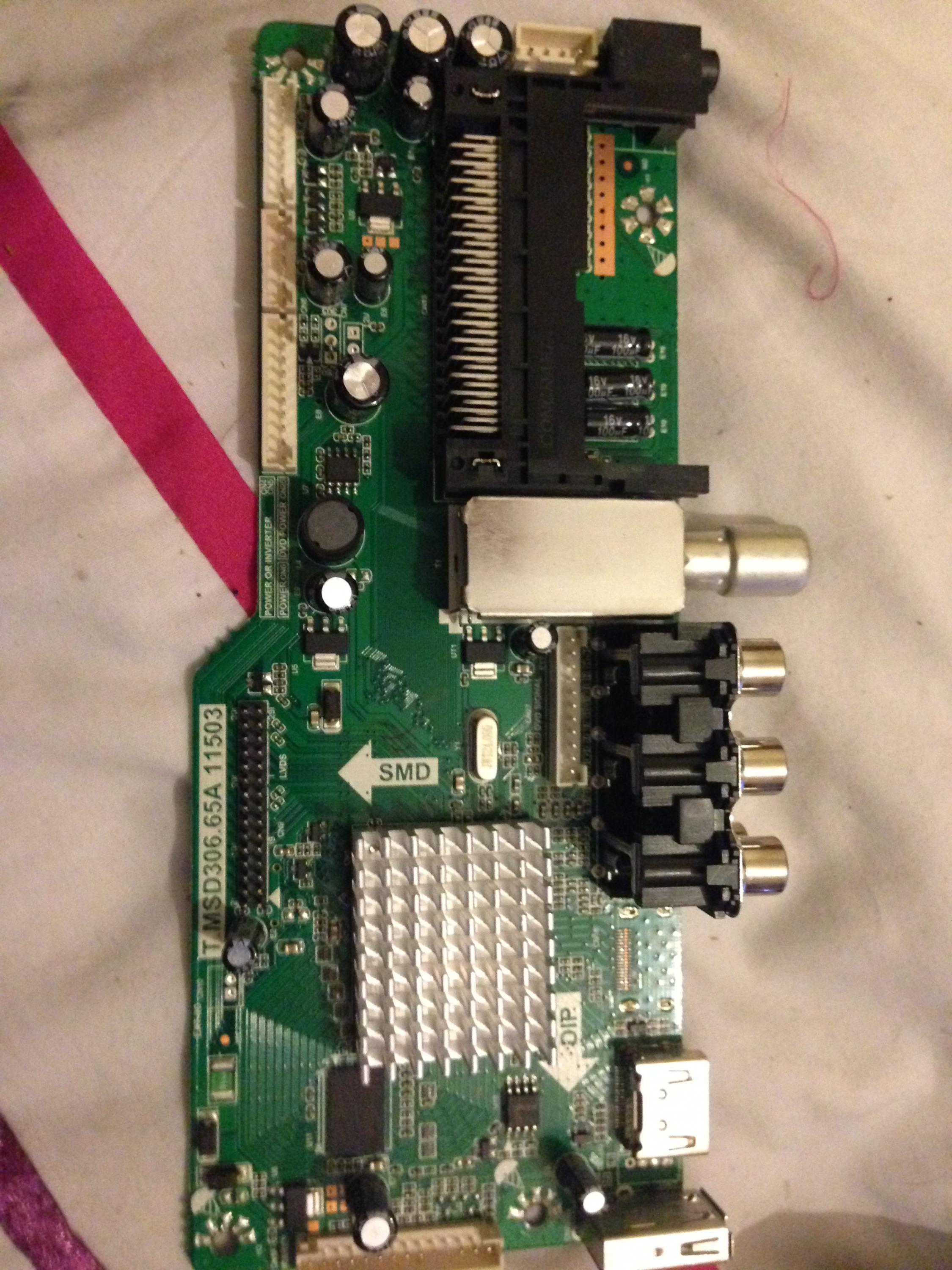

    hi got this small tv dvd tv that wont stay on when i switch on the light turns green then goes back to red see pic off layout
    Re: lcd19-229 stand by light on and off
    common fault on these is bad LDO regulators on main board.
      whats that lol how can i test ?
                pic im still reading up the link tom put but a little lost lol
                so far i know mine r 1117 Regulator

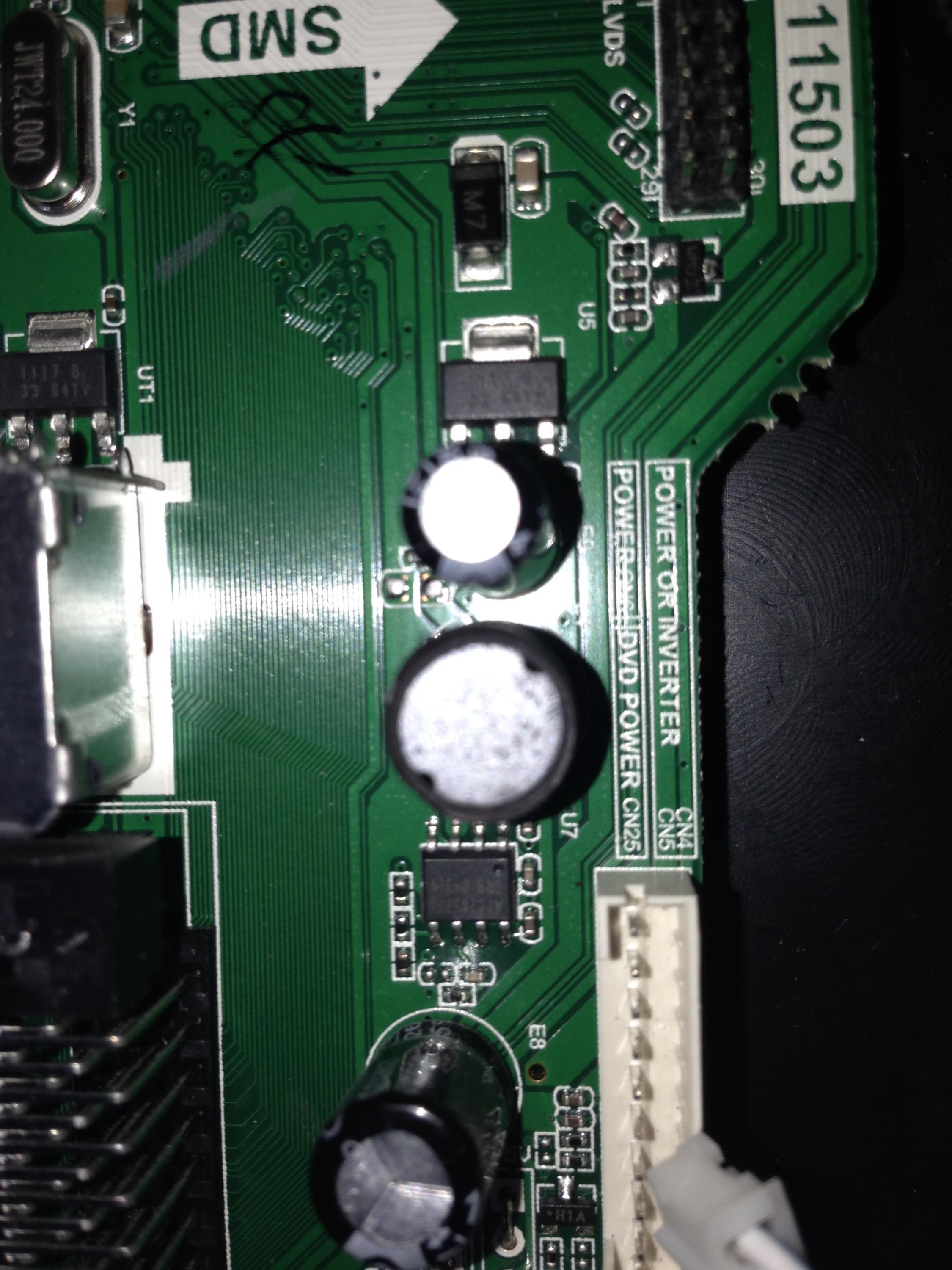

                  3 have 1117 b then under say 33 641
                  1 has 1117 b then under say ade11u
                  so im gues the top 3 r 3.3 volts ? and would test left to right
                    Top are 3.3V, bottom is 1.25V.
                    The voltages should be tested left to right, in the orientation in which the labelling on them reads the right way around i.e. you don't have to crane your neck
                              ok so below is list
                              1st
                              =000
                              =3.31
                              =5.07
                              2dr
                              =000
                              =3.32
                              =4.98
                              3dr
                              =000
                              =3.31
                              =4.97
                              this is the 1.25v
                              =0.61
                              =1.86
                              =3.38
                              this is me testing with light stuck on red stand by black lead to screw red to each pin left to right lol
                                Can you try making the measurements as you turn the set on for the last three? You may have to turn it on and off a lot of times. A close picture of the power supply showing the label would help too.
                                  ok re-done list above with green light on
                                    Hmm, my error on the 1.25V. That is OK, it is just normal adjustable type. doh.
                                    Readings seem good, so there's little more to suggest.
                                    Can you see part U7 near one of those LDOs? What is the part # on it?
                                      yerp u7
                                        Part # printed on device U7 please?
