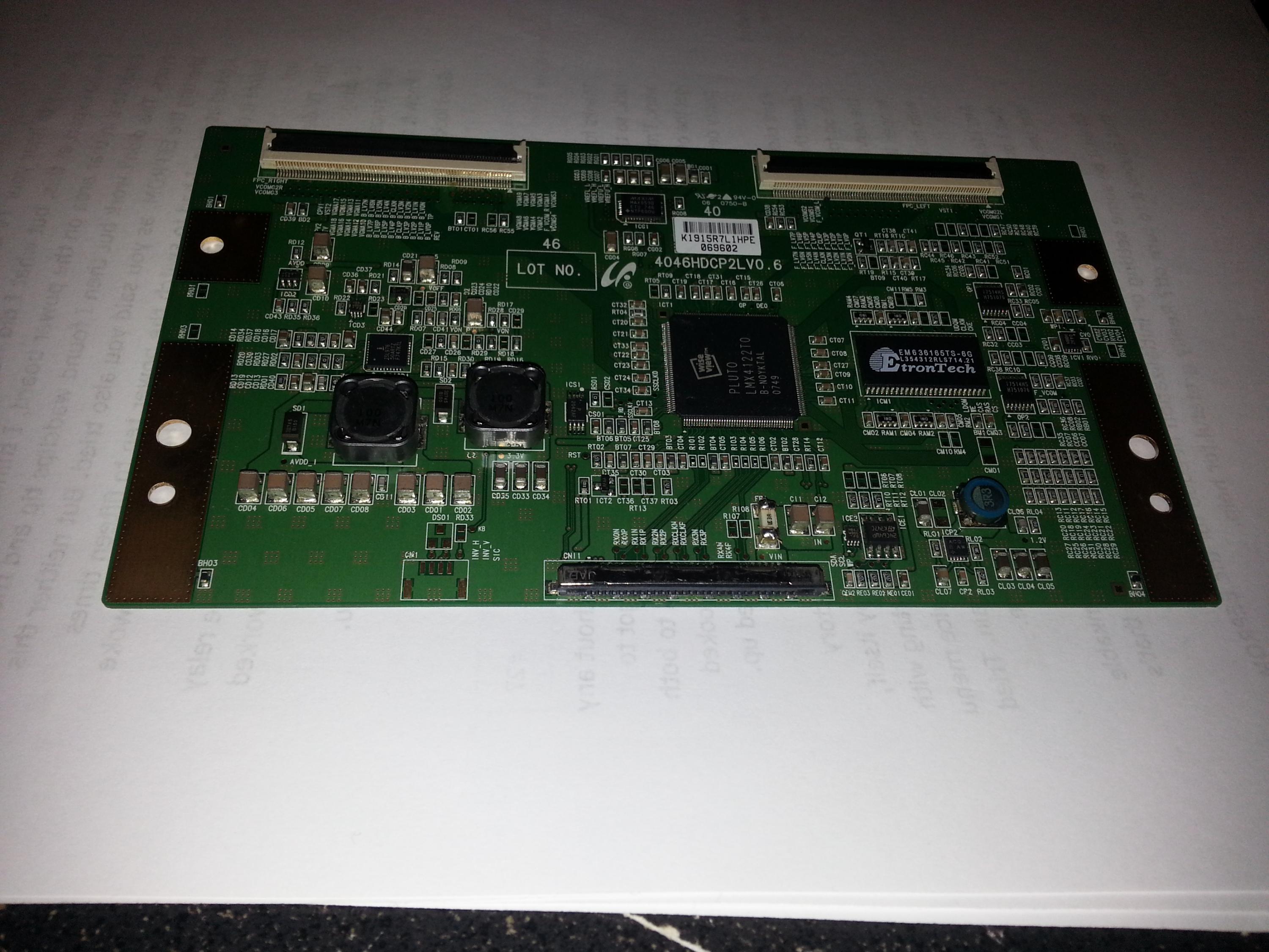

    Can you supply a picture of the T-con board?
    It is possible you got a defective board.

      Thank you for answering me hoping I can attach the pictures, here goes.
      Hope you can open these tom66 the one with orange label is replacement one without is the that was in set.

          Re: Samsung LE40R87BD
          Sorry missed your post - have you checked the voltage each end of the fuse?
              Check the voltage on each end relative to chassis, with TV powered, will tell you if main board is switching 12V/13V on (it is switched separate to the main rails.)
                I have 13v both sides.
                    Eeprom IC 1803 is corrupt. Change it to a blank 24C256.
                    When you start the tv after you changed the ic it will
                    turn on and off two times. On the third you will get the picture.
                    You had to check the options in the service menu.
                    Inch Option and Panel Type.
                            Your readings are indicating the main board is working, sending 13V to T-con. You can try checking AVDD on T-con next.
                                I am getting 14.7v there
                                    Tom66
                                    Is this voltage 14.7v at AVDD correct ?
                                      Yes.
                                        looks like T-con board working ok?
