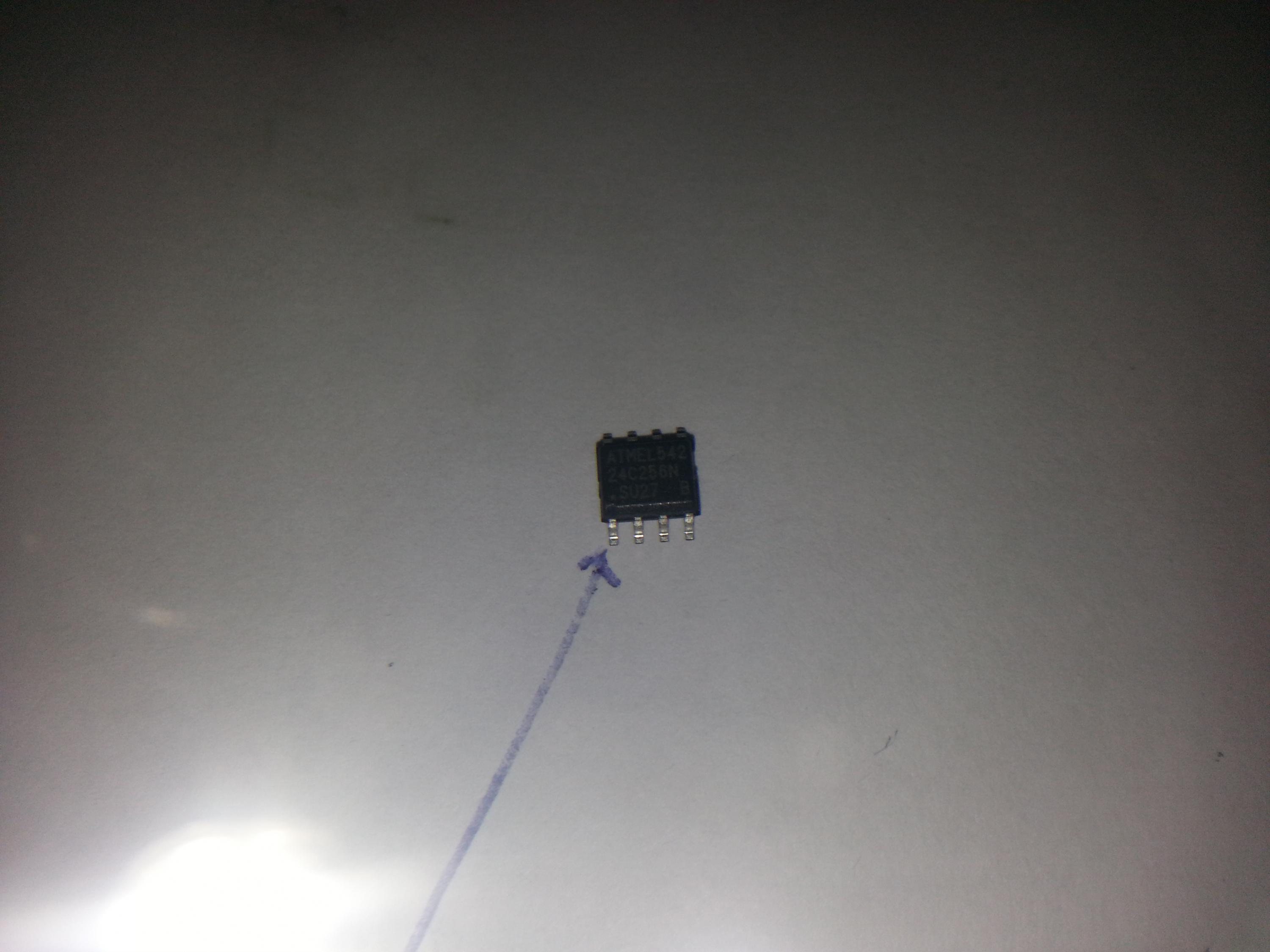

          Re: Samsung LE40R87BD
          Hi All
          I am still having problems with this set I have replaced the ic 1830 as suggested for a blank 24c256 but still same faults (sound but no picture ) and the set still starts to switch its self off/on continually after 5 mins.
          I will include a couple of pict of the 24c256 hoping some one can confirm pin one where I am pointing with a arrow.
          Any more help would be much appreciated with this set.
          Ron
            Change the main board, I've had a couple that have cut out after a few minutes of being on, no guarantees of course but it is what I would try next, good luck.
              Hi Dang
              Thanks for your reply , when you say change the main board do you mean the power/supply board or the board with all the scarts,tuner and other connections on it ?
              Thanks Ron
              • vinceroger69
                • Mar 2012
                • 6714
                • uk
                the main board is the one with the tuner and scarts on it.
