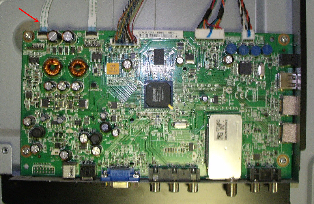

    Ok, guys here I have a Westinghouse LD4655VX LED TV that is totally dead no light on the front or anything. Only one board inside and I tested the power and do have 19 volts coming in to it but not sure what to check next. All the caps look ok and nothing looks to have gotten hot.
    Re: Westinghouse LD4655VX Dead
    A little more messing and I find if I unplug the ribbon cable to the right side if the screen I can get the tv to turn on but of course only showing the left part of the screen. I have what cable marked in the picture. Would that mean the LCD screen is crap?

      maybe bad strip of led's? or 1 bad led on the strip?
        So does that control only the LED's?
          Agree. Those are the led backlights. You could have a shorted cable to ground. Ohm out the cable. Should be infinite resistance all around.

                    Looks like the infamous Westinghouse shorted cable. You will brobably find the shory where it connects to the LED strip and bends around the frame of the strip. Sometimes you can fix it with some tape I've done it twice. While you are in there, put tape on the other one too.
                      That's what it was alright. If someone needs this fix watch this. http://www.youtube.com/watch?v=N_zPWgEitjE
