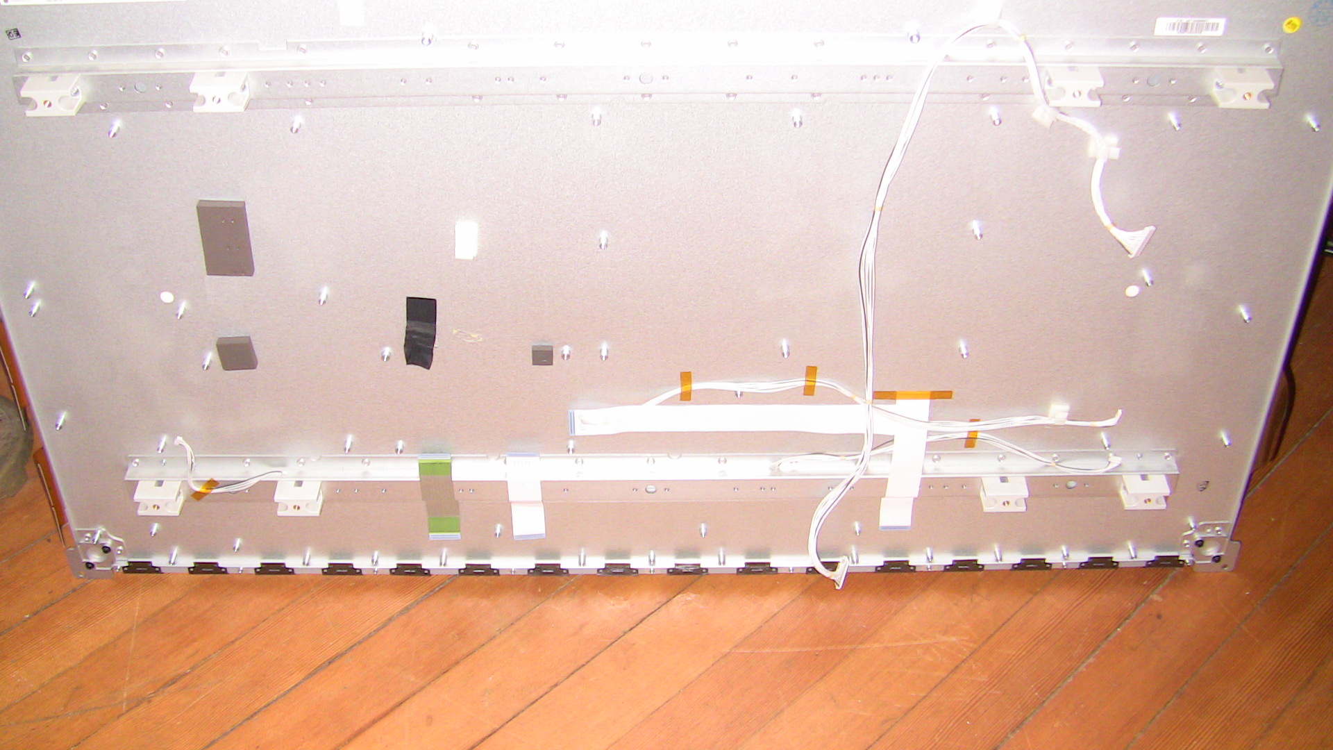

    I have a new set that I'm working on with this single vertical red line that is always there. I had the idea that it was from the boards at the bottom of the set and possibly could be those flex cables just not making contact or the panel was bad. I had a panel around from a P50HDTV10A with those boards already in it so I moved all the other boards over to it but it didn't seem to work. I think those driver boards are different between the two sets. I ended up moving all the boards back to the original TV and though I would try a few more things and maybe ask for help.
    Is it most likely that the driver board at the bottom is bad? (I think there might be a driver chip in the flex cable because that's where the heatsinks actually connect. It seems to me that the entire chip in that flex cable might be bad and not just a single vertical line. Any opinions??

    Bad plasma panel. The chip on ribbon will have failed which is bonded to the panel and is non replaceable. Sorry..

      I have 2 more panels but they are from a P50HDTV10A. They are the same panels but these driver boards seem to be laid out differently but have the same connections.
      After quite a bit of work I realize the panels are NOT the same. I had the idea that the only difference between the 10A and the 20A were that the boards were updated and there was a firmware change. I guess I need to look to see if the resolution is different.

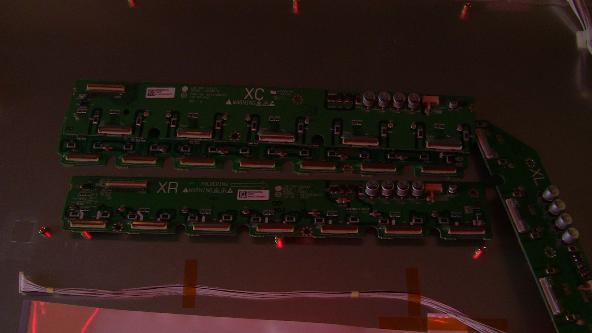

          I should have looked at the 2nd pic, yeah that's a mismatch. ones a 50X4, the other 50X4A, both would be same resolution though, unlucky.
          Models with 50X4A

            The driver boards connection to the control board is the same between the two sets. Do you think it could possibly work? to use the guts of the Vizio 20A with the 10A panel and buffer boards?
              Re: Vizio P50HDTV20A Single Vertical Red Line
              If the LVDS cable and pin out is the same, probably. Make sure to swap over the control board too.

                Do you mean to keep the control board to match the driver boards or the rest of the electronics? My plan was to change over everything from the 20A to the 10A Panel except to leave the 3 driver boards from the 10A attached.
                So it's like this
                Z, Y, Control, Main, power supply from the 20a
                Panel and L,C,R driver boards from the 10a.

                  You need to match the logic board (an LG part) to the panel electronics, or it might not work. The logic board's firmware is custom for the particular panel electronics and panel design; with wrong firmware it will likely not work, or have a poor image, or worse, it could damage the sustains or panel.

                    I wound up with everything from the 20A on the 10A panel except the driver boards on the bottom (XR,XC,XL). Everything wired up fine but when I turned it on it was just a blank display. No sparks or funny colors on the screen. I ended up just parting it out at that point but was curious to see if the 20A "Main board" would work in a 10A set. I found that the Main to control cable has changed as well as the cable that goes to the buttons bank. Moving the cables across along with the 20A main board worked fine and I got the 20A main board working on the 10A electronics. This is great because there's some nice enhancements on the 20A over the 10A.
