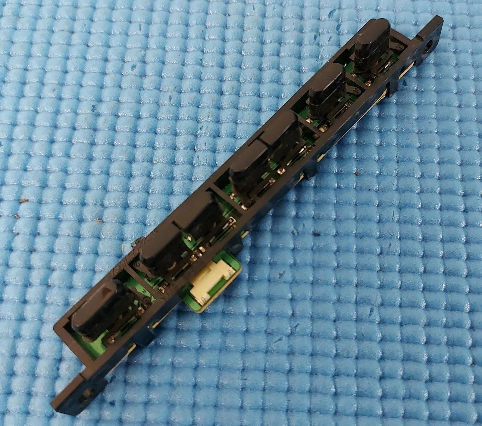

    I have an issue with my Samsung TV - it can't be turned on by the remote control.
    I can turn it on using the power button on the TV but then the channel up/down buttons are not working and the volume up/down buttons are changing the input source.
    The stand by LED is flickering when the TV is on.
    The inverter board is model BN44-00265A.
    No visible damage on the capacitors.
    Any idea what can cause this issue?

      PS board is not your issue obviously, if the set has soft touch controls then the buttons board can be faulty, or bad solder on a bga on the main board, or if present ruined software on the standby microcon

        You were 100% right - the issue was caused by the buttons board, I disconnected it an everything is back to normal!
        I didn't expect that board with so few elements can cause such issue.

          Well, the board can be salvaged, remove one at a time, in order, first the DS (diode suppressor) then the ceramic caps (brown), one of those are leaking..

            The problem here is that the buttons are leaking, either replace them or spray them with Contact Cleaner aerosol and press them many times and the leak will disappear.​

                  It's certainly not static electricity that Davi.p suggests! It is not a touch sensitive board but a switch button board BN41-00989A As Lotas has stated it's the buttons leaking continuity. I have done this repair on this board many times before. You can carefully disassemble the buttons and clean them with WD40 or equivalent Contact Cleaner spray, I usually clean the contacts with wet and dry inside the switch and on the round contact inside. Be patient taking apart all of the contact switches with a small flat bladed screwdriver. If your not capable replace the BN41-00989A or just remove it from the connector!

                        Buttons deteriorate (leakage appears) not because of frequent use, but because the silver-plated membrane and contact pad oxidize and begin to turn black, and this oxide begins to create resistance between the contacts inside the button, creating false positives!

                            Let me explain a little further the switches have when this fault occurs has a resistance within the switch ( call it leakage). The solution that I have found you need to physically clean contacts I use wet and dry sand paper first inside the switch (replace the switches if you wish however finding suitable dimensions for them can be tricky to find). As good measure I then use electrical contact cleaner inside the switch. Reassemble the switch and on to the next one. All of them must be done to prevent any reoccurrences.
                            I have found it is very tricky to determine which of the switches is faulty or partially short circuit with a meter. This is as a result of using voltage levels to turn on the relevant functions on the main board, this is achieved by putting different value resistors in line with the mechanical switches on the same common wires. The problem is the switches use common wires for signalling on so you don't know which switch or switches is faulty as you would be checking in parallel with the mechanical switches and resistors. So I always opt for the best approach is to clean them all, particularly if one has failed the others are likely to follow suit at some time.
                            The button assembly has plastic buttons in front of the unit as pictured so static is unlikely to play a part considering the physical dielectric of the plastic.

                              Had the same problem on my 52” version. Kids and their chocolate fingers did the same thing to my TV. I took the button board out and cleaned it with 99% IPA followed with deoxid. Worked perfect afterwards and is still working to date despite the TV being old now.

                                      I used baking soda and white vinegar to clean buttons membranes and everything got back to normal.
