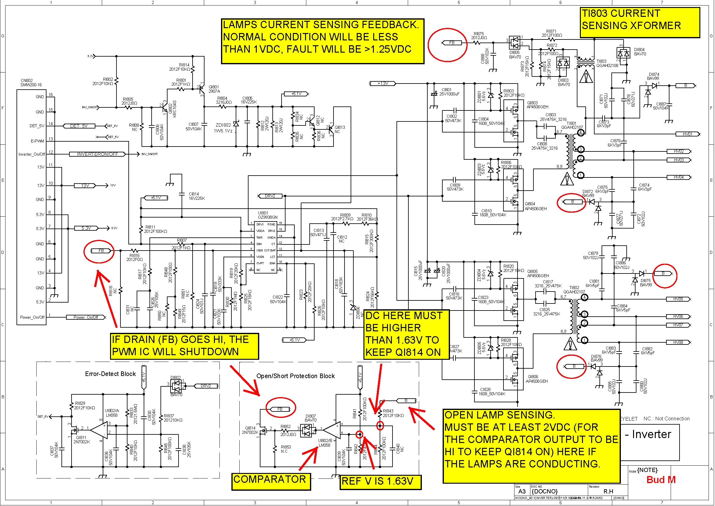

      So basically if i understand these guides, you turn the power on which in turn turns the invertor on, it is at that time the invertor sends the start up voltage to the lamps. if after a short period of time the invertor does not detect the proper current draw from the lamps, it shuts down. Would that be a correct assessment?
      So in the case of a 42 in tv it is looking for a certain current to be maintained once the bulbs start up. if it does not maintain then it shuts down, which is why the quick blip.
      I was looking at that CCFL page you linked and was wondering, if i tried one of the 13 watt tubes like shown, wonder if that would draw enough so that it would keep the invertor circuit on?
        Re: Vizio E420VL problem
        "So basically if i understand these guides, you turn the power on which in turn turns the invertor on, it is at that time the invertor sends the start up voltage to the lamps. if after a short period of time the invertor does not detect the proper current draw from the lamps, it shuts down. Would that be a correct assessment?
        So in the case of a 42 in tv it is looking for a certain current to be maintained once the bulbs start up. if it does not maintain then it shuts down, which is why the quick blip. " Yes that can be symptom of bad lamps but can also be symptom of bad inverter circuits, bad power supply feeding the inverter circuits, also bad BL_ON signal that only appear for seconds instead of being there and stay there when TV is ON. The symptom can be caused more than one source of the circuits.

          Ok Budm, heres a question concerning the CCFL backlight, a guy told me that if i were to jump the black and brown wires which are ps/on and I/O it would permanently turn on the power supply and keep the CCFL inverter on.
          I think this is a wrong statement. Because everything i have read seems to indicate that the invertor sends out the startup pulse, and like you said then starts monitoring the current, if the current does not match what it expects to see it shuts down the invertor circuit.
          Now i have opened up the back of the screen and personally inspected each lamp, they all seem to be plugs in solid, no black on the ends none broken.
          So i am curious if anyone happens to know how to figure out what kind of current draw the invertor is looking for and if the invertor can be fooled using a resistor or some other device. This way i could eliminate the back lights as the cause for the power supply shutting off the invertor.
          From my basic limited perspective on things i am thinking it is the power board that is goofy, but my friend says no it is the main logic board.
          It is really frustrating.
            Did you try turning on the TV and see if ALL the lamps come on for seconds before shutdown, the circuits also detect if the lamp fired up but not staying on or open lamp. I have no idea what the I/O pin he is talking about.
            This is some example of the detection function.
