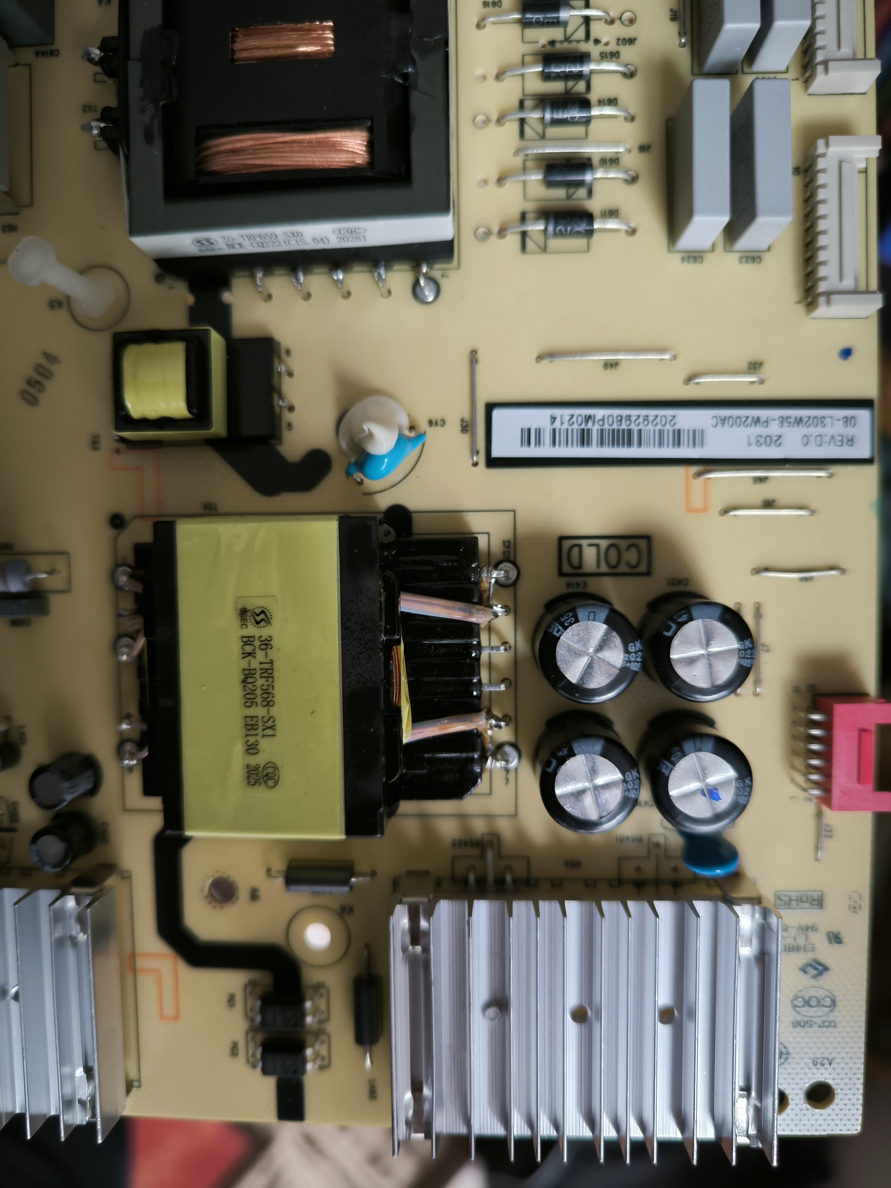

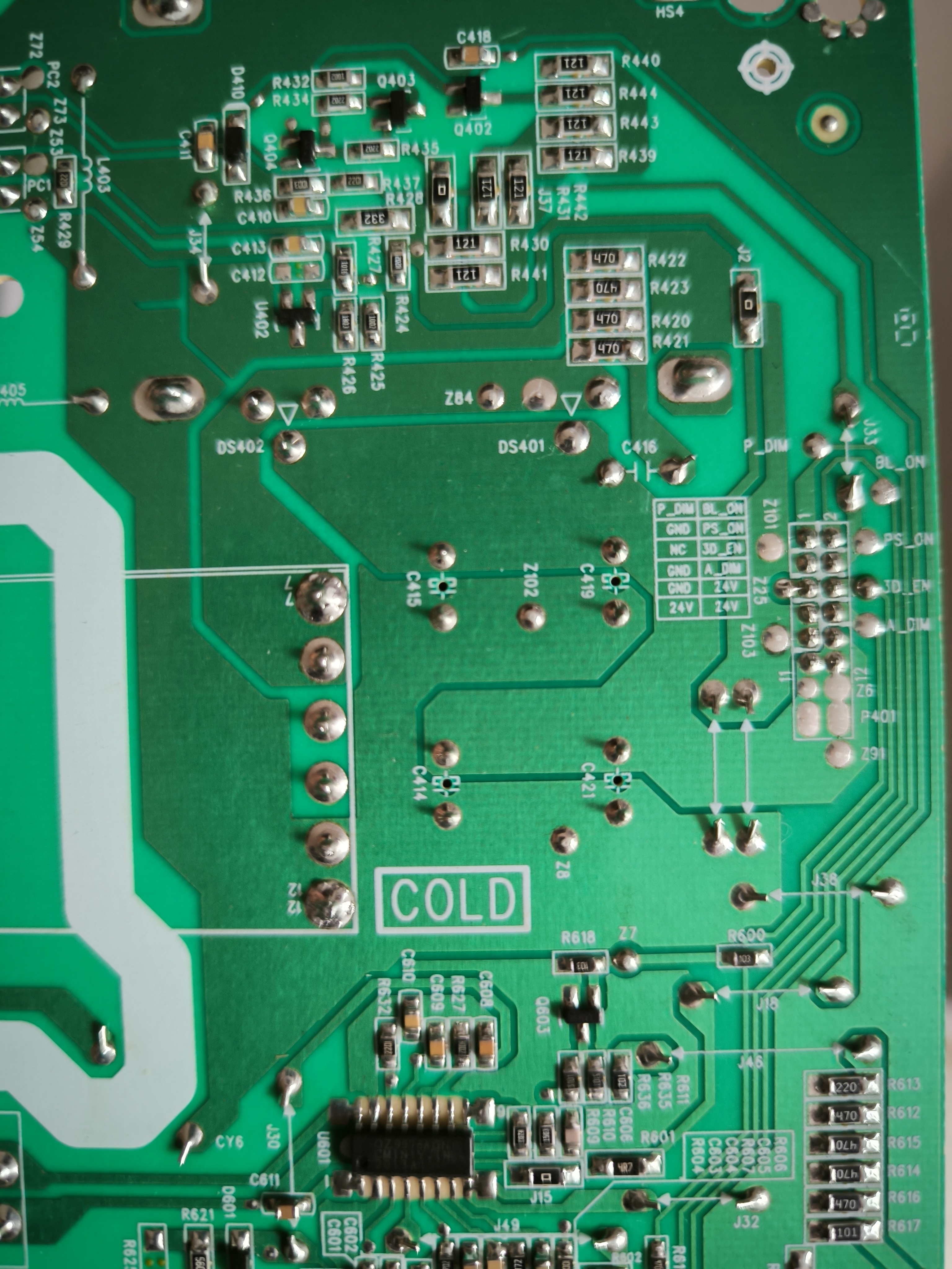

    You mean that the BL ON signal is not sent to the PSU by the motherboard.
    BL ON is not so easy to take, but measured it and was present.
    I'll take the requested picture tomorrow.
    ​​​​​​Regards

        Several tvs have main board send signal to PSU for backlight. How are you certain this isn't that way. But understood on legend. If you don't believe that's a possibility then it's PSU and LEDs.

          I've checked that point and i have the signal.
          Please find attached the requested pictures Click image for larger version

                                  I've completely dismantled the TV to take parts that can be sold. It's a huge mess; everything is glued, so it's quite impossible to fix a backlight issue.
                                  I measured all voltages LED by LED. The LED tester shows 6V directly on the majority of the LEDs, but on some, for a few milliseconds, I can see 9.2V, 15V, or 153V before reaching a steady 6V.
                                  It's as if the internal resistance needs to heat up a bit before becoming steady.
                                  This could be the root cause leading to PSU protection mode.
                                  So based on that I don't think I'll sell any LED strip
