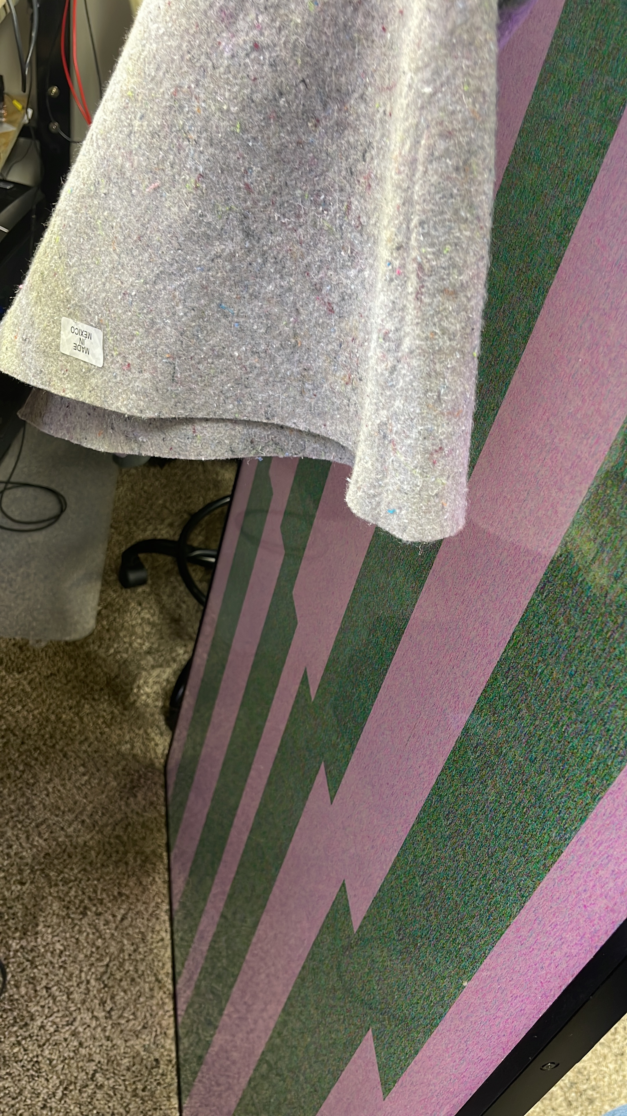

    Hey everyone, I have a Sony Xbox-65x900e with static lines. I’m assuming either the panel or t-con. Any suggestions before I start diagnosing? Service manual says T-con, panel, or B* Board (which I have no idea what that is)

    Xbox...ahah.. is it LCD, OLED? Has it good sound when RF input is present? It sounds mainly bad main board, do a screen self test with 12v jumper from PSB and MB lvds out detached

      Haha thats blasphemy! So I spoke to one of my guys in France and he stated it was FRC chip, I took a quick look at the service manual and I think its the MFC11. I found a listing on ebay that was a repair service for the main board and it had the picture I posted. I need more equipment for the SPI to flash these IC's but I dont have the income or time. So I'm going to replace the mainboard and I'll post my results.
