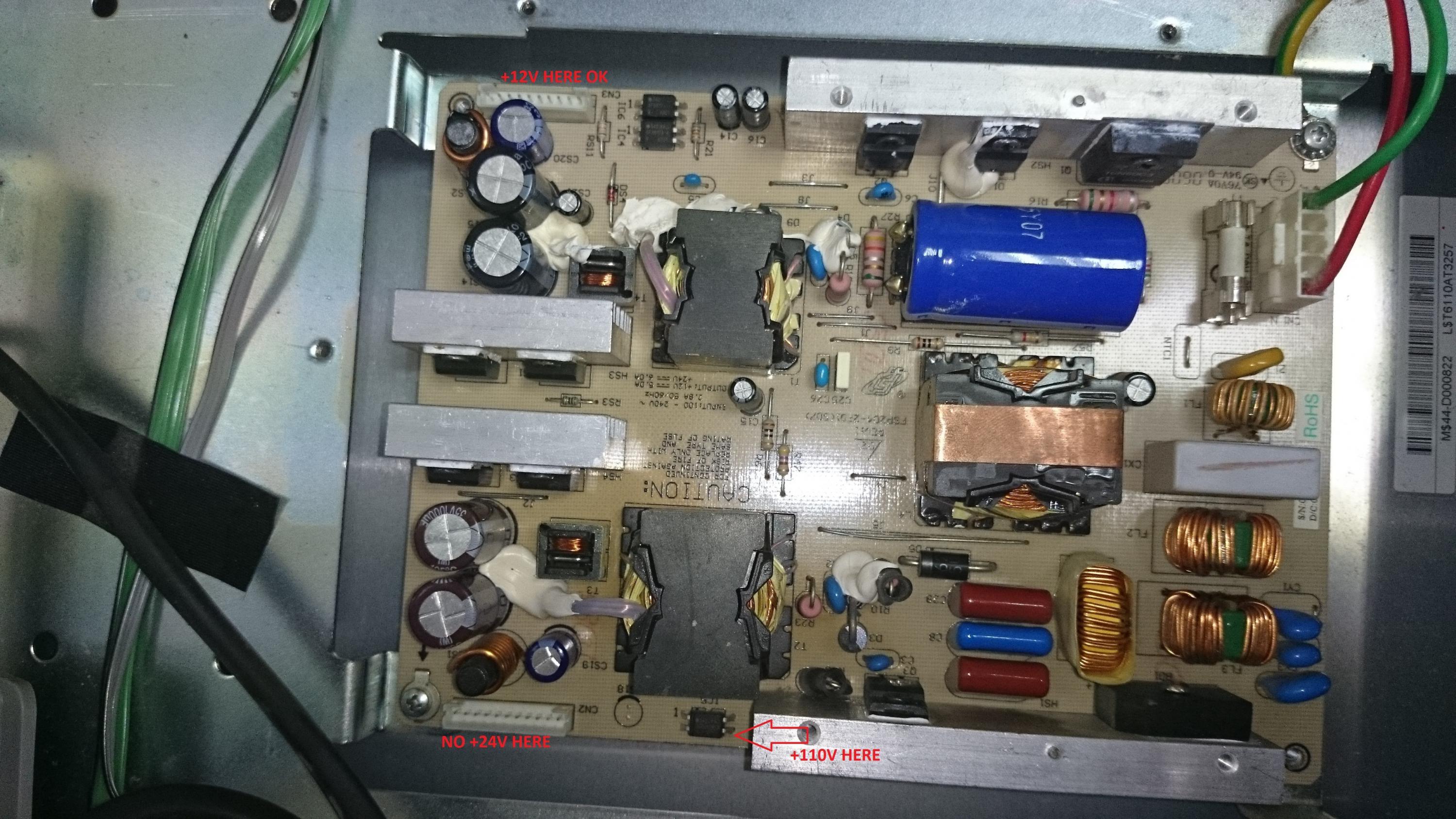

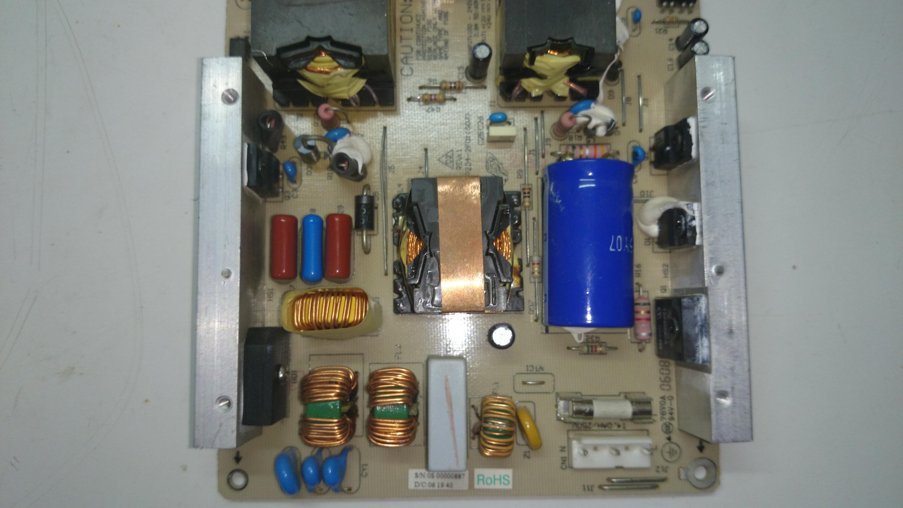

    Hello all,
    OKI TV 32" that wont power on.
    The power supply have the reference FSP204-2F01 and it have 2 connectors, CN3 +12V and CN2 +24V
    I replaced CS12, CS13, CS15, CS15, CS19 and CS20 bulged capacitors. Changing these made no difference to the TV and I still dont get +24V on the CN2 connector.
    Any help is appreciated!

    Good clear pictures of the board, both sides?
      Re: OKITV32HDA with power supply FSP204-2F01
      Uploading pictures...
        OK, on the two legs of the blue 450vdc main filter cap, do you get around 370~400VDC right at the two legs when the power switch is activated? When you work in the primary side of the circuit, the negative leg of that main filter cap is the Ground ref point for your meter, not the chassis. BTW, do see any indicator lights on the front of the TV? IF not, the voltage regulator ICs and the fuses on the main board will need to be checked.

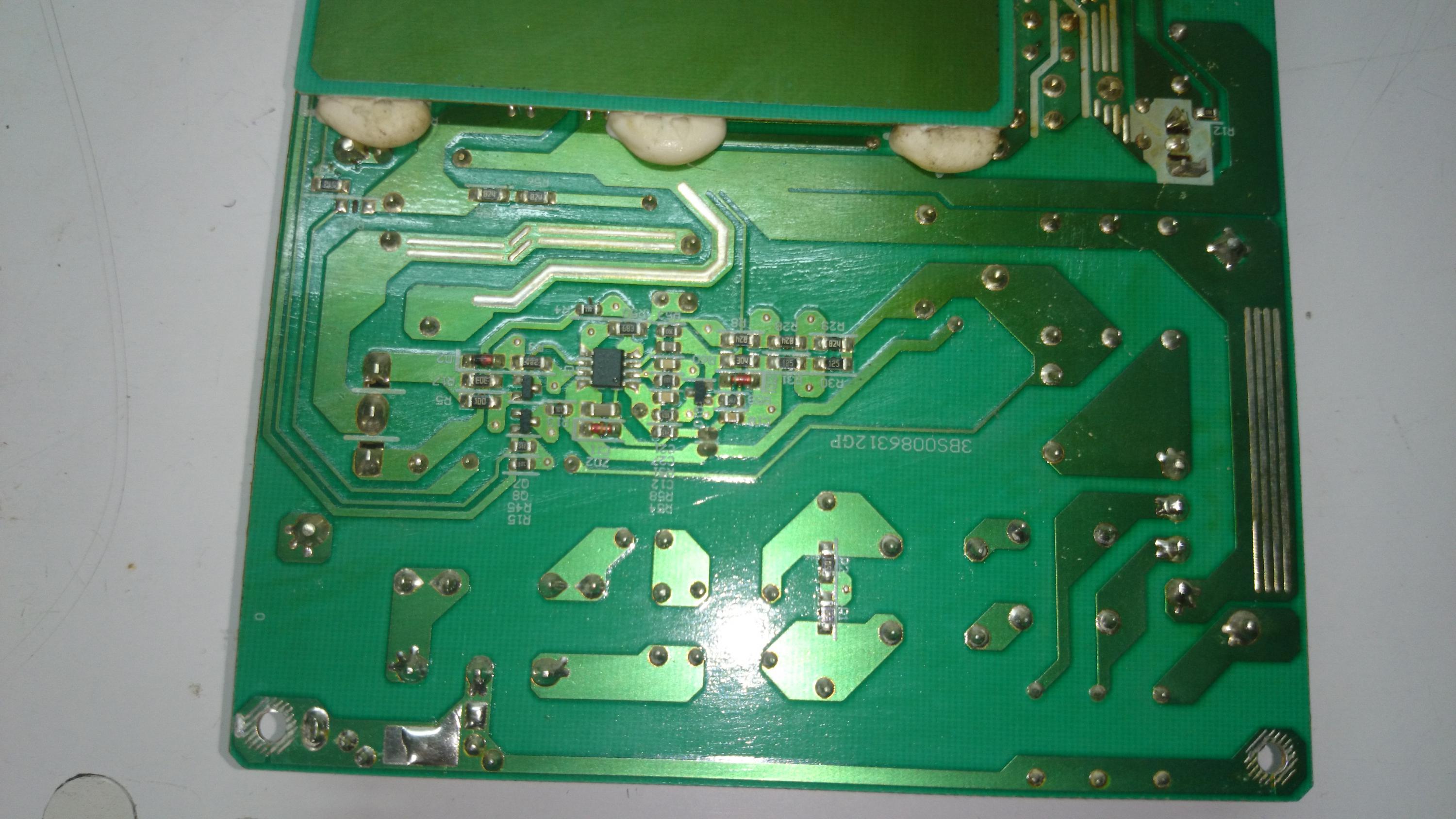

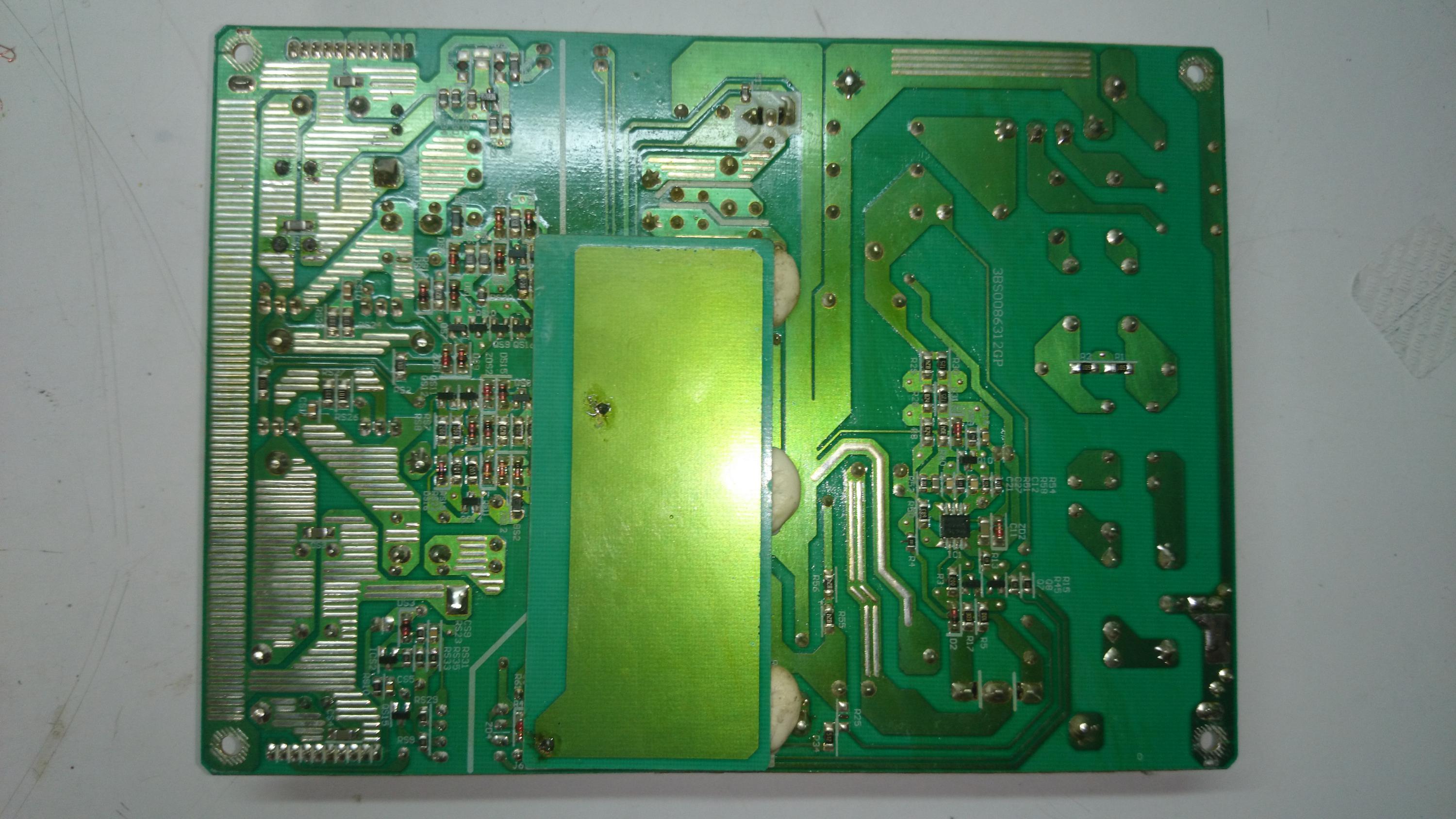

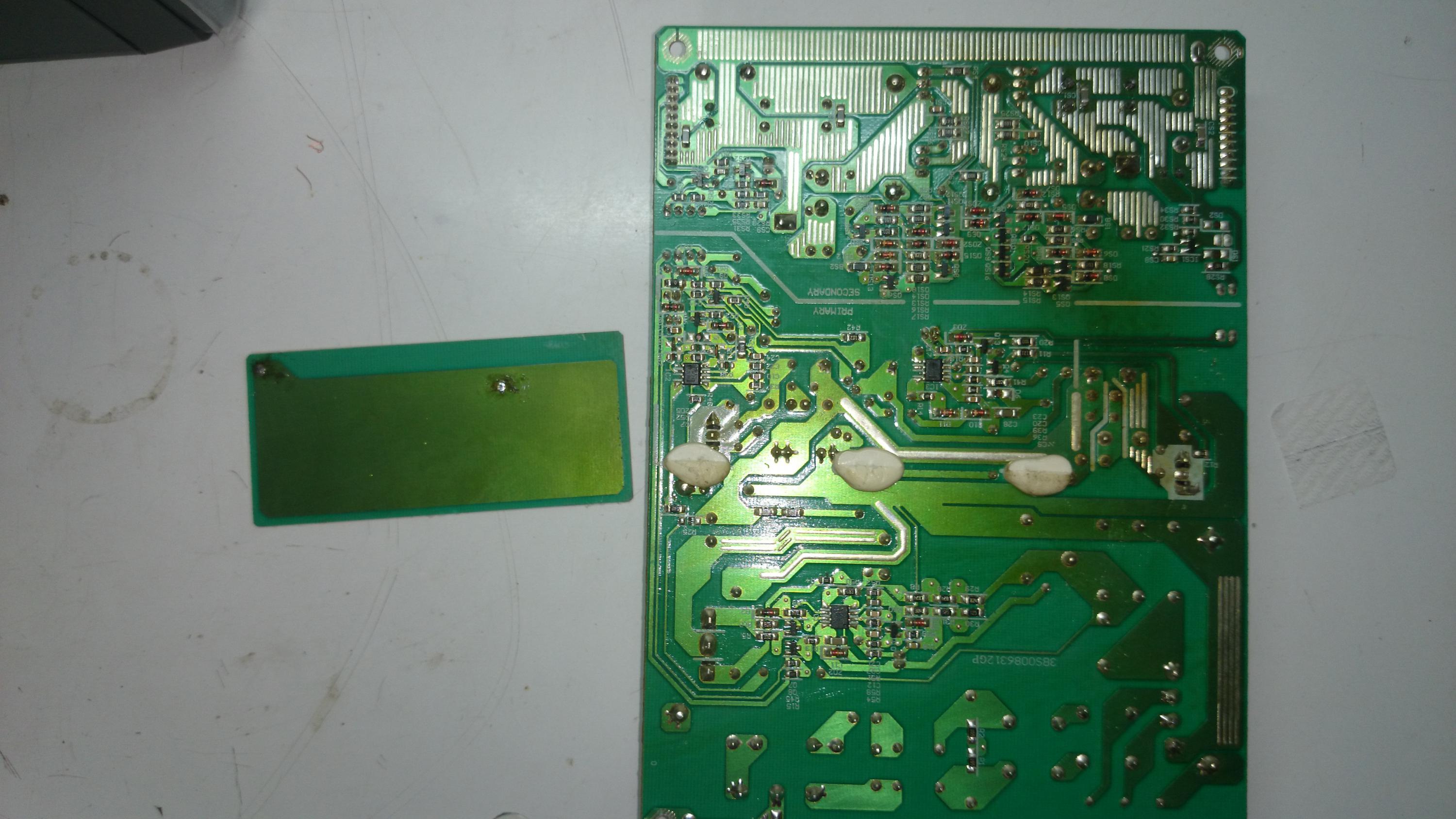

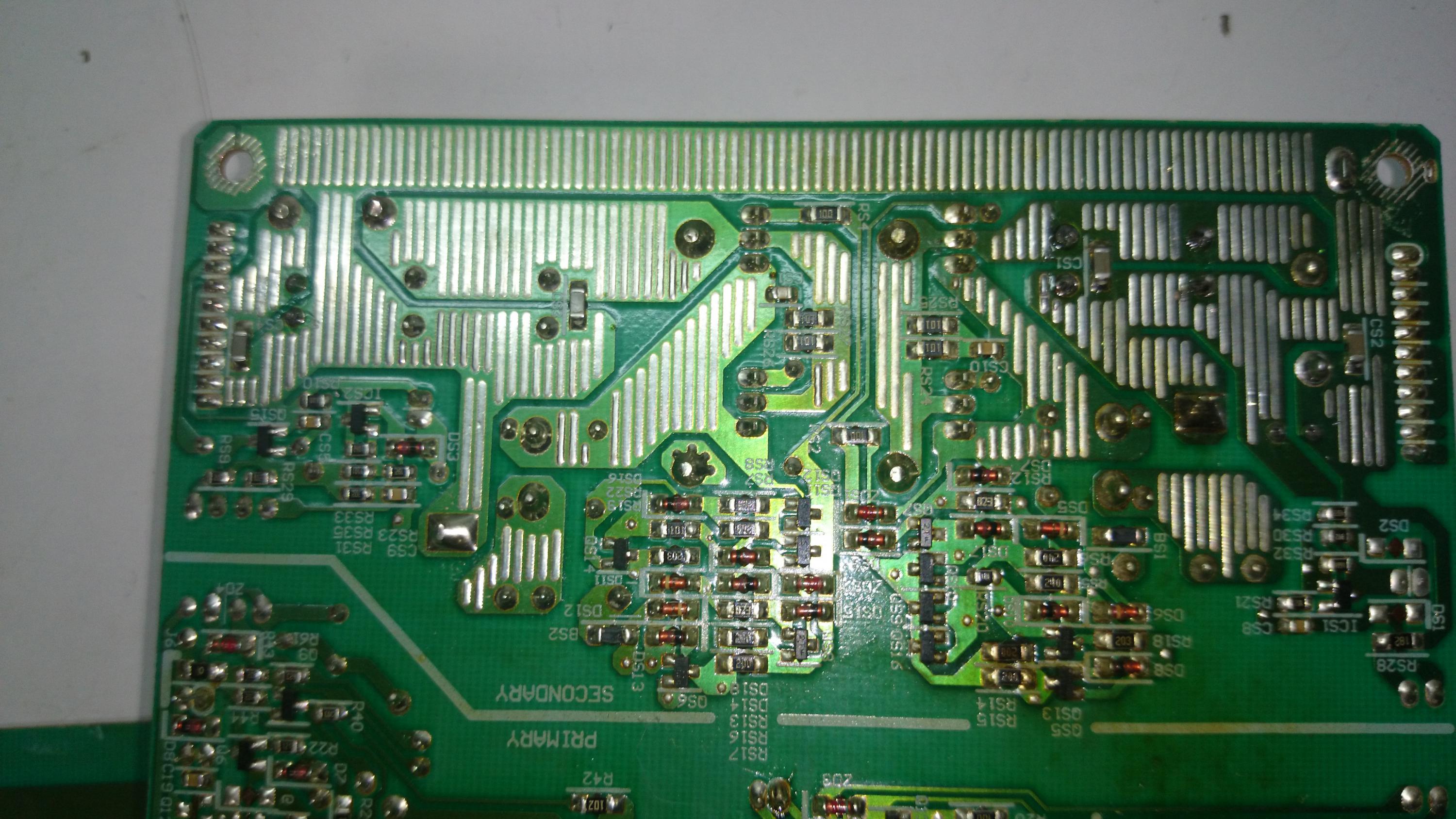

          Uploading pictures of bottom and upper side right now.
          I get 110V on the 450V main filter cap. This is very low, why? I measured this value directly from the main 450VDC capacitor.
            That means the main board may not be sending the PS_ON signal to turn on the PFC Voltage booster up to run the 24VDC power supply section, need to check the DC Voltage (with ref to the chassis ground) on connector CN3 PIN 3 to see if it goes from 0VDC to >2.5VDC when power switch is activated.

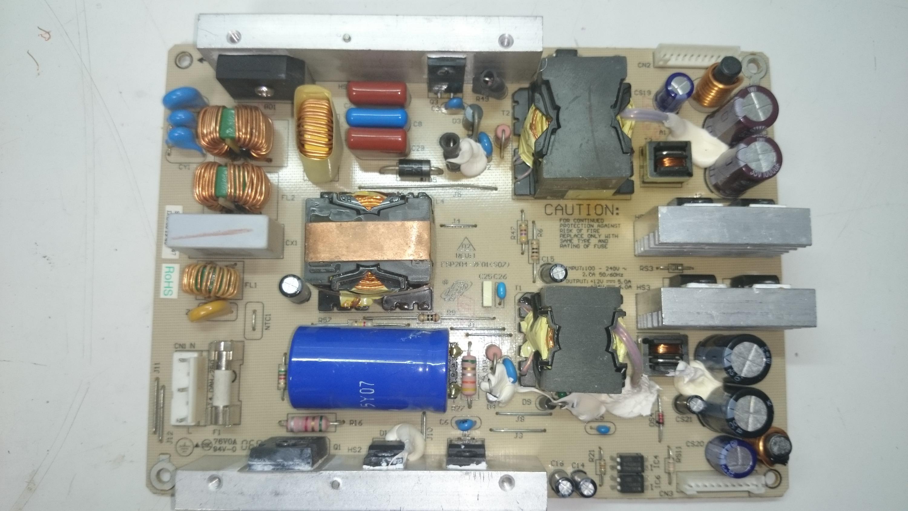

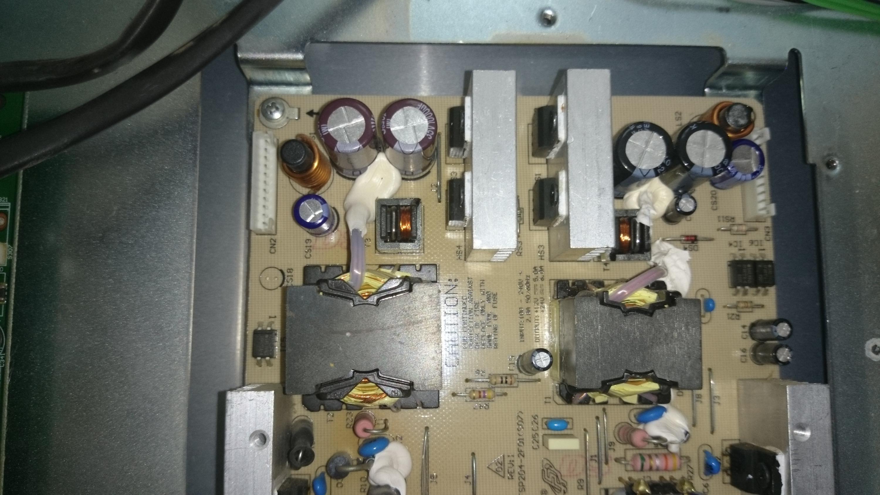

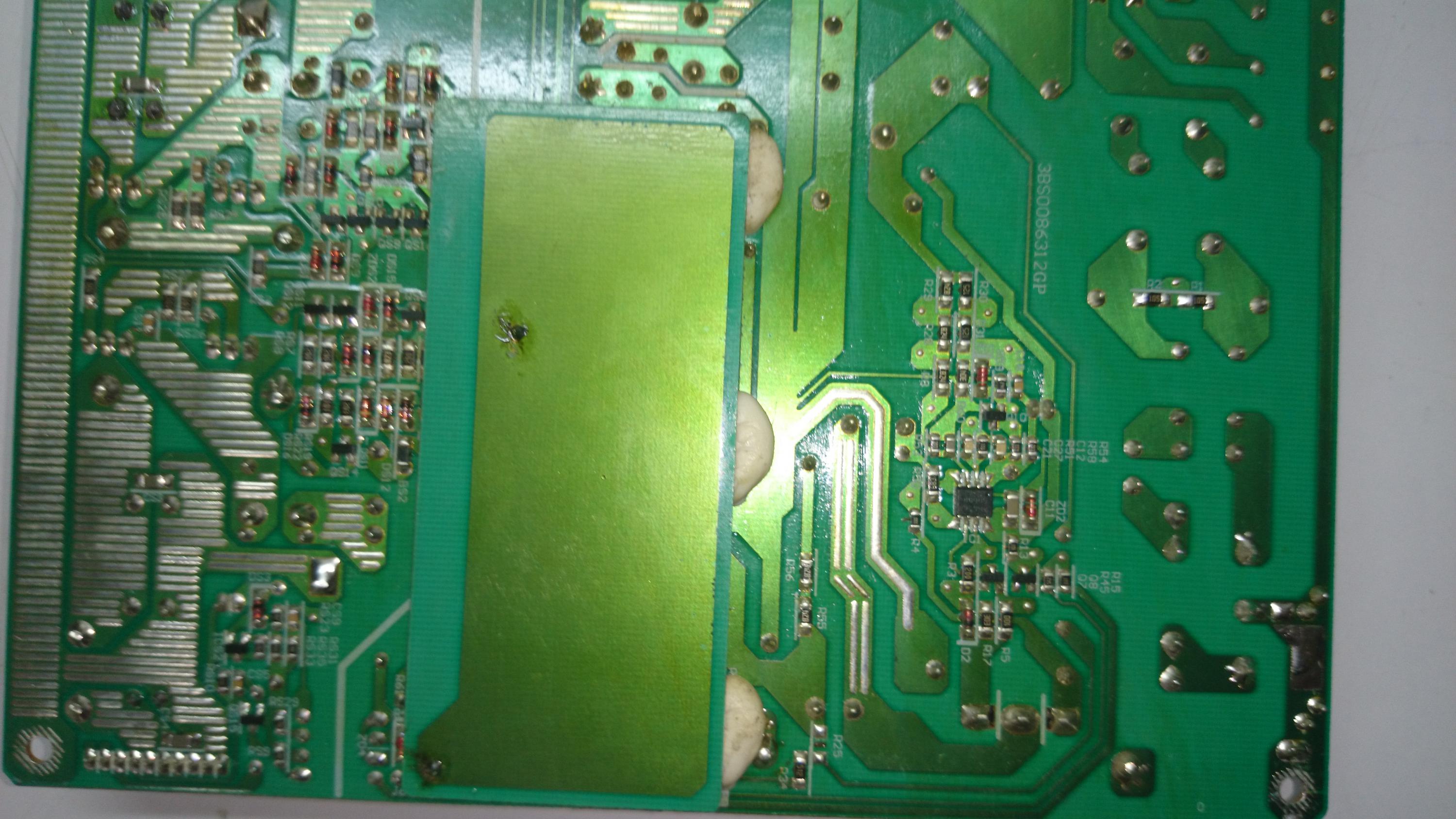

              Here are some pictures of the power supply. upper side and bottom side.

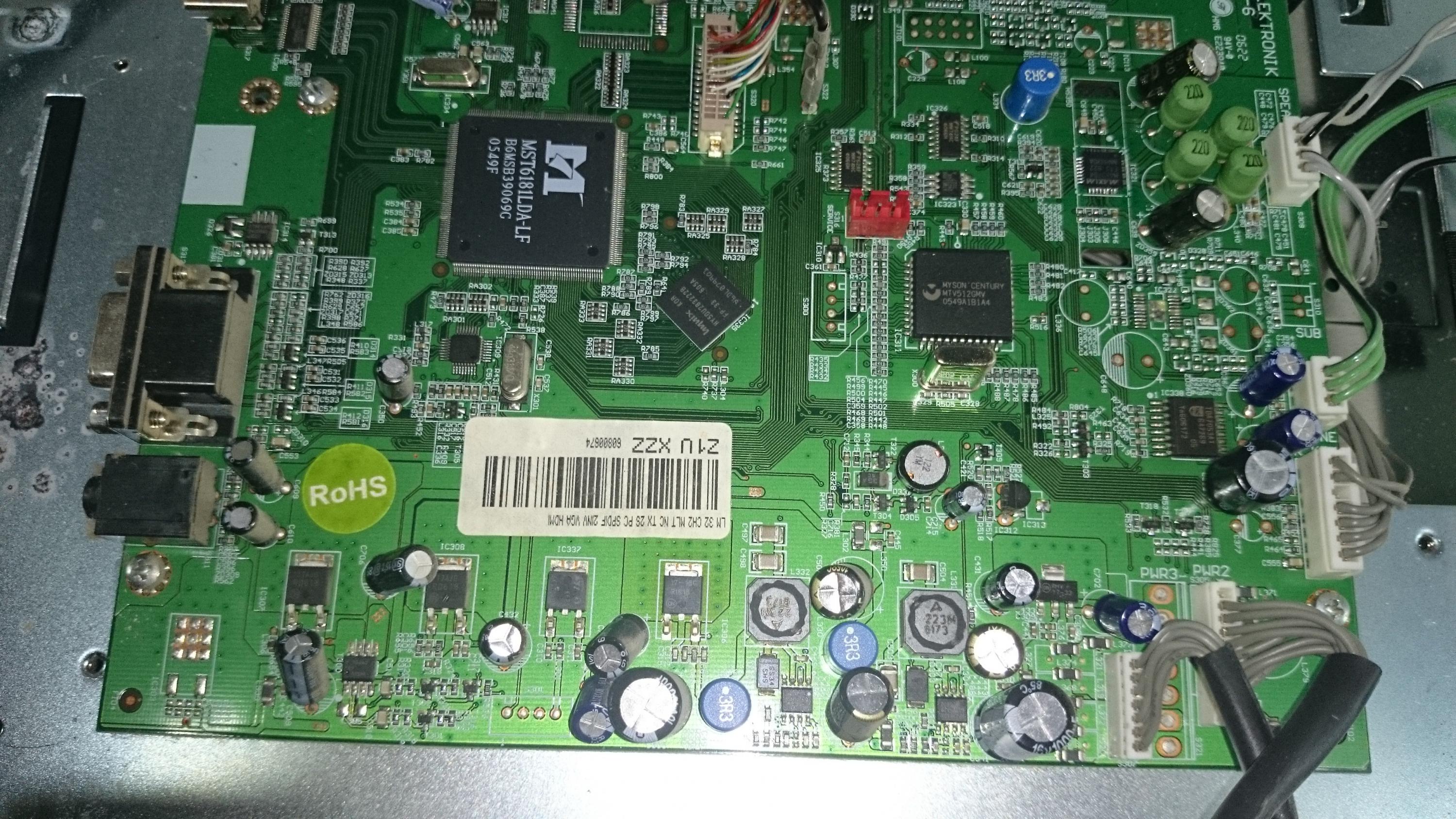

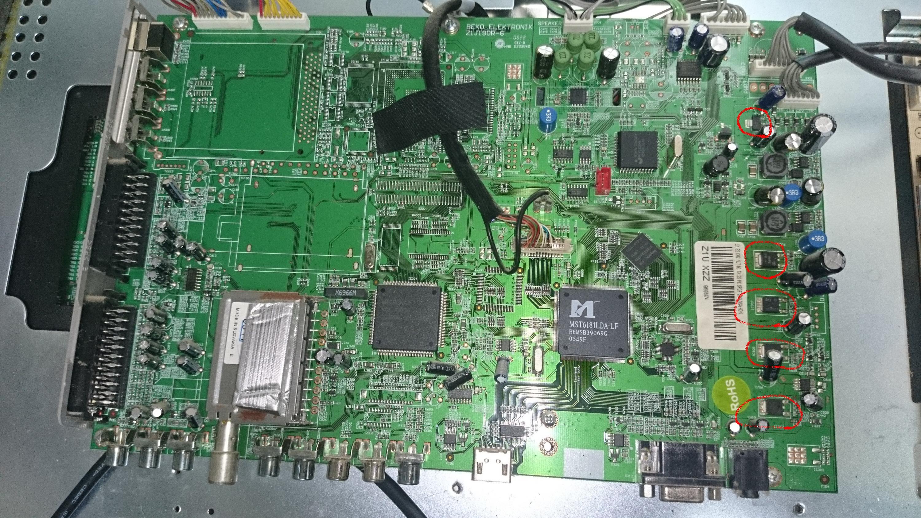

                  Since the main board is getting the 12V to run the board, at this point the main board is the problem, you need to check the main board fuses, if any, the voltage regulator ICs (see the link to how to test LDO). Pictures of the main board next.

                        Uploading pictures of the main board.
                          "But I'm not getting the 24VDC of the power supply' That is because the main board is not sending the PS_ON (0V at CN3-3) signal to turn on the 24VDC and the PFC Voltage booster circuits. Read the guide under my signature on how typical LCD TV works. BTW, your TV uses 12VSTBY POWER SUPPLY instead of typical 5VDC.

                            Ok, I understand. I'm uploading the pictures of the main board.
                              I see 5 regulators on the board.
