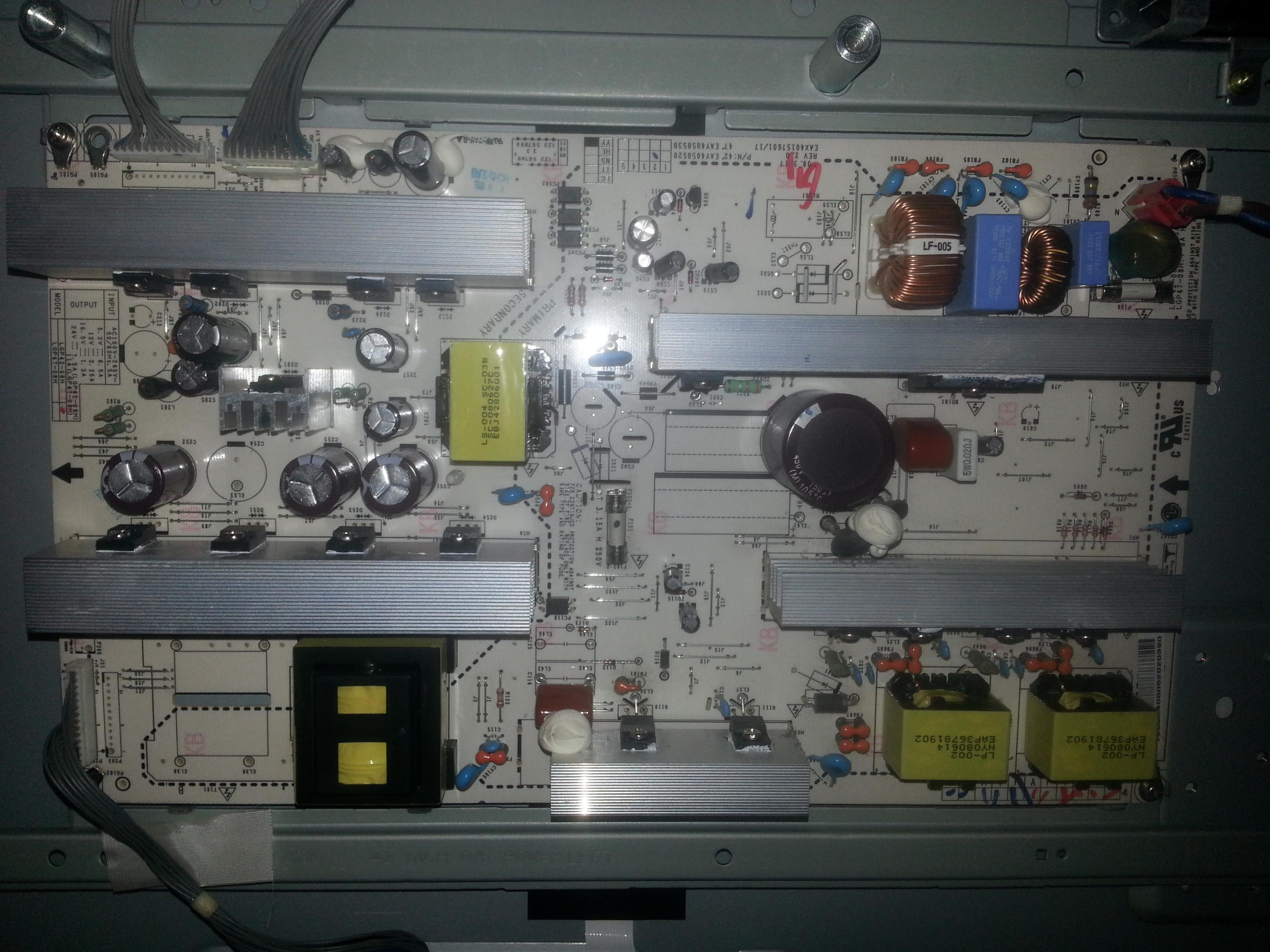

    lg 42lg5000 no screen power or sound
    Hi have a lg with no back light or sound a board voltages seem low I'm getting a really faint 3 flashing light on the front then it goes blue but that's really really faint this is the power board

      Re: lg 42lg5000 no screen power or sound
      I'm getting from here from the 12v I'm getting 0.9v and from the 16.5v nothing
          If I disconnect the y main my power goes up to right voltage so I think it's drawing the power

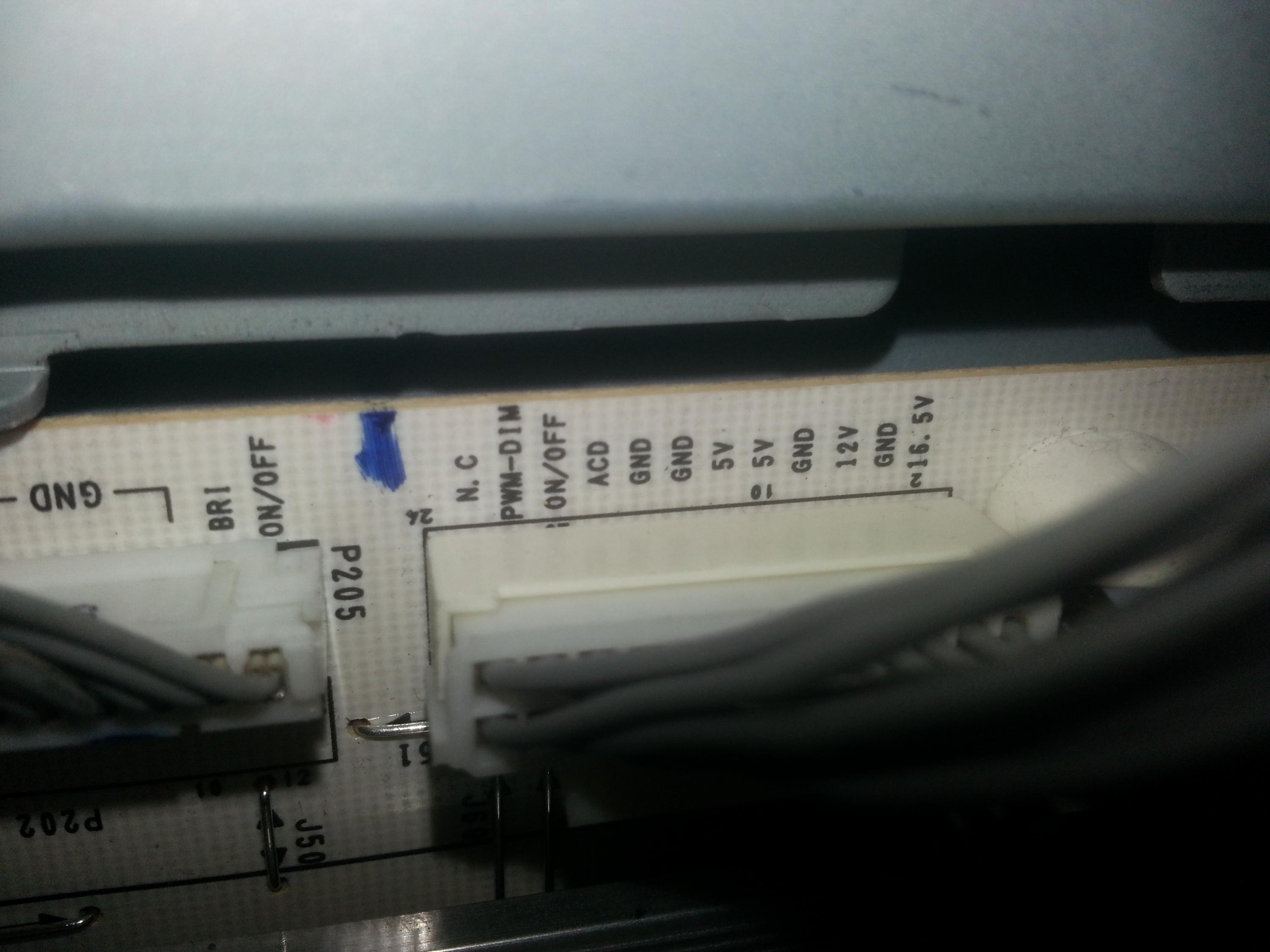

                      By unplugging things one by 1 then checking the voltage when I plugged that invertor in it was taking the voltage to the A board from 16.5v to 0.9v
                        That COULD indicate a short circuit. Did you also check the 24V?
                        • adamp91gvm
                          • Jan 2014
                          • 706
                          • uk
                          Yer it was getting 0v with the invertor in 24 with it out
                            Good troubleshooting, would seem to indicate that is at fault.
                              cCheck for bent pins in the connector - post pic of inverter board.
