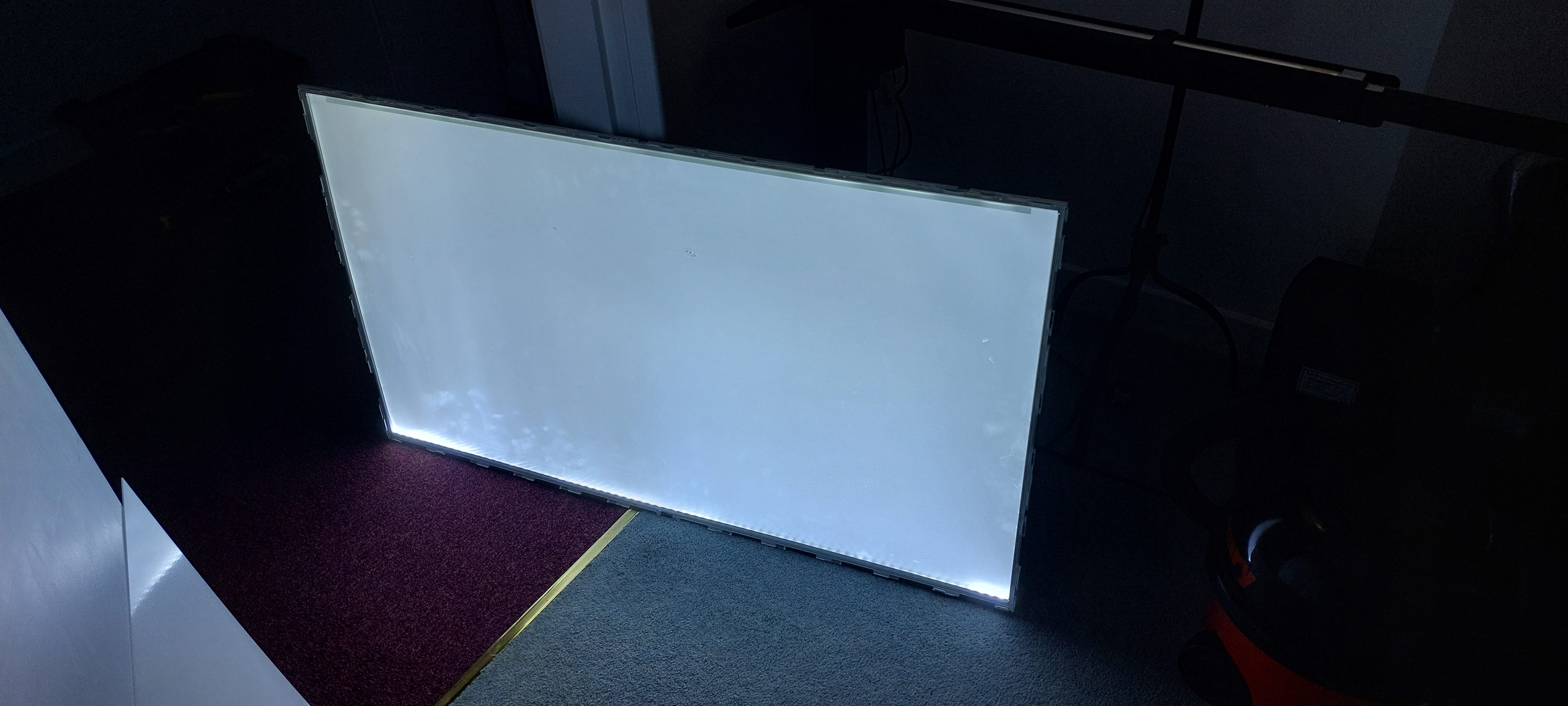

          I'm going to need to take it back apart to give the diffuser a clean but we have progress!

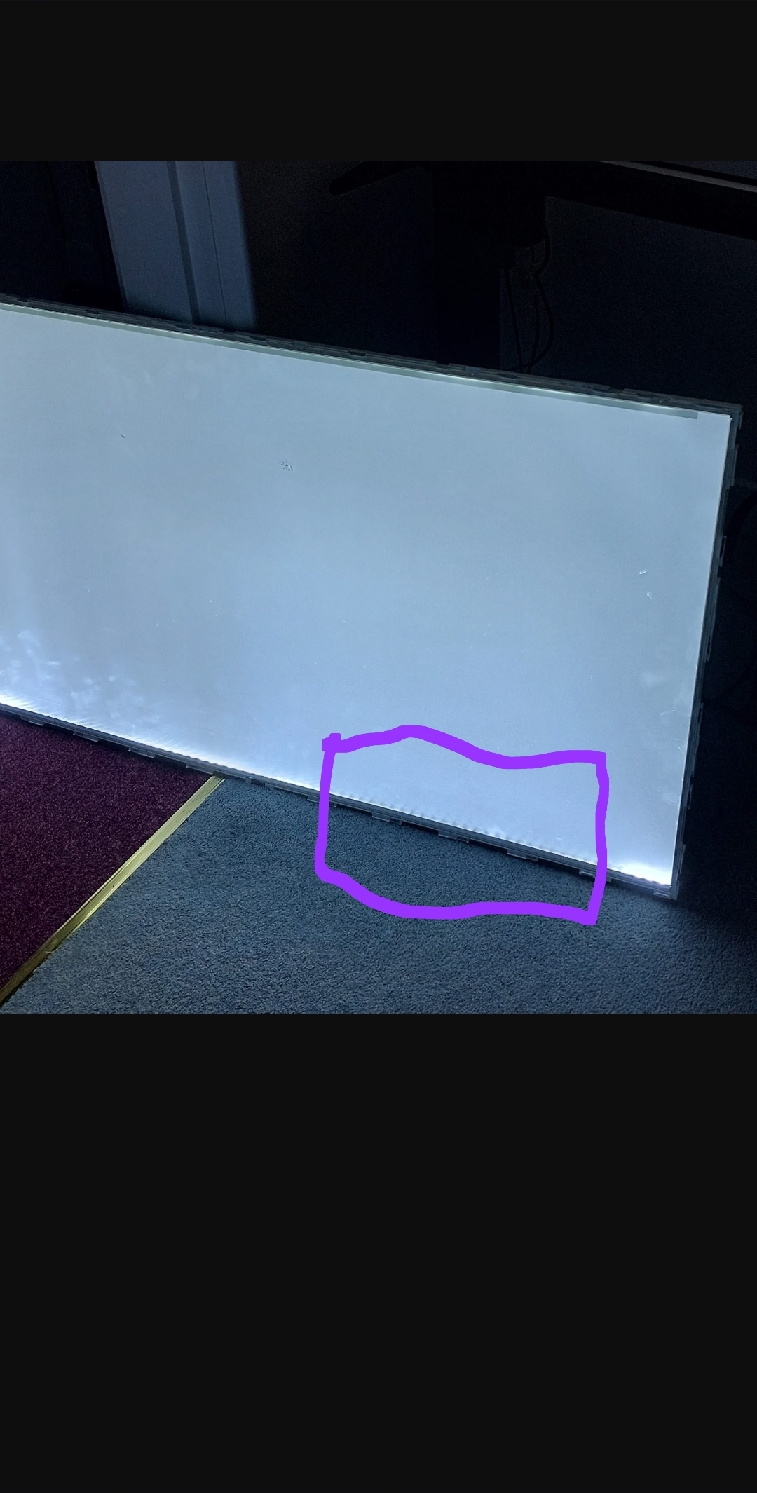

            You have bright spots in bottom corners, make sure the snap connectors are down enough. That's going to show up on the picture. Those other spots, put the sheets over top lay it flat and turn it on, it hides some of what you see so brightly. Then you'll have a better estimation of what you need to cleanup. Not all of that will show through

                Yes! Everything should look as close as possible to this area here or it's going to show up once you put the tv back together. Like I said put those other 2 sheets on and lay it flat, and put lights on and some of the defects will go away. But definitely not those bright spots

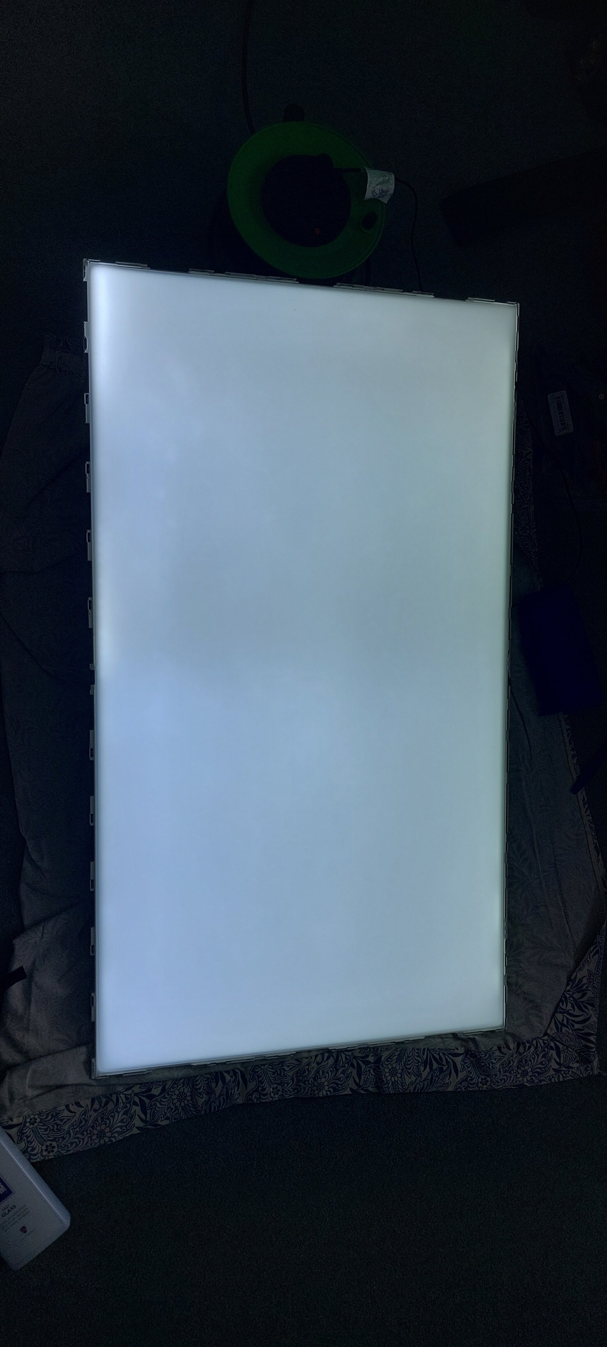

                  I don't think I will be able to resolve the issue in the bottom left fully as manually applying pressure hasn't changed much - BUT I'm really happy with the result. I'm going to put the panel back on once the capacitors have had 20 minutes to discharge

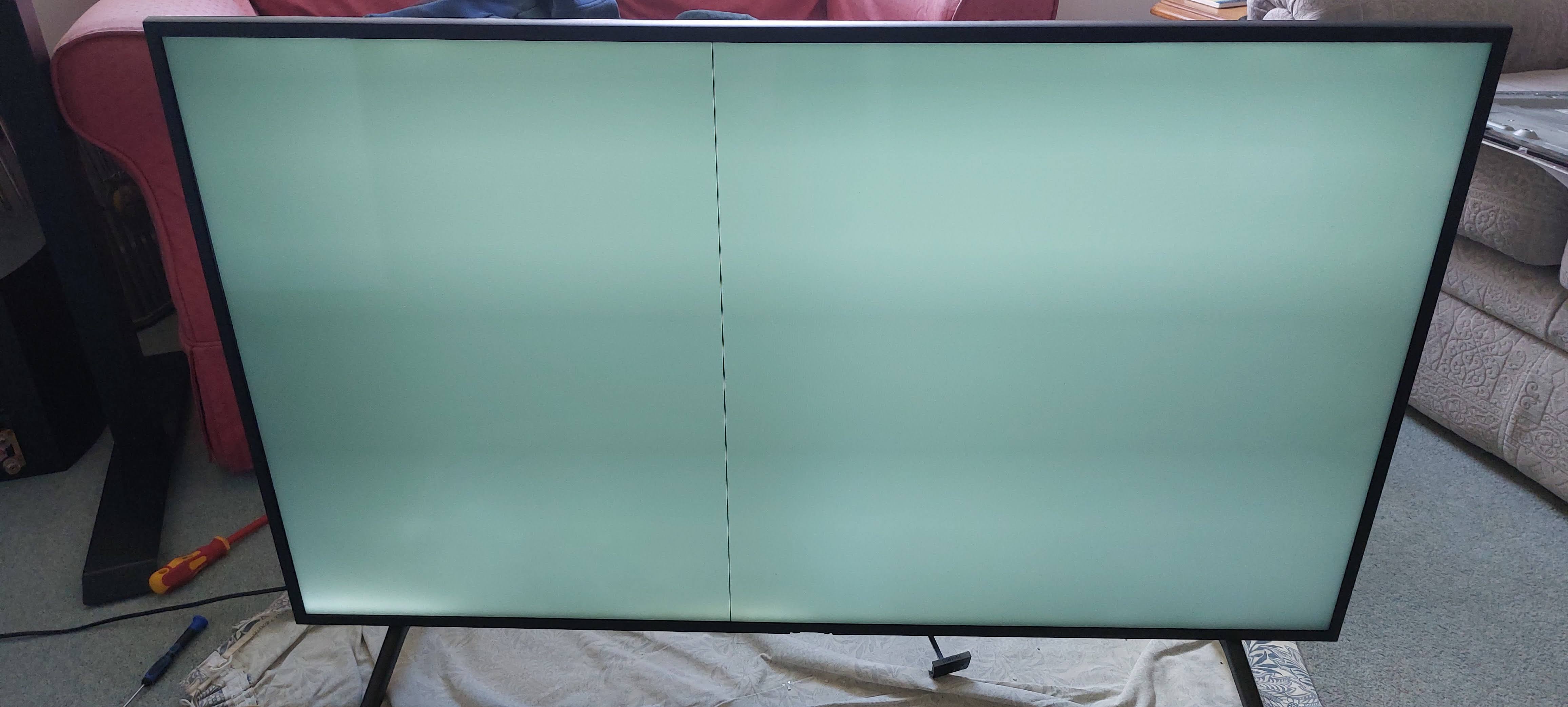

                    I am really hoping this is a bit of dust in the connector! Click image for larger version

                      Oh boy ๐Ÿ˜ฎ ๐Ÿ˜ฎ

                        No amount of fiddling with the ribbon cable seems to improve it, I think I might have to admit defeat on this occasion. Thanks everyone for your input

                          Yea, I've had this happen once before, but to be fair the backlight was out so maybe it was already there before changing it. Sorry to see
