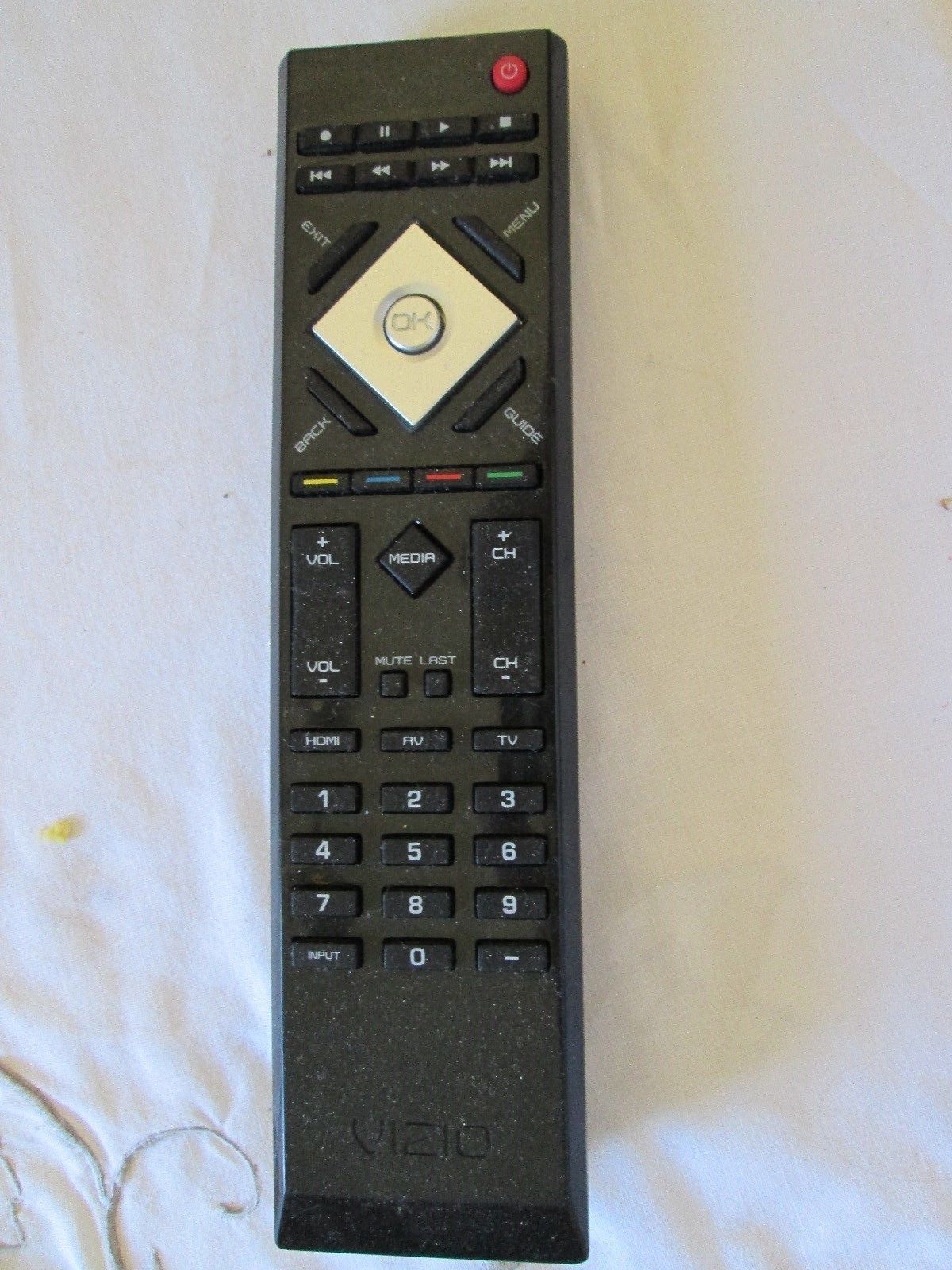

    There is no HDMI button on the remote or TV, only an input button. I'll play around with the input and try to change it to HDMI blindly. Standby

      ok you can change the input from the control panel buttons on the TV, press input button than wait about 5 second, no sound then press the input button again.
      Do you know the last input the TV was being used on?
      You don't have this remote controller?
        No I have a smaller remote.

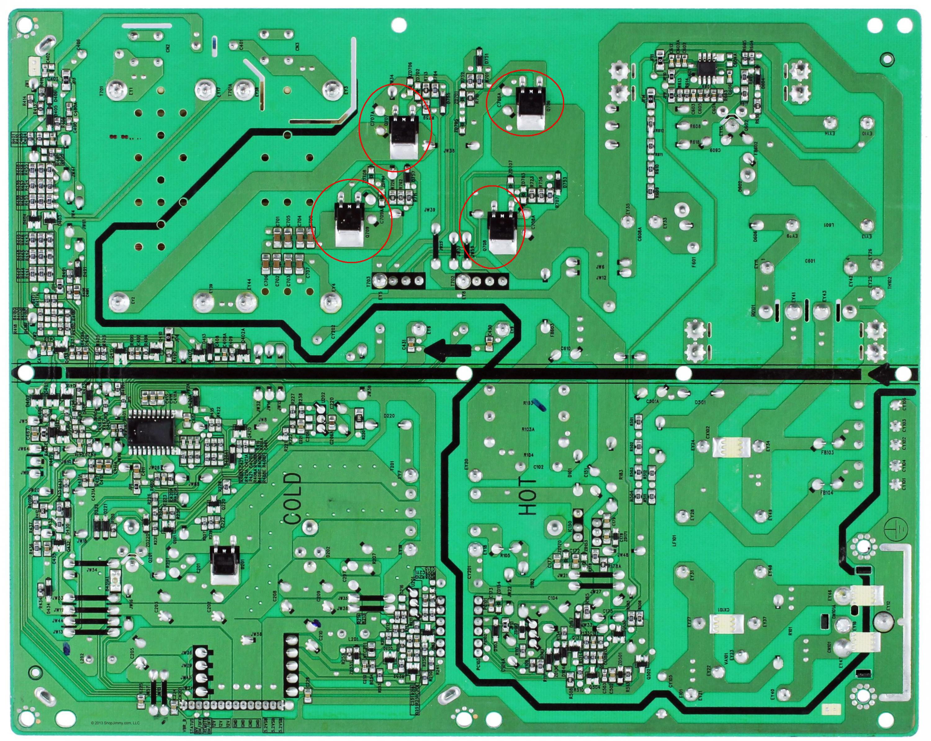

                  I took the TV completely apart, thinking that the two long circuit boards that the led lamps plug into were the inverter boards. Eh, it looks like it turns out that the "inverter board" is built into the power supply board.
                  http://www.shopjimmy.com/vizio-0500-...t-inverter.htm
                  So it looks like my instincts were right from the beginning, that it was the power supply board at fault? Unless I missed a board somewhere... but I've got this thing in pieces at the moment.

                    I have only seen this model with the power supply & inverter together. if you want to confirm your inverter circuit is bad, it may have bad output transistors.Check the four transistor for short using your meter. I'm repairing the same power supply & inverter and I found shorted output transistors. But to quickly repair your TV just replace the power supply & inverter board.

                      Thanks. I'm getting resistance on all 4 transistors so they don't seem to be shorted. I order the power supply board anyway... Hopefully it'll fix the issue. I'll update this post with results.

                        My favourite trick with these 2+ transformer inverters to put a neon bulb next to each transformer; if the bulb glows, there is HV being produced and the transformer is probably working.

                          yes hopefully, one more possibility will be bad one or more bad CCFL. Sometime you will an arcing noise is that was the case.
