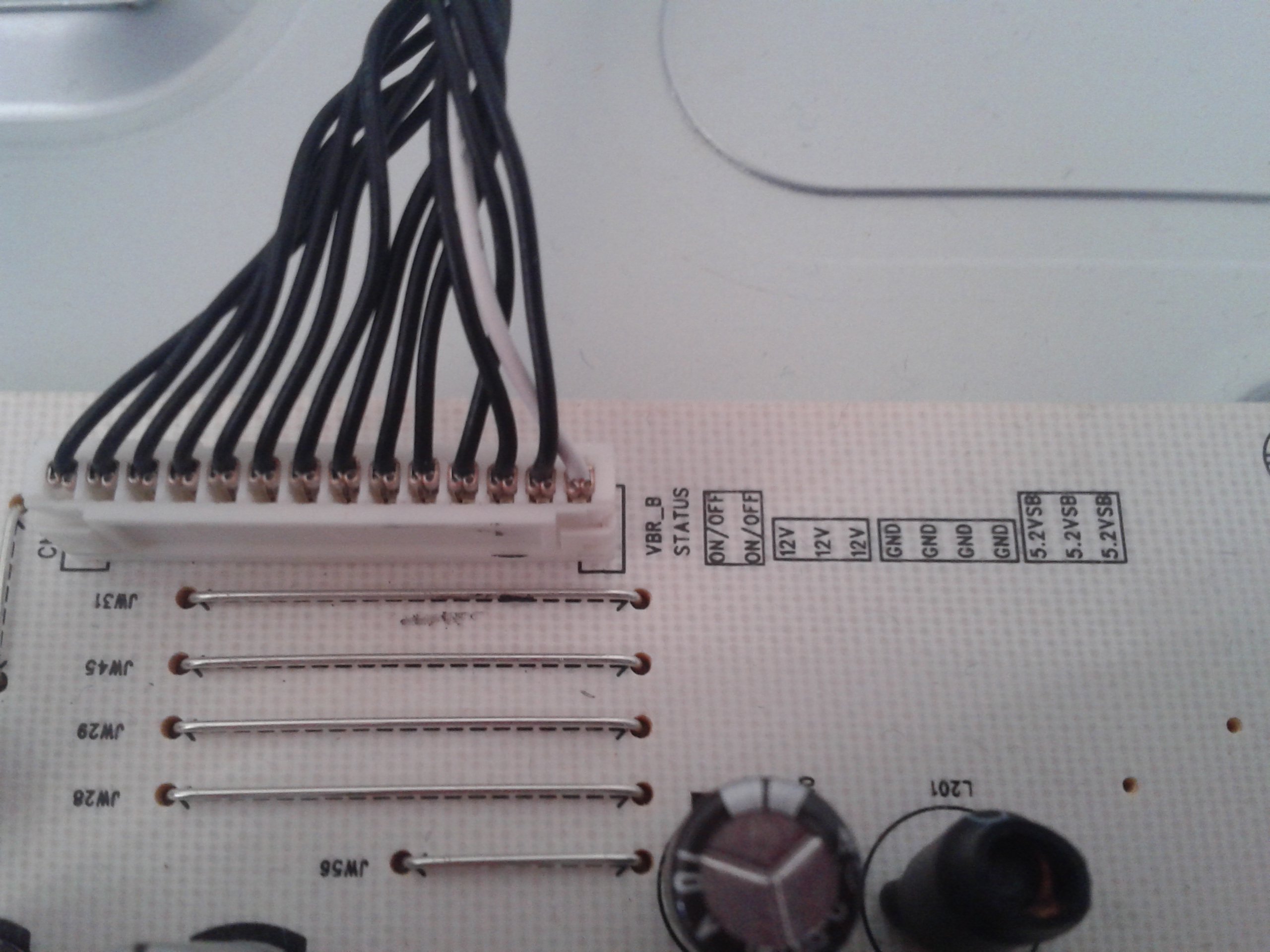

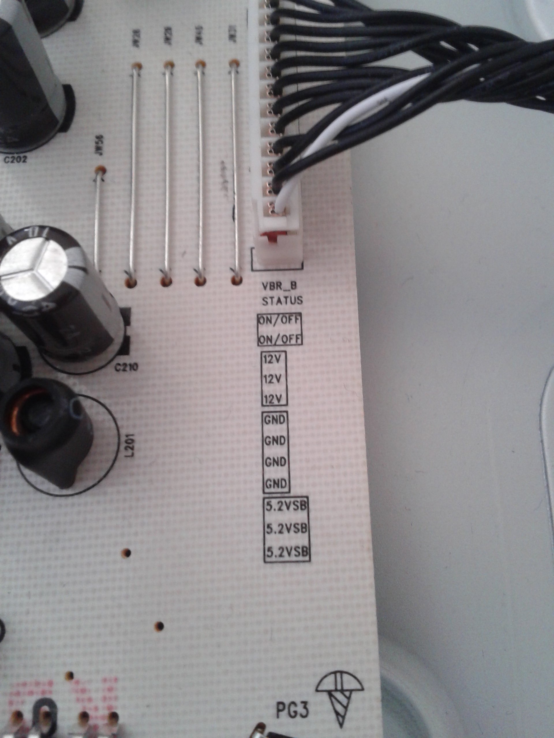

                              I'm getting some oddball voltages here out the power supply board.
                              If you look at the attached picture, here are the voltages I measured with the TV on(Visio logo white)... from left to right. In other words, #1 = far left cable and #14 = far right, white cable:
                              1. 5v
                              2. 5v
                              3. 7v
                              4. 7v
                              5. 26v
                              6. 26v
                              7. 26v
                              8. 0v
                              9. 0v
                              10. 0v
                              11. 0v
                              12. 12v
                              13. 12v
                              14. 12v
                              Does the diagram list them in the wrong order? Even if so, don't these voltages seem odd? Maybe it is the power supply board that's bad.
                                Re: Vizio 32" E321VL struggling to power on
                                Check your meter is set to DC volts. Not AC.
                                  doh
                                  1. 2.5v
                                  2. 2.5v
                                  3. 3.5v
                                  4. 3.5v
                                  5. 12v
                                  6. 12v
                                  7. 12v
                                  8. 0v
                                  9. 0v
                                  10. 0v
                                  11. 0v
                                  12. 5.7v
                                  13. 5.7v
                                  14. 5.7v
                                  hmmm. Looks like it checks out. Does this verify the power supply board is probably good?

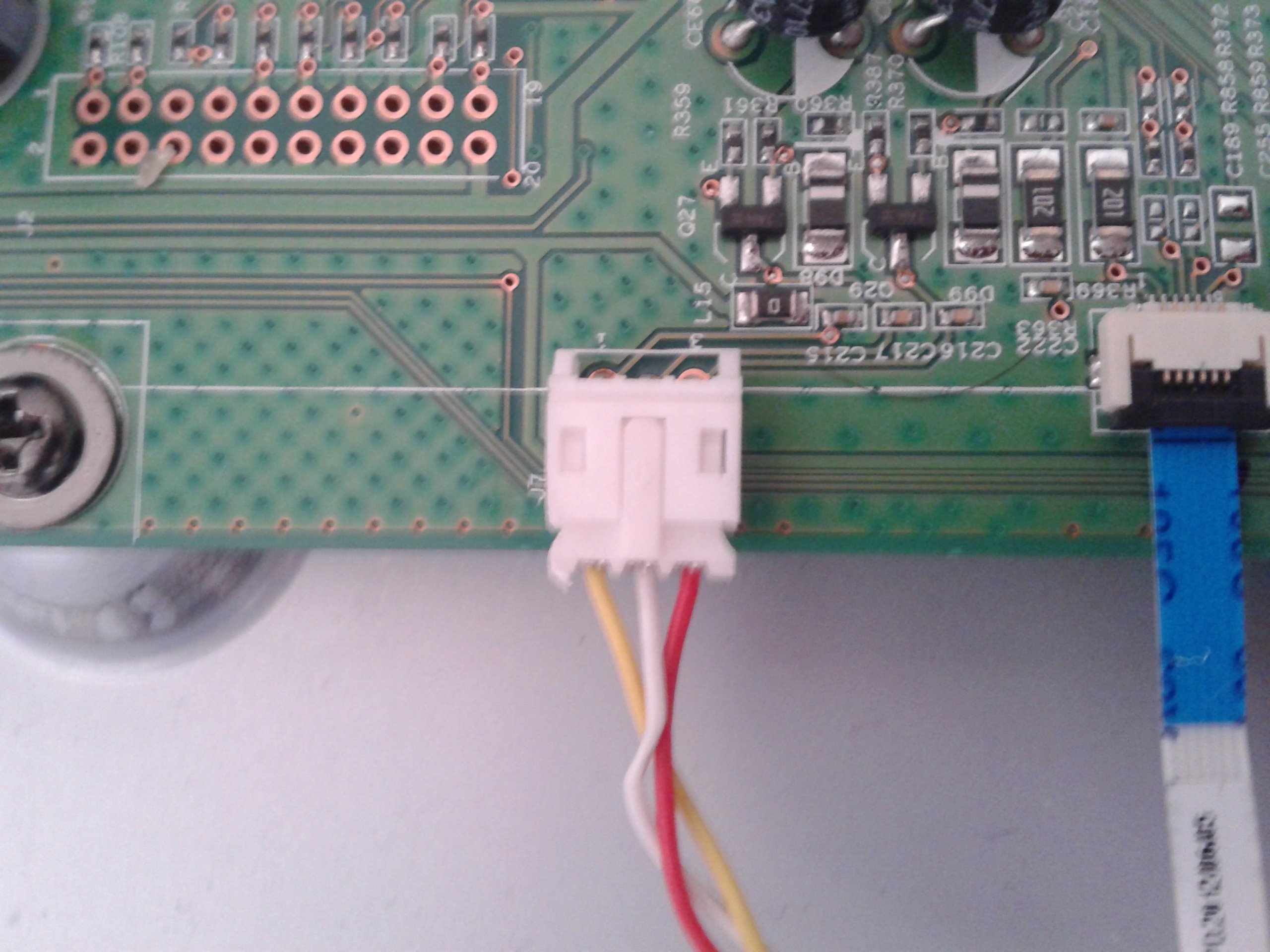

                                      This little fella that's leaving the main board appears to be going to the inverter that is tucked away under the assembly, near the lcd panel.
                                      Here are what the wires are reading in DC voltage:
                                      Yellow: 5.5v
                                      White: 3v
                                      Red: 3.5v

                                        Both on/off readings were 3.5v
