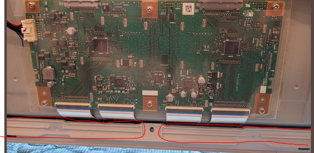

        They are located here, where these 4 cables go.

          Ok those both look fine to me.

            They run along the entire length of the panel itself; you also need to remove the black protective strip to get to them.

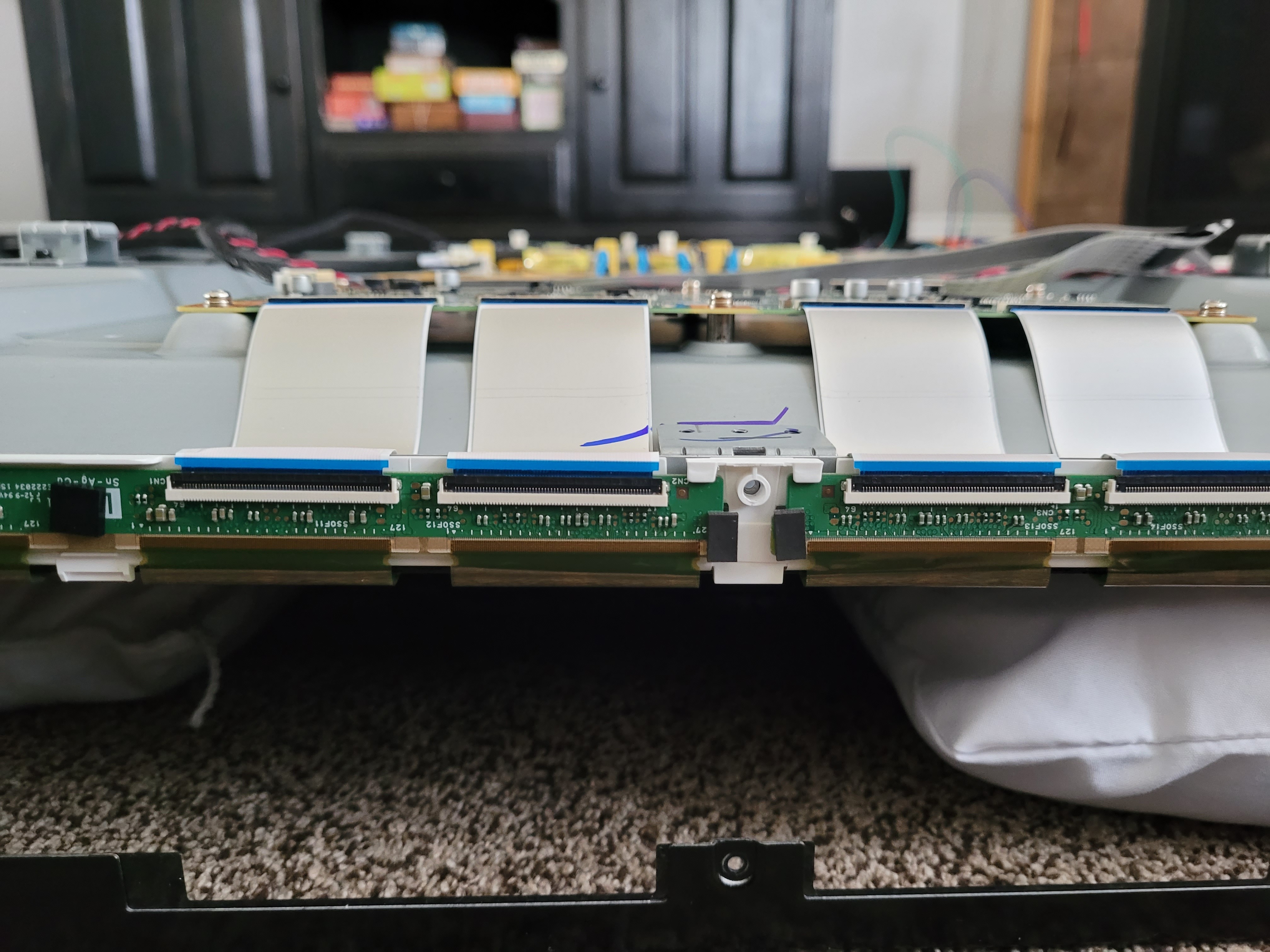

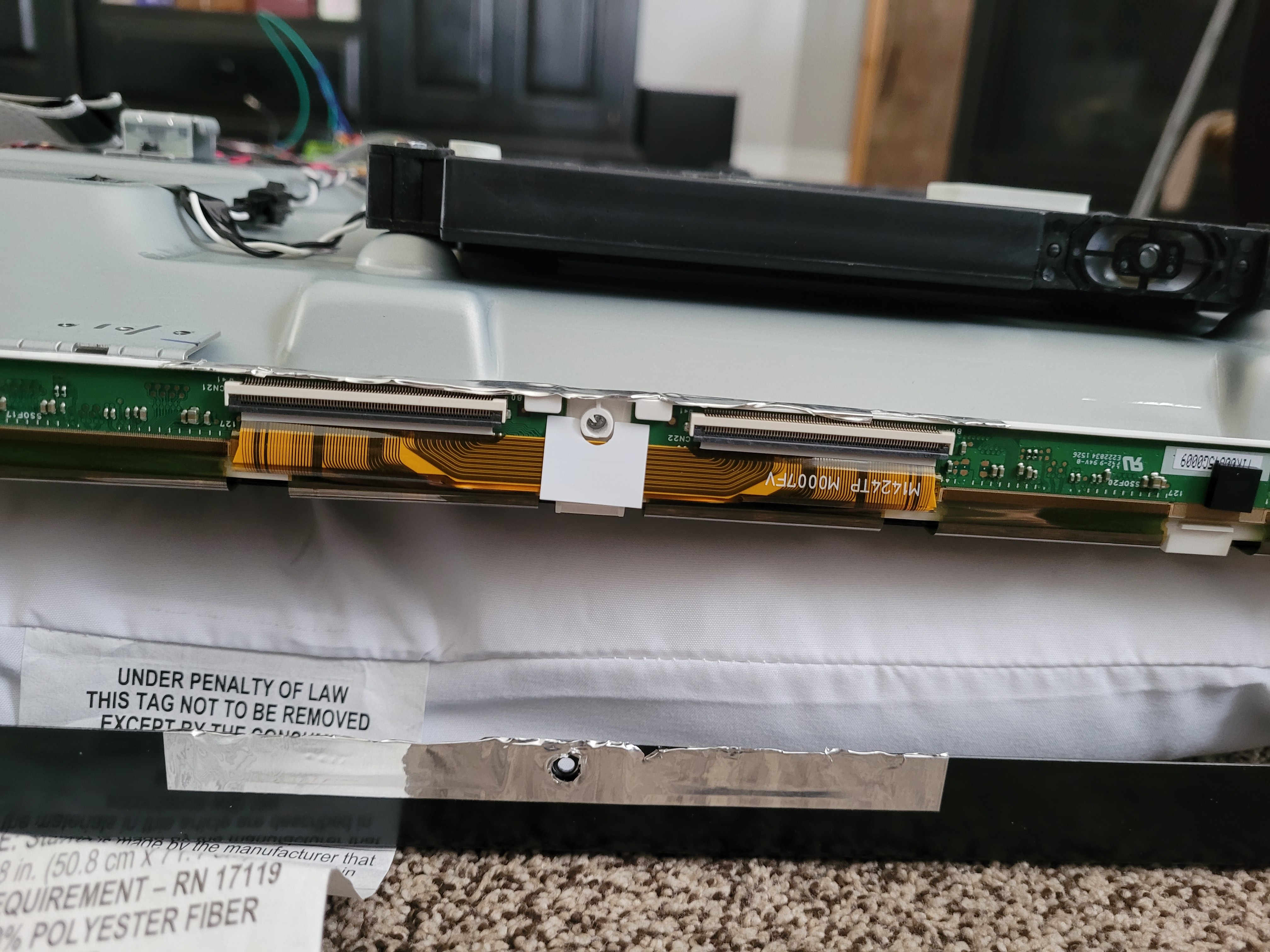

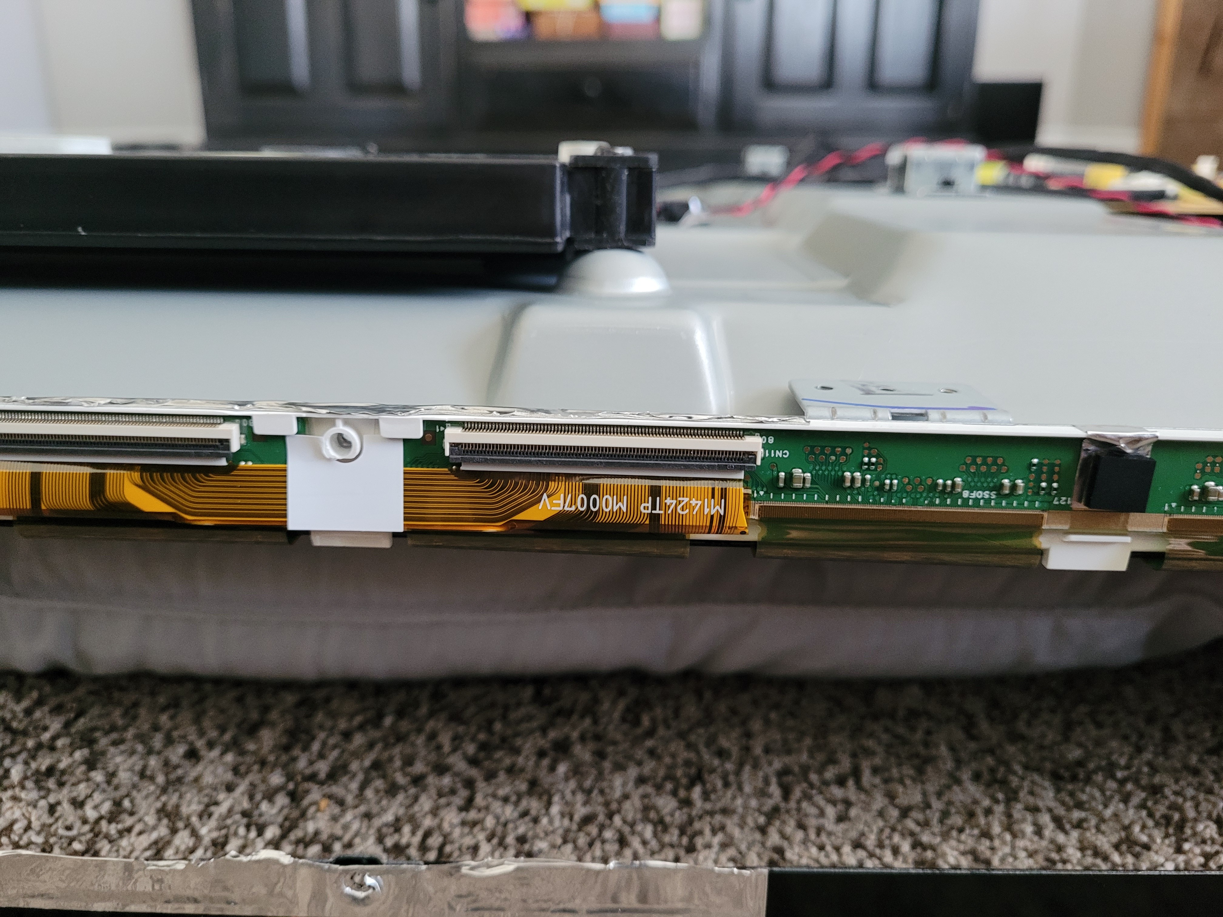

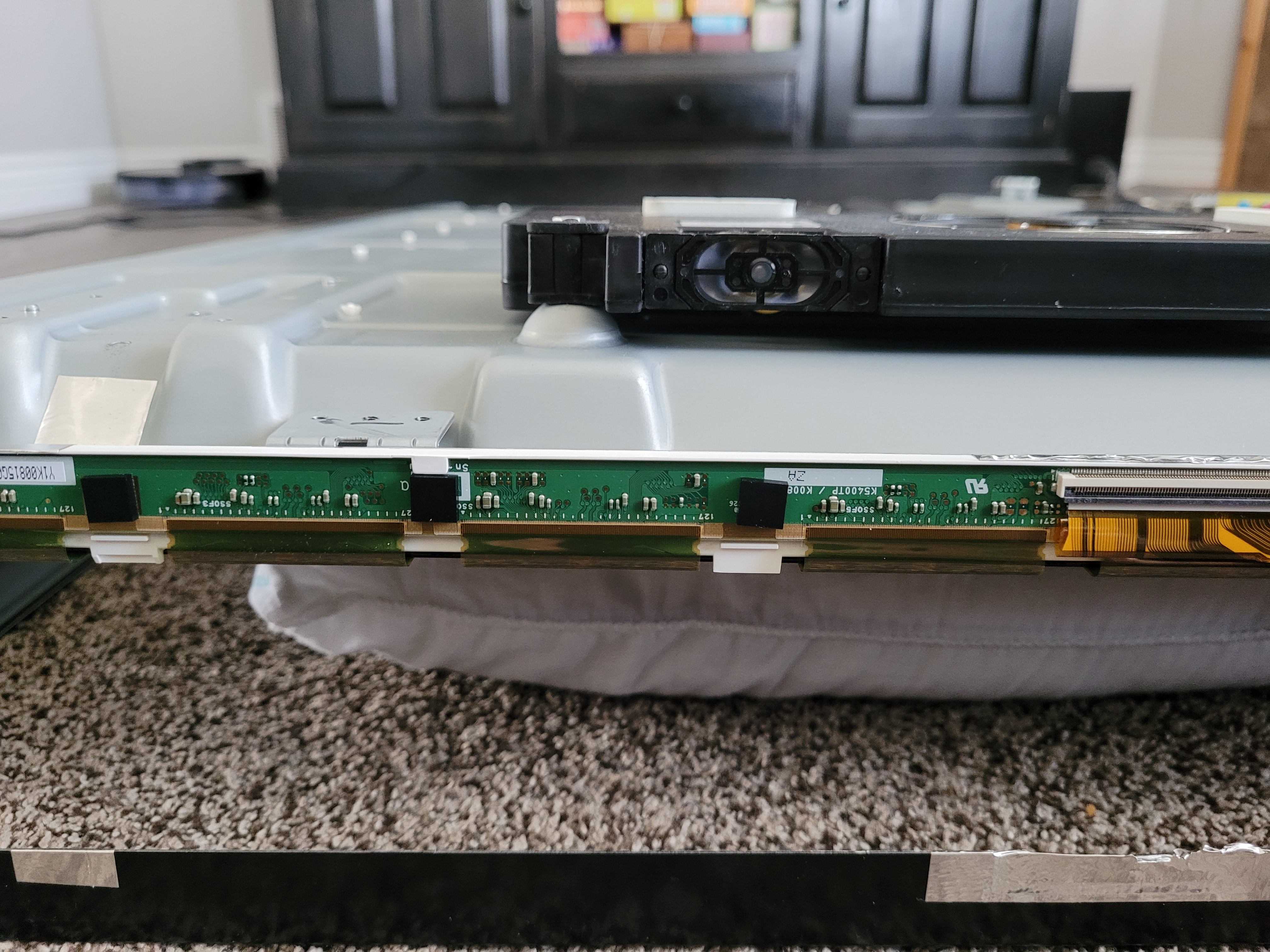

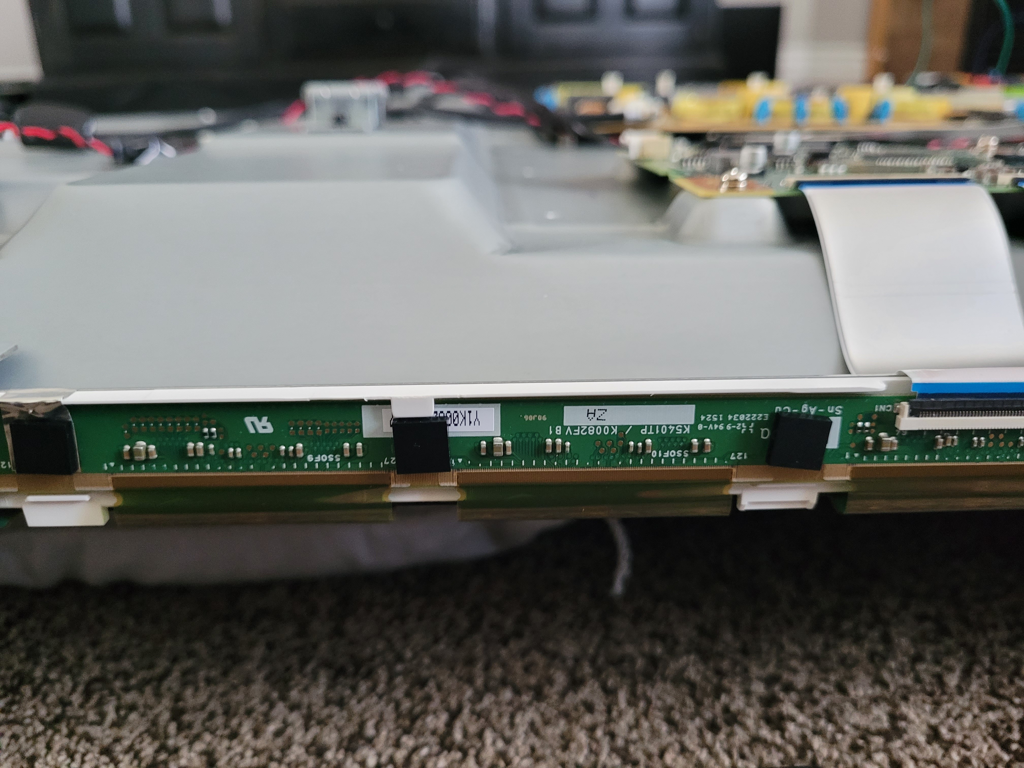

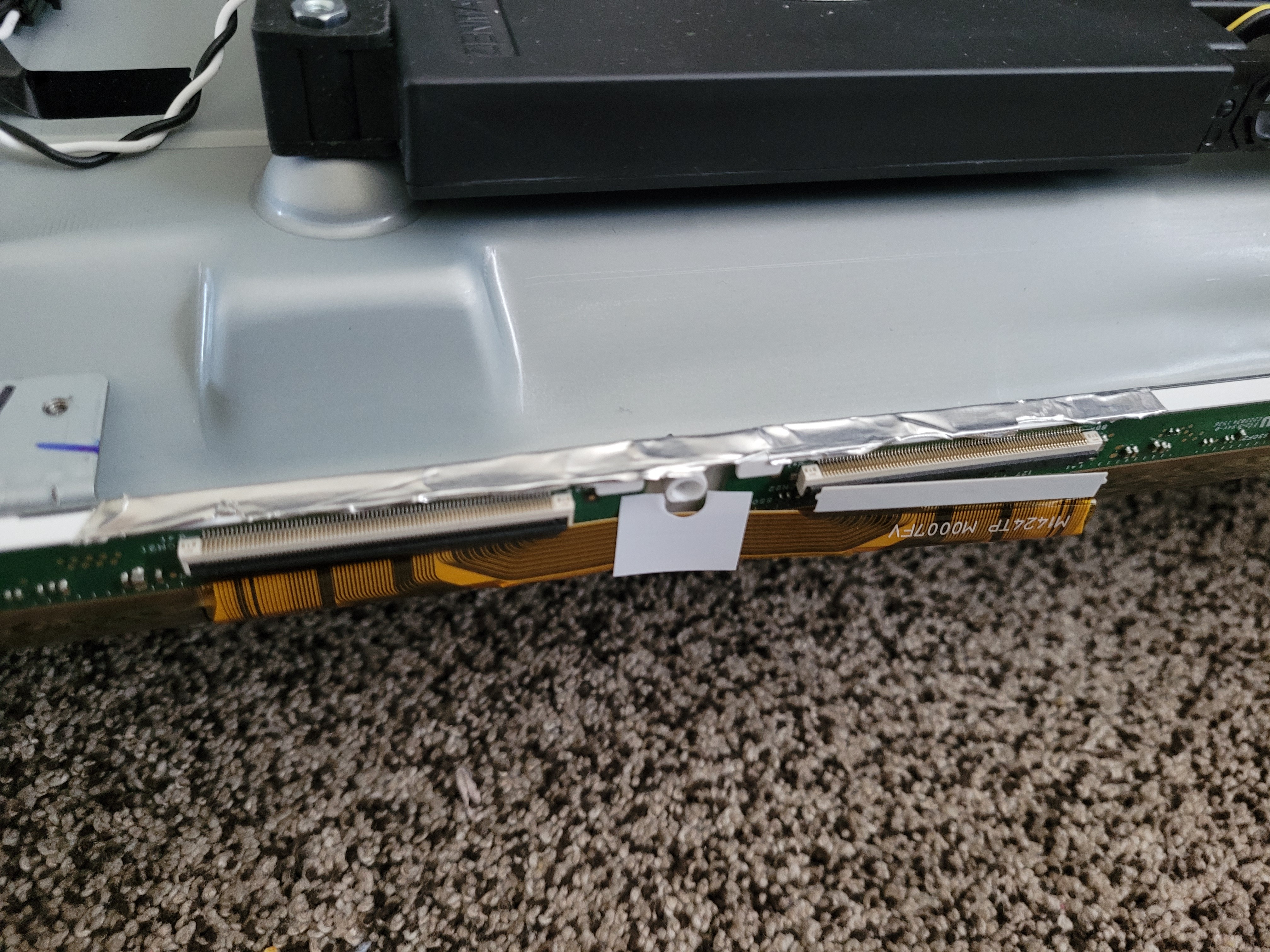

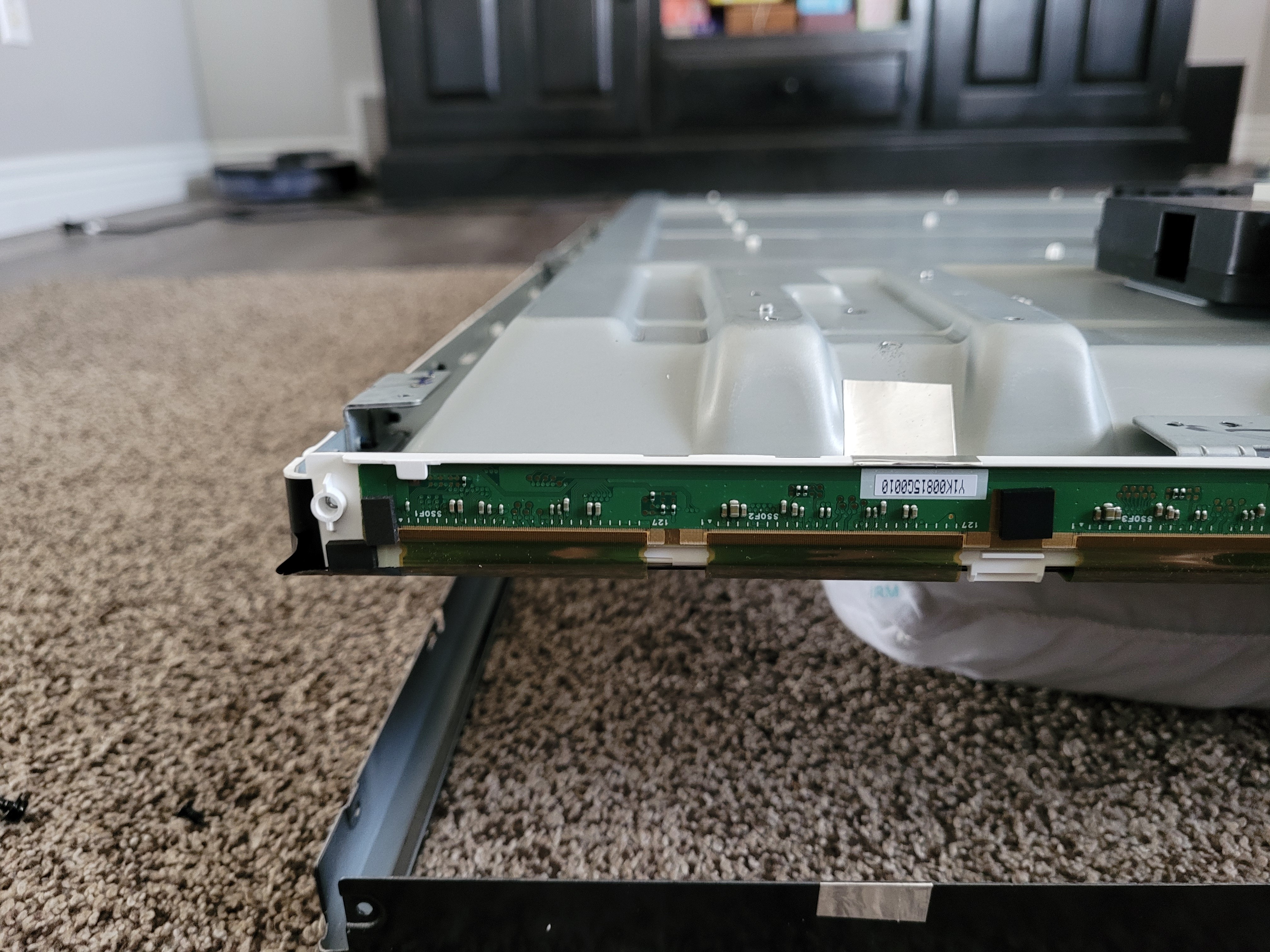

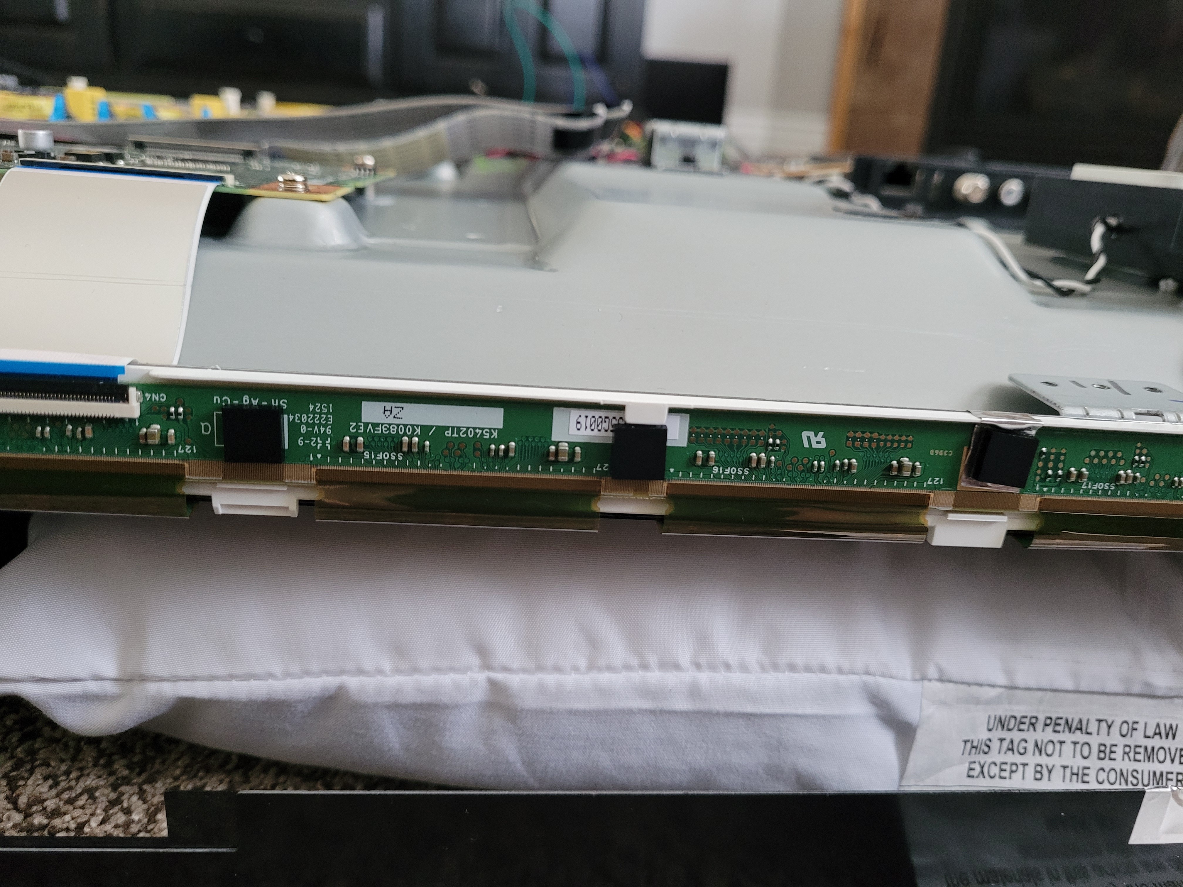

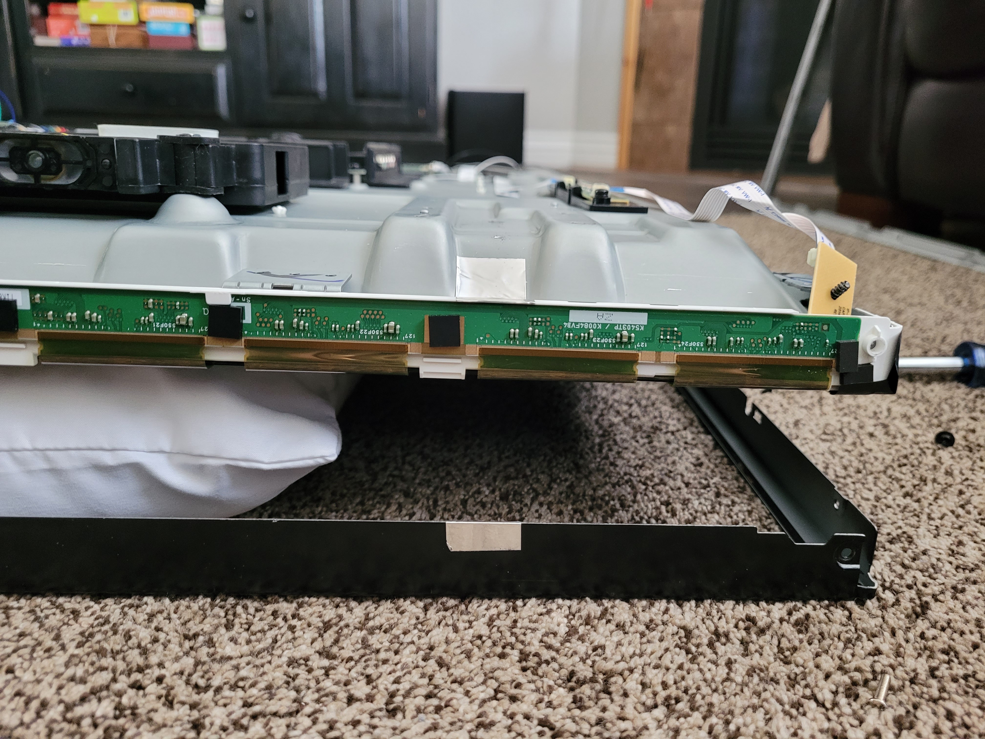

                            Thank you that makes sense. Ok here are some photos of the panel boards along the bottom. They may not be in the exact same order they were taken. Hopefully I got them close enough you can see them clearly. Thanks again.

                              you have on each side at the middle of left & right side U ribbon cable... you need to disconnect from one side for each left & right and turn on the TV see the screen how it llok
                              notice do it once a time for both side while all cable sockets LVDS should be in place connected as original

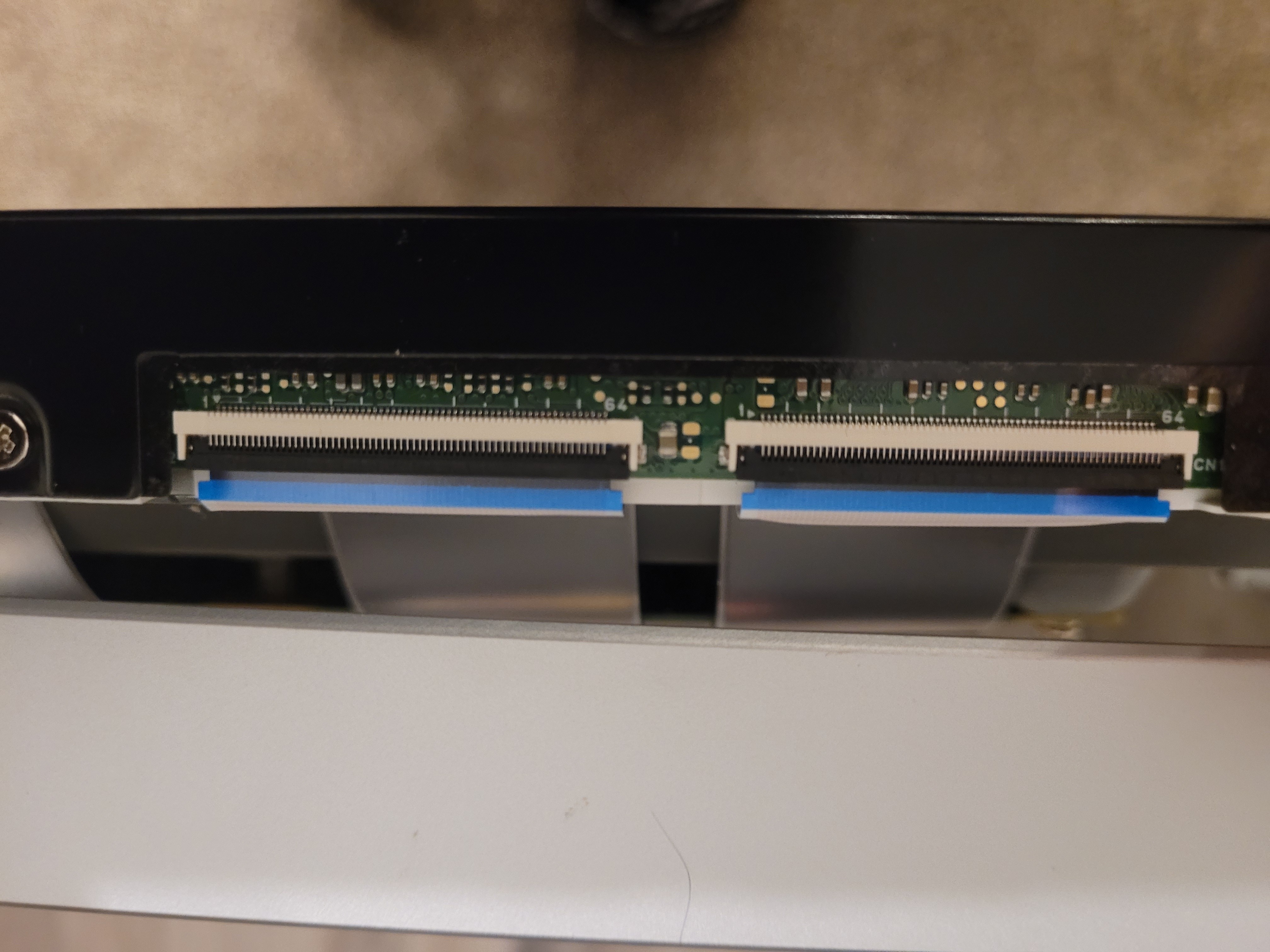

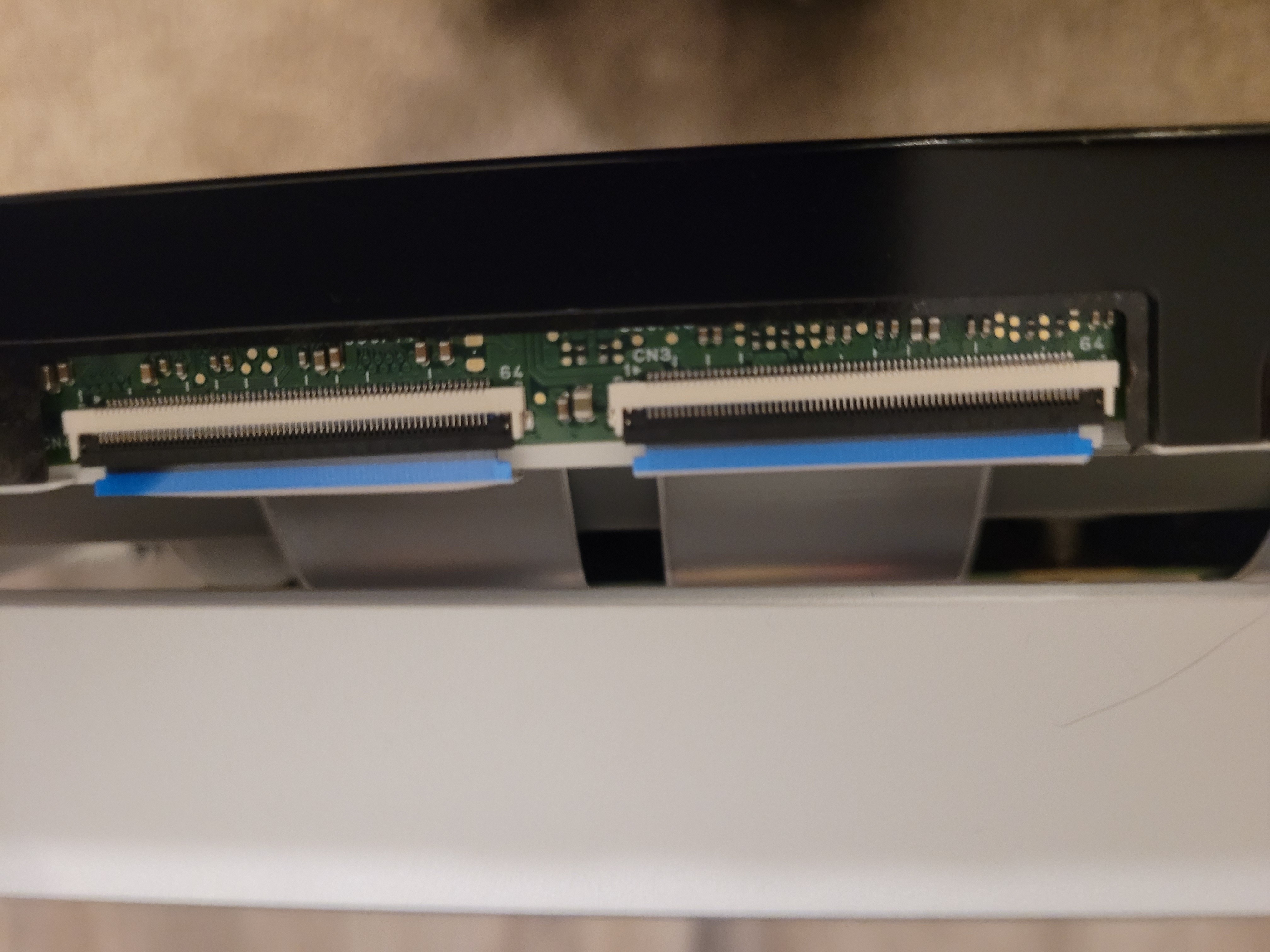

                                Ok I finally got around to doing this. I removed one half of each of those cables on each side of the TV. I turned the TV on each time. Voltages on the pins all looked normal. TCON was not ever powered on. And the led never came on.
                                A pic just to display how I had each half disconnected. Thanks again for all your help.
