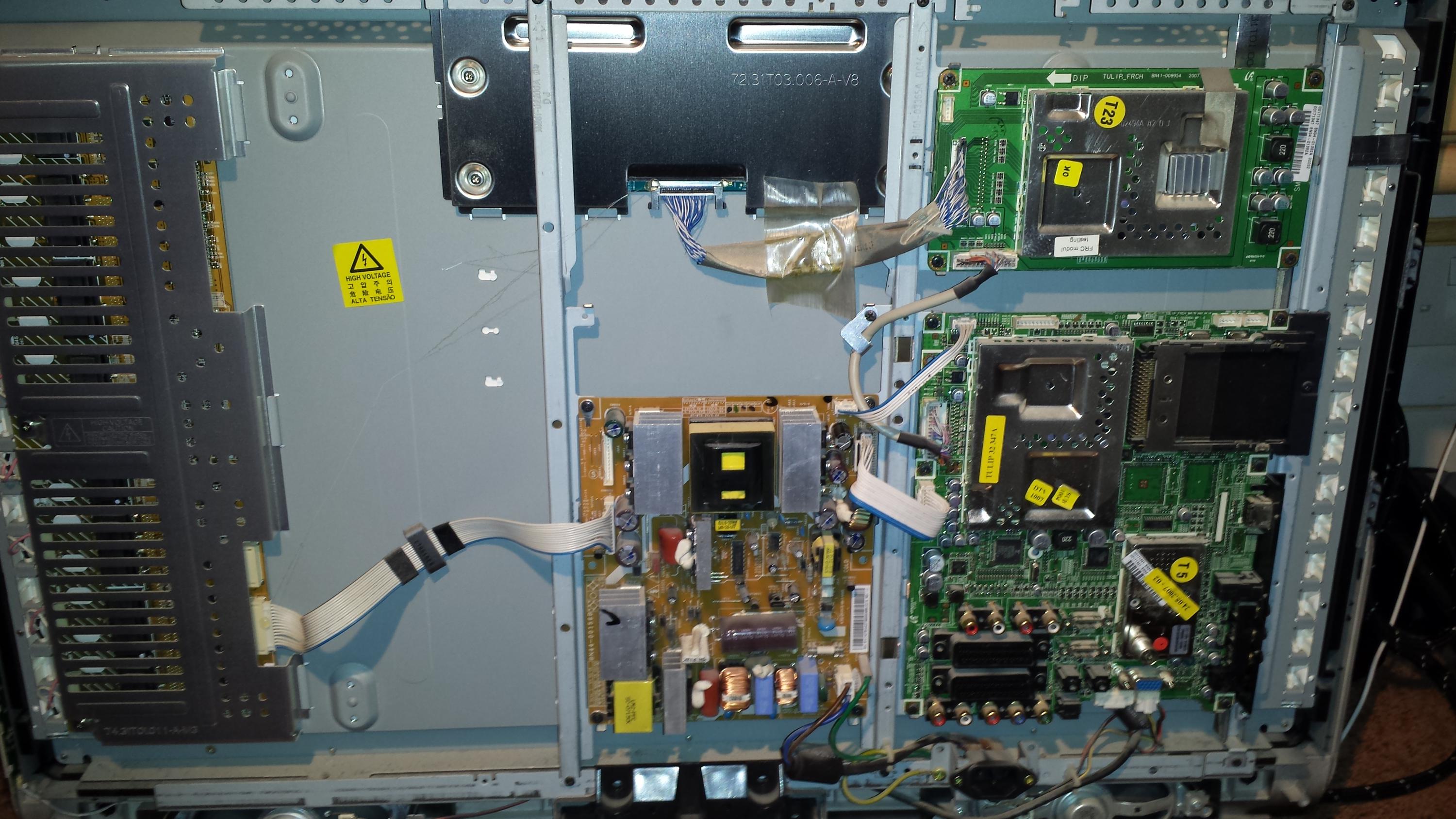

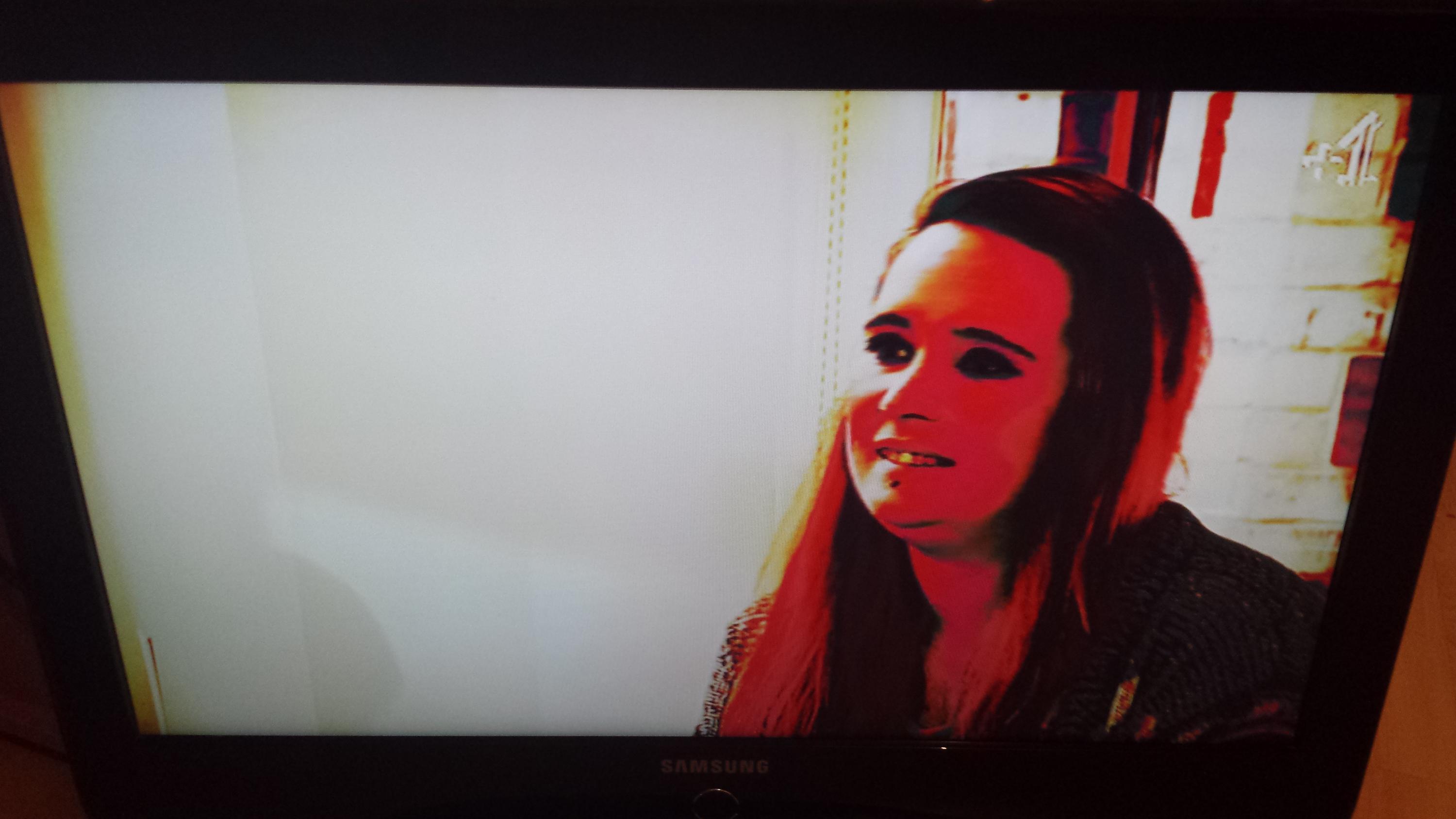

    Hi guys
    just a quick question got this tv today the colours are really bright,noticed one cap was bulged so changed that but still the same.
    so i need a second opinion tcon board gone ?
    thanks

    Re: Le32m86bd
    Opps forgot to post a picture of the problem

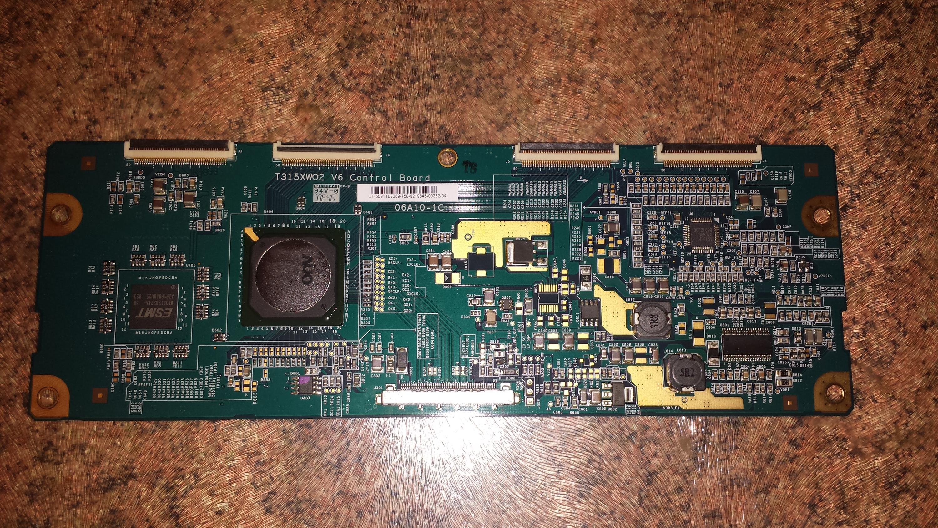

      I'd check and see if t-con has an AS15 chip on it... common fault.

        Re: Le32m86bd
        As15-f showing on the chip tom
          Re: Le32m86bd
          Good, near the top right of board and AS15 there are a set of points marked VGAMA1 thru VGAMA22, see them? With the board installed and TV showing picture, measure voltage on each point with respect to ground. Report each reading, along with VGAMA name.

              Re: Le32m86bd
              Definitely bad. Replace AS15 chip or t-con board and it should be fixed.

                  Re: Le32m86bd
                  Just a quick update replacement t-con board arrived all fixed !
                  thanks tom for your help
