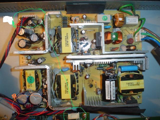

                        CN3 connector circled green goes to the main board and has 3 pins ground, 3 pins +24v, and 1 PS_on(blue wire). CN2 circled orange has 5 pins ground and 5 pins 24v. Does the main board convert one of the 24v lines to the 3 or 5v to switch the PS_on? I could disconnect blue wire(PS_on) but dont have 5vstby to jump to.
                          Re: Polaroid FLM 2632 wont power up, no lights
                          In this case, yes. So right now with just TV plug in but not turn on, do you get any DC voltage on any one of the output pins? We need to find the always on power supply section.

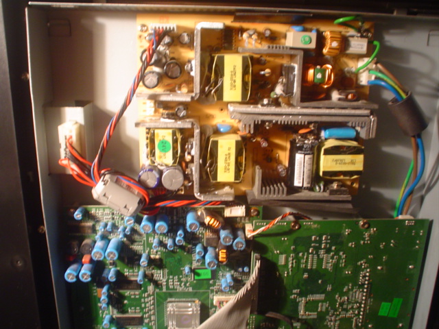

                              Can you test the small white fuse - cant see it in your picture -( they are not really clear enough for trouble shooting) It is on the board in pic 2 top right corner. Resistance test first then switch on and test voltage on bothe ends with respect to a ground screw.

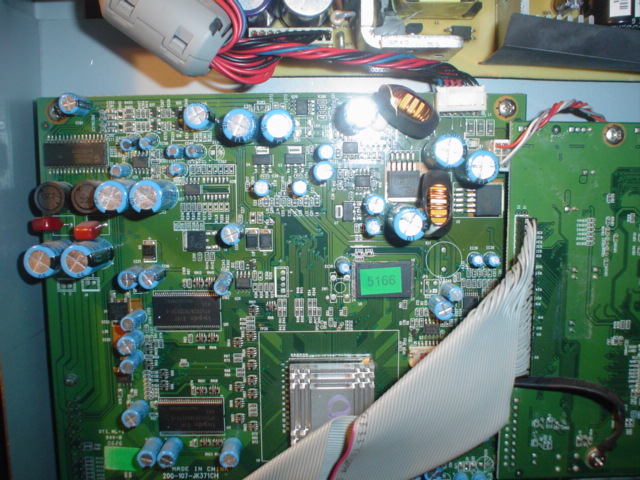

                                I checked that fuse and it has 24.1 volts to both sides. I also checked the voltage regulators and some of those show no voltage. U5, U6, U7 show nothing.
                                  Those two TOROID inductors and the two 5-pin ICs close by are buck converters that steps the 24V down to around 12V to run the audio amplifiers section, the other is for 5V convertor for the logic circuit, its output is further stepped down by the linear regulators. You can try to find the spec sheet to see how it works check the output voltages of both circuits.
                                    Sorry, been busy, first time in a few days to get back to checking tv. I checked the two 5-pin ic's...1501A 50 Vin +24.1v output 5.1 FB 5.1 SD 0
                                    1501A 12 Vin 24.1v output 0 FB 0 SD 4.4
                                    Looks to me like the 1501A 12 is bad. Would that cause U5, U6, U7 to not have voltage? And could that be why I am not getting voltage to PS_on? Its hard to tell what the circuits are not having a schematic, plus being a newbie.
                                      You trace out and see if the output of that supply feed into the inputs of the regulators.
