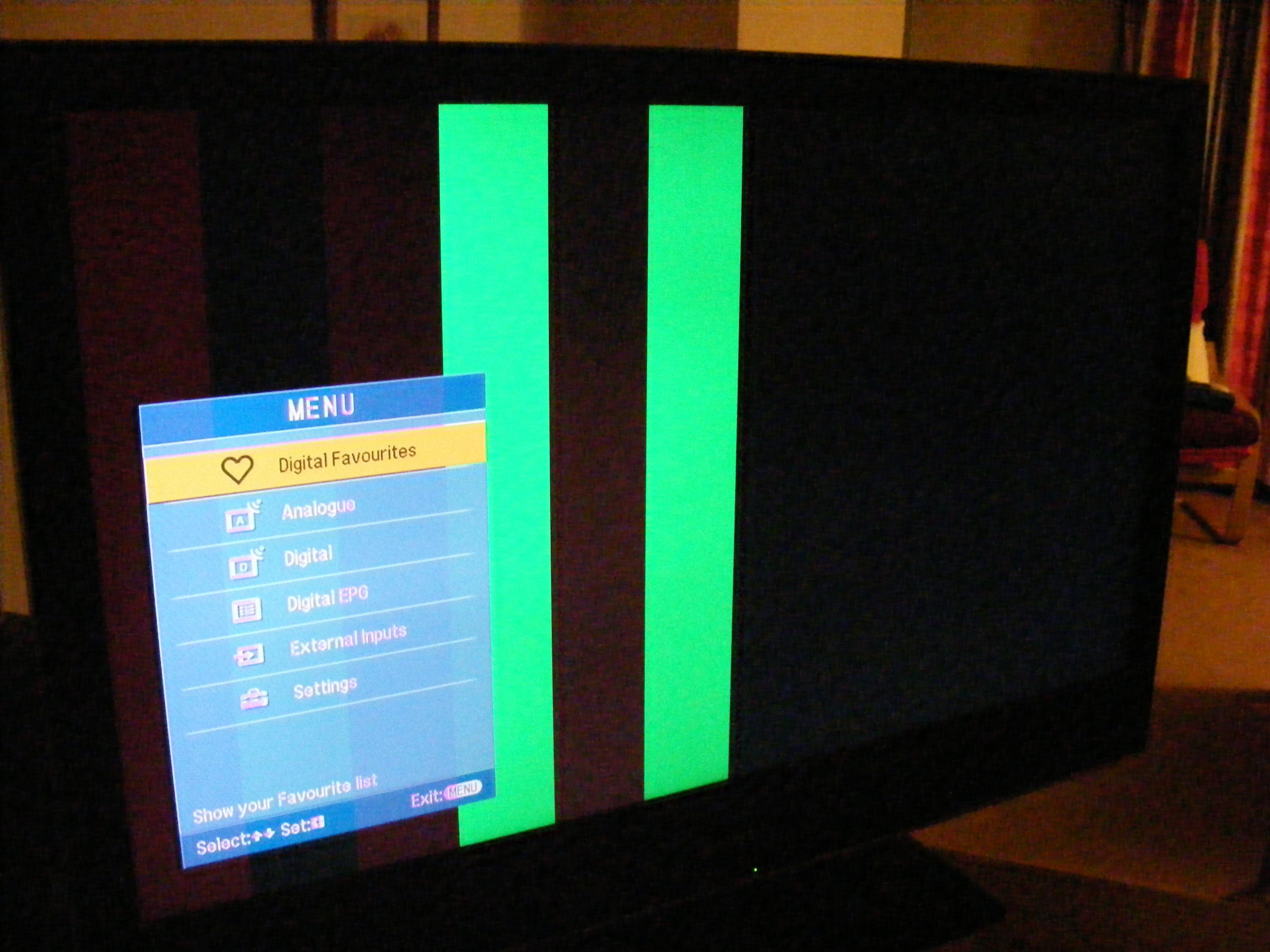

Sony KDL-46D3500 - no image, just bars

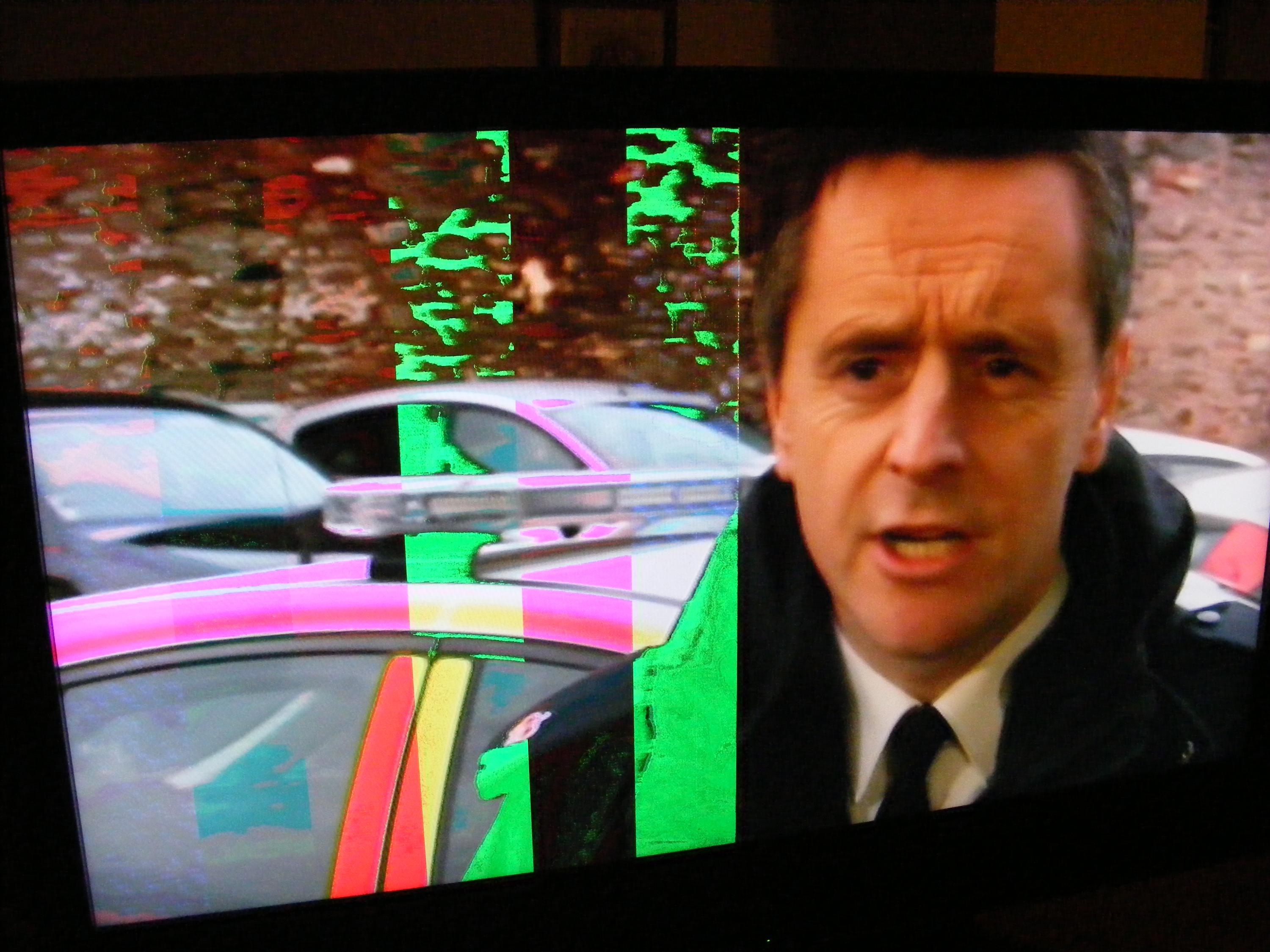

          So after receiving no replies.. (where were you guys??? ) I ordered a V0 board to try out.
          With the panel connected I get an image but with some bars on one side of the screen, and some funky colouring in the bars. The menu appears over the bars. Images attached.
          Are the bars likely a symptom of bad t-con? Or an incompatibility of the V0 board with the V2 panel/main board, or a problem with the tabs/panel? Something else? Basically I'm wondering if it's worth trying another V0 board or waiting for a V2.

            Tcon is fine. Menus appear over affected area. That has to be am incompatibility issue. Maybe a setting for this can resolve it?

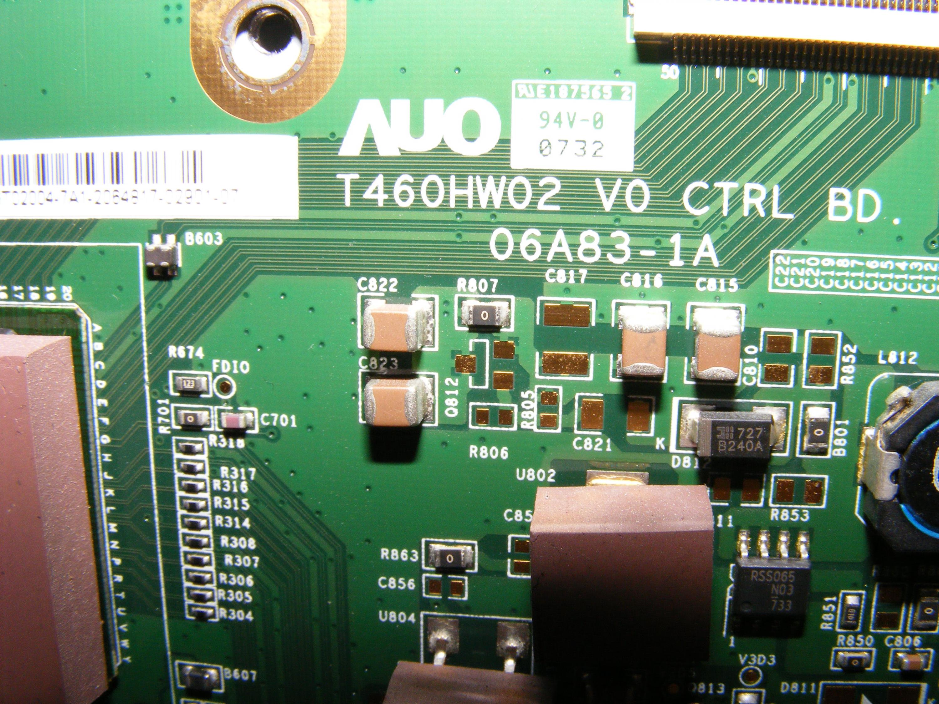

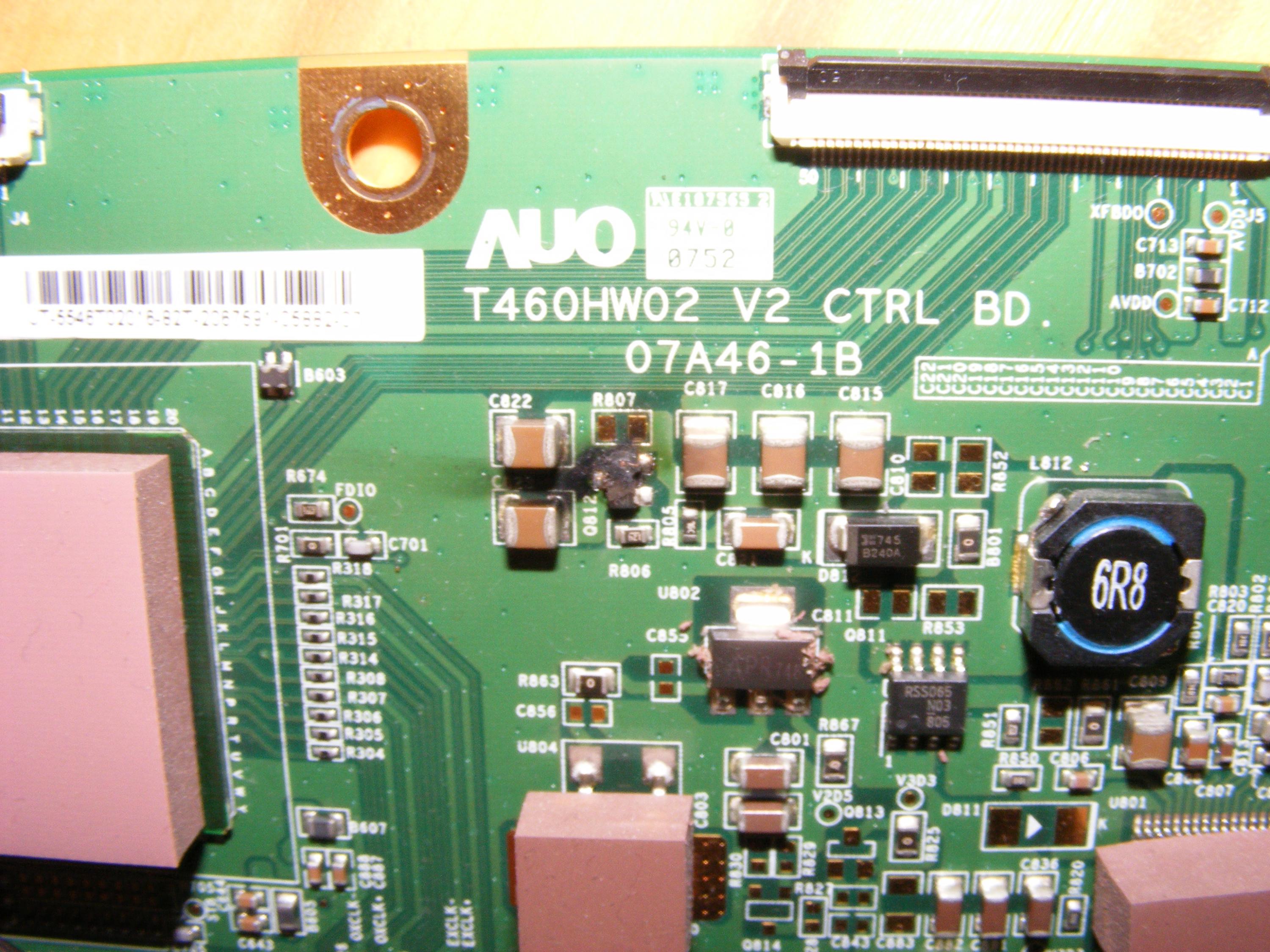

              Anyway, I'm happy to report the V0 board does seem to work for the moment with the V2 panel. Only difference I could see on the boards was actually around the transistor I fried on the first board - which isn't present on the V0, and a couple of resistors and caps are different next to it. (see pics)

                For anyone that's interested, I found out that the bar issue is affected by pressure on the large BGA chip on the t-con. With the cover in place there is constant pressure on that chip hence the image improving but the problem has started to creep back in even with it all screwed together.
                My guess is the solder balls under the chip are aging and need reballing. So looks like another bad t-con then.

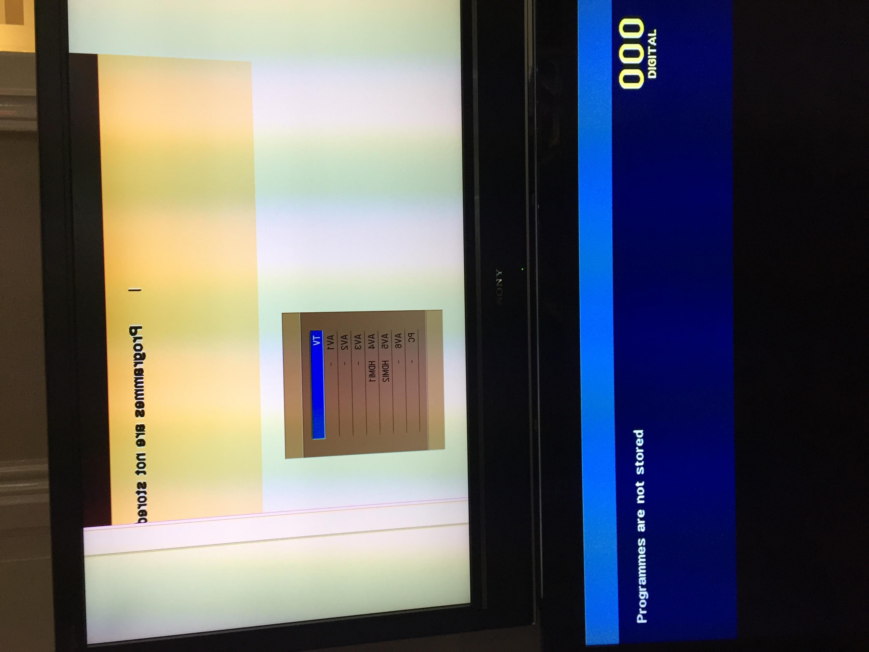

                  Hi guys, I have this problem, the tv below is via scart so im assuming its not a Main Board problem.
                  the image is split and the menu is in reverse
