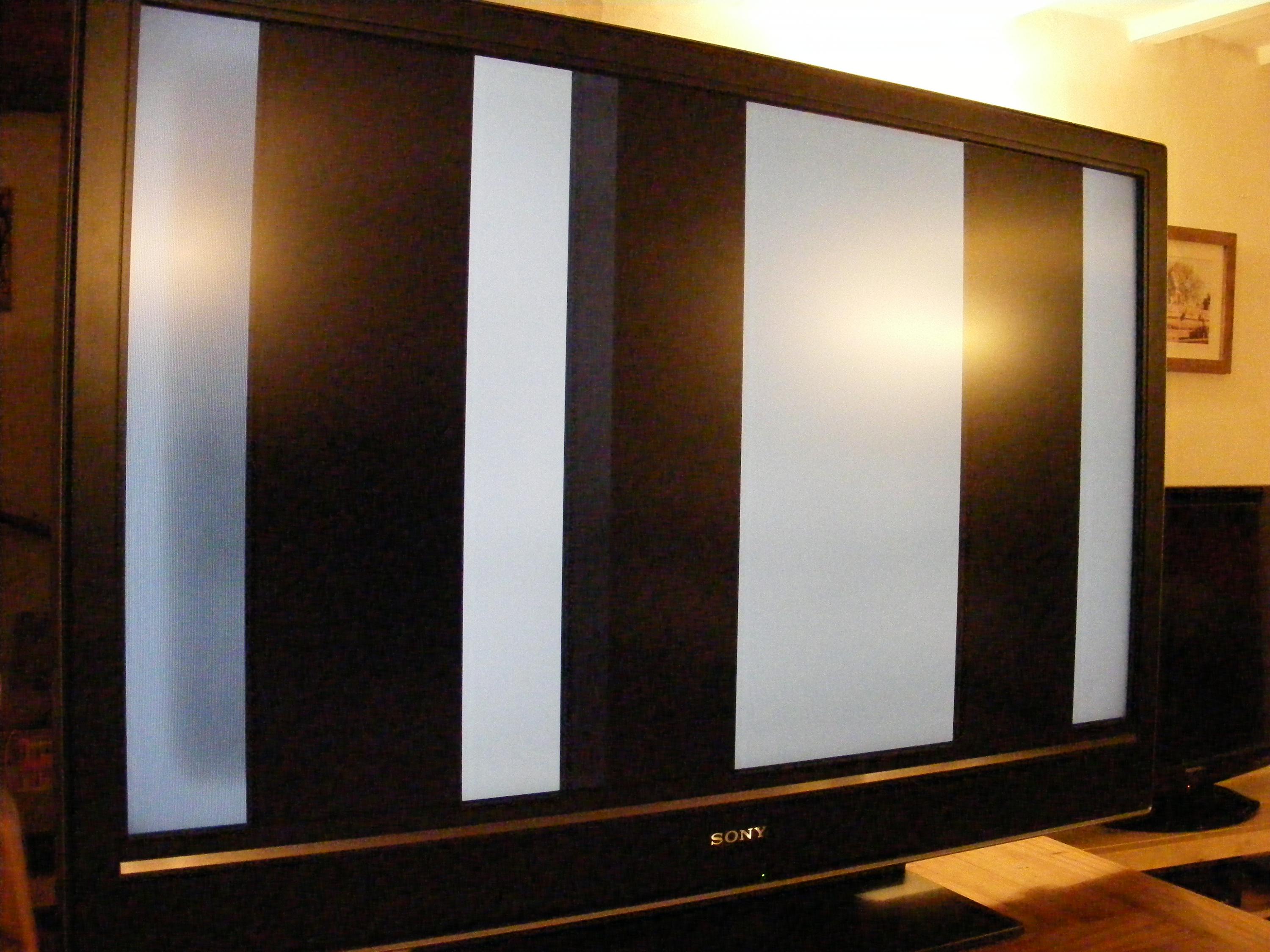

    Sony KDL-46D3500 - no image, just bars
    Hi
    What does this look like to you? t-con? Panel? Main?
    I'm interested in replies, maybe I'll fill in the back-story later.

    Re: Sony KDL-46D3500 - no image, just bars
    is that with a signal?bring up menu,the same?,im thinking t-con on this one
    tab bonds as far as ive seen so far resemble thin lines rather than big block lines,but dont quote me on it.
    things to try...
    re-seat lvds cable after cleaning both ends with iso-alc
    also the tab bonds if they removable and not intergrated in the screen
    check voltage at t-con,and for anything getting hot on there,gamma chips processor etc.freeze spray can be your friend here,(blast it around the bezel joint of the panel boarder),may shortly bring picture back.
    flex the screen,does anything change,(will also confirm bad tab bonds)
    test mainboard by scart socket out to another tv,if pic good ,mainboard should be ok.
    what panel is in this tv ?,auo,samsung?,chimei?.
      Thanks multimeter! Very helpful.
      It's with and without signal. Changes in signal and bringing up menu only change the brightness of the pattern. After leaving it on for a while some coloured thin lines do sometimes appear and also a slightly darker grey rounded inner box visible in the light bars as can be seen a bit on the left bar on the above attached image.
      Interestingly with the t-con metal shielding removed for testing voltages, the display shows only all white.
      Connecting to another TV by SCART I can display TV channels, but not menu or HDMI inputs. Is that normal behaviour? Thanks for this tip. Didn't know I could do that believe it or not.

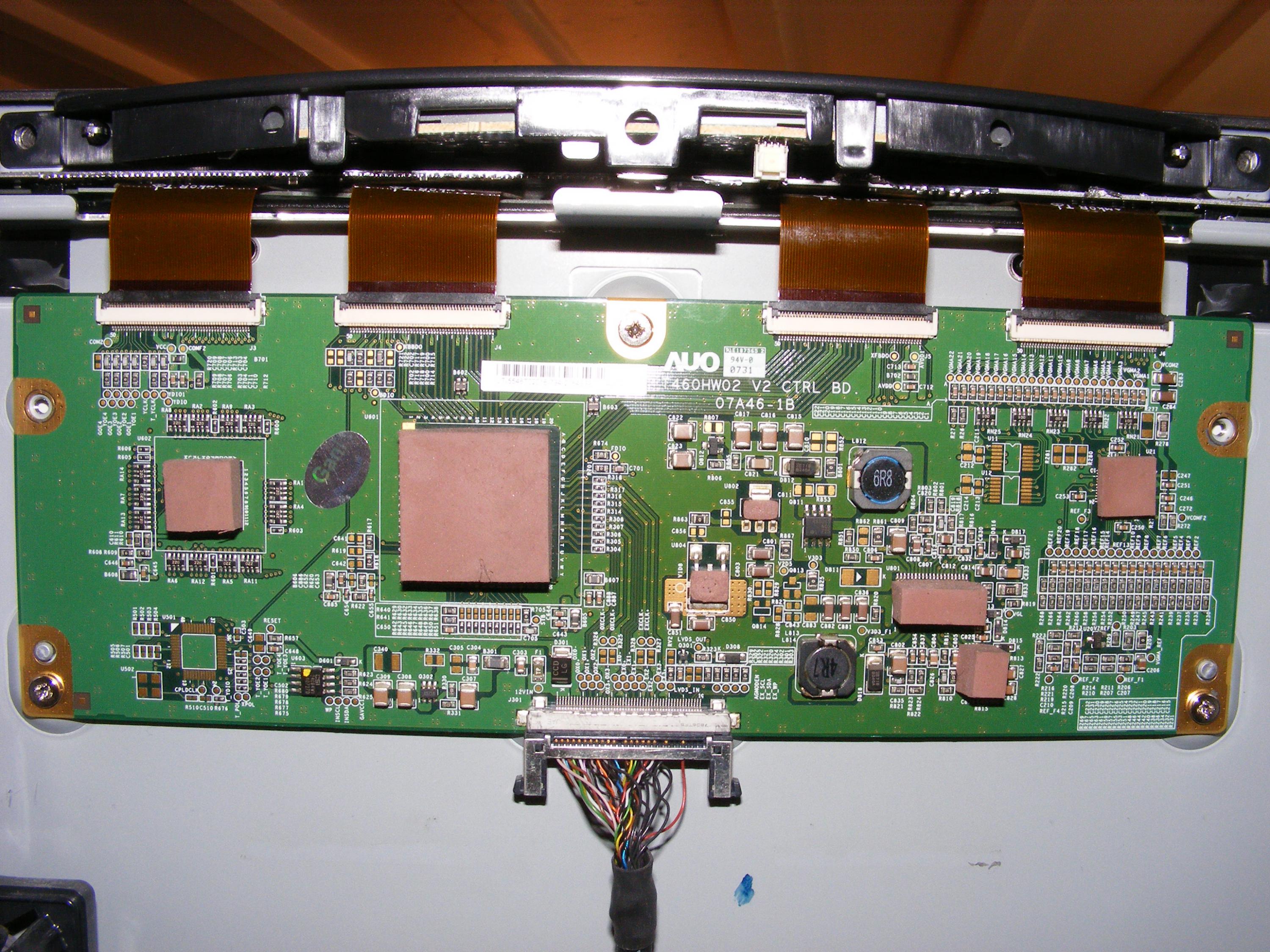

      t-con voltages:
      12VIN: 12V
      VCC: 3.34V
      VGL: -6V
      VGHC: 0V !! This should be ~25V right?
      Couldn't find VGH to test. Gamma voltages look ok. Nothing on t-con is getting particularly hot.
      Panel is AUO T460HW02 V4
      So would 0V VGHC cause this symptom? Does this confirm bad t-con or could something else cause VGHC to be 0V?
          if you have scarted out to another tv,you should see the channel program being viewed,the menu may not come up as it will be another section on that mainboard that deals with all that,the scart out option will normally be video and audio.
          25v on vghc,seems a little too high,can you give the part number of this t-con
          im thinking t-con,or panel
          have you tried flexing the screen around its bezel? ,if its tab bonds it will alter the picture,i like to grab top 2 corners and twist lightly
            ok can see part number..on pic

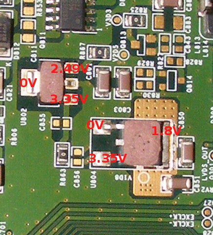

                  can you check input output voltage from u802,looks like an adjustable regulator,check for input voltage ,(vcc),check for output voltage,(normally the large fat tab)if you get stuck put up the part# for that regulator
                  hopefully there should be input voltage,a reduced or missing output would be a failed reg.

                  • tn245
                    • Oct 2013
                    • 530
                    Here you go. Also tested U804 While I was at it.
                    So, looks like U802 is bad?

                      • multimeter
                        • Jan 2011
                        • 739
                        • united kingdom

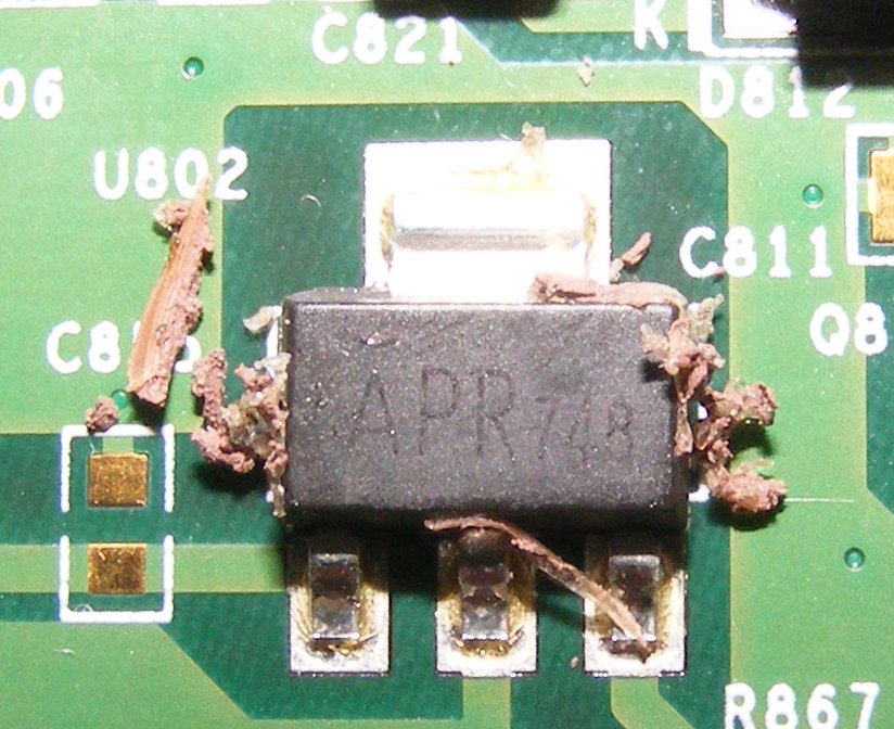

                        whats the part number of u802 reg?
                          After scraping off the thermal crap it looks to me like the markings say APR 748. I didn't find any datasheet for it.
                            VGH should be around 25V, this could be causing your fault
