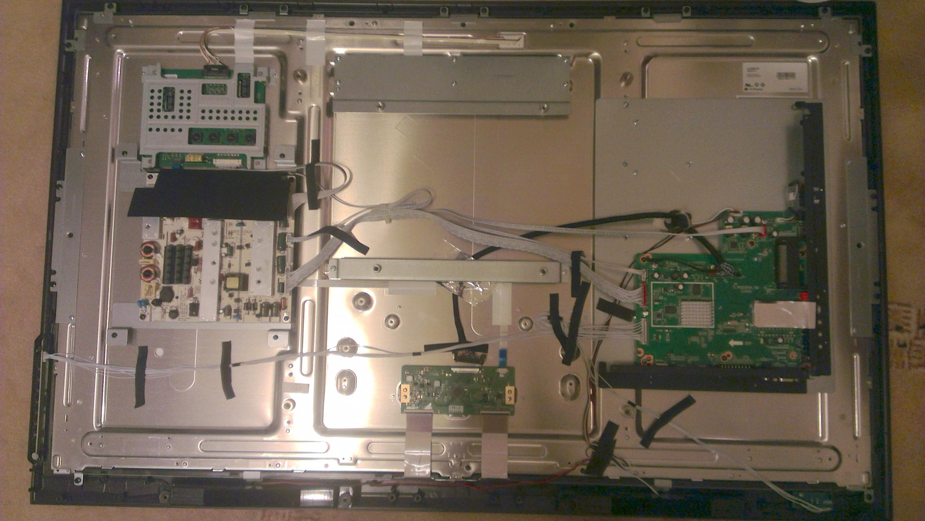

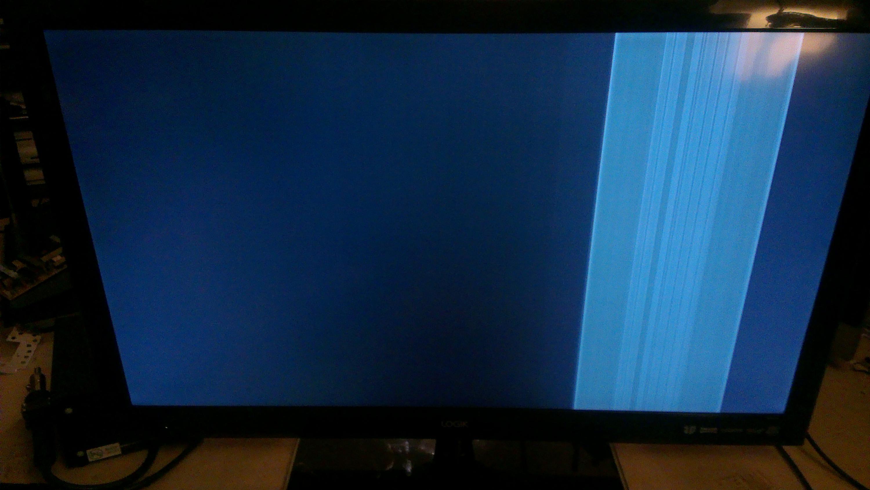

    i have a logik l423ed11 42inch lcd, the picture shows a vertical line that moves from left to right, i think it's the 'no signal' logo which is moving about. if i press menu a wider pattern comes up in the middle.
    any ideas what this would be, panel / main board / tcon?
    thanks

    It's a fairly new TV so I'd be going "PANEL!!"
    There is a chance, if the t-con is separate, that a loss of VGH or VGL voltage could also cause this.

      hi tom i was thinking the same
      it does have a tcon though so maybe there is hope?

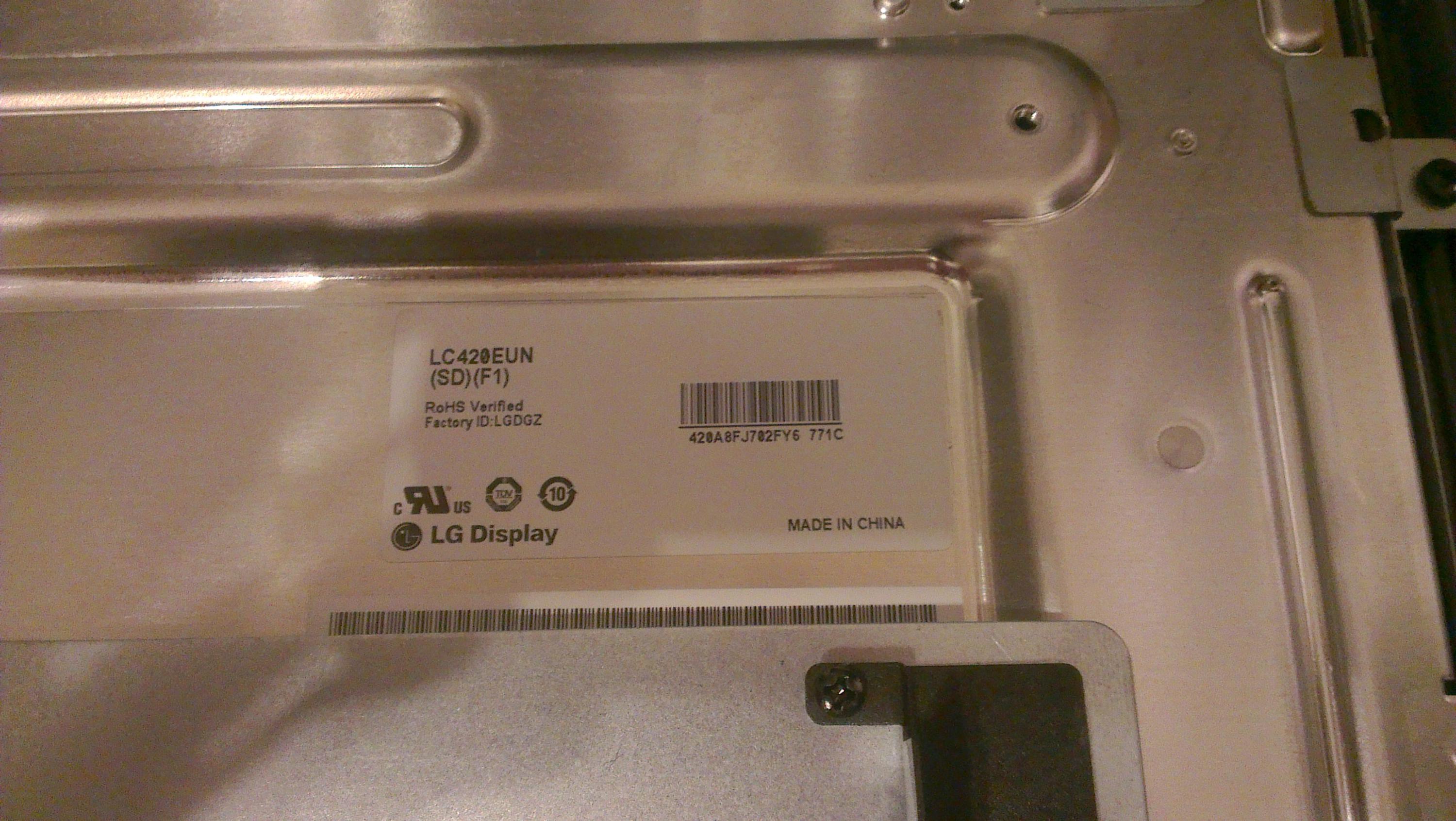

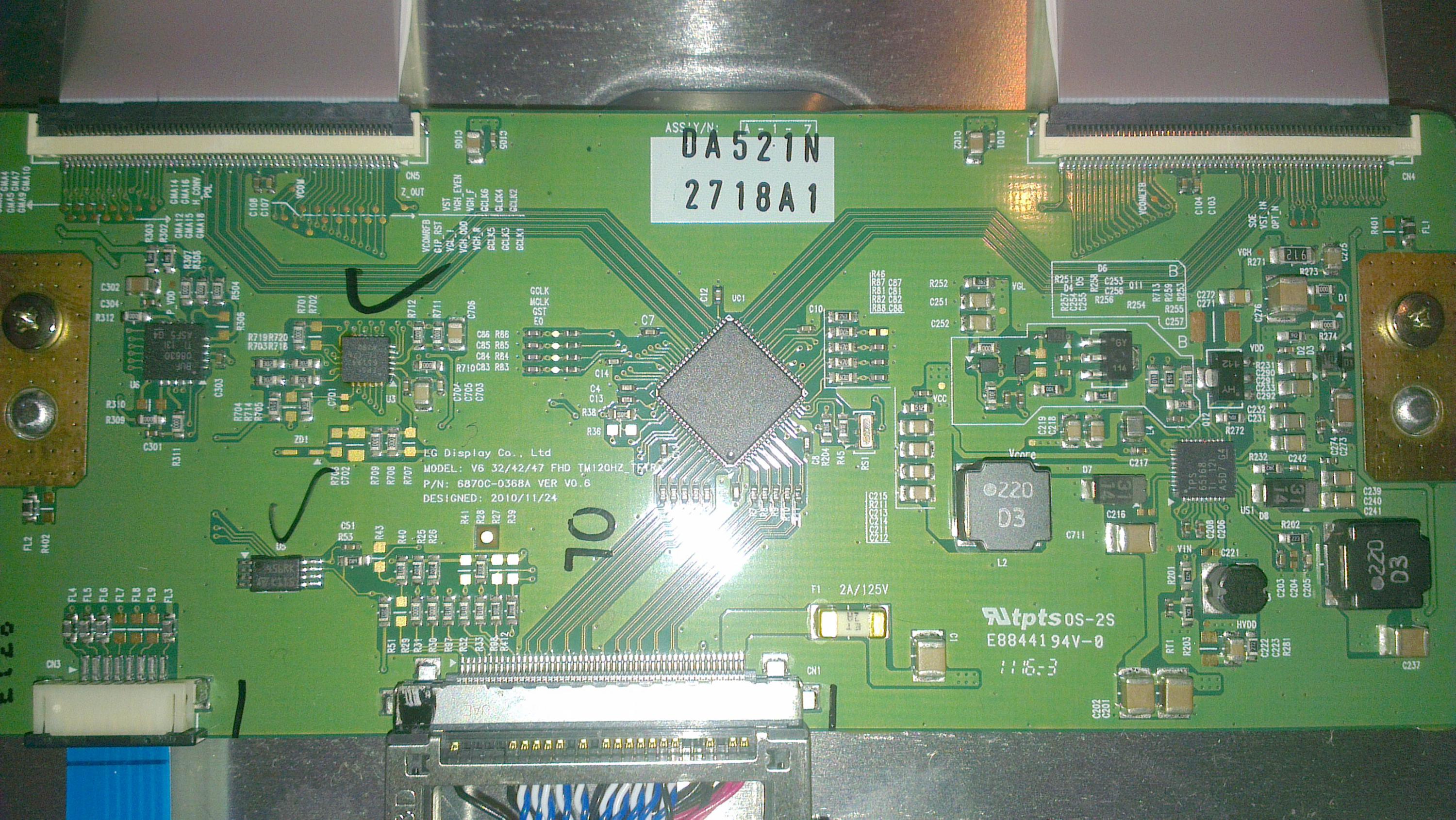

      it has an LG panel LC420EUN, with an upside down tcon

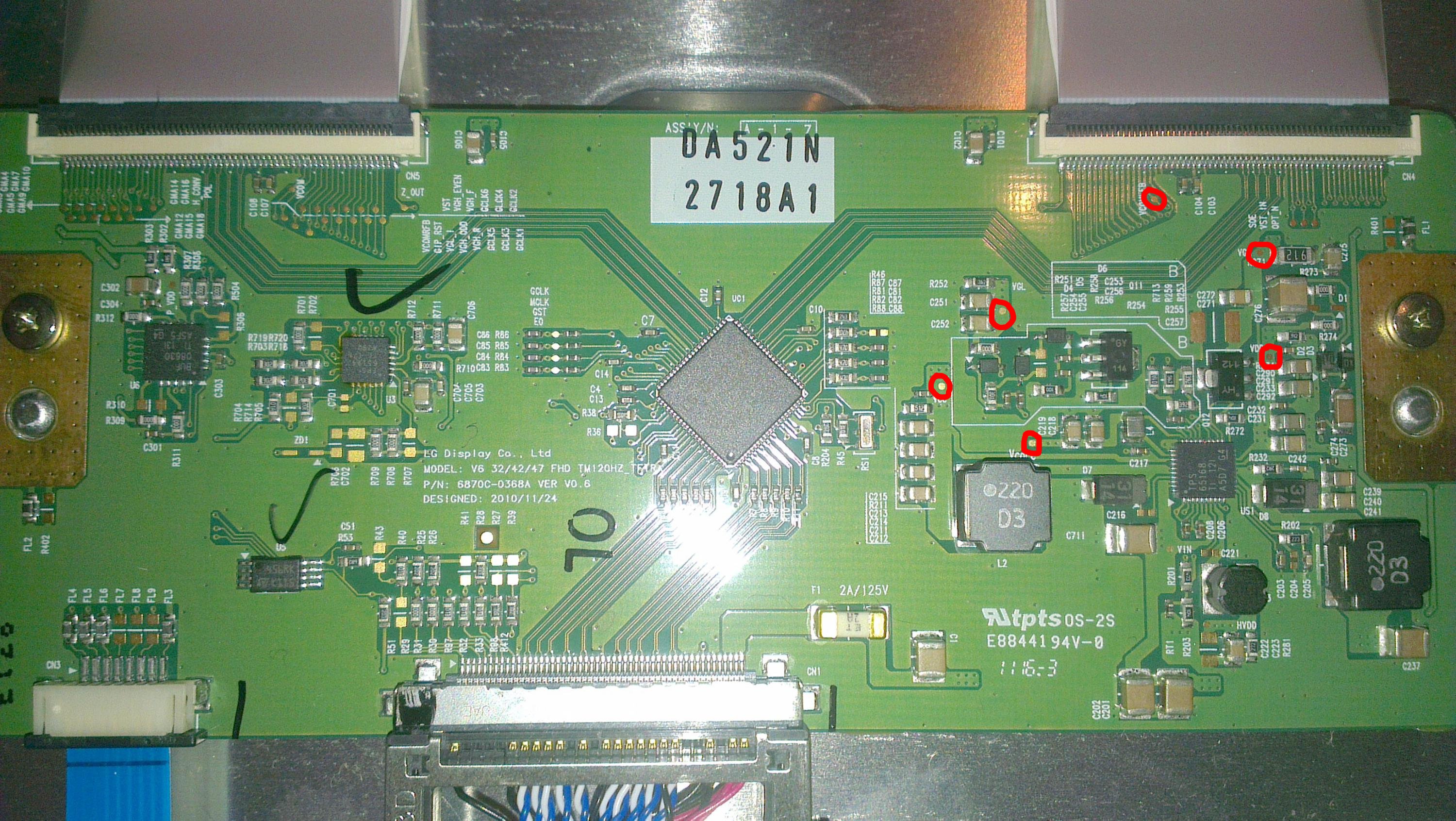

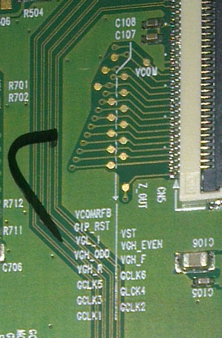

        Need a shot of this board.
        https://www.badcaps.net/forum/attach...3&d=1390070388
        where the labels can be seen for test voltages. Like VON, VOFF, or alternatively VGH and VGL.

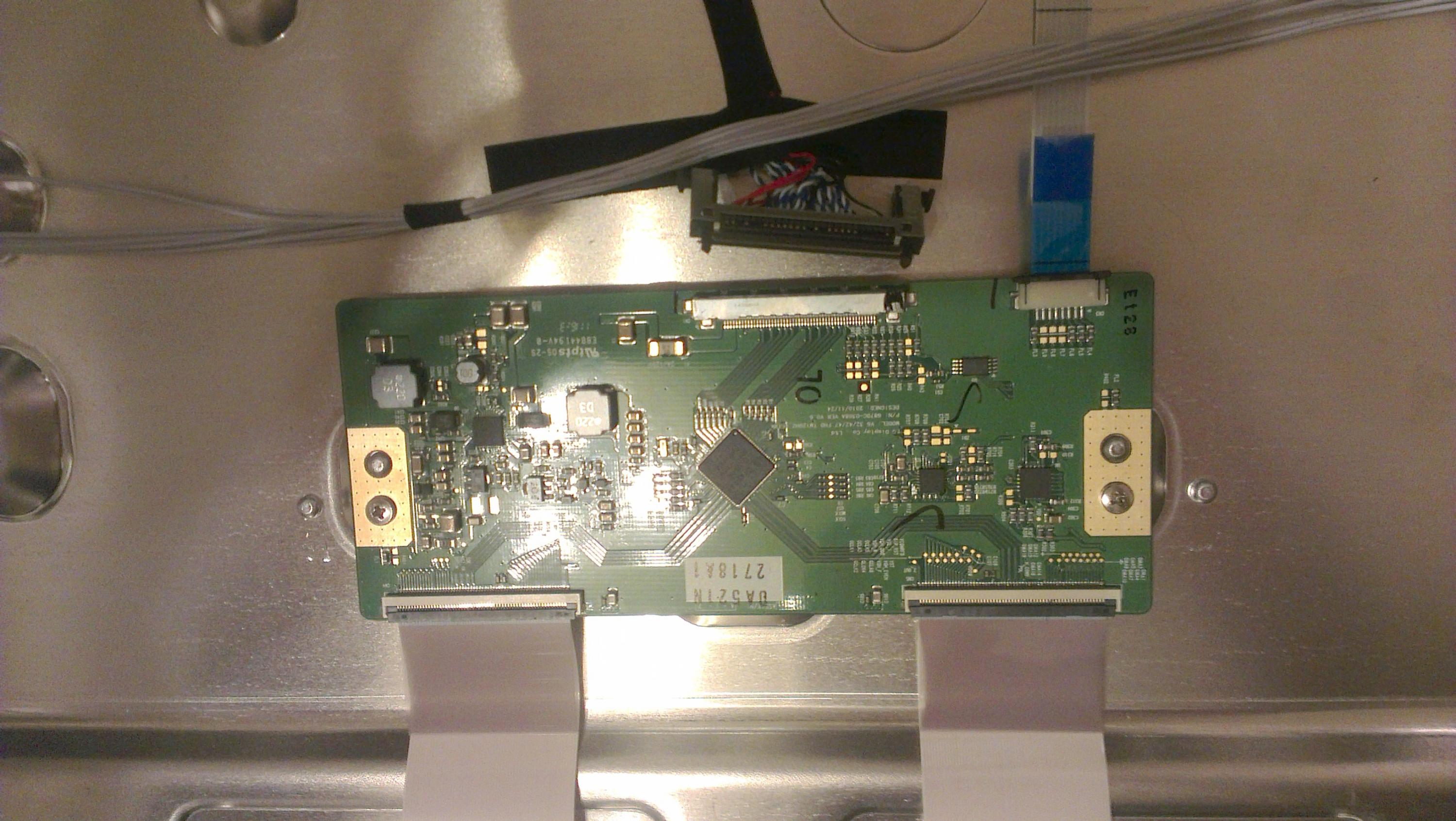

          here is a close up of the tcon

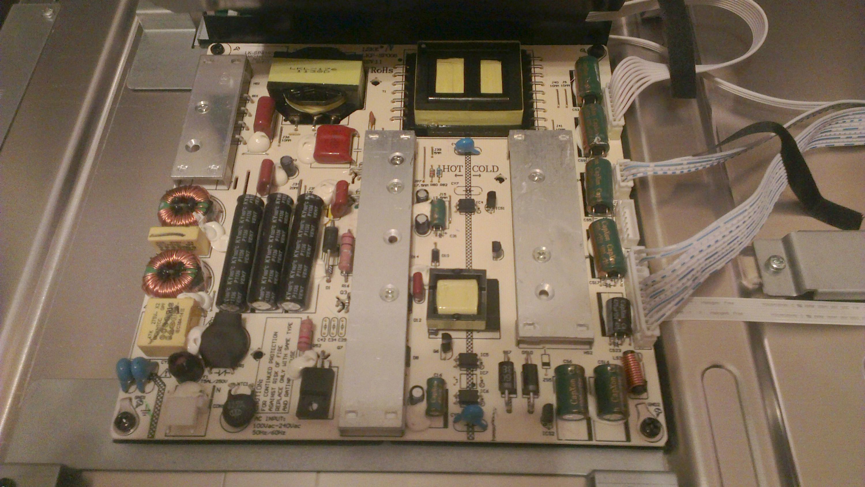

          there is 11.85v on the main fuse.
          what else can i check?

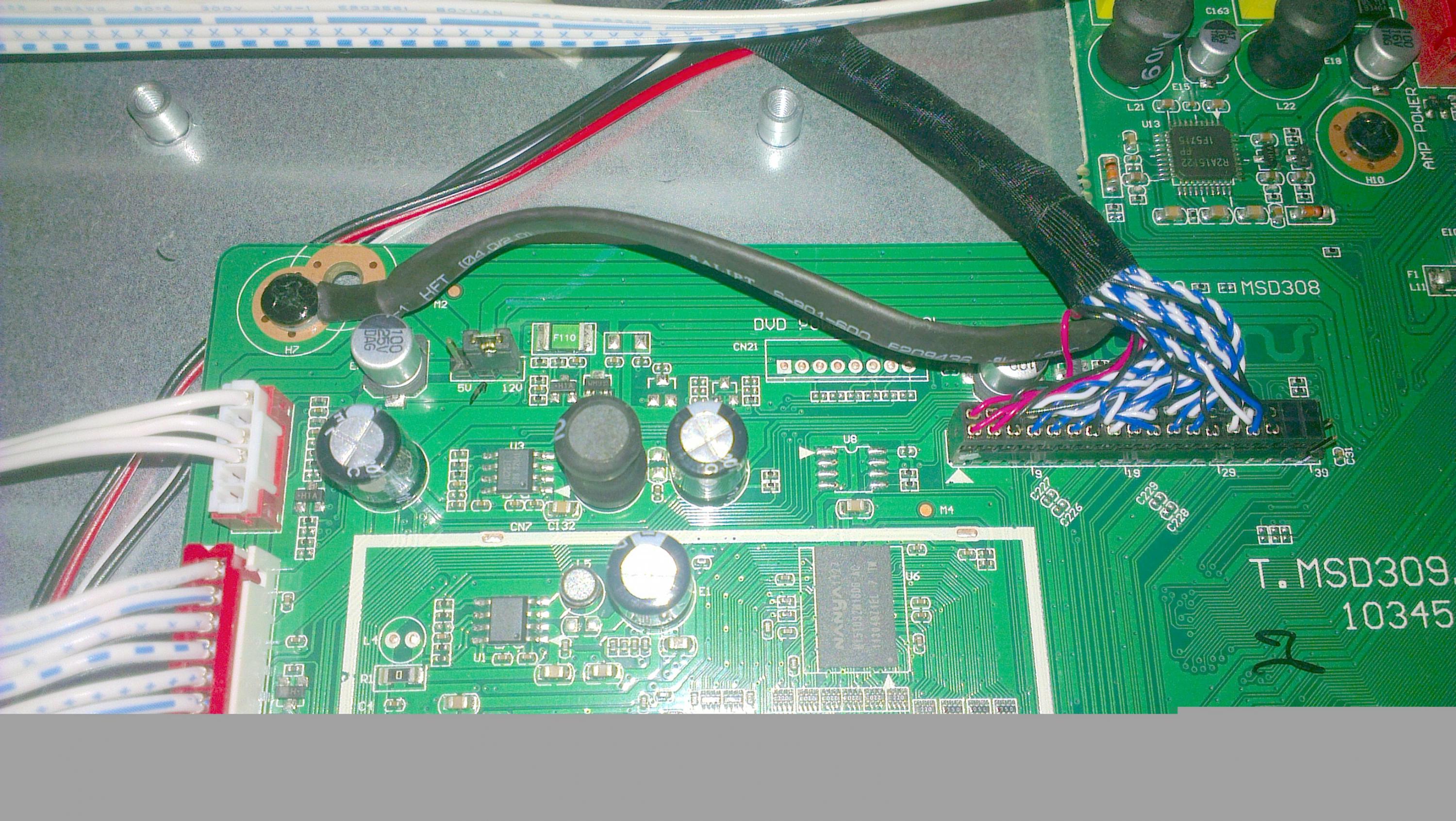

          the main board has a jumper that sets either 5 or 12v for the tcon
          i can get the tcon on ebay, £20

            the pads on the right half mostly measure -.97v
            the left most one (vcomrfb?) is 5.61v and vcom is 5.61
            z out is 5.8

                See image. Test each ringed point, board plugged in and set powered up, DC volts, red probe on point, black probe on chassis. Report adjacent label to each point - VGL, VGH, AVDD, AVCC, Vcore, VCOM_FB.
                  Re: Logik l423ed11 vertical lines
                  ok i get:
                  VGL -0.97v
                  VGH -0.73v
                  AVDD 11.56v
                  AVCC 3.29v
                  Vcore 1.97v
                  VCOM_FB 5.14v
                    VGL and VGH are your problem. I bet, since voltages are so close, there is a short between them in the panel. Try unplugging one ribbon at a time and see what happens, sadly this will probably NOT be repairable.
                      with the ribbon near them out they are the same (vgl -0.97 vgh -0.73). with the other ribbon out only, vgl is -1.56 and vgh is -0.73
                      with both ribbons disconnected: vgl is -1.56 and vgh is -0.73
                        Sounds like a short, which has since damaged them, you could try replacing the components around there (likely a transistor or resistor) or the t-con but I suspect there's a fair chance they'll fail shortly afterwards due to panel fault.

                            VGL around -5V to -10V for all panels.
                            VGH around +20V to +28V for early panels, +17V to +30V for newer panels like this.
                            The VGL deselects a line on the screen, so it doesn't take data, VGH selects it, the Gate in Panel driver (see DS: ) swings between VGL and VGH for each line in the screen.
                            So when a line is at VGL, it is "muted" and it is not looking for data, when it is at VGH it is listening for data, in between the two it could do either, I think that's why all lines show the same.

                              i took the panel out and removed the bezel to see the boards that are bonded to the screen. nothing much to see except one is sticky. looking at the edge of the panel something has been spilled on the screen and run down onto the left board (panel is mounted upside down). it looks like it was coke, its brown and sticky. theres not much on these boards only 2 pin components. i think there's a chance if i clean this off and buy another tcon it might work?alcohol spray and a tooth brush?
