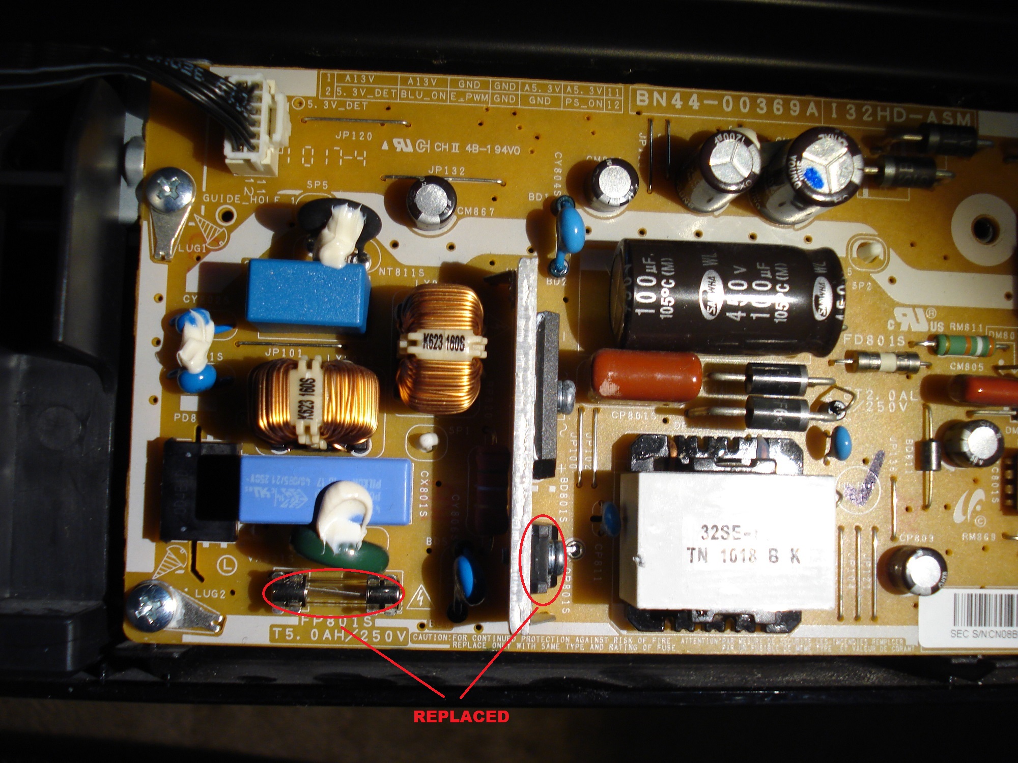

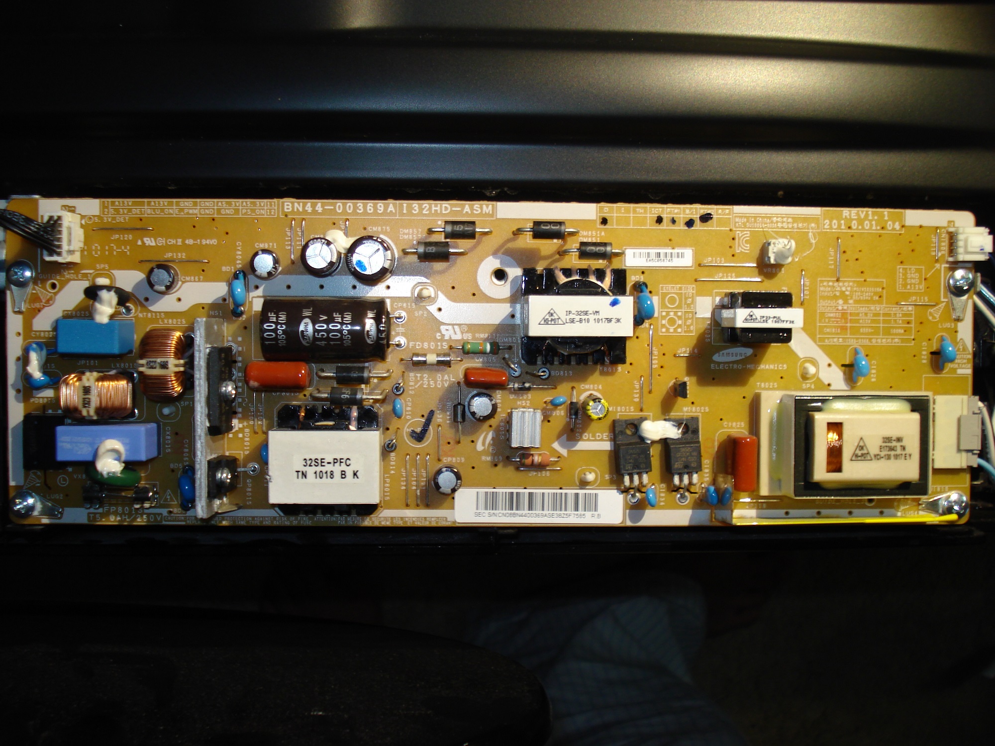

    Hey guys, I need some help with this one.
    I initially got this set with the problem of no power and no standby light.
    I opened it up and found a bad mains fuse and one shorted FET that's labeled 10NM60N. I replaced the fused and the fet with a 10NM60ND.
    The standby light is now on and the set turns on with the Samsung chime but there is no backlight. I shined a light on the screen and can see the picture.

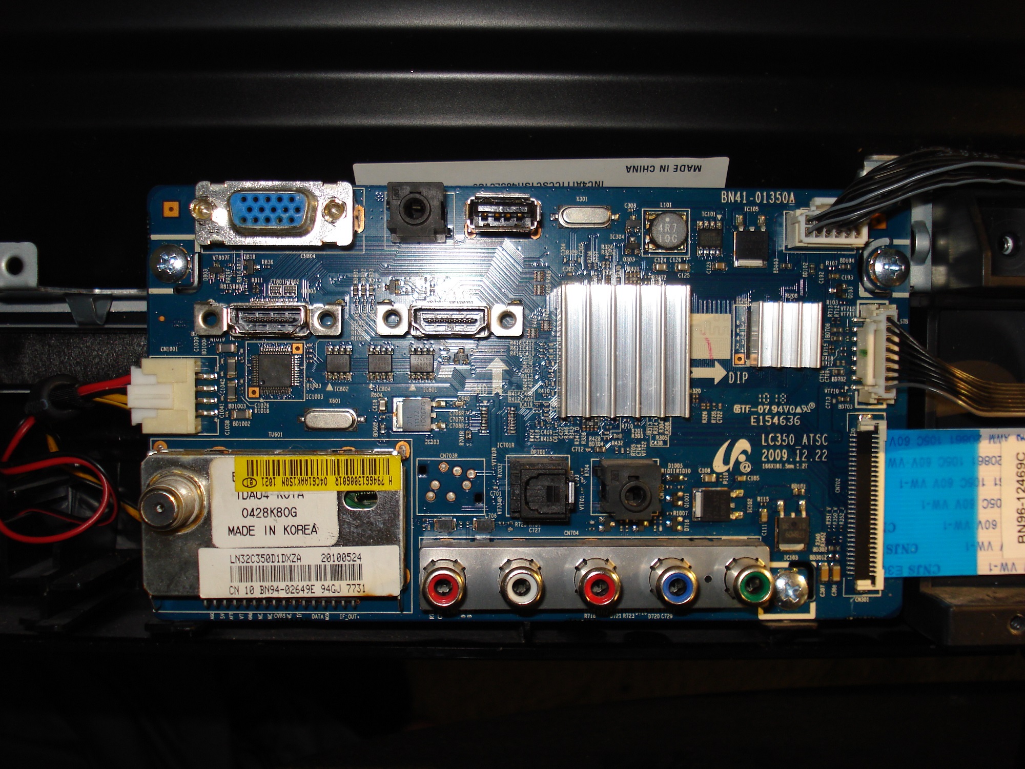

    How do I know if this is a main board or PSU/inverter problem? What voltages should I check?
    Re: Samsung LN32C350 No Backlight

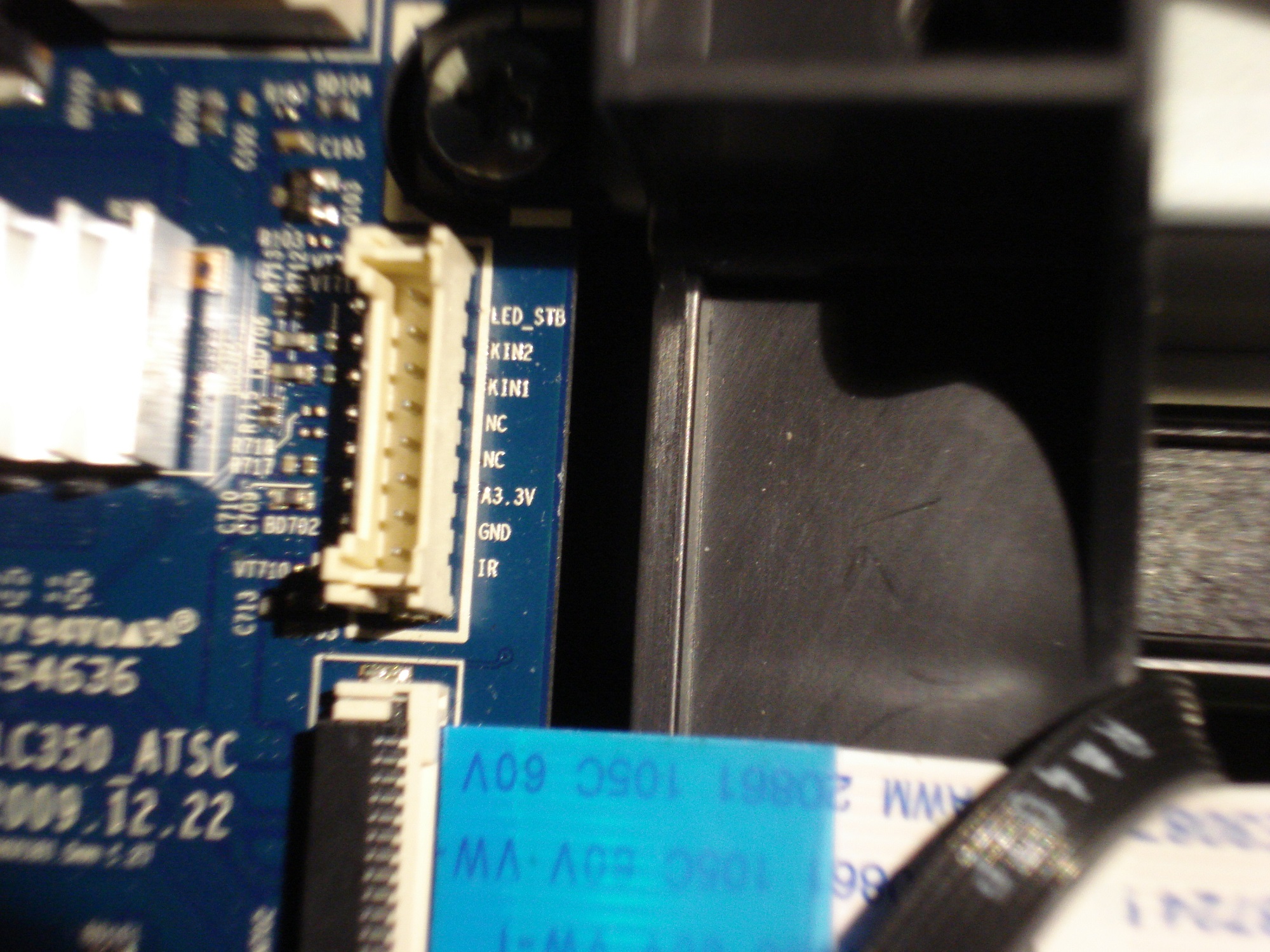

    Look to see if the main board send the BL_ON signal to this power supply/inverter combo board. Check the DC voltage on the big main filter to see if it has about 370~400VDC right at the two legs.
    • Glitcher
      • Mar 2013
      • 673
      • USa
      Hmm I only see one labeled BLU_ON, is that the one? Its measuring 0.05V

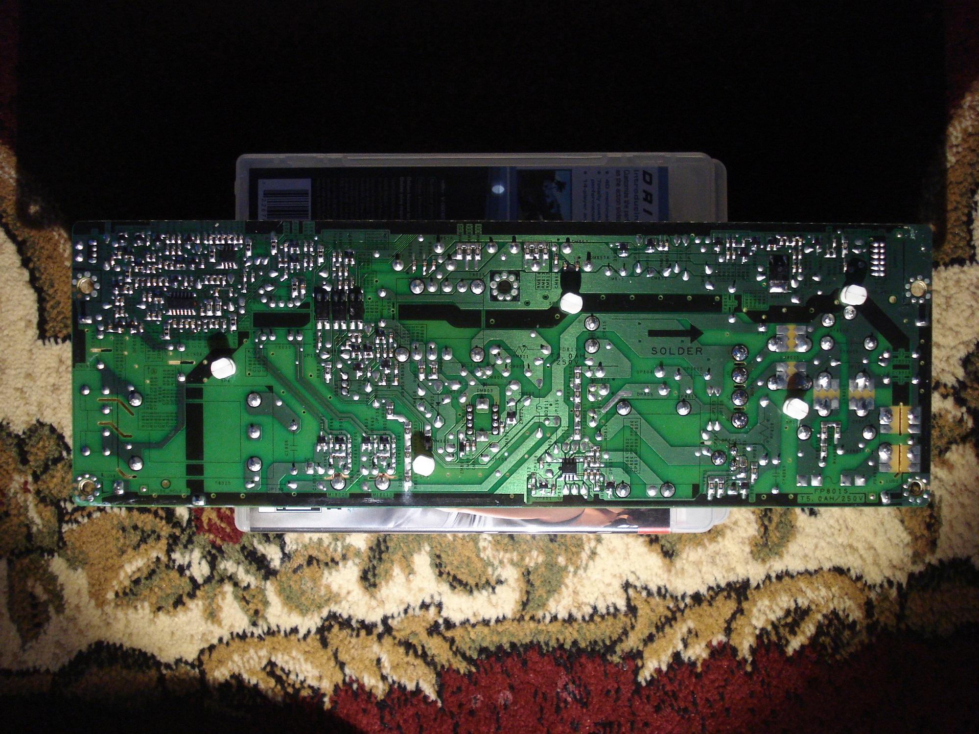

                  Post good pictures of the bottom side of this PS-Inverter board, in the means time check all the Diodes (especially the two black one next to that main filter cap) on the primary side of the circuits, and look for any burnt/damaged parts.
                  • Glitcher
                    • Mar 2013
                    • 673
                    • USa
                    So far I checked all the diodes on the PSU in circuit. They all seem good with readings in one direction and infinite in the other.
                    There are no obvious burnt/broken components that I'm seeing.

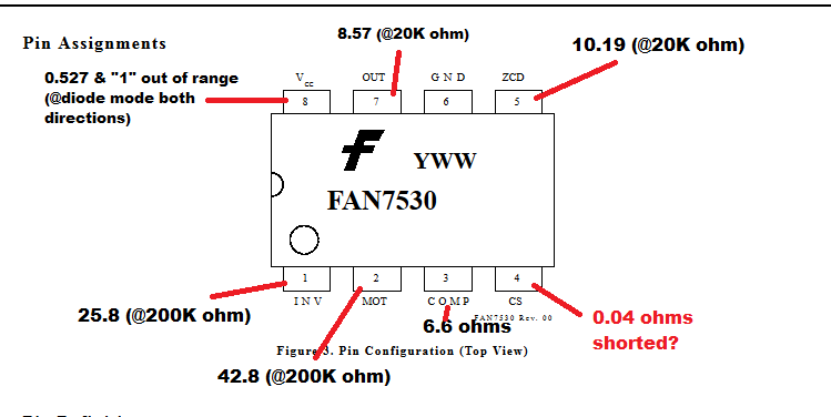

                          I checked the resistors directly connected to the gate pin and they measure to the correct range. The diode beside is still in question, since I'm not sure how to check that.
                          I'm guessing that 8 pinned IC (IC802S) to the left of the FET is the PFC IC ? From tom's schematic its a FAN7530MX. I found the datasheet for it but not sure how to check if its still good. Should I check the voltages of each pin, and since its in the primary side, I should check them relative to the main cap correct?
                          Tom - Thanks for the schematic, I checked DP805 out of circuit and it appears normal. What did you mean when you said to check the "Vcc"?
                                Measurements are shown below in the photo.
                                The Vcc pin measures 15.9V while the set is on.
                                The CS pin has a low resistance reading, but im not sure if it means it shorted or not. Measuring the voltage it reads 0.71V while set is on.
                                Reading the datasheet
                                Pin 4 CS: "This pin is the input of the over-current protection comparator. The MOSFET current is
                                sensed using a sensing resistor and the resulting voltage is applied to this pin. An
                                internal RC filter is included to filter switching noise."
                                Not sure what it means.
                                  CS pin is connected to ground via very low ohm resistor (<1 ohm) so that's normal. If you have got 16V at that IC you should have PFC voltage.
                                  Check DP803, RP803, RP823, RP802 (SMD resistor/diode probably.)
                                  DP803: normal diode check (not open)
                                  RP803: 30 ohms
                                  RP823: 68 ohms
                                  RP802: 10k ohms
                                  Also CP810 - across diode DP805 - should read open
