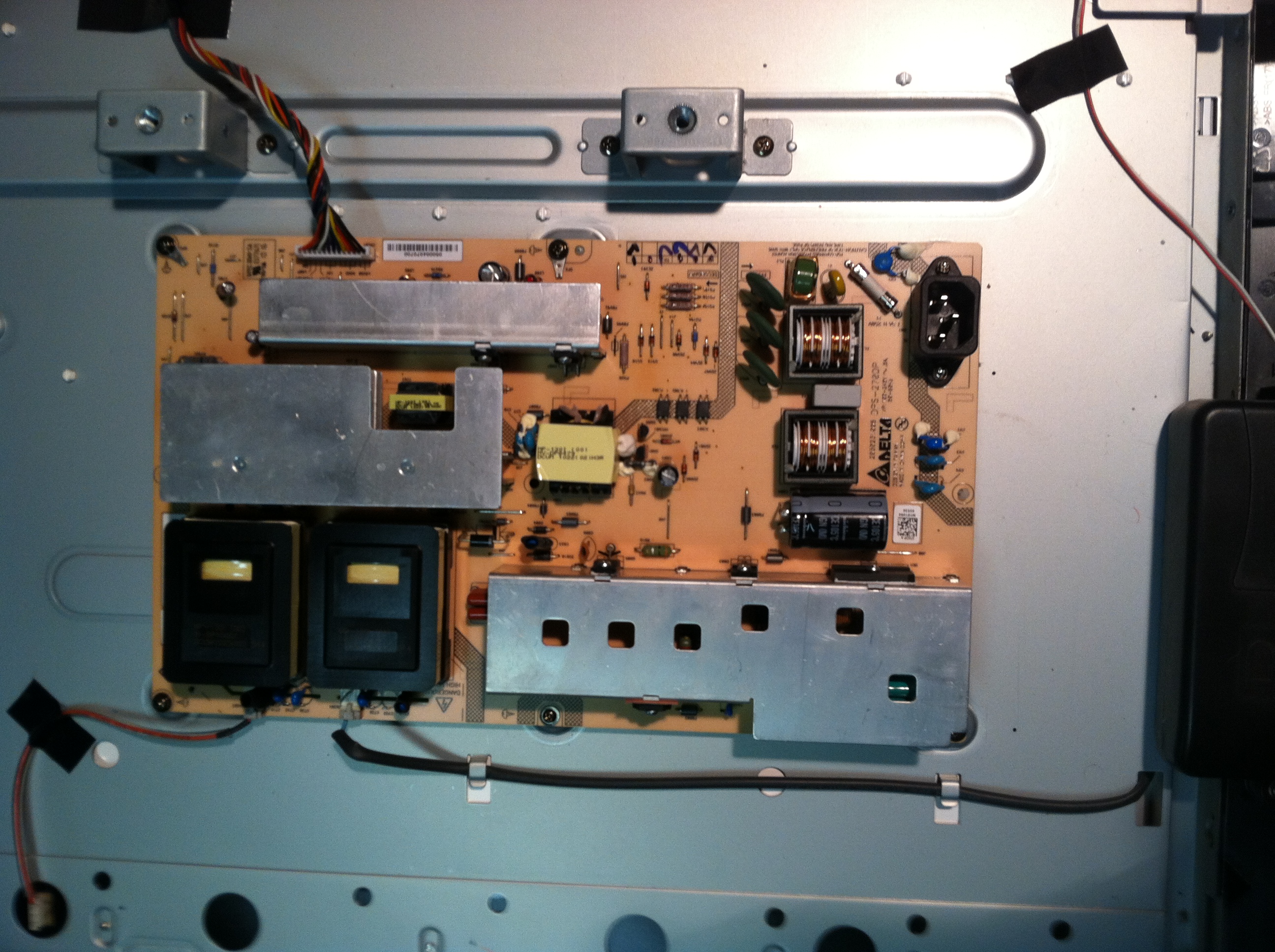

    Vizio E470VL backlight shutting down
    After reading many, many post here and I have narrowed down the problem to one of two possibilities I think. I can get the backlight to light up at the most sometimes for one or two minutes then i would lose the signal going to the power supply board on pin two of the white 14 pin connector. ( pin 2 is lamp ). If I disconnect the high voltage lines going to the lamps then the signal does not go away. I put my meter on the megohm setting and measured from chassis ground to the pins going to the lamps and read open which is good. I then hooked everything back up and the lamps were on for about 30 seconds before shutting down. I have a static bar checker from the days I worked in industrial electronics which is nothing more than a neon lamp in a tester the size of an ink pen. Using the neon light test I noticed that getting close to the blue caps next to the bottom connector that the neon lamp was alot brighter than next to the top three blue caps. I am thinking that the blue HV caps might be breaking down under a load. Would this cause the symptom?? Also I have checked all mosfets on the main and power supply boards and they look good. The caps have no markings on them. I found some on ebay that say they are used in HV sections of alot of LCD tv's. They are 18pf 6KV. Would this be the right value for the Vizio? Power Supply Board part number is 0500-0407-0700. Any help would be appreciated. I was thinking about replacing all the small blue caps ( about the size of an M&M) first if I can verify that this is the right value.
    Re: Vizio E470VL backlight shutting down
    OK, tell me when you turn on the TV, what do you get at PS_ON, I ON-OFF, LAMP, and Dim PIN, and after it goes into shut down.
        I will try the jumper. When it goes into shutdown I am losing the voltage on pin 2 which is lamp. Before shutdown I am getting 3.2 volts. Do you know which transistors were replaced and which board were these on?

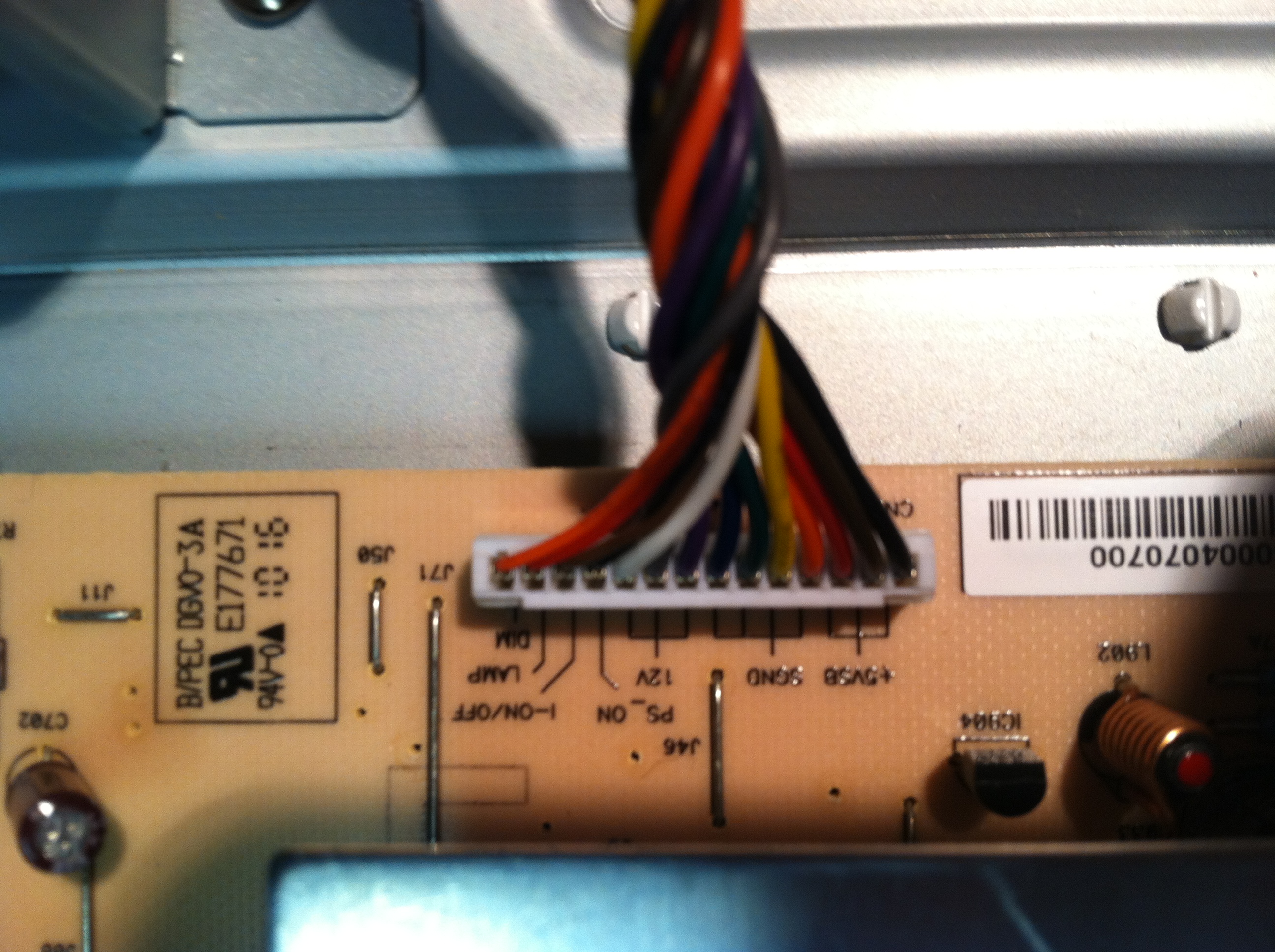

            Can you give us a good pic of the cable connector labels of the main board / PS ?
            It seems that the back light comes on and stays on when pins are jumperd but there is some confussion in pin numbers in my thinking. The Pic of CN201 is upside down and the jumper next to it is J71 not to be confused with being pin 1 of CN201.
            +5VSB are pins 1-3, SGND are pins 4-7, 12V are pins 8-10, PS_on is pin 11,
            I on/off is pin12, Lamp is pin 13, and Dim is Pin 14.
            With this being the numbering our logic can be on the same page, Unplug TV wait a few minutes for caps to discharge through the PS, use a 500 to 1000 ohm 1/8 or 1/4 watt reisistors (Radio Shack buy 4 or 5) with the cable from the Main Board disconnected. Use one resistor to make each jumper between pins. There will be several jumpers for testing
            Jumper from the 5VSB pins 1 or 2 or 3 to pin 11 PS_on. then simultaniously
            Jumper from the 5VSB pins 1 or 2 or 3 to pin 12 I on/off
            Now plug AC power plug in the wall and and see if the backlight turns on and stays on.
            if yes or no, then then we can work from there. I just want to ensure we are on the same page so the correct part can be singled out as good or bad. Parts can get expensive. I hope that I have not offended you.
              Ok.. My mistake Looks like I have been reading the numbering backwards on the Connector.
              I will jumper using a resistor this time between 5volts and Ps_on and 5Volts and I on/off. Get back with you shortly with the results. Thank you for the help. I will post a better picture also.

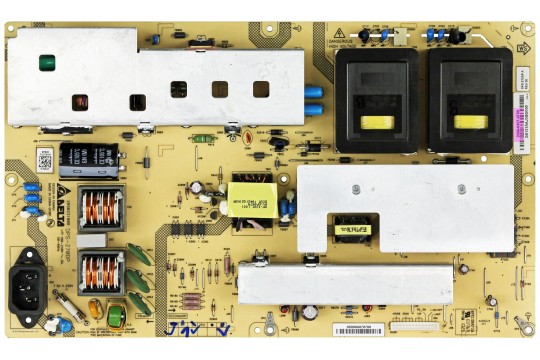

                        Which one of the power supply board you have?
                        http://www.shopjimmy.com/catalogsear...q=Vizio+E470VL
                          They are just switch transistors . When they blew it shorted out my 24 volts. Pins 12, 13 and 14 are on connector CN201 on the power supply board. They are Pin 12 -Inverter On,
                          Pin 13 - Lamp and Pin 14 Dim.. I was reading those in reverse earlier.
                          I would lose lamp voltage without the jumpers. I tried the resistors to the Lamp first (Pin 13) and the back light would still shut down. Then I went with a resistor from 5volts to pin 12(Inverter On) ALSO and still the backlight would shut down Then finally I went from 5 volts to pin 14 (dim) and the TV played until it blew the two transistors. I am going to post a picture of the power supply board and the two locations of Q700 and Q 708 that I am going too replace. They have been removed as well as the heat sink flange so you can see where they were at on the board. PS part number is 0500-0407-0700.

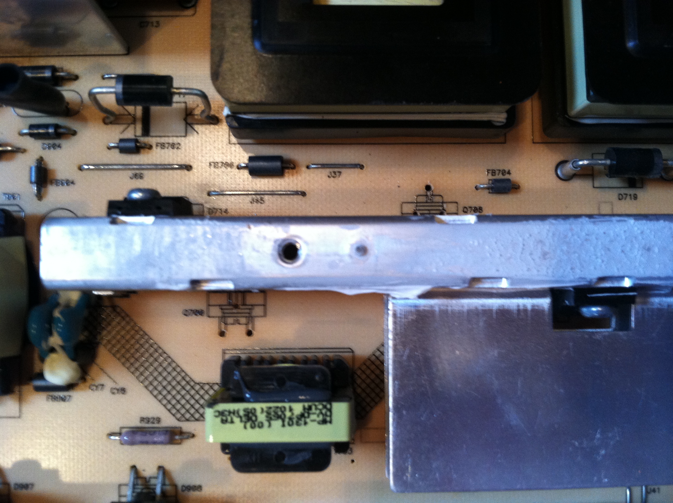

                                Well at least the problem finally showed itself. Sound good. Replace the Mosfets then connect all cables and see if it works at that point. Good Luck with it.
                                    Sorry I mean 12 volts. I replaced the mosfets but also found R805 was smoked. It was underneath the large heat sink that was a pain to remove. Does anyone know the value of this resistor? It looks like brown/Black/silver/gold/gray/black it has six bands???? 10 ohms maybe????
                                      I did some research and found out it is a fusible resistor.
                                        That means it has shorted components such as MOSFET. The resistor may be for feeding the B+ to the inverter circuit or it is the Source resistor on the Source pin of the MOSFET for monitoring current flowing through the MOSFET. You need to trace out the two legs of the resistor to see whwere they are connected to.
