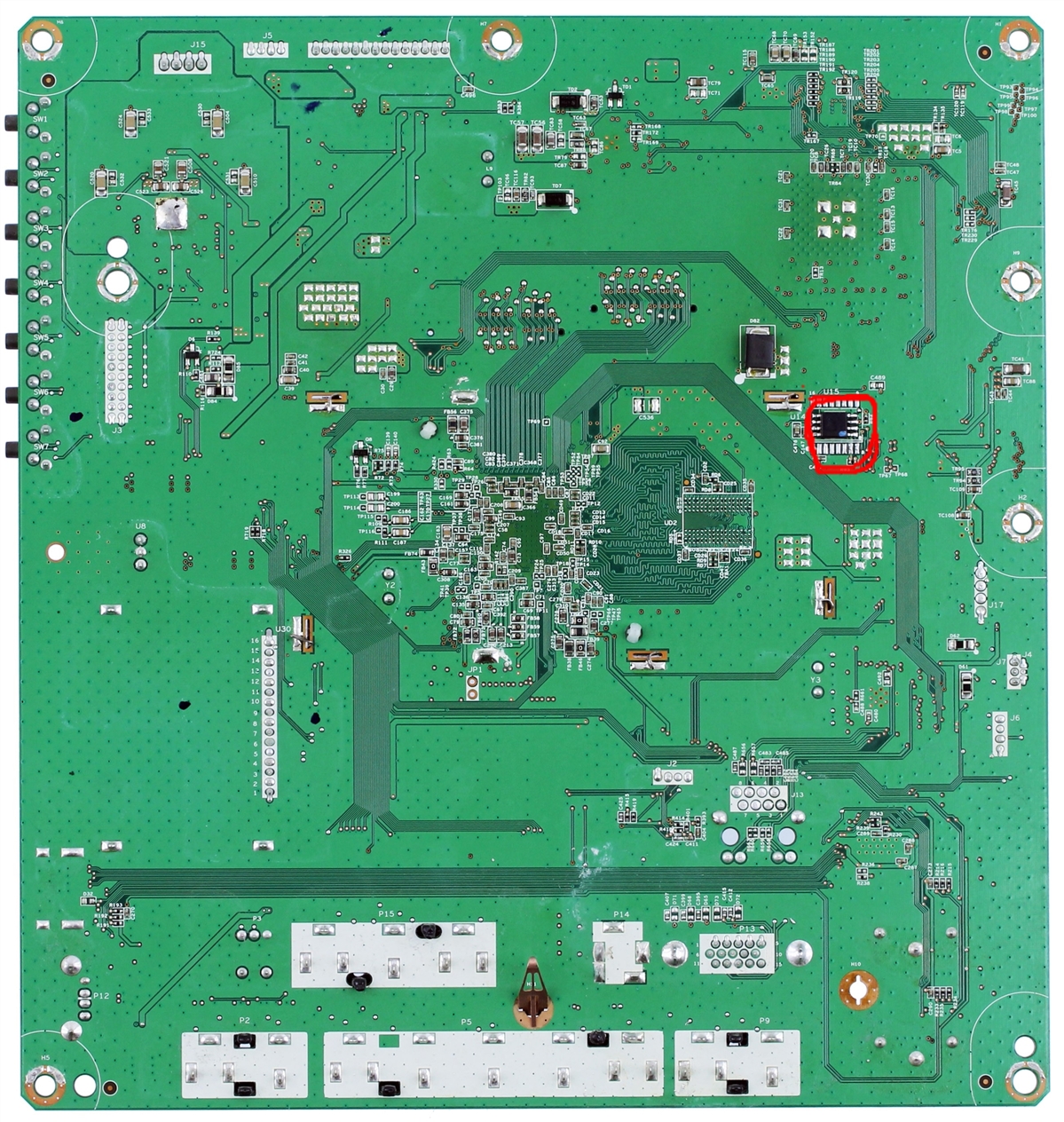

          Ok, I ordered a new eprom and the instructions said it was U14 underneath the can. There was not a U14 but a U12. I replaced U12 but now I think I made a mistake. I saw another picture on the web that showed the chip was U15 on the back of the Board. Here is my board number 3647-0292-0150(3J) and 0171-2272-3253. Which chip is the eprom for this board? Also does anyone know of a source for the entire board incase I just want to order a new board. Everywhere I have checked is out of stock for this board. Thanks
            Re: Vizio E470VL backlight shutting down
            The eeprom is located on the back side of the board U15, It will help to post picture of your main board.
              OK I found the eprom I will post a photo and it is circled in red. Thanks for the help. I have a new one on order and fortunatly kept the old chip i removed from the top of he board. The eprom I had ordered previously from ebay had cheap, cheap legs and they broke off. That is why I had to order a new one. Hopefully this will fix the problem. I was thinking about replacing the entire board but everyone on the web is out of stock.

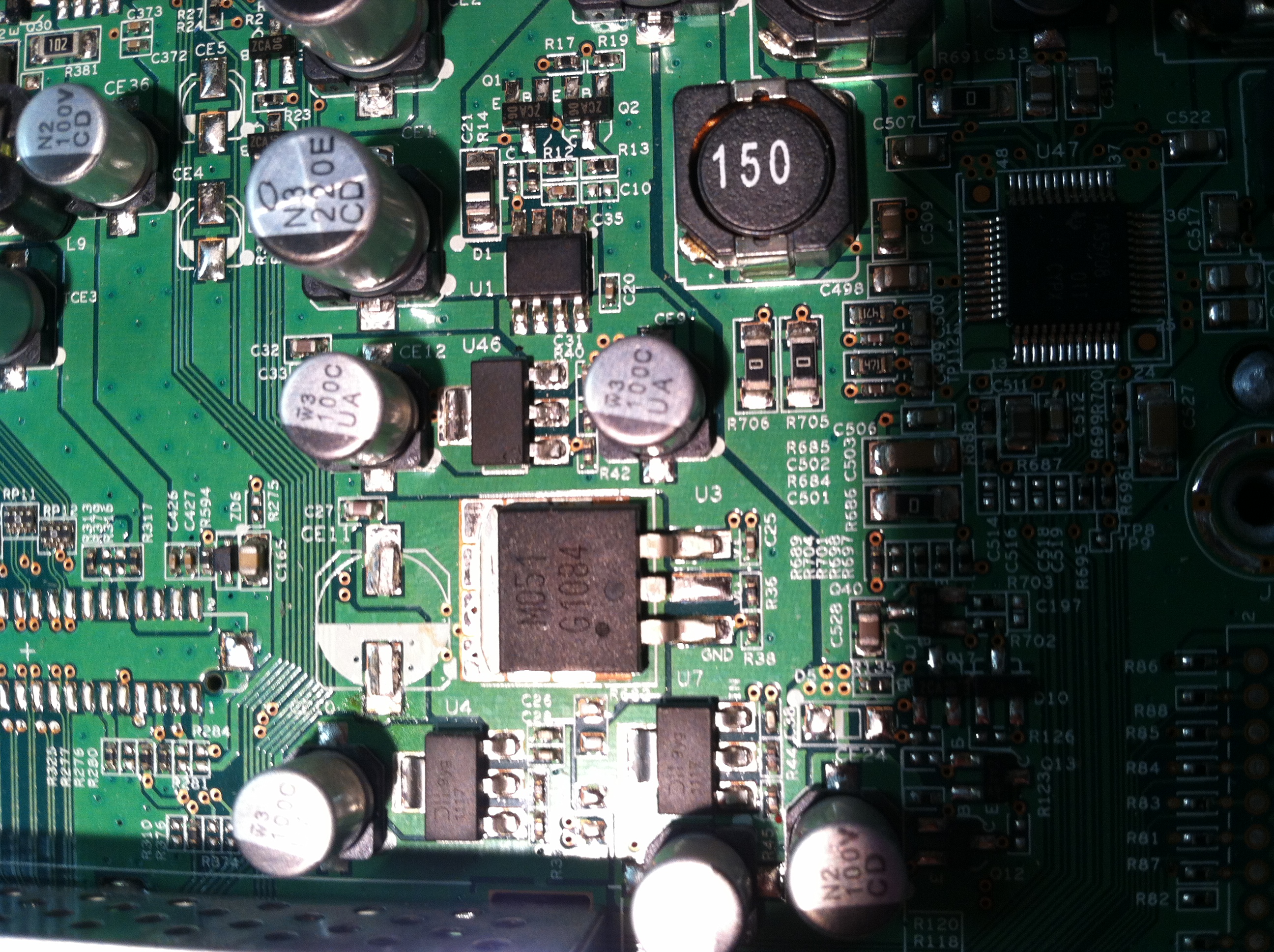

                          Problem is I dont want to pay 150 to 200 bucks for a used board. I got this one for 85 so if all possible I would like to fix it. I have not had a lot of good experiences getting boards that are said to be good off of ebay. It seems it's about a 50/50 shot. With that being said I just pulled Cap CE11 off of the board that was connected to the regulator that is overheating. Regulator is still overheating even though the voltages look normal. Still not getting enough voltage to turn the power supply on so I can get the 12 volts. I am posting a picture of the regulator that is over heating which is U3. Thinking about ordering a new regulator and gonna have to put in a new surface mounted cap. Those things are really hard to pull without destroying. Any ideas on what would cause U3 to overheat and has anyone had this problem before and also what type of cap and value is CE 11. TV is model EV470VL and main board number is 3647-0292-0150 .. 0171-2272-3253
                            #33
                            U3 maybe powering the TUNER circuit, what is the output voltage? can you take a resistance measurement on the output of that regulate (tv power off) to ground.
                              #34
                              3.2 Volts output
                                #35
                                did you measure the resistance from the tab of the regulator to ground, with the tv power off? you may have a short or some other components are over heating
                                  #36
                                  Yes I did do an ohm reading of the regulator and everything looked fine. No shorts and no other components overheating that I can see. I have a new regulator on order but what puzzles me is that the voltages read 4.8v , 2.2 v and 3.2 v at the tab...
