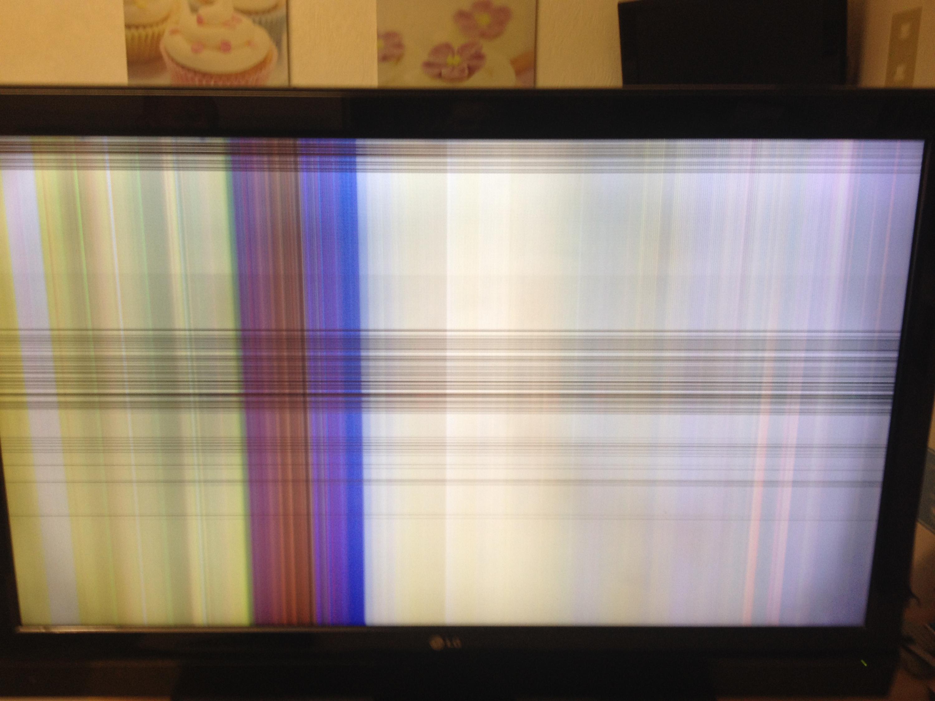

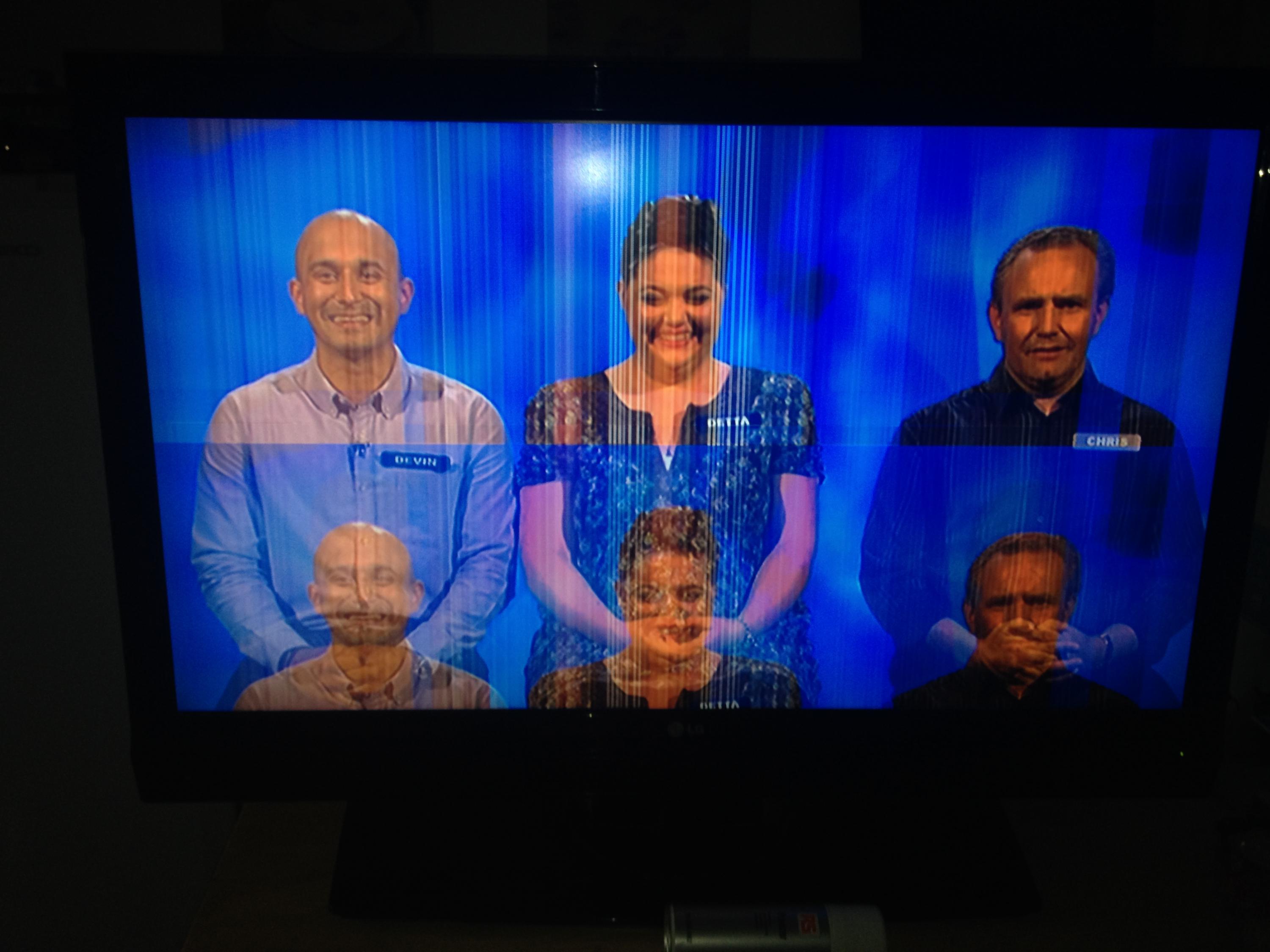

    I have a lg 47inch lcd picture starts jumping after 30mins like this in picture 1 and then the picture go,s like this after anther 15 mins picture 2 any help please could it be the t-com

    looks like panel fail to me,bad tab bonds
    try re-seating lvds cable after cleaning contacts both ends with iso alcohol
    flex gently the screen,does anything change?
    still could be t-con though
    can you show a picture of the screen,with the menu up ?

      I'm going to agree with panel, and I've never had good luck repairing LG panels with tab faults :/. Has to be zero for three on success rate.

          Well--trust me to disagree!
          I had a 37" LG 1080P set on Sunday with exactly that symptom--Working well for up to half hour, sometimes only 10 mins from completely cold. Strange thing is--certain scenes, like computer generated stationary images (intros to programs etc) were mostly stable--only when the pic changed to motion would it go beserk!
          It was the Mainboard at fault.
          Changed the T-Con, no difference, replacement (Philips-LG) mainboard cured the fault completely.
          It was a LG 37LF66 summit or other....
