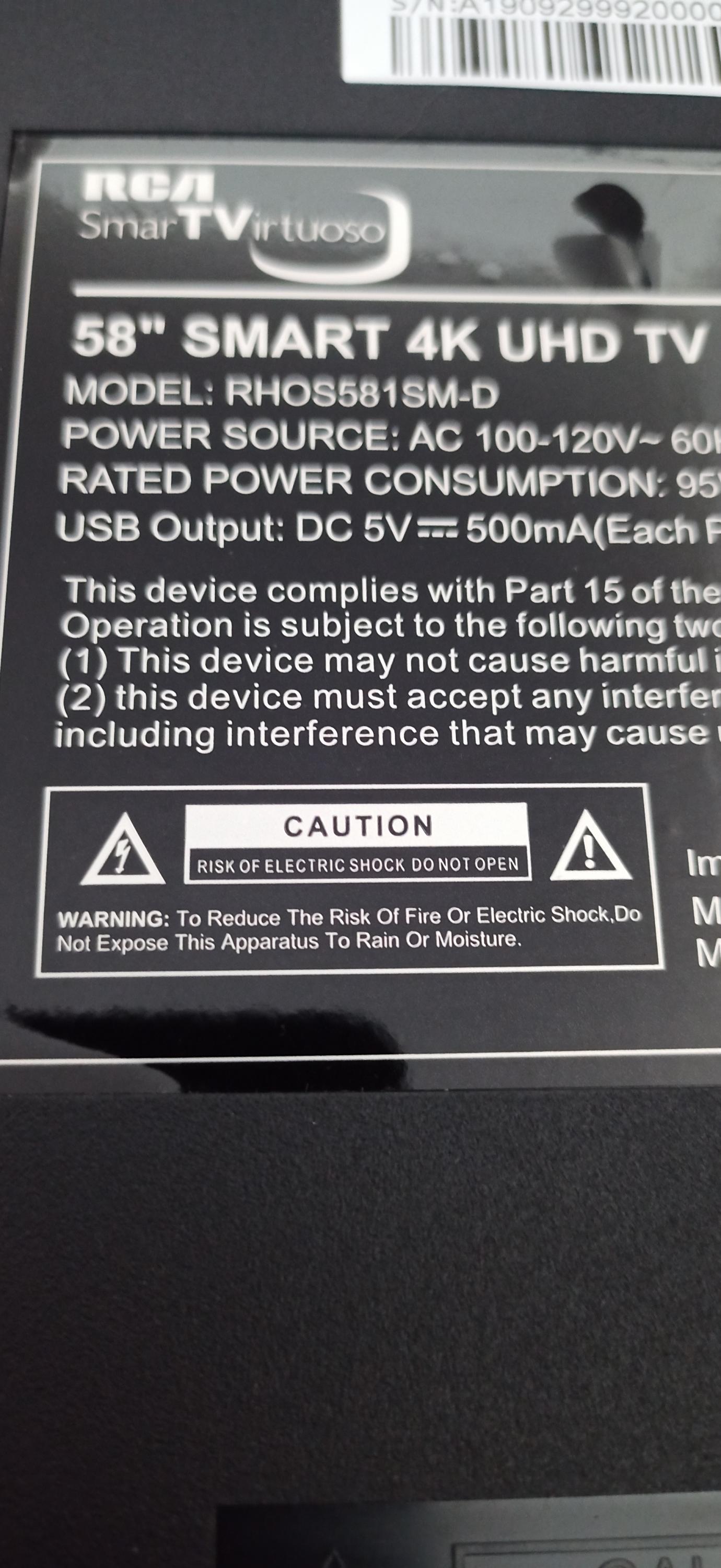

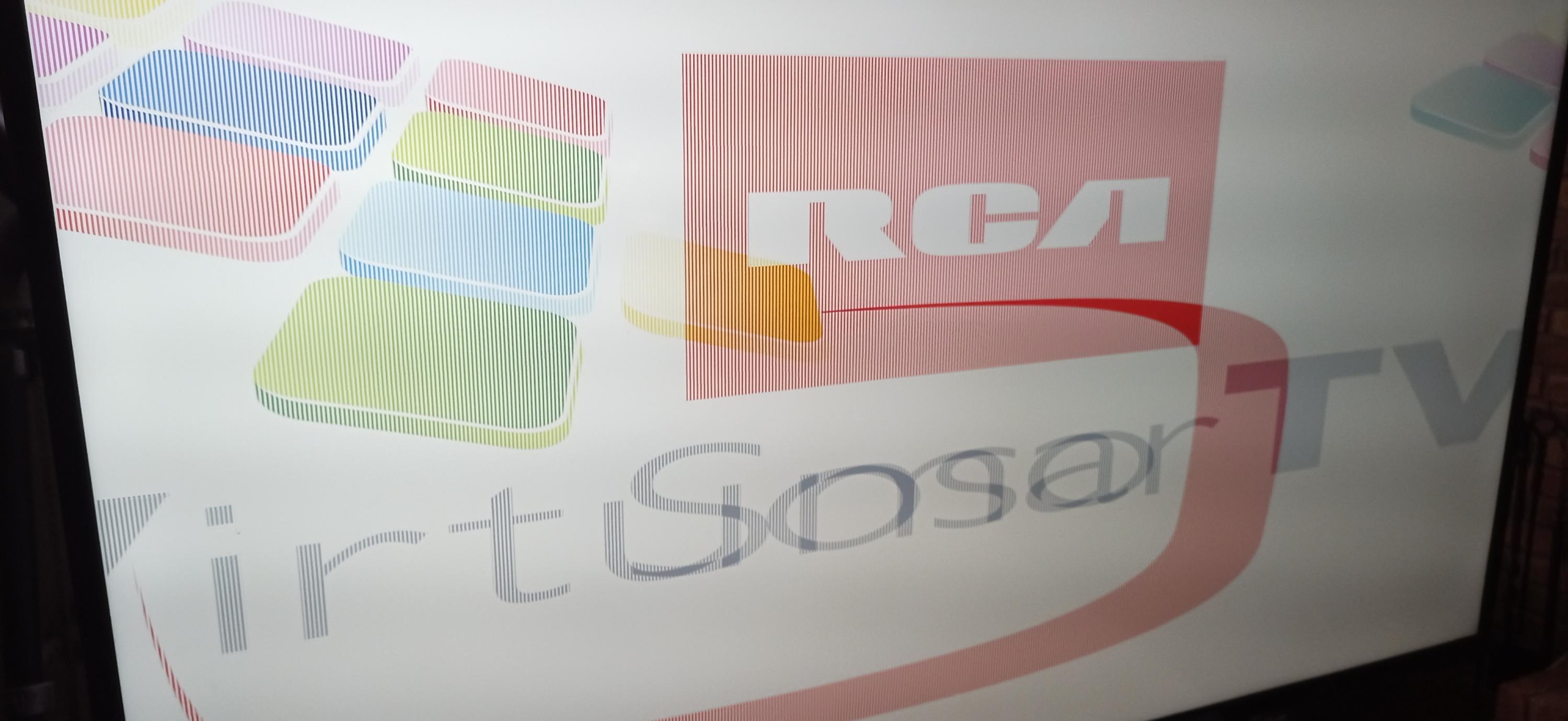

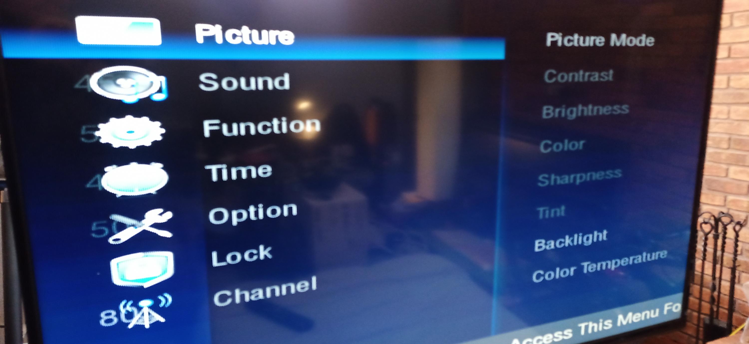

    RCA Virtuoso RHOS581SM-D Picture Fault
    Picture looks stretched out and it looks like every other vertical line is not being drawn though hard to see that in the pics.
    I've disconnected each half of the panel and the fault remains exact save for the disconnected side being white.
    The original complaint was the tuner stopped working so the main was replaced however the new and old board exhibit the same picture defect.
    Nothing is getting hot and pushing on the panel drivers effects no change in the picture.
    So with that does anyone know how to enter the Service Menu on this set so I can check panel type etc, and do you think the tcon can be at fault here ?

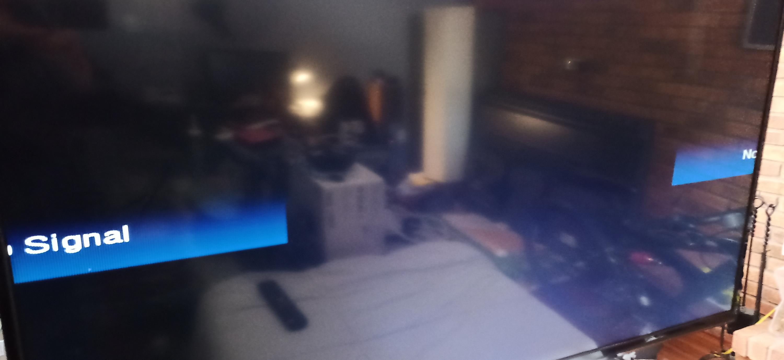

    Re: RCA Virtuoso RHOS581SM-D Picture Fault
    Sorry for the reflections but the fault is surely visible....

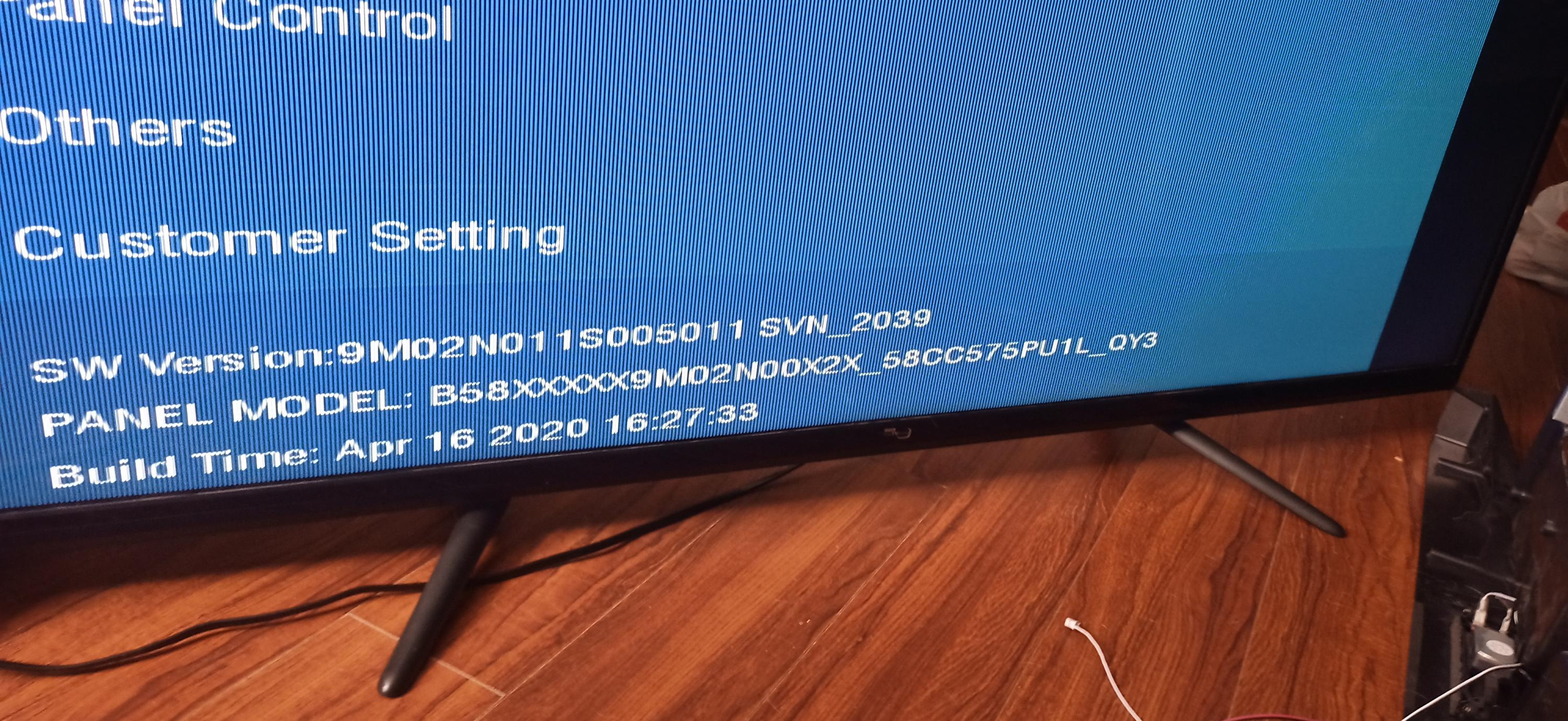

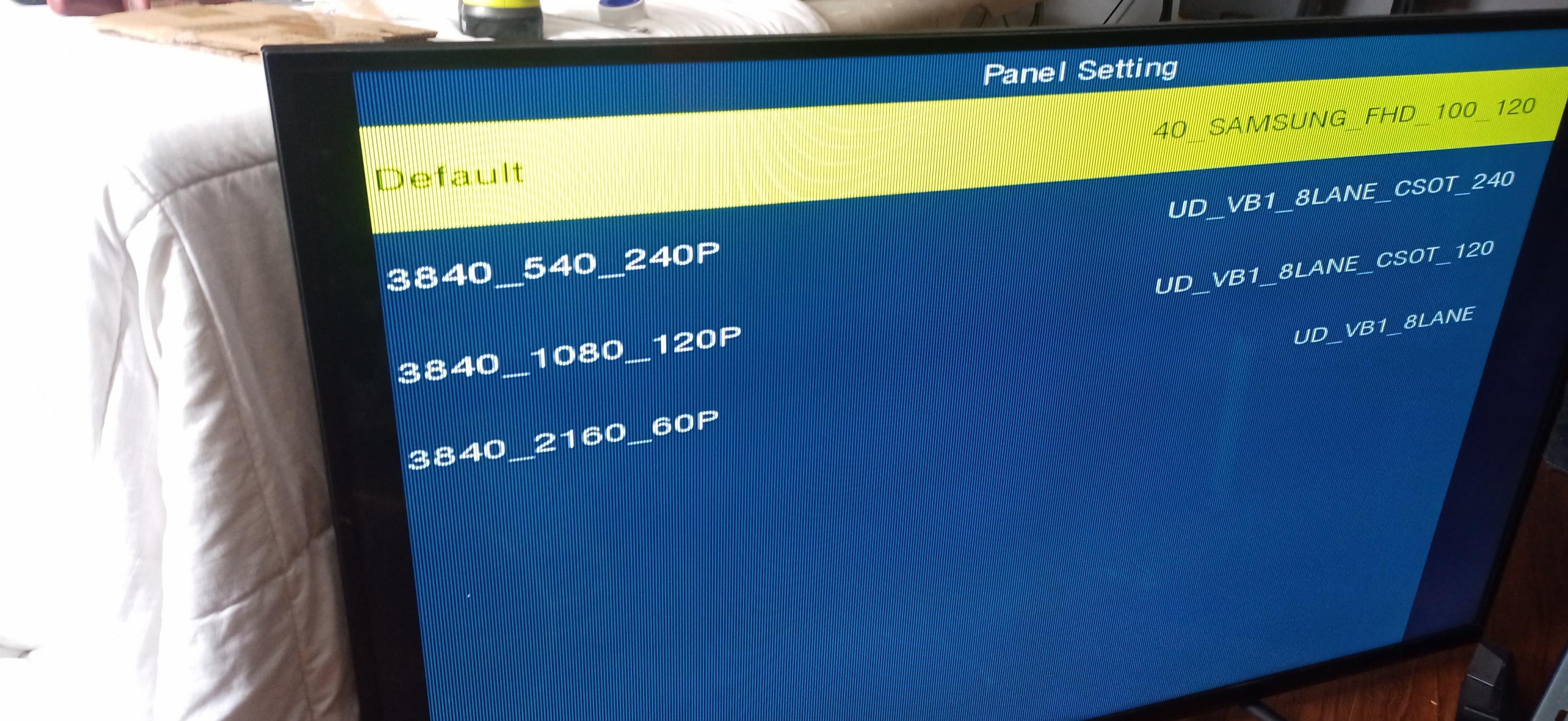

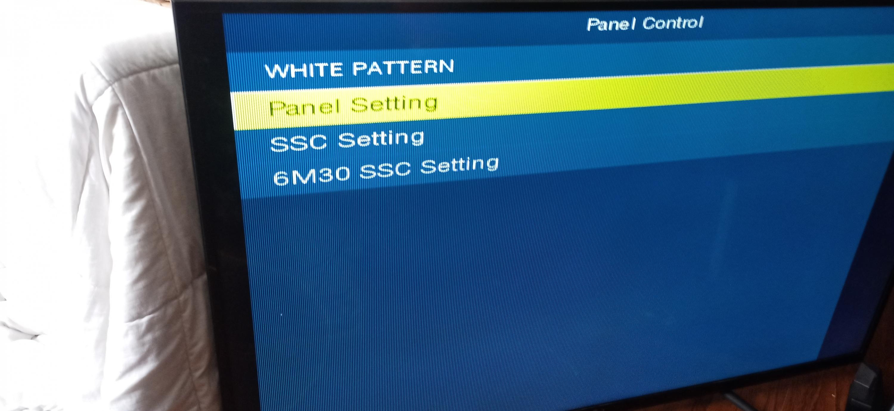

                    For anyone else looking the Service Menu can be pulled up by going to the antenna/cable input and then pressing Source-3-1-9-5
                    The panel setting did not match mine and the default mode was set to a Samsung 40". I could not find how to change the panel type itself but there were more than 80 modes the main board could be set to. I chose the one listed in the last menu as shown, the 4k 60hz setting.
                    This did not work and the set no longer has a picture
                    Alas I have another board - I've just created more work for myself as now I'm going to have to pull the eeprom and read/save it before proceeding.

                      I pulled the 24C64's from both boards and they both read as 0xFF's in fact the boards will work fine without them apparently. So I have no way to reset the settings of the non-working board the info must be supplied on one of the bga devices and I don't have the equipment for reading/writing those...
                      If the problem is indeed with the panel info not matching the installed board how do I know which setting to chose since they are not clearly defined ?

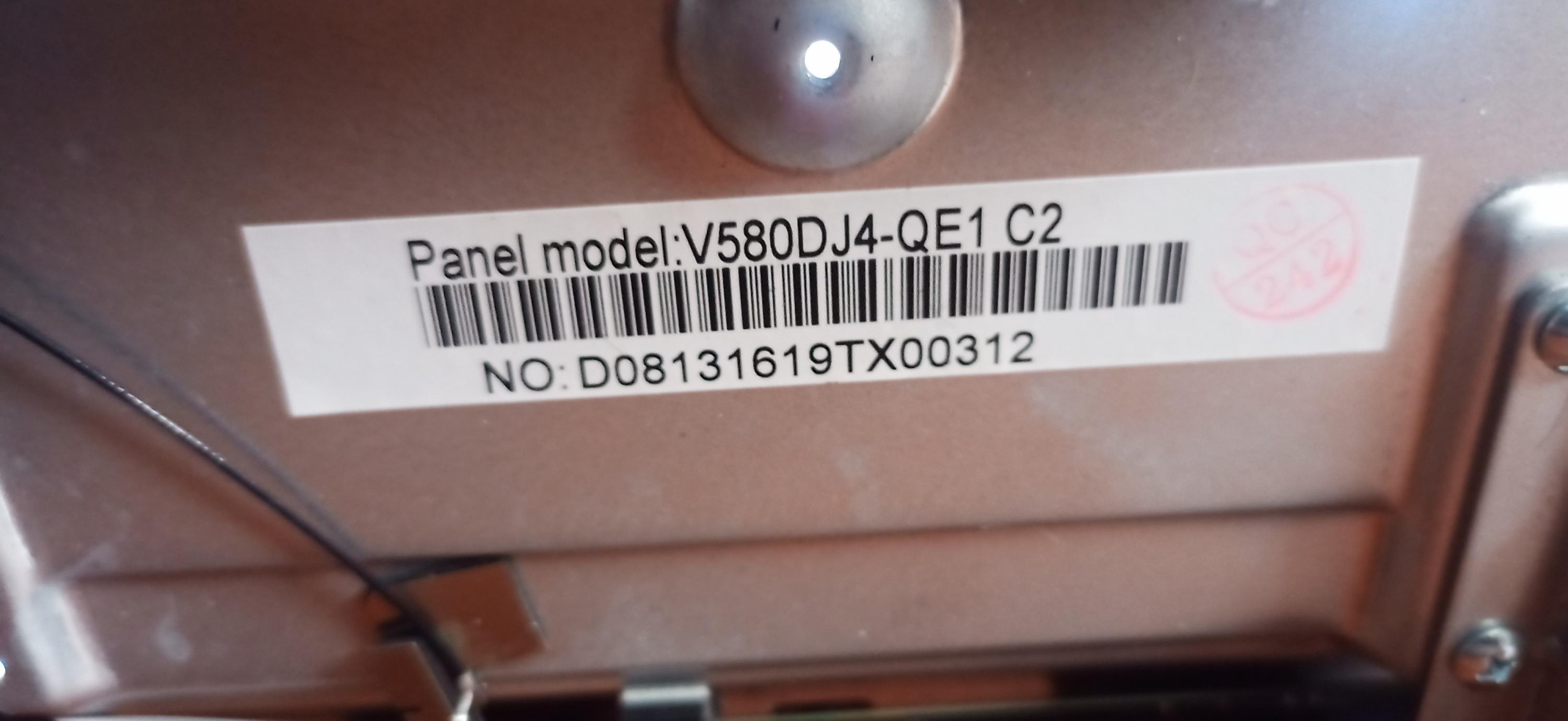

                        I should have included a pic of the panel sticker. Here it is.
                          Like I said these are cheap. My panel is set to Samsung 40 in hidden menu also for rhos651sm probly generic for all these pieces of shit lol. So changing that will not solve problem. Your issue most likely is t-con, main board, bad cables for vertical issues. Horizontal lines would be worse more towards a possible bad panel. I am pretty sure they pushed a shitload of this garbage since 2019 covid. All the overseas workers were dying or dead of covid working for peanuts and these countries just shipped thousands of defective tv's to keep their stock investors profits stable. Happens all the time. profits for rich and wealthy over all us pee on's. Shallow soulless bastards. Yayyy covid rage on ... show humanities true reflection .. Death in near future from ignorance and stupidity lol
                            Oh I know these are cheaply made but thank you for verifying yours is also set to Samsung. Since I had two of these main boards both doing the same thing I think it more likely to be tcon or lvds cable as you have stated.

                                      After a little more digging on this it turns out there are two different panels used in this model, a Panda and an Innolux, which I have in mine.
                                      The Panda has 12 source and 12 gate drivers.
                                      The Innolux has 12 source and 16 gate drivers! I think that would explain the messed up scanning I am seeing.
                                      The mainboards for these look identical but are likely carrying different flash memories or at least different settings with relation to the expected panel pairing.
