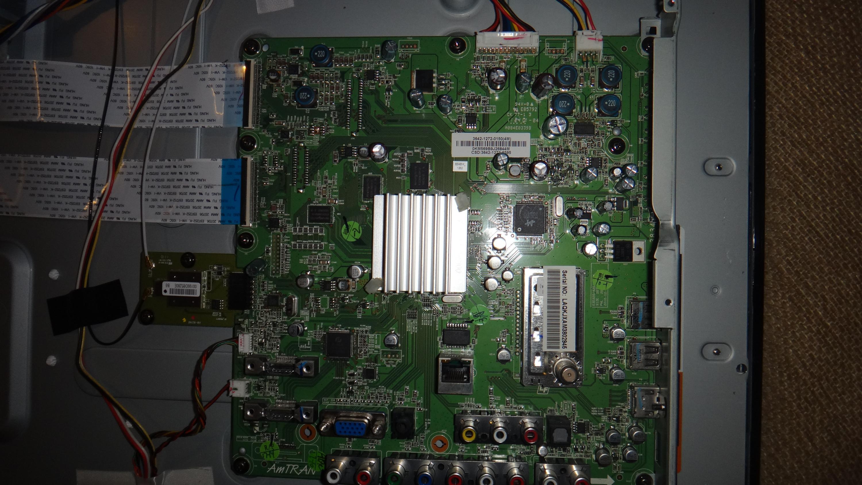

        Re: Vizio E3D420vx No Standy Power. Why?
        Originally posted by dhack61
        If your screen comes on then your fuse probably is ok.
        There are several here with the same problem on Vizio e3d420's and 420's. I have the same problem with a 320. have not found a solution. You need to check the voltages coming off the power supply board with your meter. Pins 1-3 should be the standby 5.2V Voltage. Pins 8-10 should be 12v, pins 11-14... I have no idea. THose are the return voltages signals from Mainboard. I am searching for those.
        For What its worth 7 out of 10 sets I have fix with no Standby light and good voltages on the power supply have been mainboard problems. But...keep checking back maybe someone will have a breakthrough.
        What have you done with the ones that have been mainboard issues; do you fix the mainboard or buy/swap it out for another know working mainboard)
        Ive been T/Sing mines on and off for about 6 months now. I replaced the power supply and it has been the exact same issues. I have tried looking for voltage regulators on the mainboard but honestly I cant pick out any except two (up13, up2) and those have the same voltage readings when it work and when it doesn't. They are some other 8 pin chips that might be voltage regs but I honestly dont know.
        I think the issue with this thing is definitely thermal but in which component IDK. The heatsink on the main processor does get hot to the touch and reads around 112deg F with my infrared thermometer.
        This has been pissing me off because its intermittent in that if i leave it unplugged for a day it will cut on after that for anywhere between 5 mins to 24 hours. I used to be able to unplug it and hold down the power button for about a min and then plug it back in to cut it on.
        If anyone know hows to fix this please help or at least where do I find a schematic or something. Vizio doesnt have one, shop jimmy doesnt have one so Im real curious on how the heck to T/S this dag gone mainboard. I dont want to have to spend 50-90$ (ebay not guaranteed to work) or 120$ shop jimmy for a new one on a tv that cost 440$ new now.
          http://www.youtube.com/watch?v=cNFzBJELFoU
          you need to watch this,voltage regulator U33 often bad and another one but cant remember now the number...

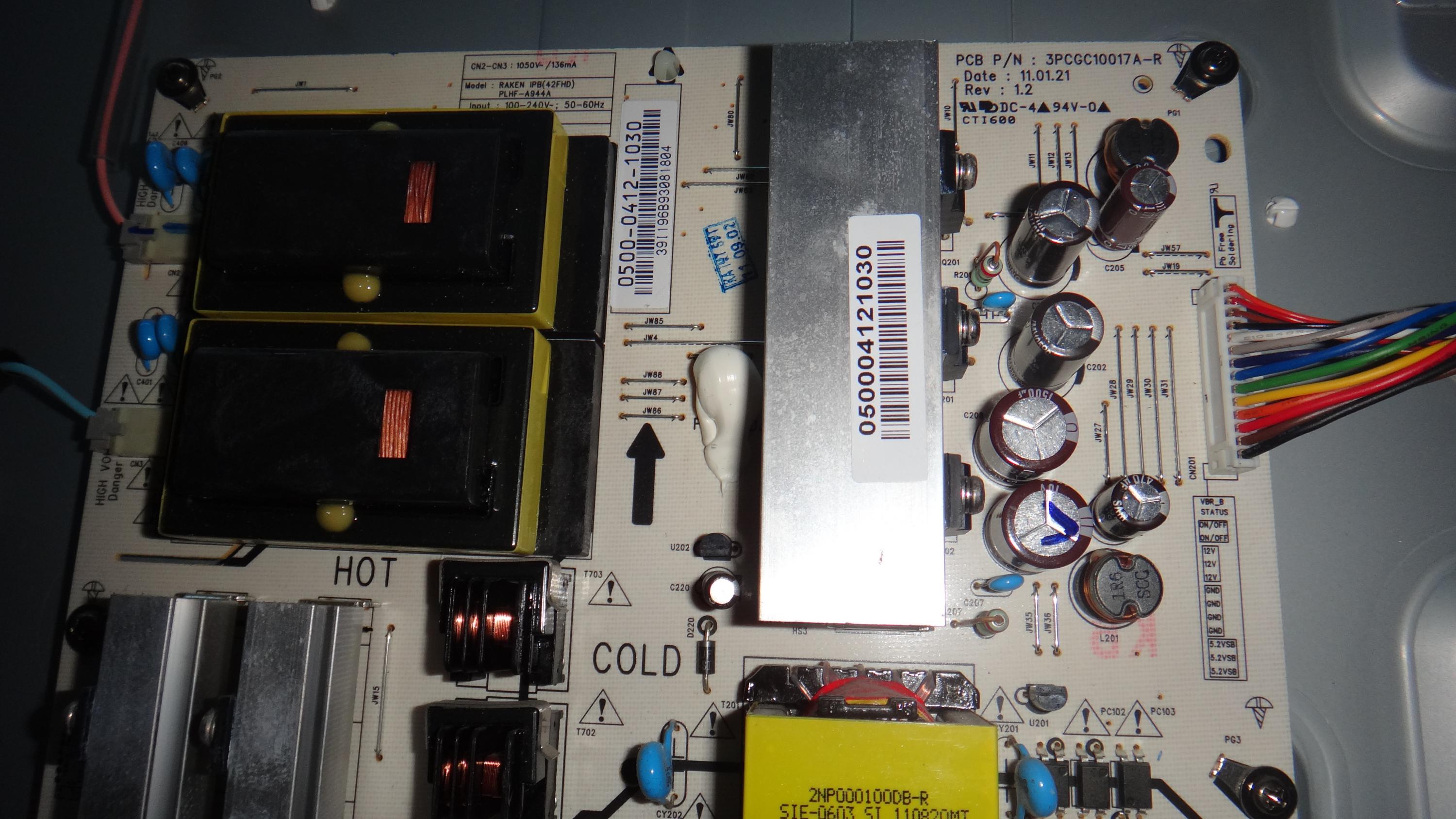

              Hello;
              I have a vizio E3D420VX and it doesn't work, but it has a different issue. I was watching a movie one day, and I heard a loud noise like something exploded. The TV turned off and it won't come back on. I took the cover off the TV but I don't see anything burnt or anything that would look bad to someone with little to no experience. I have pictures of the boards that I can upload. Please help....
              • Denkodt
                • Aug 2014
                • 16

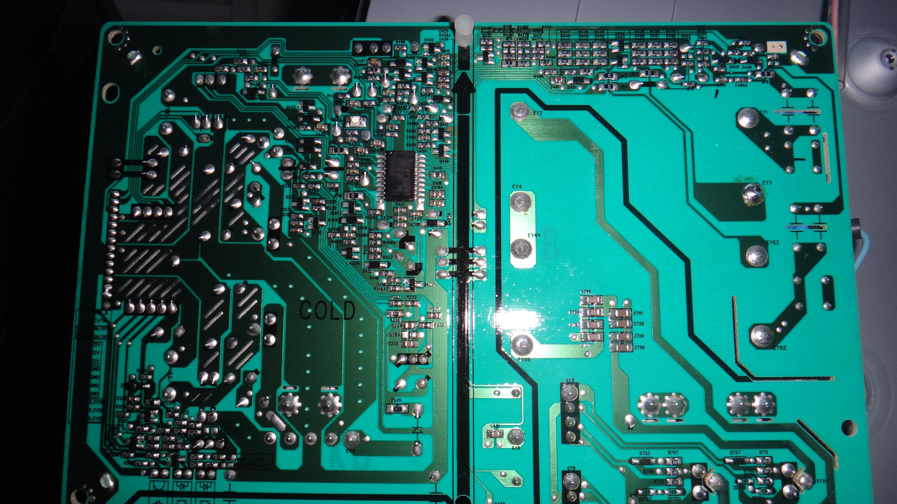

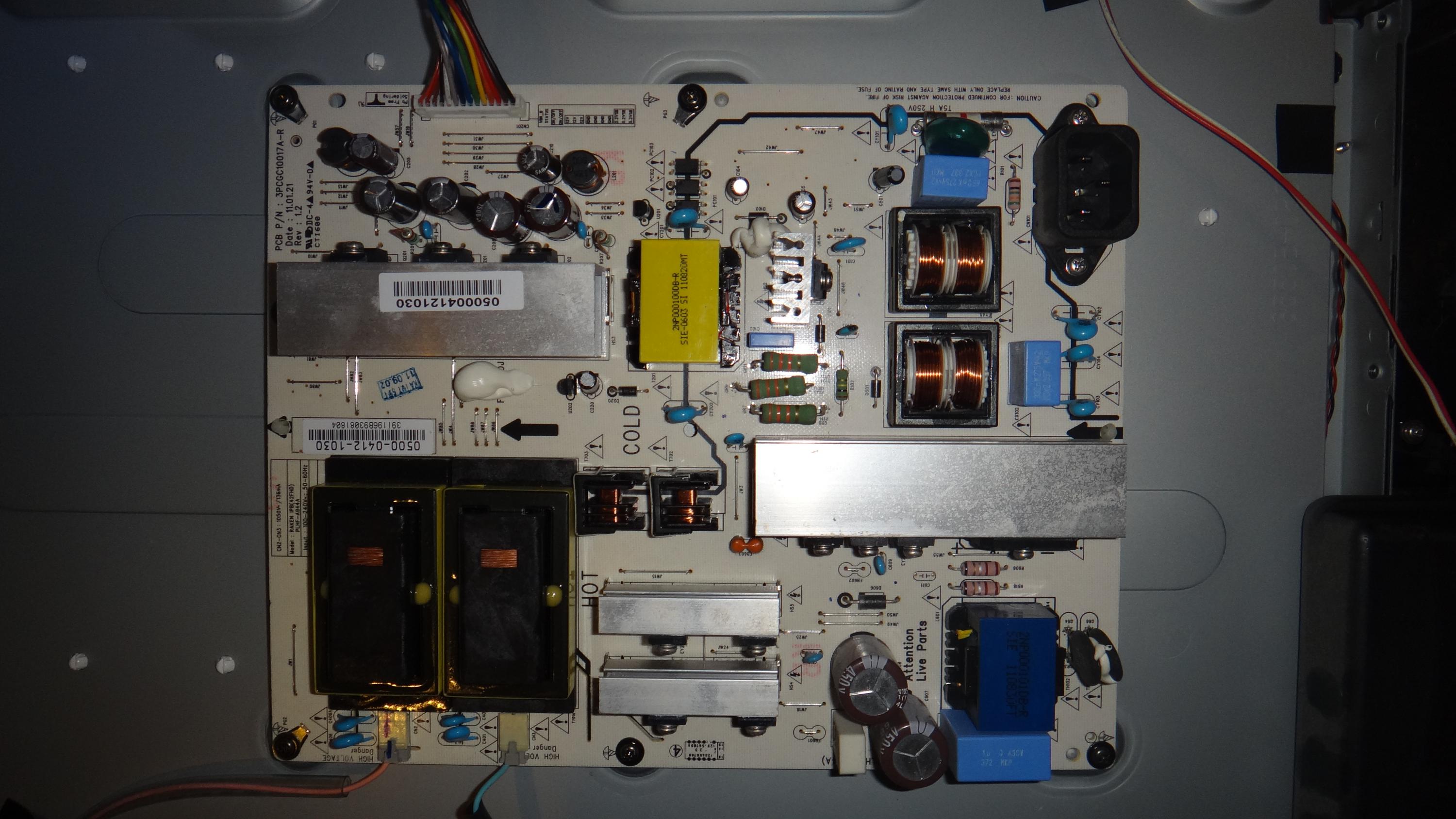

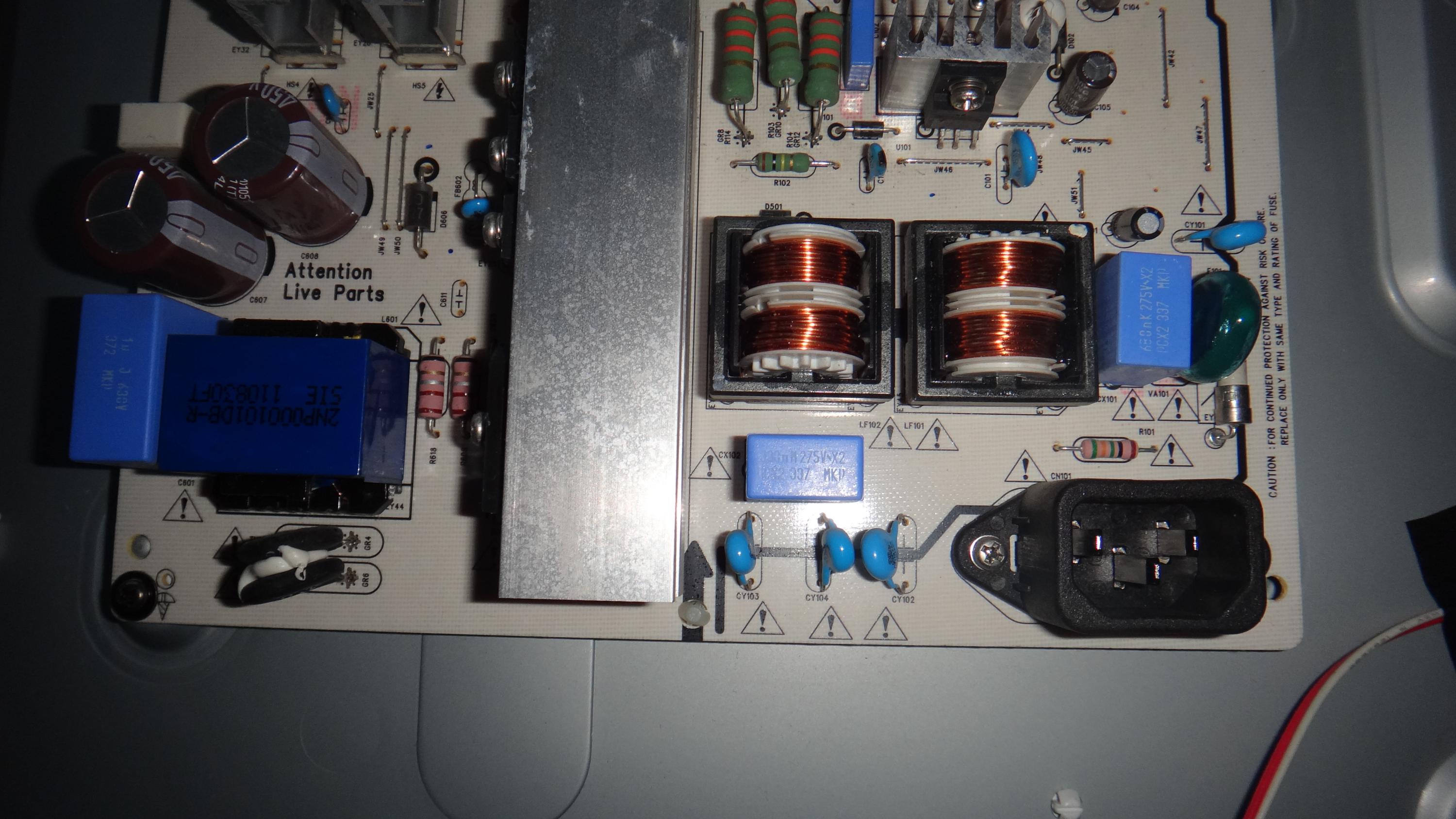

                Here are the pictures of the boards
                  Can you take new pictures with better lights, it is kind of dark? also take the pictures of the bottom side of the power supply/inverter combo board.
                  What kind of tools do you have?
                  • Agent24
                    I see dead caps
                    • Oct 2007
                    • 5095
                    • New Zealand
                    I see a blue high voltage ceramic capacitor on the PSU that looks like the top has blown off.
                    It is nearby to what looks like the main switching transistor\IC. I also see an electrolytic capacitor nearby that might be bulged.

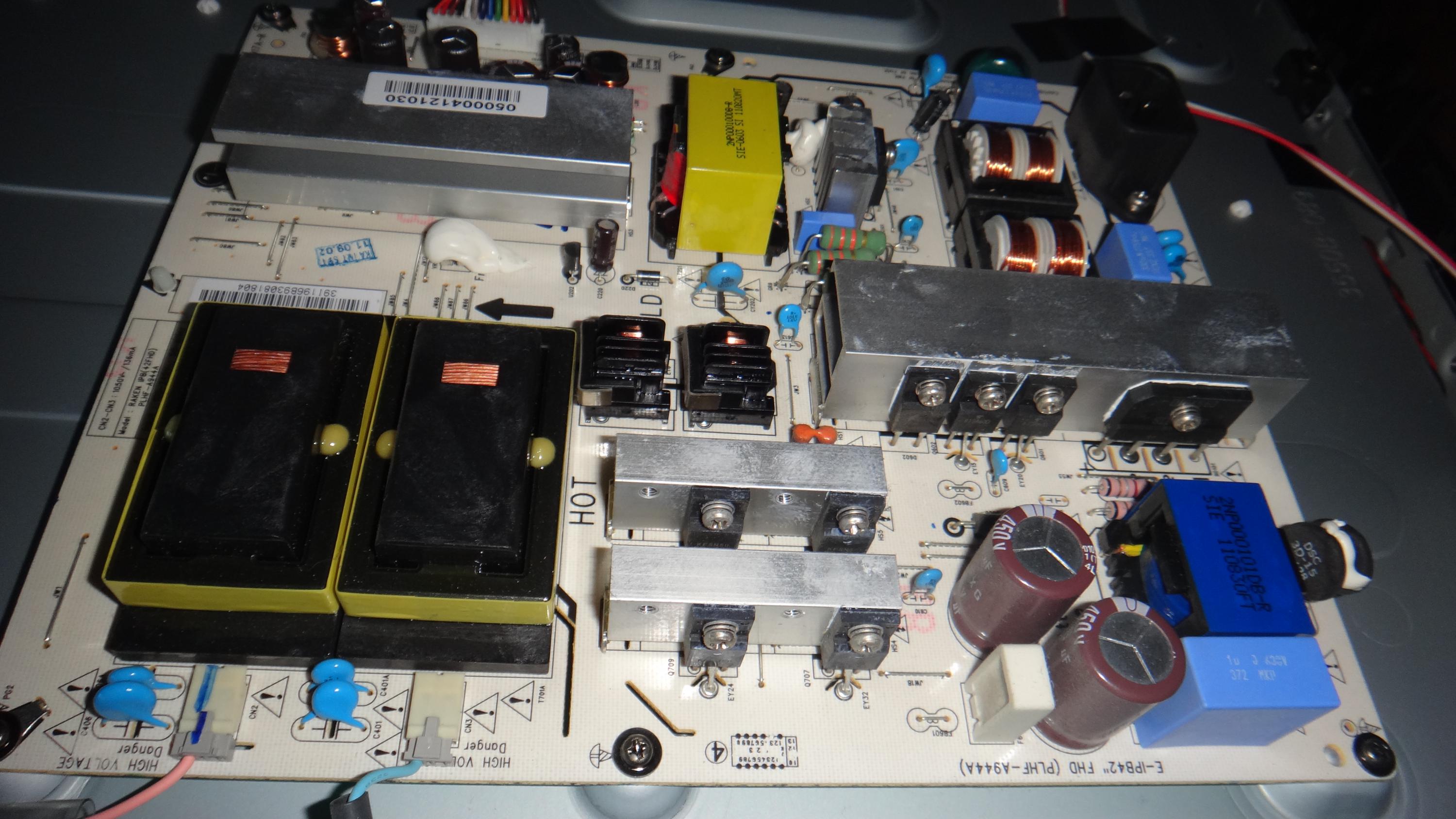

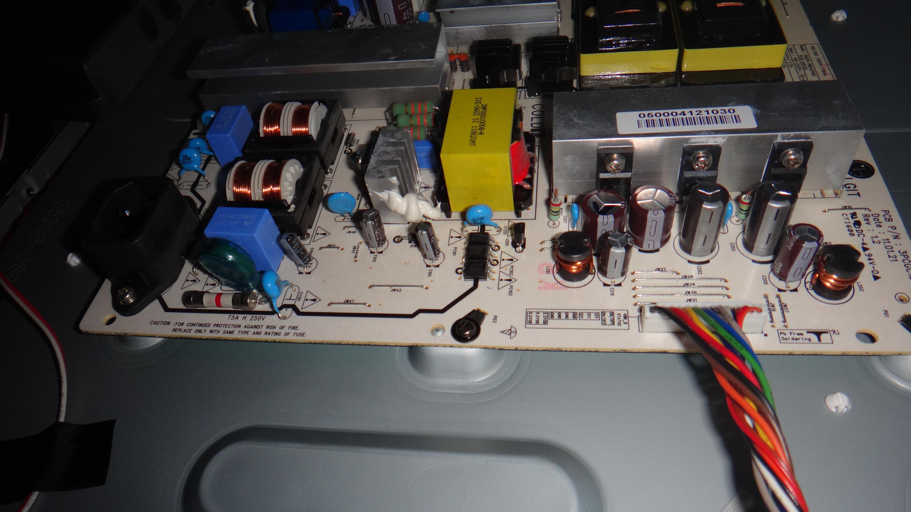

                      I have 4 more pictures of the board.
                      I have a volt meter and basic understanding of electronics, but I definitely need someone to hold my hand.
                      Which capacitor is the one that has the cap blown off? All capacitors seem flat, that's why I wasn't sure what is wrong. Normally it is clear to see a bulging capacitor...

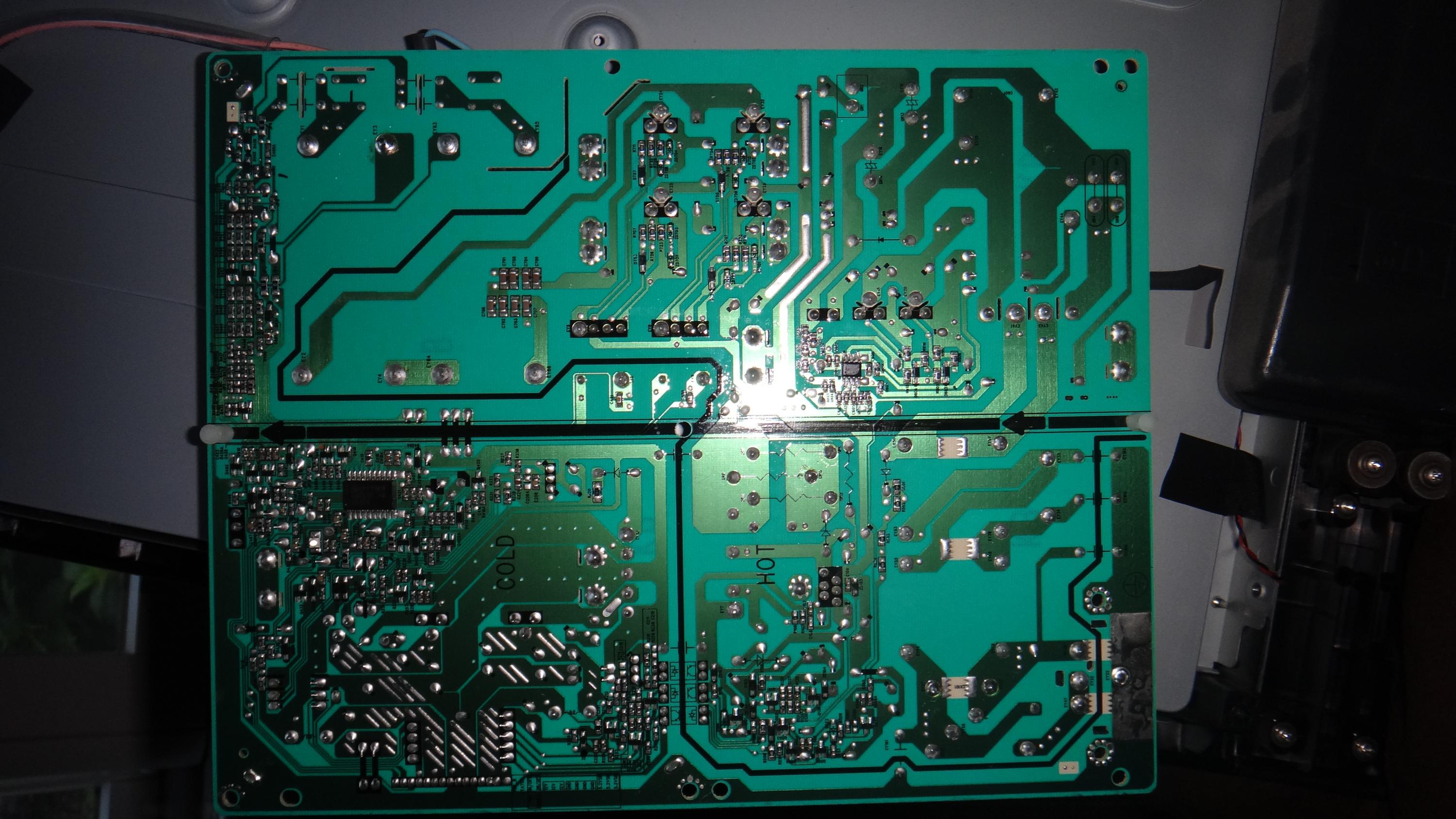

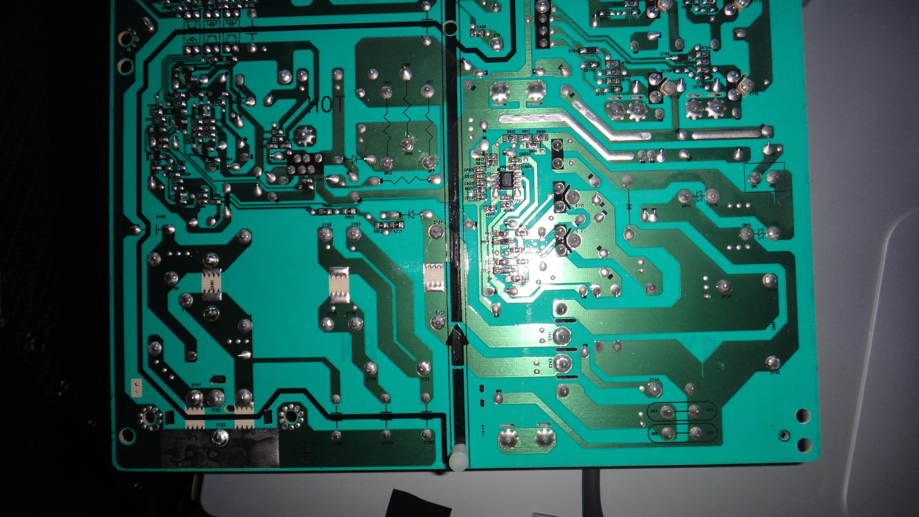

                        Here are the pictures of the back side
                        • Denkodt
                          • Aug 2014
                          • 16
                          I think I found what you were talking about, it's C103 and it has a small hole on the top. I will replace it and see what happens. Thanks so far.
                            What else does C103 connect to? Does it connect to the device on that heatsink nearby? It's possible more than just C103 has blown.

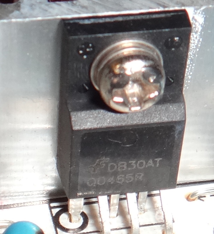

                                What is the device on the heatsink? Can you read the part number?
                                -David VanHorn
                                  That is the Snubber cap connected in parallel with the Source and Drain pin of that SMPS IC on the heat sink.
                                    Here is a closeup of it, do you think that might be bad as well? How would I check that?
                                    It is DB30AT 00465R
                                      It might be D830AT 00465R, the 8 looks like a B
                                        If the snubber capacitor blew the IC might be dead too.
                                        It seems to be an FSQ0465, see attached datasheet. You need to check at least the IC for shorts in the internal FET and check the other snubber components too. Probably a diode and some resistors.
                                        Check the datasheet Page 18 for the example circuit. Yours should be similar.
