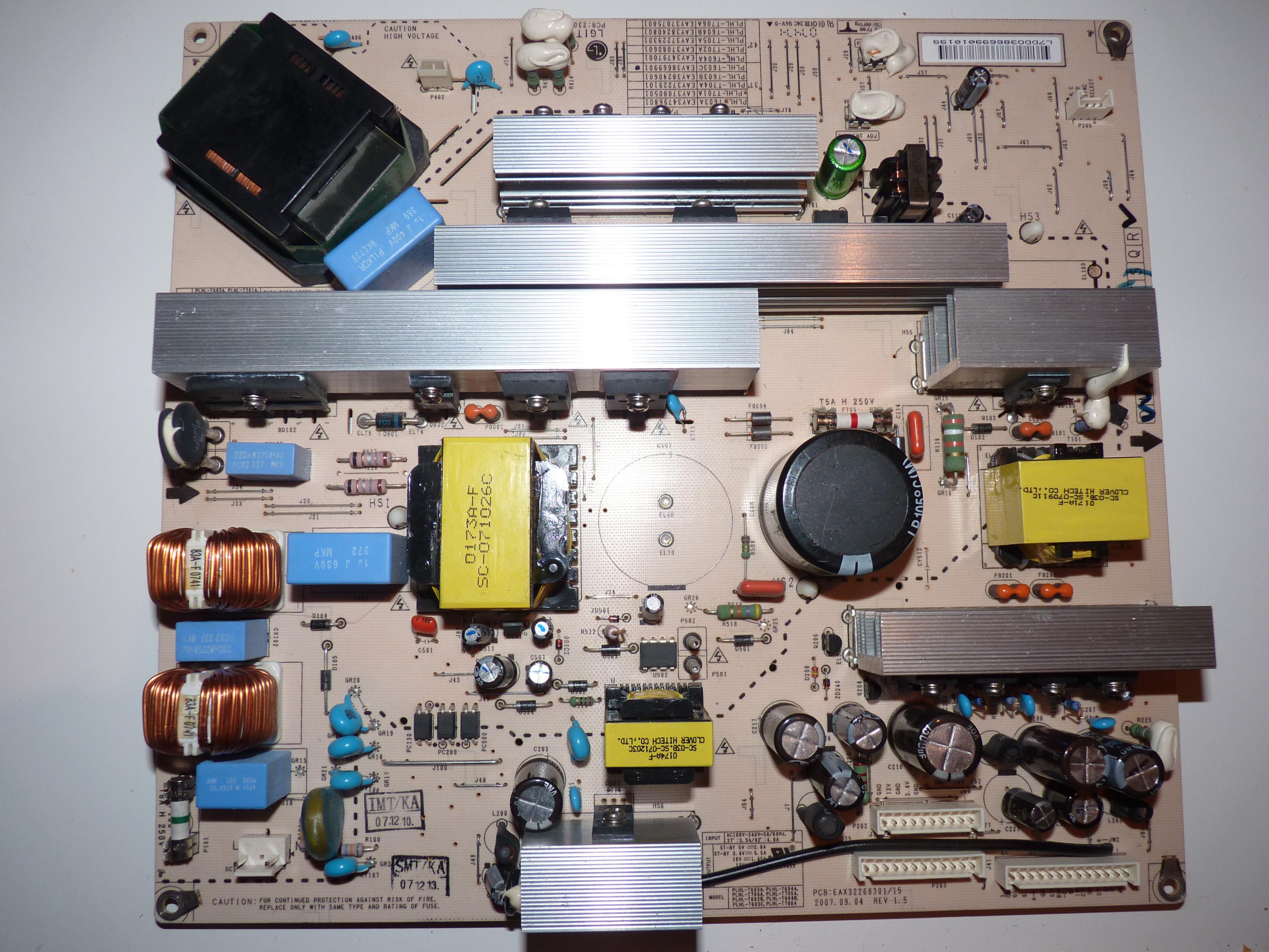

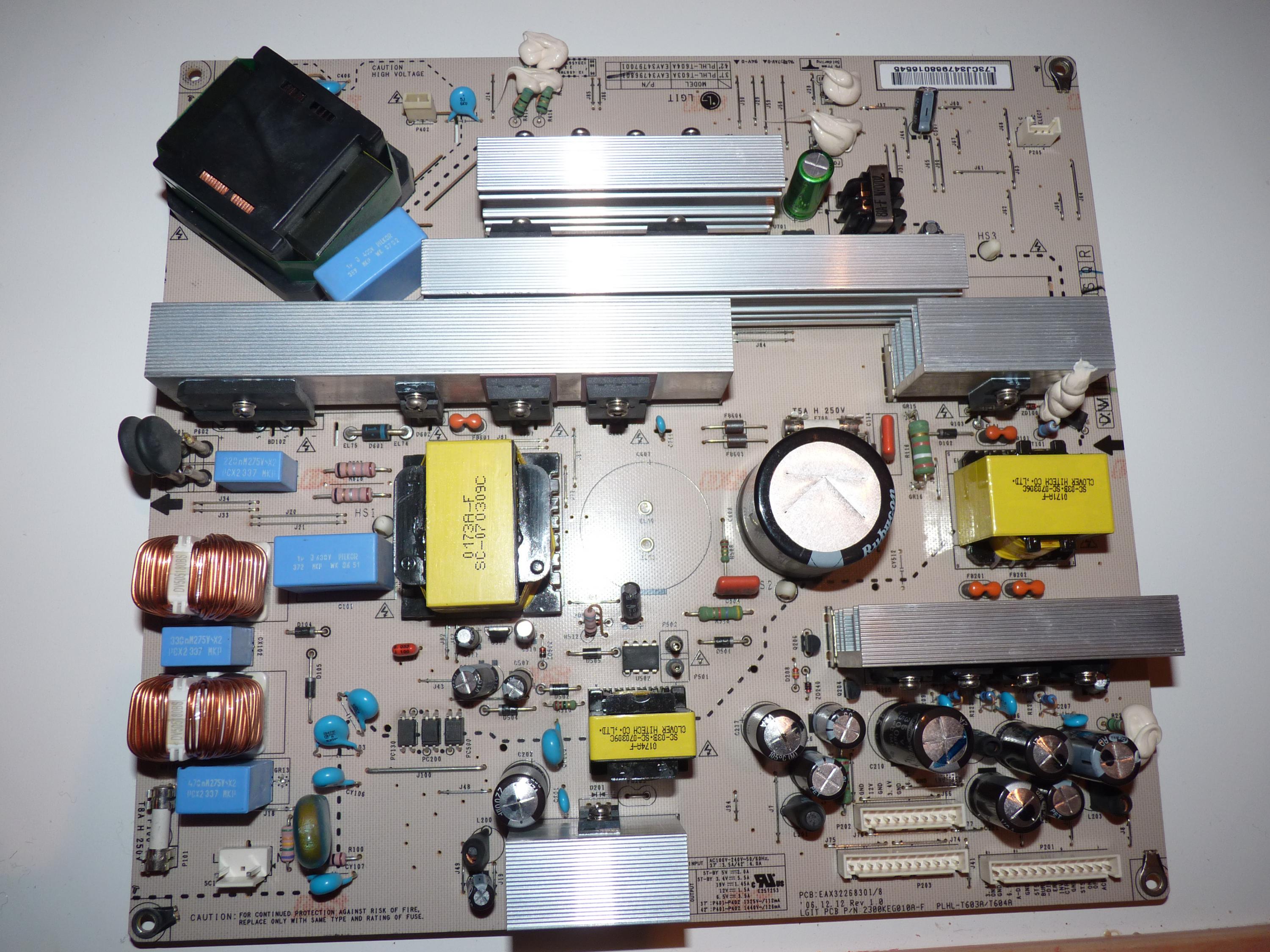

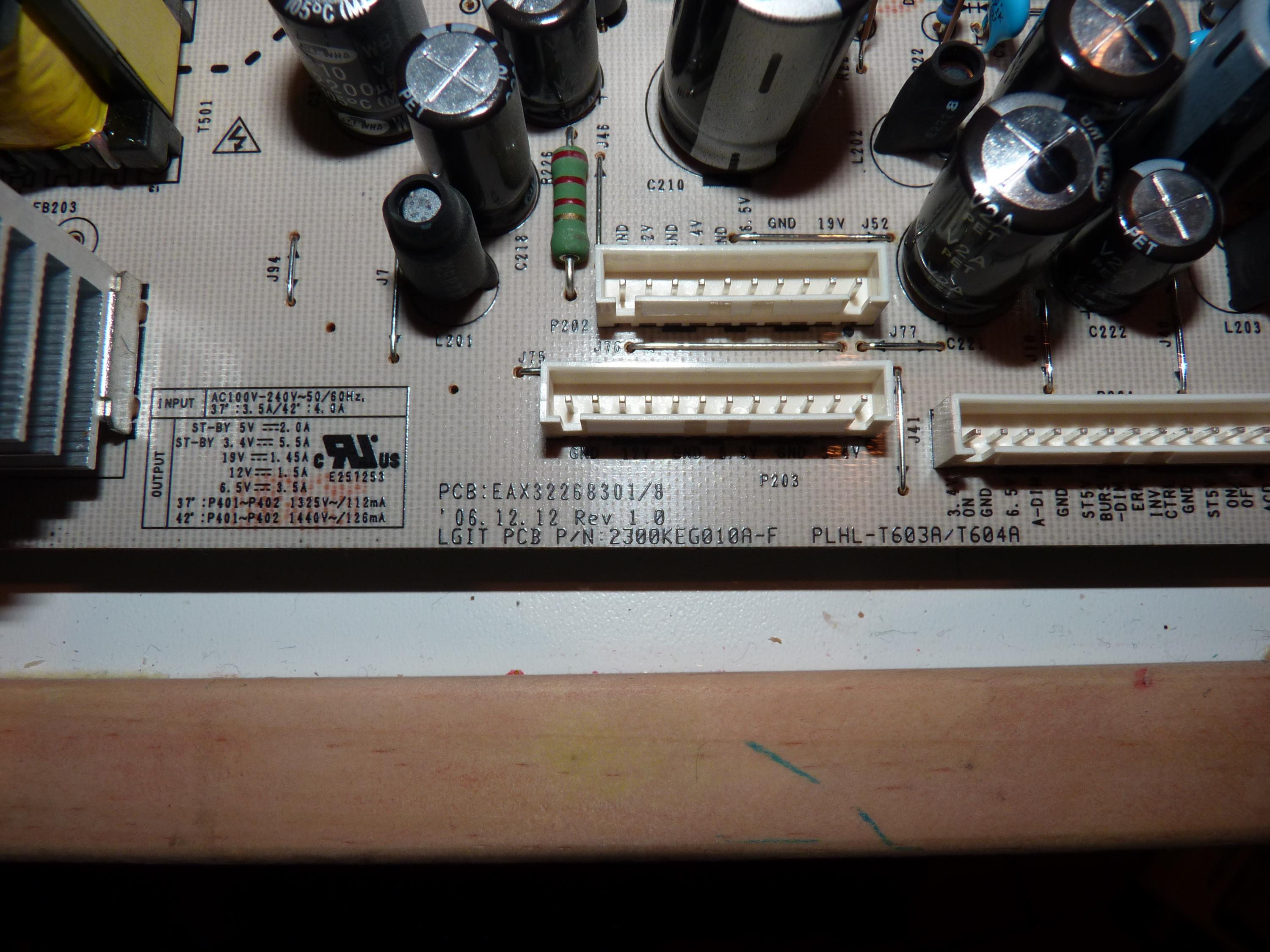

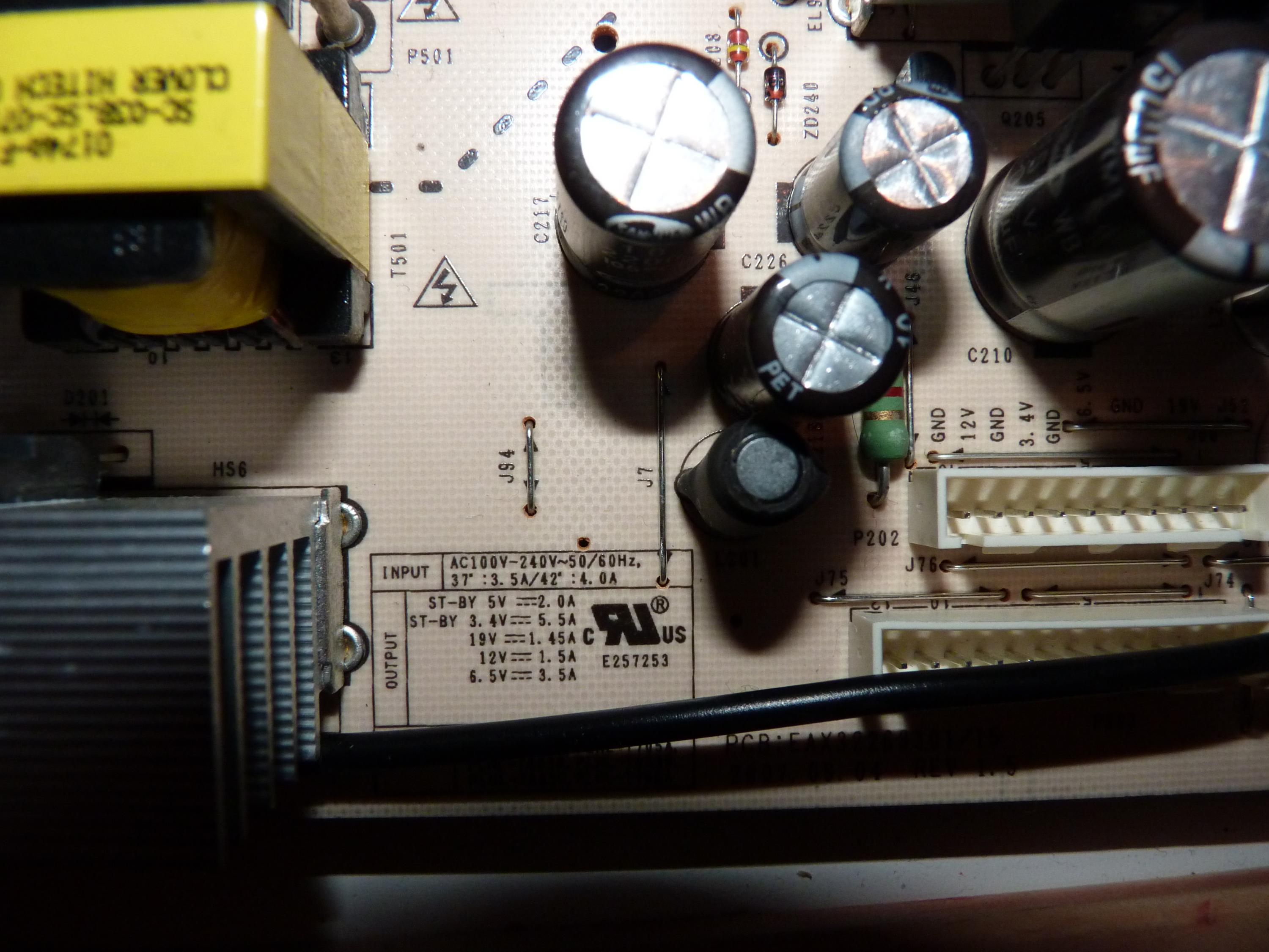

                                  can you post a good clear picture of your power board imo it does seem like a bad capacitor issue but post a picture of the psu board and also by the connectors so we can see what the voltage markings are printed on the board have you got a multi meter to test voltages etc we can advise you how to test them if needed.

                                    Images added, the first two are the old board with quite a few bulges, the second two are the new board.

                                      Two left power board pictures have bad caps. Replace c221 ,217, and the one
                                      next to 2 small green caps.(2200uf). Those caps look bad to me.
