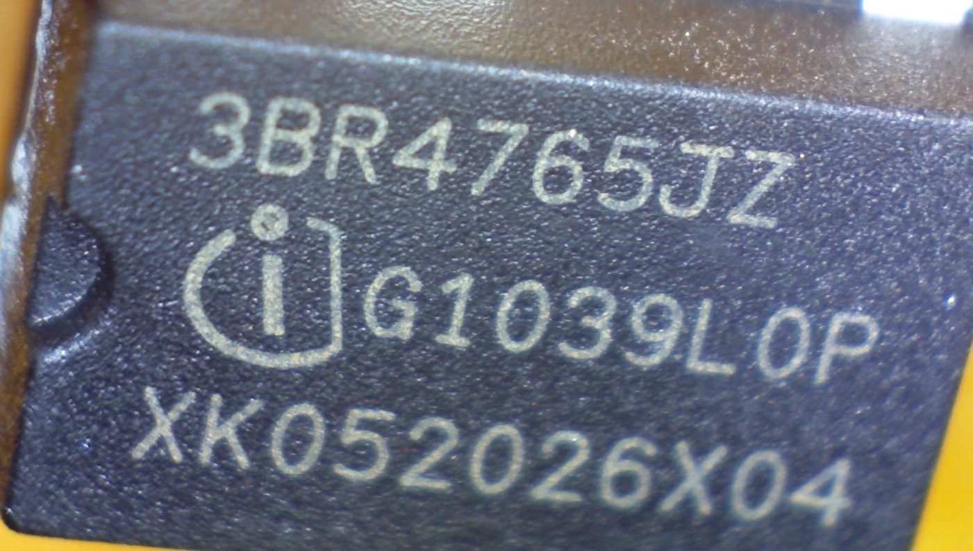

        I had time to take a shot of the IC. Here it is:

          OK, take the resistance reading between Ground pin against all other the pins of the IC, then take DC voltage readings of all the pin with ref to the ground pin (or the negative legs of one of the two small filter caps for this stby section).

            Re: LG 42LV3500 trips circuit breaker
            Vcc fluctuates a lot. I see from 10.xV to 17.xV fluctuation.
            There is no short or low OHm resistance, between any of the pins.
            Pin #4 it oscillates a bit and keeps rising slightly.
            Pin #1= 0V
            Pin #2= 4.98V
            Pin #3= 0V
            Pin #4= 0.044V ~ & rising slightly
            Pin #5= 163V
            Pin #7= 10.xV-17.xV
            Pin #9= 0V
              Try changing the startup cap, it should be connected to the VCC pin of the IC.
                  That capacitor it was good, but I have replaced it anyway. Didn't fixed the issue.
                  What is weird, that if I measure Vac, it shows a constant 6.5Vac.
                  One of the diodes could be bad?
                      If startup capacitor doesn't fix it replace the IC.
                        I have replaced the IC, but it didn't help.
                        I'm measuring a 0.4-0.5V at standby with some oscillation.
                        The Vcc at the IC it's still oscillating as before.
                        I have measured 4.5V and 3.7V at the primary side of the optocuplors, but only 0.4-0.5V at the secondary side. Not sure what it means, but I thought that I should mention it anyway.
                        Any other ideas?
                            I'm reading this ICs datasheet and I have found this:
                            "The Control Unit contains the functions for Active Burst
                            Mode and Auto Restart Mode. The Active Burst Mode
                            and the Auto Restart Mode both have 20ms internal
                            Blanking Time. For the Auto Restart Mode, a further
                            extendable Blanking Time is achieved by adding
                            external capacitor at BA pin. By means of this Blanking
                            Time, the IC avoids entering into these two modes
                            accidentally."
                            It could be that capacitor is bad?
                              When the power is first applied to the circuit, the start up cap will get the charge up current through the Start-up cell which is connected through the D pin of the SMPS IC, once the voltage on the start up reaches 18V for the turn threshold (10.5V for shutoff threshold). The burst mode during power saving just to keep the circuit alive when the load is light load (in standby). So try having a load (1/2A) connected so it will not kick in the power saving mode. It seems to me that it is trying to start but the VOLTAGE from the AUX winding of the transformer for keeping it running is not there. The Resistor Cs is OK?
                                It seems like it's turning on and off. It's in this cycle.
                                I will have to check that resistor.
                                  Try having the load connected.
                                    I don't understand, which load?
                                      #38
                                      Load at the output for this power supply section.
                                          I think budm means board connected as usual, e.g. main board and LED backlight.
